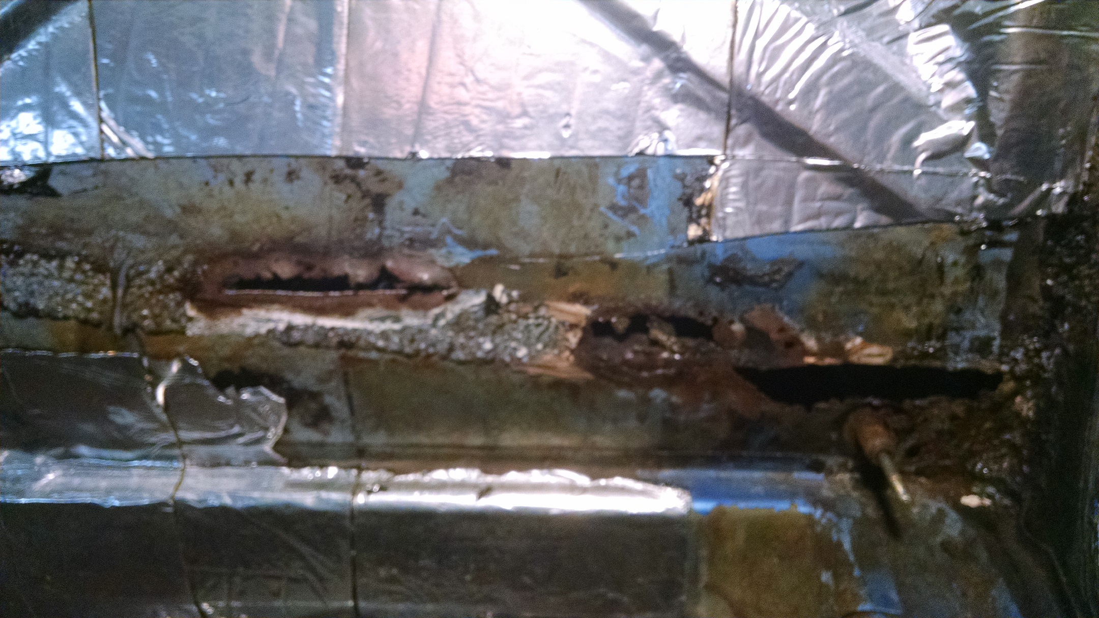

Another fuzzy picture, dang, gotta figure out what's up with my phone.
Found rust and will take care of that while I'm here.
Looks like a long term window leak in combo with plugged drain hole. It's very localized which is good. But still sucks I gotta cut it out and patch it.
