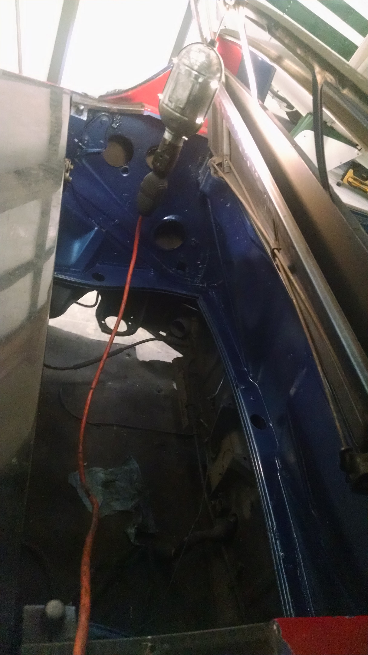

Done enough with the engine bay. Lots and lots of welding, grinding, cleaning etc.
I'm not fixing the oversized 914-6 oil tank holes. They are what they are.
