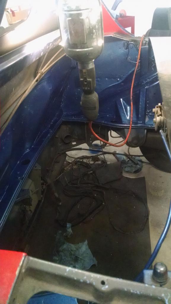

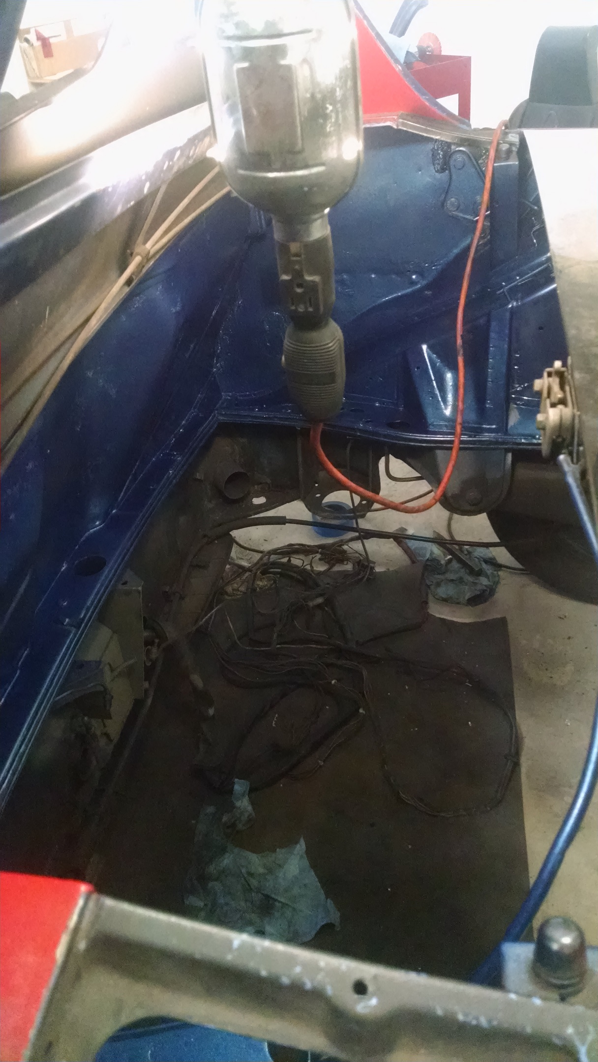

Found a color in spray can that was sort of close to the Anacona Blue. This isn't that type of 914 that it matters if the color is a bit off. Going to drench it all again with a third coat and call it good.
Found fiberglass patching which had to cut out and replace with metal. Also had to put rear trunk springs back in and remove the shock trunk kit along with welding up holes.
This was a former AC car, there was was a lot of patch work already done. It was so-so, tried to clean it up a bit.
Hoping I can get the engine back in with all the correct 914-6 conversion, cleaned up wiring, oil lines, factory heater boxes and much more before it goes off to paint.
We'll see, I have about another week or so.
