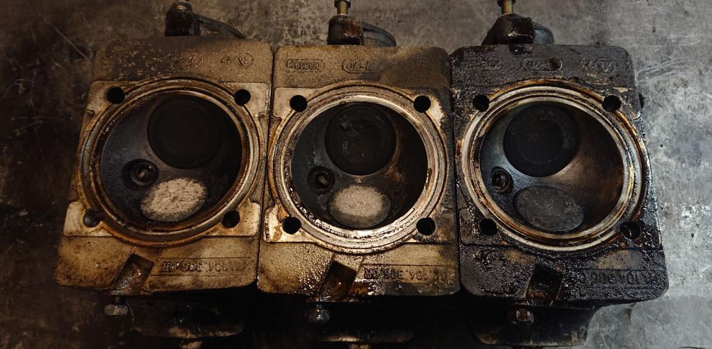

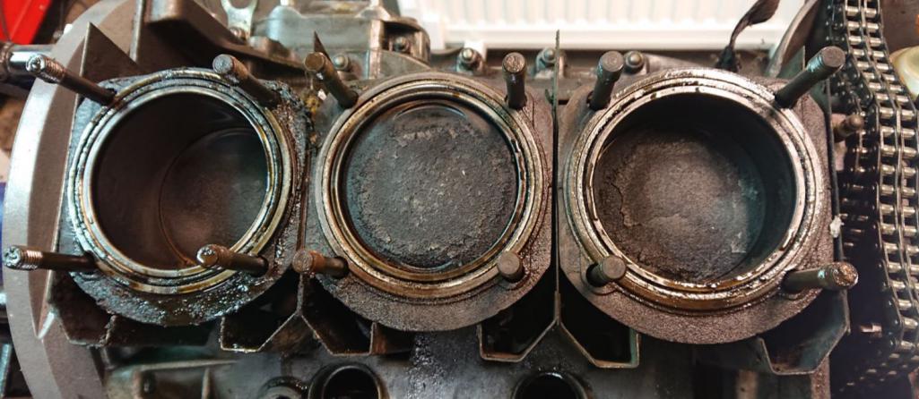

I did not want to put the engine in the car and end up with a major problem and as I enjoy taking things apart....... did I make the right decision and what do these picture tell the initiated?
Heads 1 to 3 from left to right

DavidSweden   I have started to check over the 911T engine befor...   May 16 2021, 10:52 AM
horizontally-opposed   Unfortunately the results were worse than terrib...   May 16 2021, 11:09 AM
mepstein   Do a top end on the engine. Not crazy expensive an...   May 16 2021, 11:57 AM
flyer86d   I agree with Pete and Mark. Get the heads done, ge...   May 16 2021, 03:01 PM
rgalla9146   The engine pictured went from 1. 137 ...   May 16 2021, 03:15 PM
mepstein   Listen to Rory. Doesn’t hurt to try.   May 16 2021, 03:39 PM
horizontally-opposed   Listen to Rory. Doesn’t hurt to try. :agree:   May 16 2021, 06:11 PM
porschetub   My 2.2t engine started like that after sitting 18y...   May 16 2021, 09:35 PM
Optimusglen   There are some 2.2T heads in the classifieds right...   May 17 2021, 05:53 AM
DavidSweden   Thanks for sharing all the good advice/knowledge I...   May 23 2021, 02:05 PM
mb911   Looks like it needed some new seals anyway   May 24 2021, 06:34 AM
Retroracer   I think you did the right thing FWIW. Lots of car...   May 24 2021, 01:05 PM
mepstein   I think you did the right thing FWIW. Lots of ca...   May 24 2021, 01:56 PM
