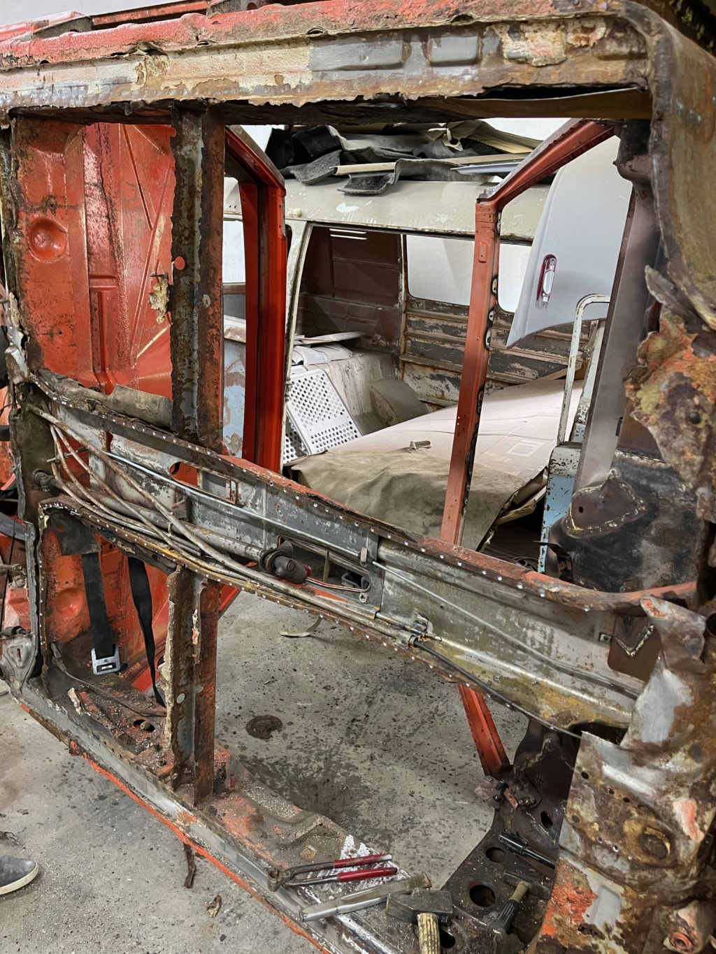

mb911   Are you brazing it all?   Apr 28 2021, 09:04 AM
peteyd   Are you brazing it all? I hope this is not the ...   Apr 28 2021, 10:06 AM
KBMC1304   [quote name='mb911' post='2911657' date='Apr 28 2...   Apr 28 2021, 11:30 AM
mb911   Just keep in mind brazing is much like a glue and ...   Apr 28 2021, 11:55 AM
KBMC1304   Just keep in mind brazing is much like a glue and...   Apr 28 2021, 02:48 PM

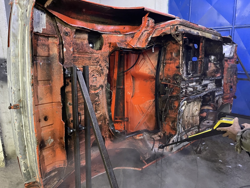

rgalla9146   Your car has great potential but needs much care. ...   May 9 2021, 06:24 PM
SirAndy   It is advisable to stabilize the door openings (a...   May 10 2021, 11:20 AM
KBMC1304   Your car has great potential but needs much care....   May 10 2021, 03:52 PM

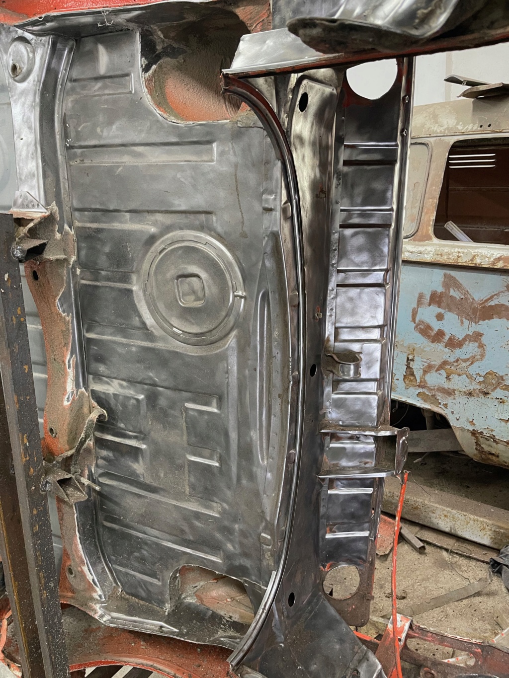

rgalla9146   Is it just me or do those floors look a bit unusua...   May 10 2021, 06:11 PM
KBMC1304   Is it just me or do those floors look a bit unusu...   May 11 2021, 05:10 PM
rgalla9146   Looks right now. The other picture was from an ...   May 11 2021, 06:43 PM

jcambo7   With no door bracing from what I can see, what are...   May 20 2021, 02:13 PM
SirAndy   With no door bracing from what I can see, what ar...   May 20 2021, 02:22 PM
KBMC1304   With no door bracing from what I can see, what ar...   May 23 2021, 05:33 PM
