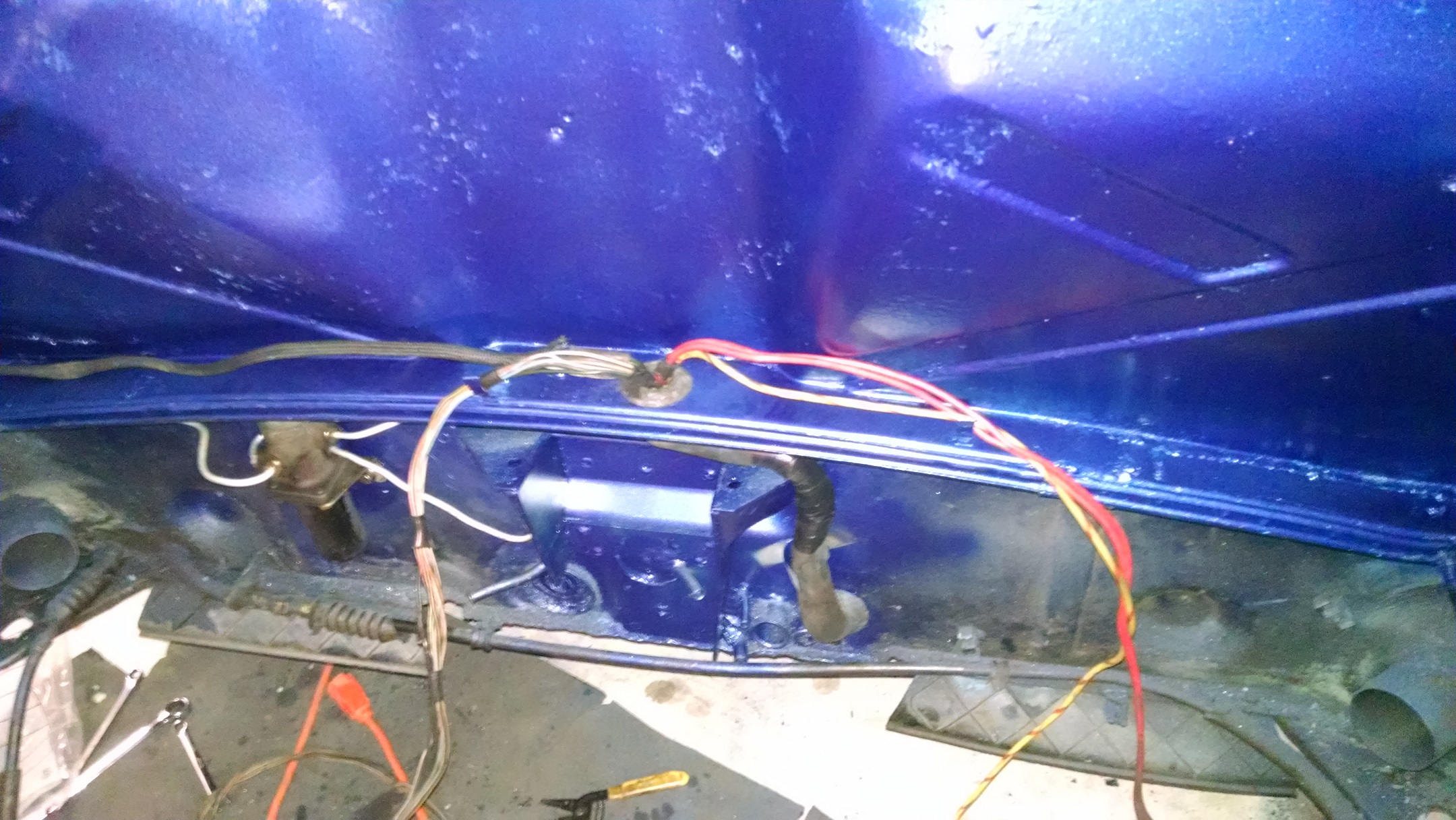

Moved the Brake Pressure Regulator, new lines from PMB made that pretty easy. Worked on cleaning up wiring, it was pretty messy. Around the engine still is.
You can see a patch on the engine shelf to the right were the dealer AC once was. I left most of that stuff alone. It's not perfect, but it's solid and just fine.
Getting closer to installing the engine. Waiting on SS fuel lines.
