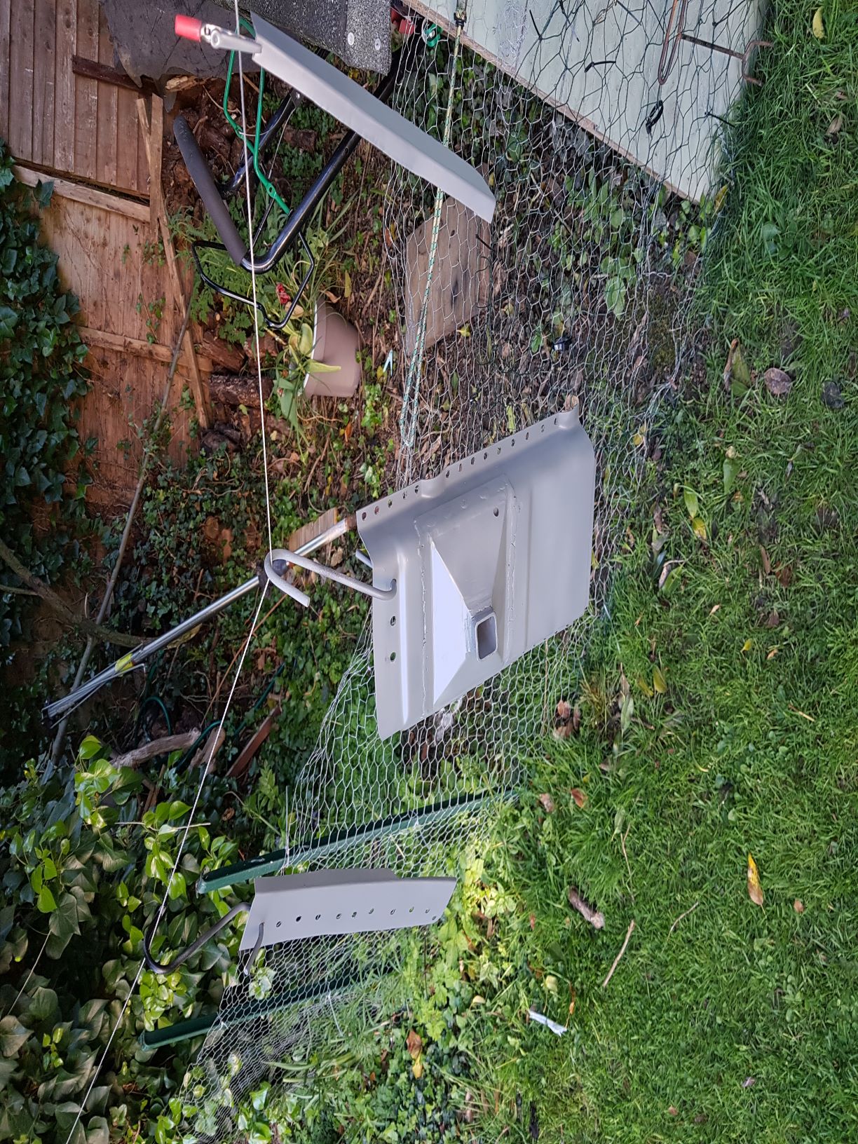

Just the left side rocker left to weld, going to push on and get it done this weekend, will be glad to move on from it. finished prepping the repair panels today so just need some goods weather, then on to prepping for paint, and motor build.

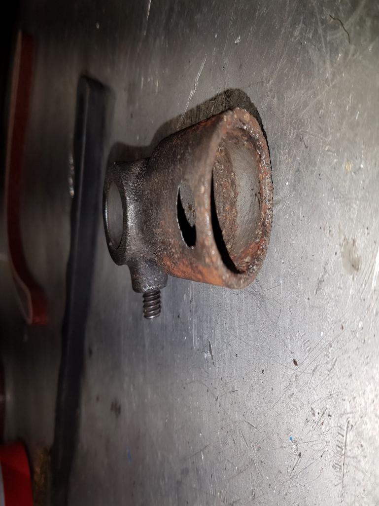

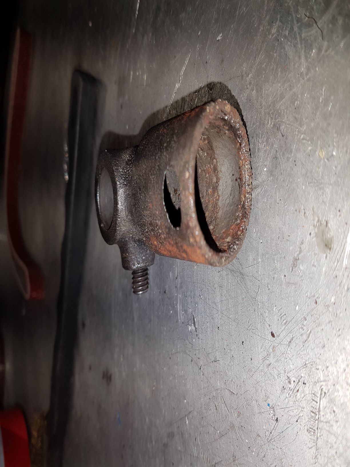

I found the shift rod head has some done some self lightening, was going to weld up but how much of an issue is that whole and the now missing grove on the inside to operation?Attached ImageAttached Image
