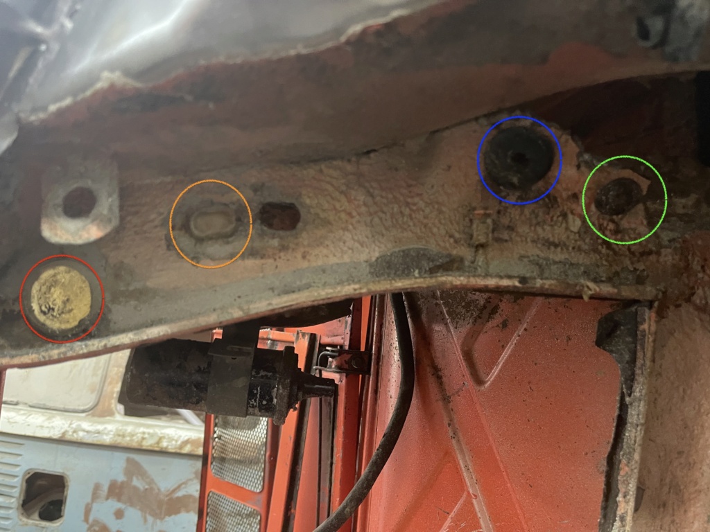

KBMC1304   http://www.914world.com/bbs2/uploads_offsite/i22.s...   May 27 2021, 03:19 PM
KBMC1304   http://www.914world.com/bbs2/uploads_offsite/i.ser...   May 27 2021, 03:45 PM
rgalla9146   The blue circled hole is not original. The green...   May 27 2021, 03:55 PM
Root_Werks   Red circle = factory plugged rain tray drain? On ...   May 27 2021, 05:27 PM
rgalla9146   Red circle = factory plugged rain tray drain? On...   May 28 2021, 05:52 AM
ClayPerrine   Red circle = factory plugged rain tray drain? O...   Jun 2 2021, 01:34 PM
