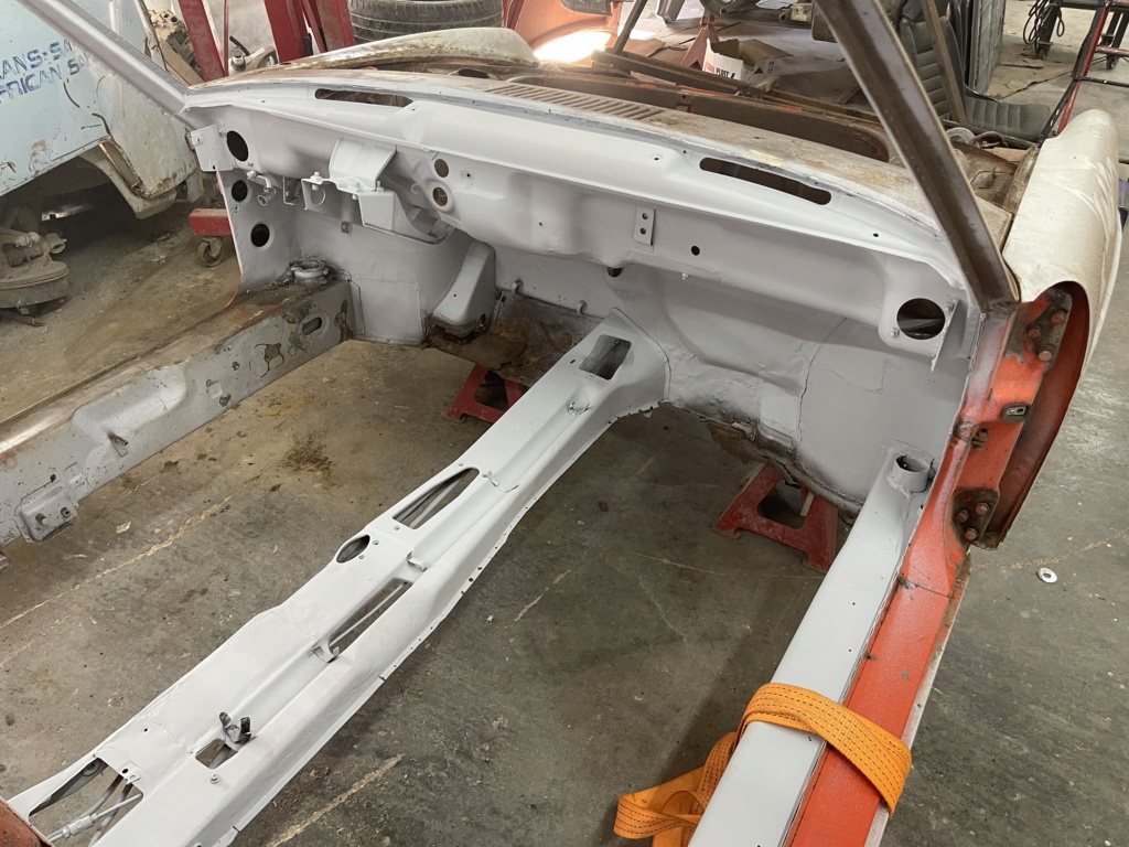

rgalla9146   Your car has great potential but needs much care. ...   May 9 2021, 06:24 PM
SirAndy   It is advisable to stabilize the door openings (a...   May 10 2021, 11:20 AM
KBMC1304   Your car has great potential but needs much care....   May 10 2021, 03:52 PM

jcambo7   With no door bracing from what I can see, what are...   May 20 2021, 02:13 PM
SirAndy   With no door bracing from what I can see, what ar...   May 20 2021, 02:22 PM
KBMC1304   With no door bracing from what I can see, what ar...   May 23 2021, 05:33 PM

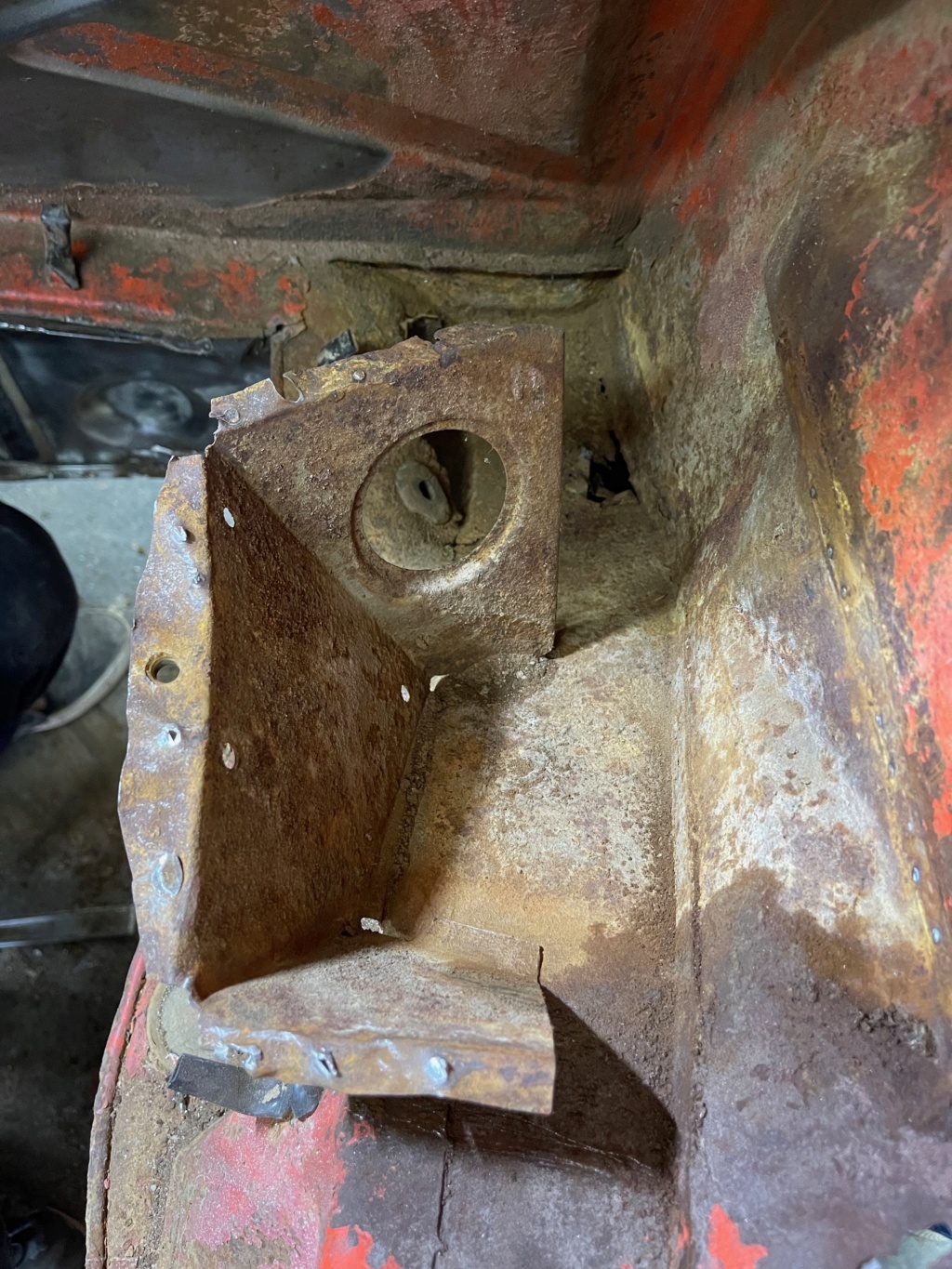

rgalla9146   The blue circled hole is not original. The green...   May 27 2021, 03:55 PM
Root_Werks   Red circle = factory plugged rain tray drain? On ...   May 27 2021, 05:27 PM
rgalla9146   Red circle = factory plugged rain tray drain? On...   May 28 2021, 05:52 AM
ClayPerrine   Red circle = factory plugged rain tray drain? O...   Jun 2 2021, 01:34 PM
