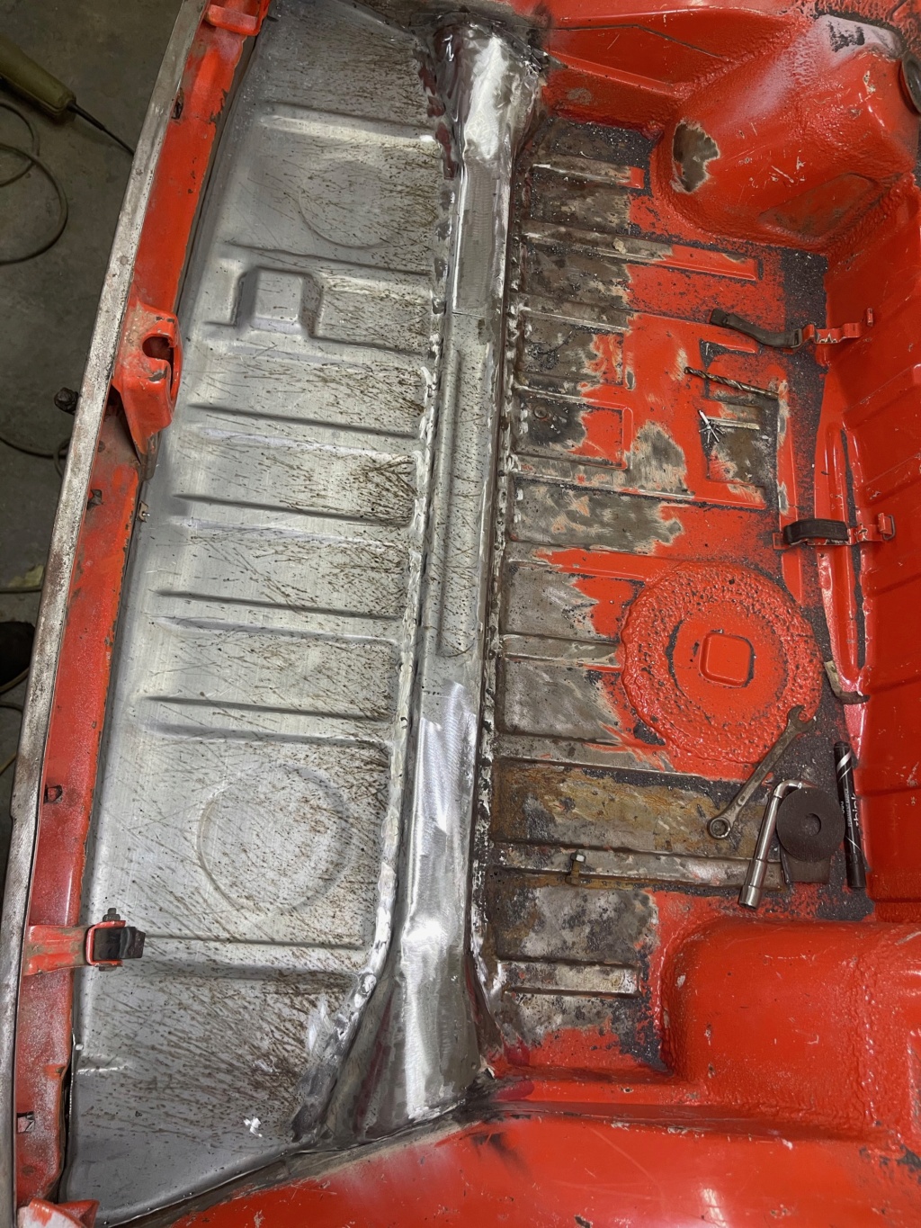

mb911   Are you brazing it all?   Apr 28 2021, 09:04 AM
peteyd   Are you brazing it all? I hope this is not the ...   Apr 28 2021, 10:06 AM
KBMC1304   [quote name='mb911' post='2911657' date='Apr 28 2...   Apr 28 2021, 11:30 AM
mb911   Just keep in mind brazing is much like a glue and ...   Apr 28 2021, 11:55 AM
KBMC1304   Just keep in mind brazing is much like a glue and...   Apr 28 2021, 02:48 PM

rgalla9146   Your car has great potential but needs much care. ...   May 9 2021, 06:24 PM
SirAndy   It is advisable to stabilize the door openings (a...   May 10 2021, 11:20 AM
KBMC1304   Your car has great potential but needs much care....   May 10 2021, 03:52 PM
VegasRacer   Trans Sahara African Safari. ? Was that a tour gro...   May 10 2021, 04:16 PM
KBMC1304   Trans Sahara African Safari. ? Was that a tour gr...   May 10 2021, 04:49 PM
rgalla9146   Is it just me or do those floors look a bit unusua...   May 10 2021, 06:11 PM
KBMC1304   Is it just me or do those floors look a bit unusu...   May 11 2021, 05:10 PM
rgalla9146   Looks right now. The other picture was from an ...   May 11 2021, 06:43 PM

rgalla9146   The blue circled hole is not original. The green...   May 27 2021, 03:55 PM
Root_Werks   Red circle = factory plugged rain tray drain? On ...   May 27 2021, 05:27 PM
rgalla9146   Red circle = factory plugged rain tray drain? On...   May 28 2021, 05:52 AM
ClayPerrine   Red circle = factory plugged rain tray drain? O...   Jun 2 2021, 01:34 PM
