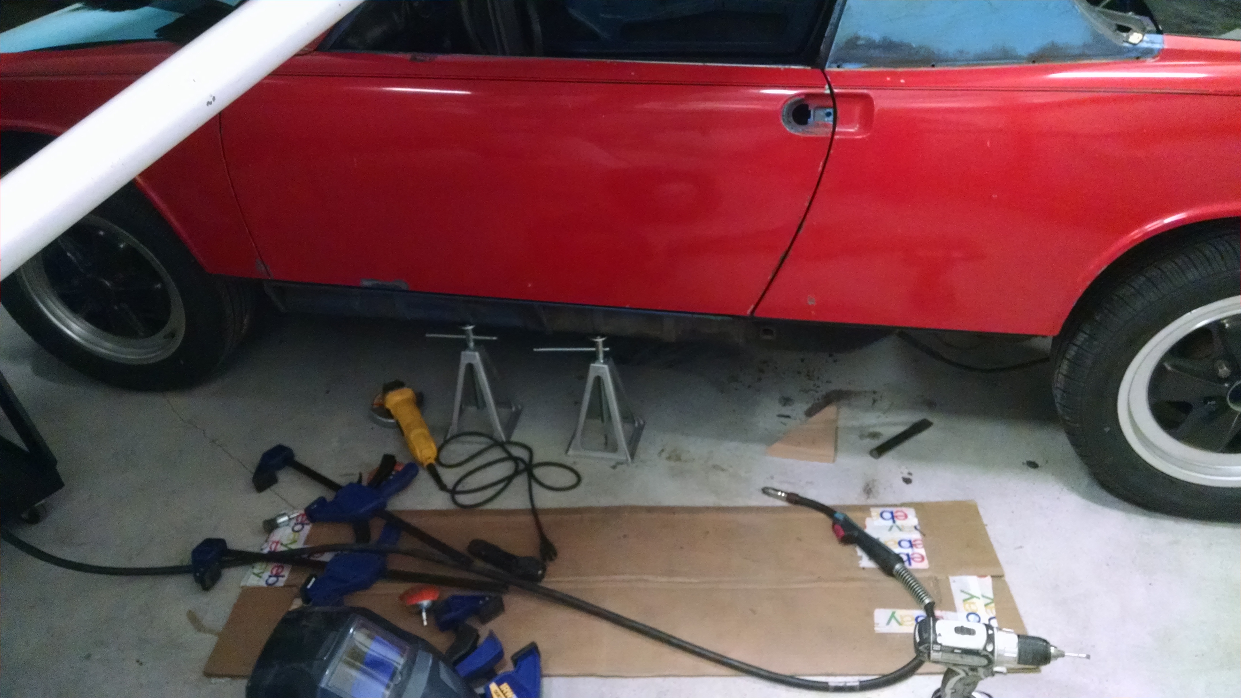

Started installing MD's inner long stiffening kit. Totally forgot how much work it is. Note the little RV jacks to keep door gaps as perfect as possible:

Root_Werks   Started installing MD's inner long stiffening ...   Jun 9 2021, 10:00 PM
Root_Werks   Hardest part is keeping metal tight against long. ...   Jun 9 2021, 10:04 PM

Root_Werks   Finished up the inner longitudinal stiffening kit ...   Jun 11 2021, 09:44 AM
