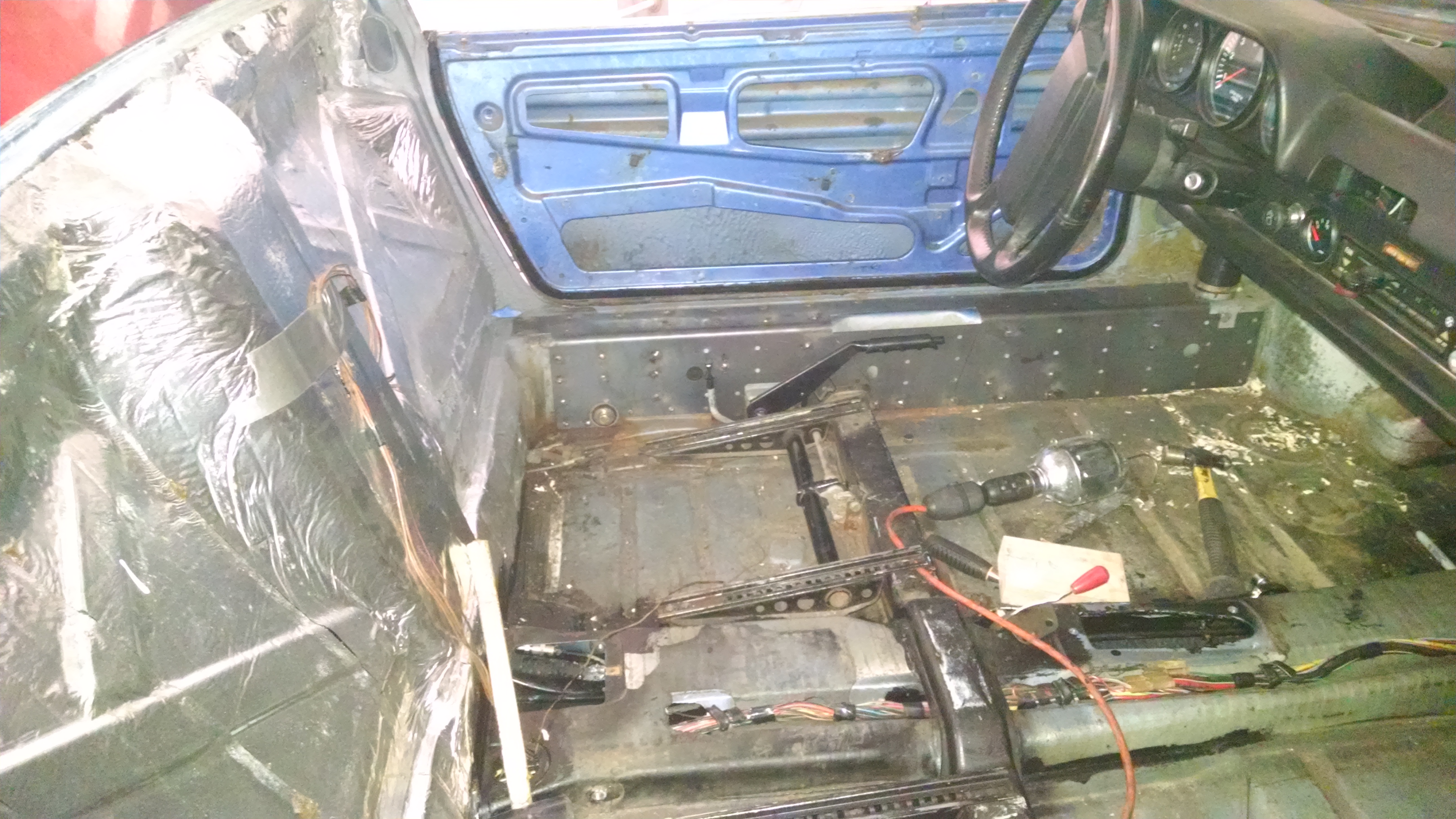

Root_Werks   Started installing MD's inner long stiffening ...   Jun 9 2021, 10:00 PM
Root_Werks   Hardest part is keeping metal tight against long. ...   Jun 9 2021, 10:04 PM
