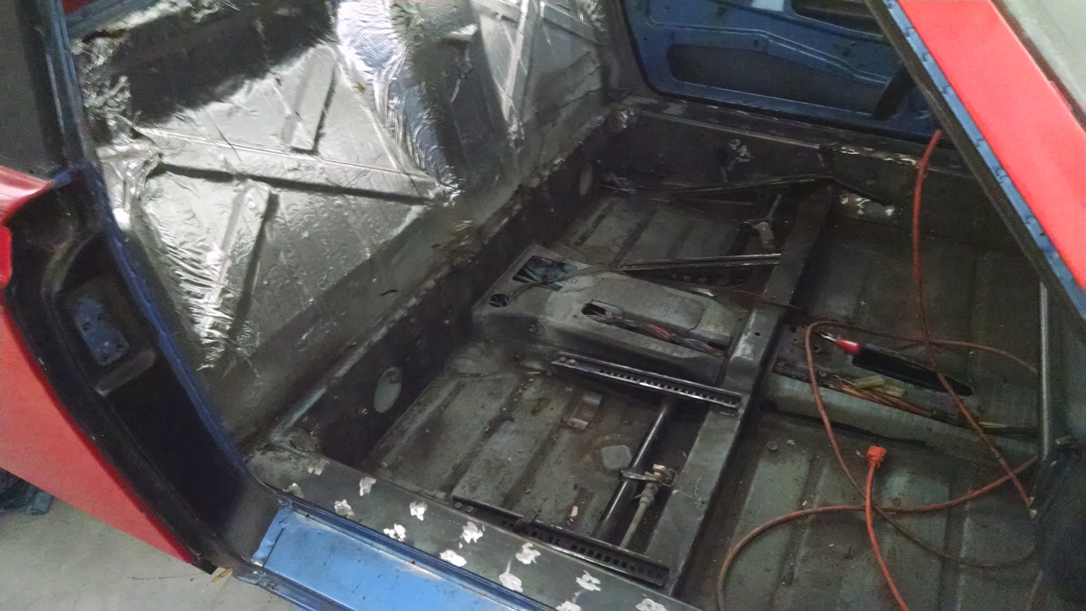

Finished up the inner longitudinal stiffening kit installation last night. This is the 3rd or 4th one of these installed and I've learned a bit each time. Still took me 6-7 hours to do, but it's totally worth it. The reduction in body flex is dramatic when doing the "but test".
I also remember how much less cowl shake there would be when going over bumps or RR track crossings. Very excited to have this done.
