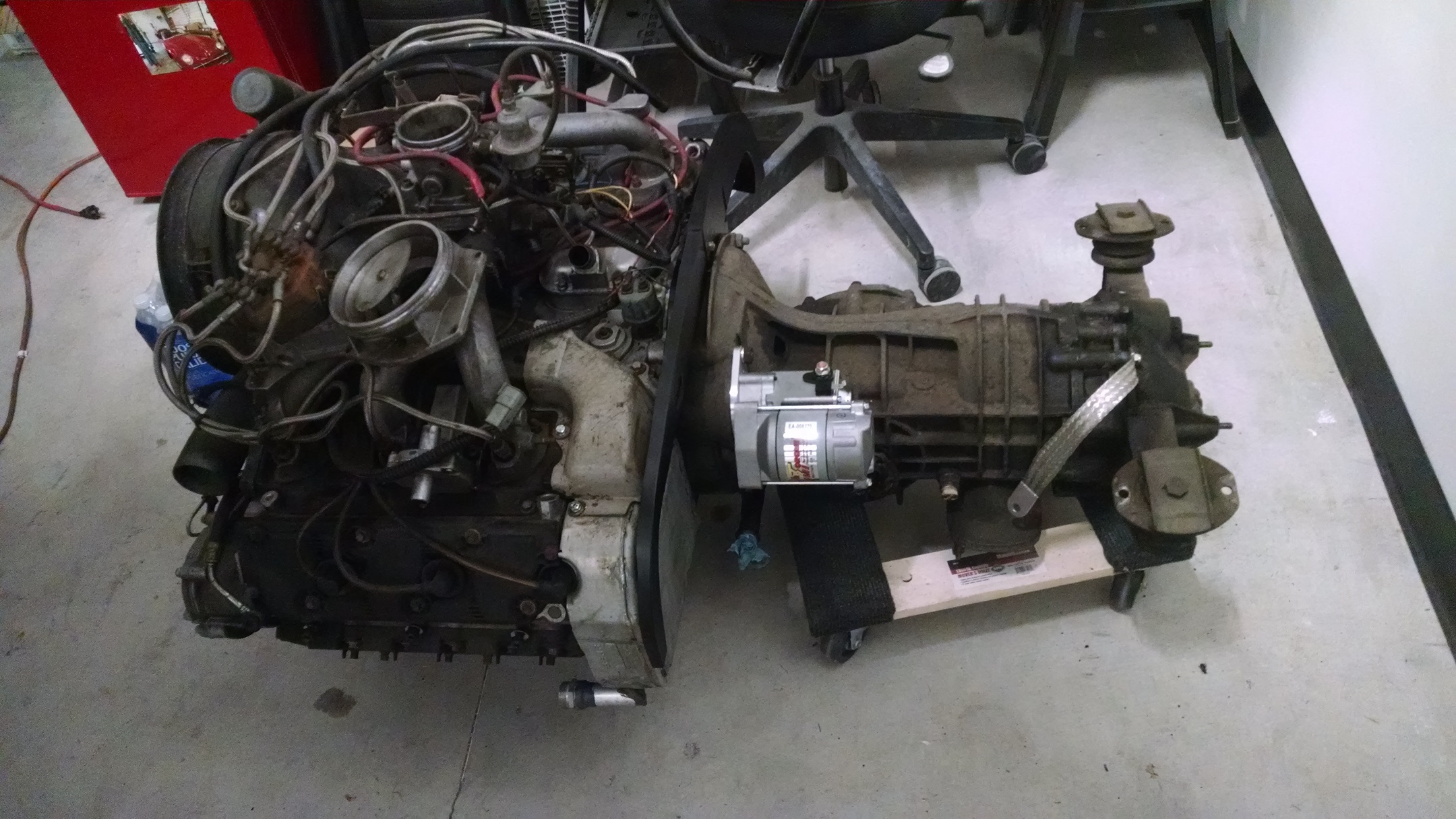

Quick shot of the new Hi-Torque starter, ground cable, correctly modified cooler from Ben and part of actual repo 914-6 engine tin. Whole engine needs re-wired. The wiring is correct, but messy, really messy. Maybe I can clean it up? On this, starting from scratch might be easier. I'll have time once the 914 goes in for paint.
