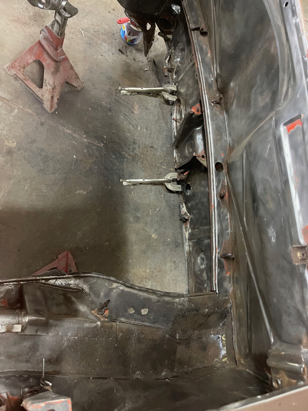

rgalla9146   The blue circled hole is not original. The green...   May 27 2021, 03:55 PM
Root_Werks   Red circle = factory plugged rain tray drain? On ...   May 27 2021, 05:27 PM
rgalla9146   Red circle = factory plugged rain tray drain? On...   May 28 2021, 05:52 AM
ClayPerrine   Red circle = factory plugged rain tray drain? O...   Jun 2 2021, 01:34 PM

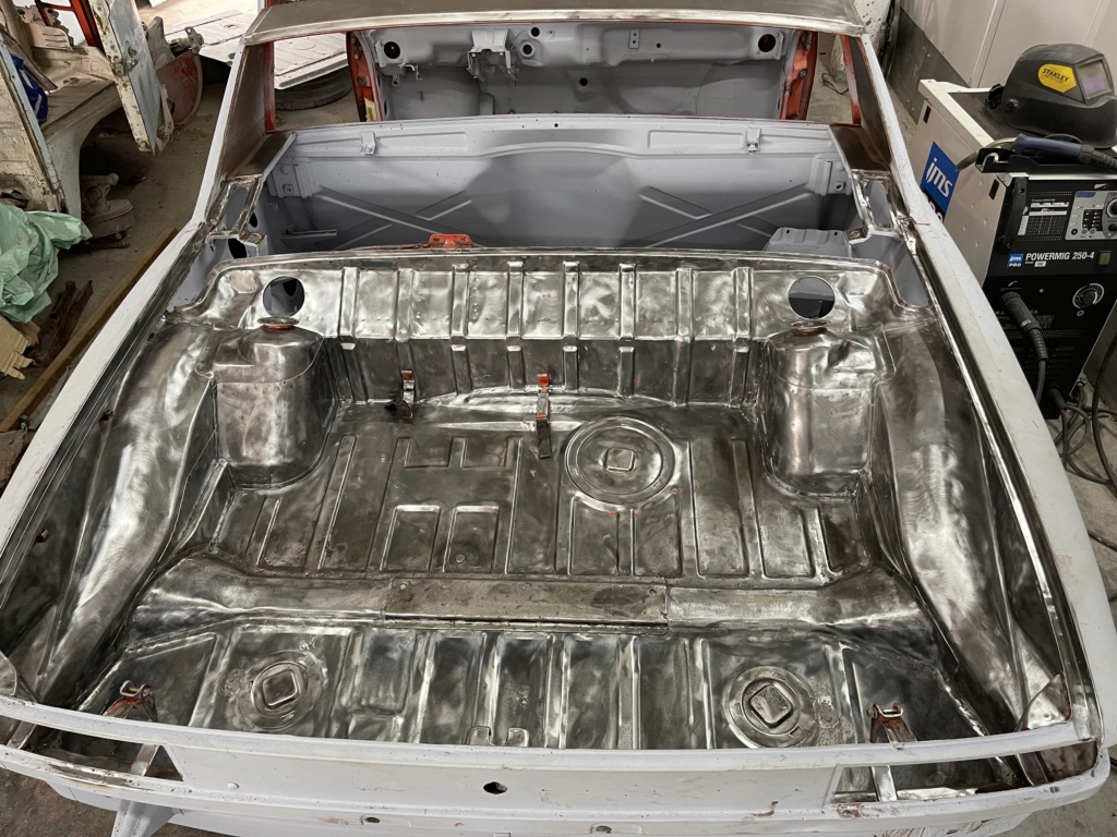

tazz9924   what are you using to take the paint off? seems to...   Jun 3 2021, 03:32 AM
KBMC1304   what are you using to take the paint off? seems t...   Jun 3 2021, 04:48 PM
