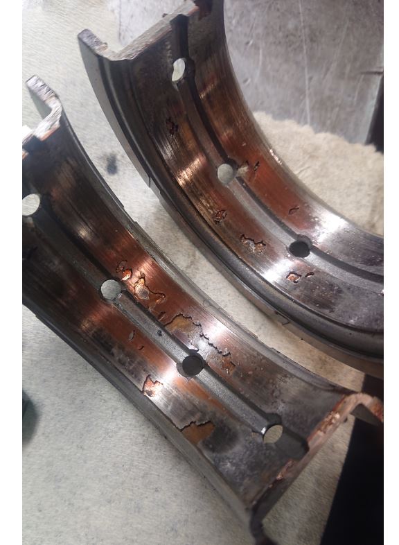

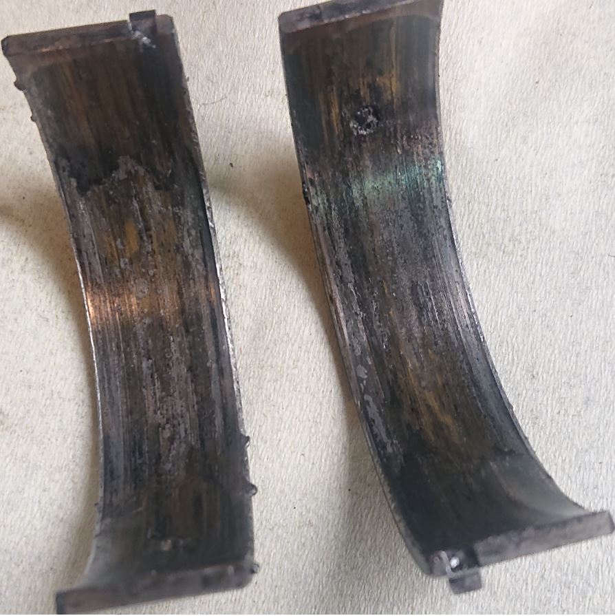

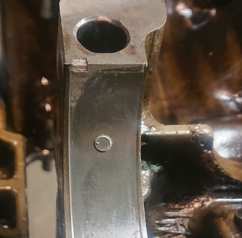

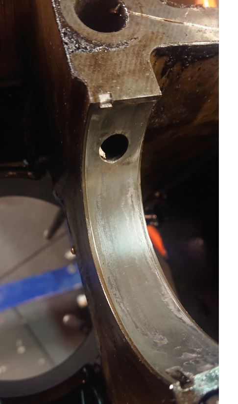

After the problems I discovered with the heads, I could not stop myself splitting the case and I found more problems.
The thrust bearing at the flywheel end was toast, big pieces missing, on the positive side there does not appear to be any damage to the case or crank. What would cause this type of bearing failure?
What was a bit worse was one that the number 6 bearing had rotated in the case, the oil hole in the bearing shell was full with what looked like metal (molten from the bearing?) and both bearing tags have cut into the case, there is also a round metal deposit on the bearing seat in the case (deposited through the oil hole in the bearing shell) this is probably more molten bearing metal?
Can anyone tell me how serious this damage is?
Thanks in advance.

porschetub   After the problems I discovered with the heads, I...   Jun 20 2021, 02:55 PM
mepstein   Get a quote from your machine shop and go from the...   Jun 20 2021, 03:34 PM
Retroracer   Get a quote from your machine shop and go from th...   Jun 20 2021, 08:56 PM
porschetub   Get a quote from your machine shop and go from th...   Jun 20 2021, 10:49 PM
sixnotfour   Rod Bearings have to be worse...   Jun 20 2021, 04:19 PM
Shivers   Well bummer, sorry dude. I love those little short...   Jun 20 2021, 04:45 PM
ClayPerrine   The 2.2T is a mag case, so I would consider it a d...   Jun 20 2021, 06:59 PM
DavidSweden   Bad news from the machine shop it looks like the 2...   Jul 8 2021, 11:32 AM
mepstein   I’m pretty sure I have one. I’ll check at the ...   Jul 8 2021, 12:25 PM
ClayPerrine   I have a serviceable 2.4T crankcase. The only dif...   Jul 8 2021, 12:44 PM
