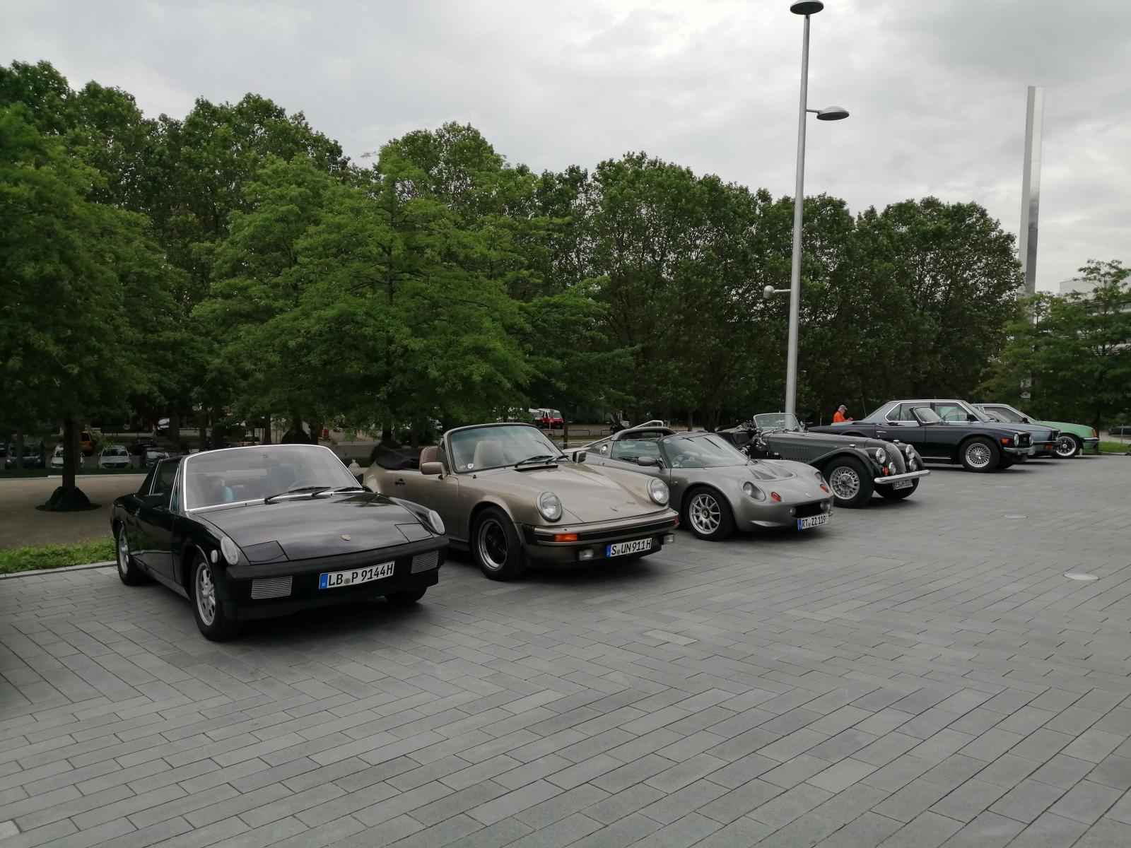

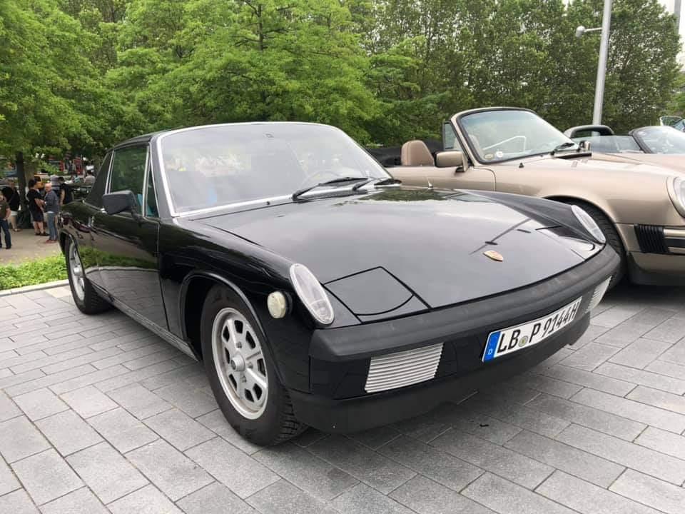

Took it out yesterday for a local Cars&coffee with my 5 years old boy, enjoyable time with him (IMG:style_emoticons/default/sunglasses.gif)
