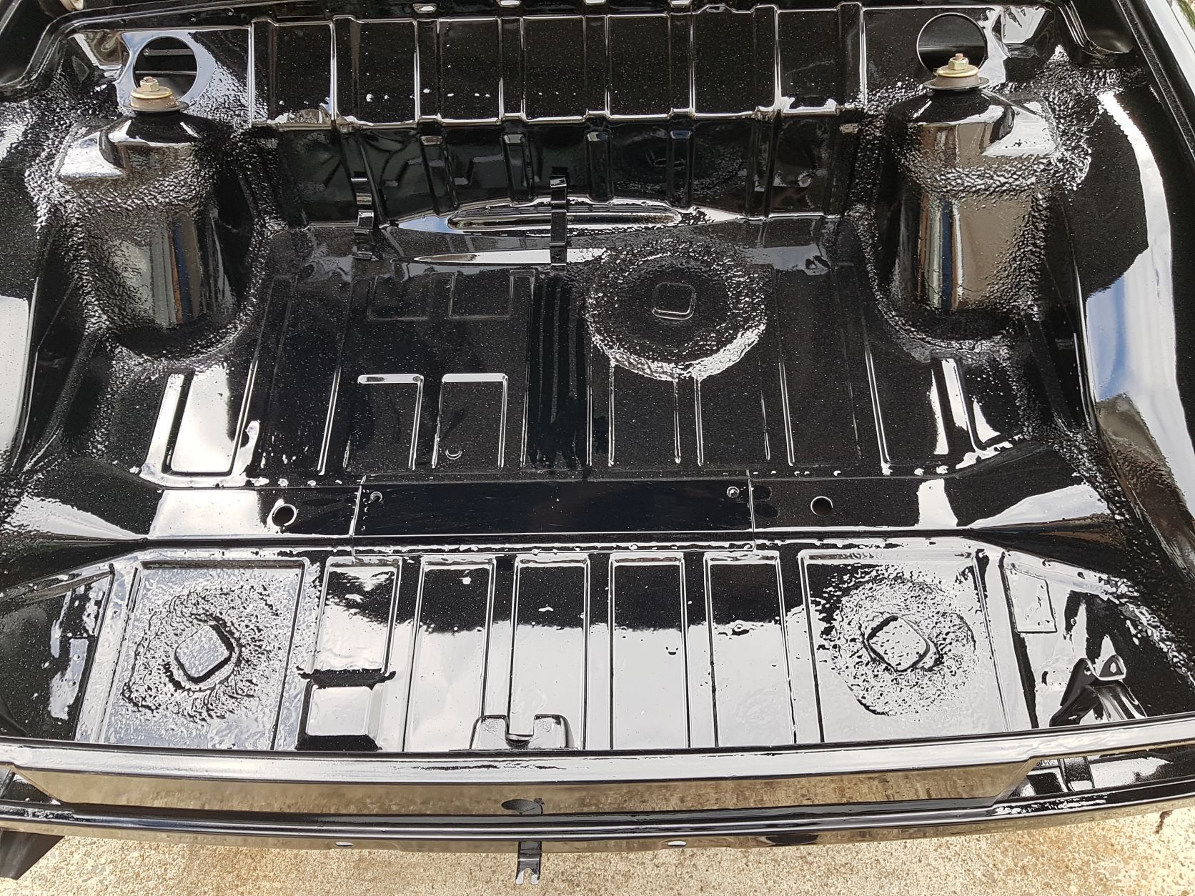

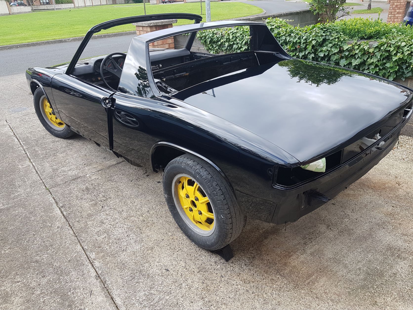

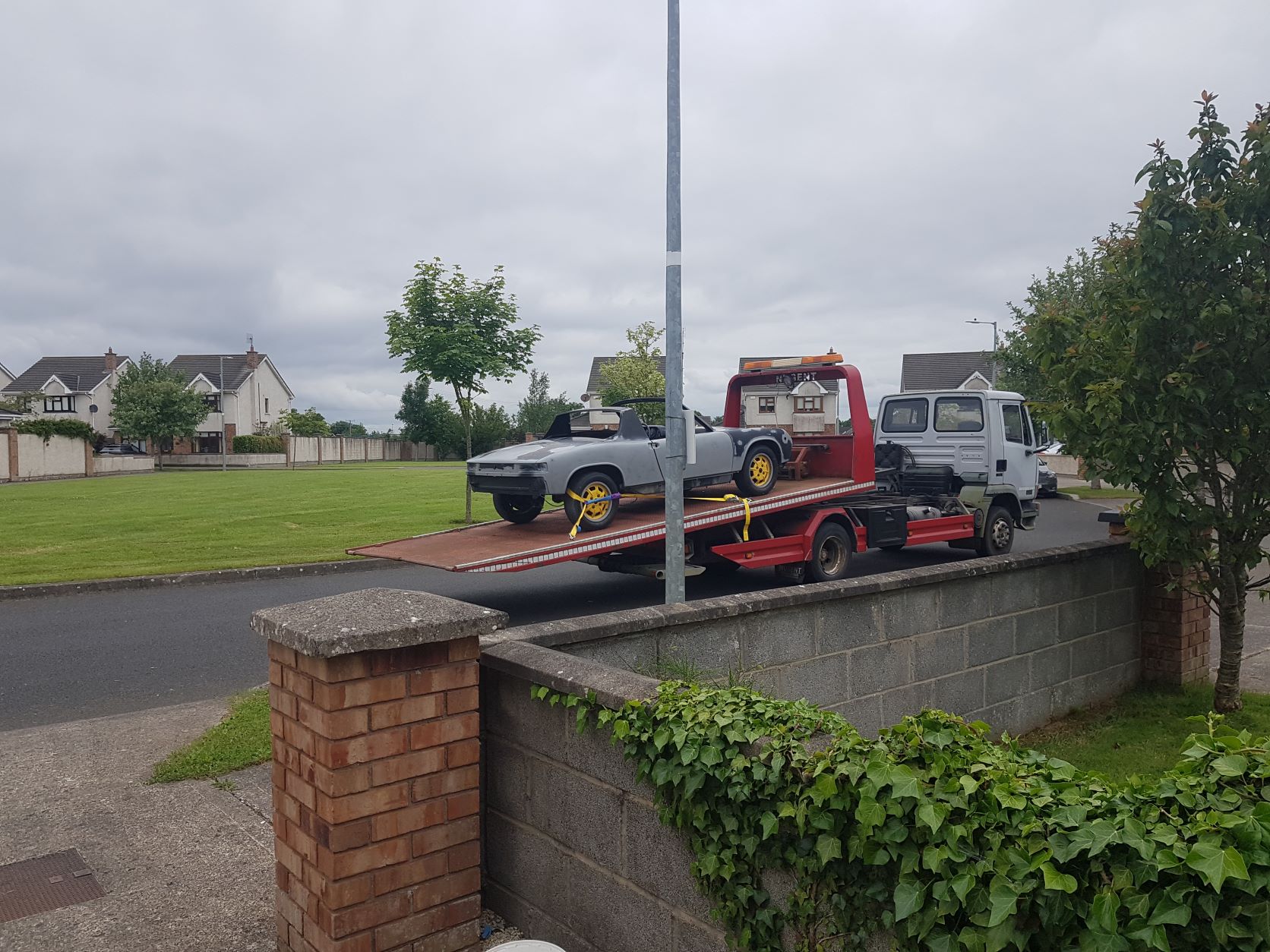

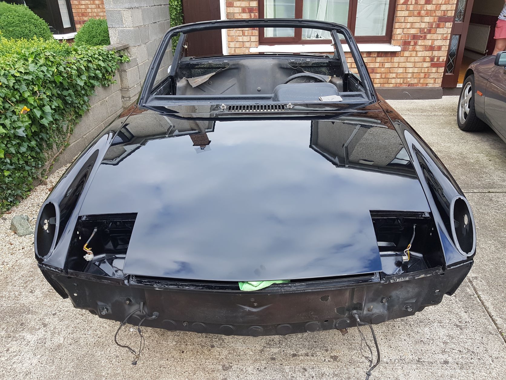

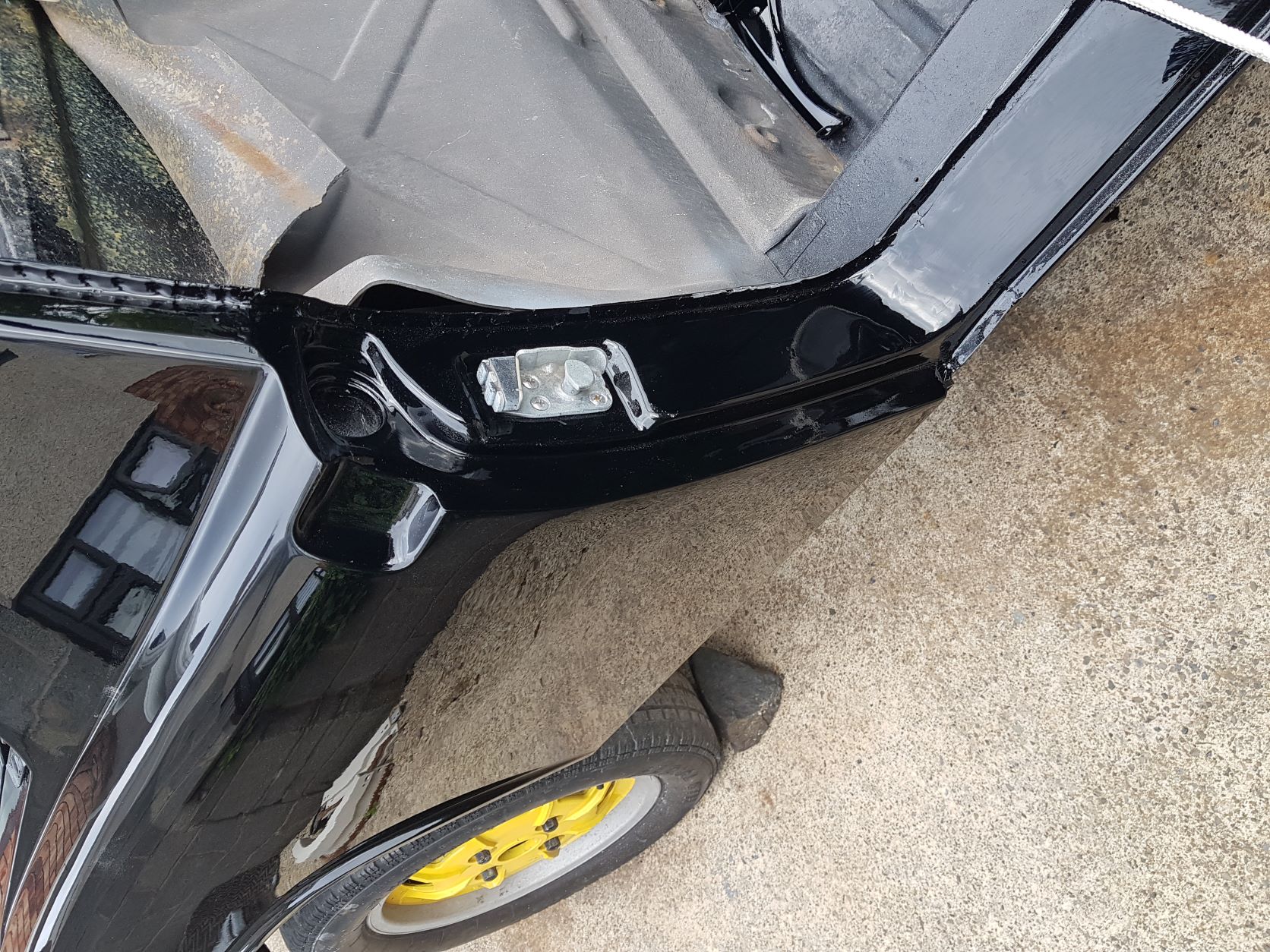

Well, car was off to paint last week, and today I have a shiny new shell back in the drive, very happy with the result. Particularly happy with the final look of the repaired door jam, good weather forecast so plan to do rear suspension this weekend. I progressed the engine build in the week it was away, will post some pics later but all going well I will get be putting case 1/2s together in the next few days as well. its great motivator to be putting things back on the car now!
