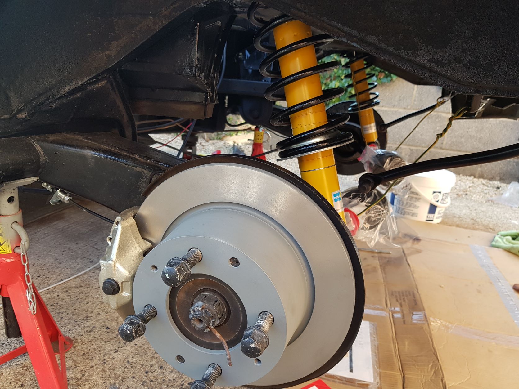

Having a great spell of weather here, so parked the engine build to carry on with work on the drive while it was in my favor. Got the rear suspension and brakes almost all done, just found I was missing the drop link bushings. Cleaned, re greased and repainted the drive shafts, will move up front next.
