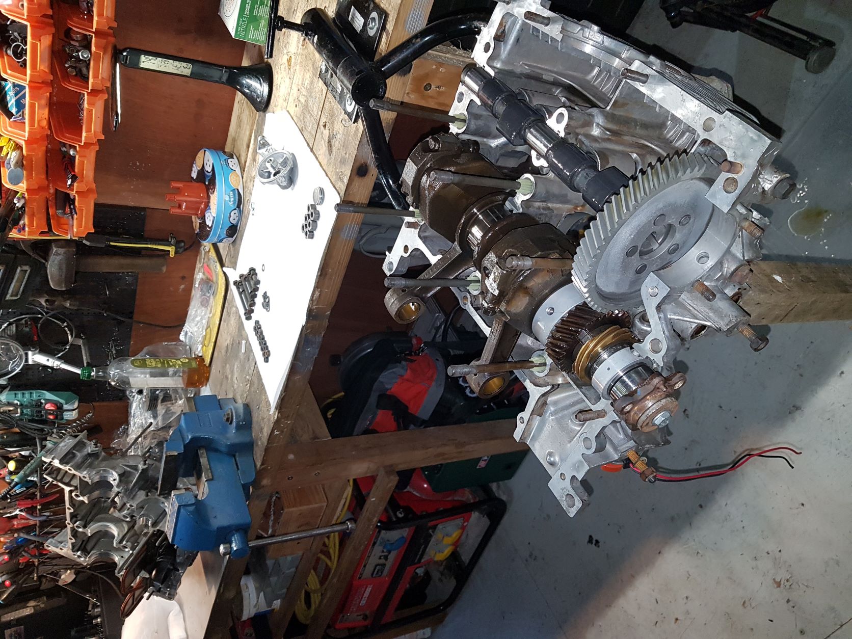

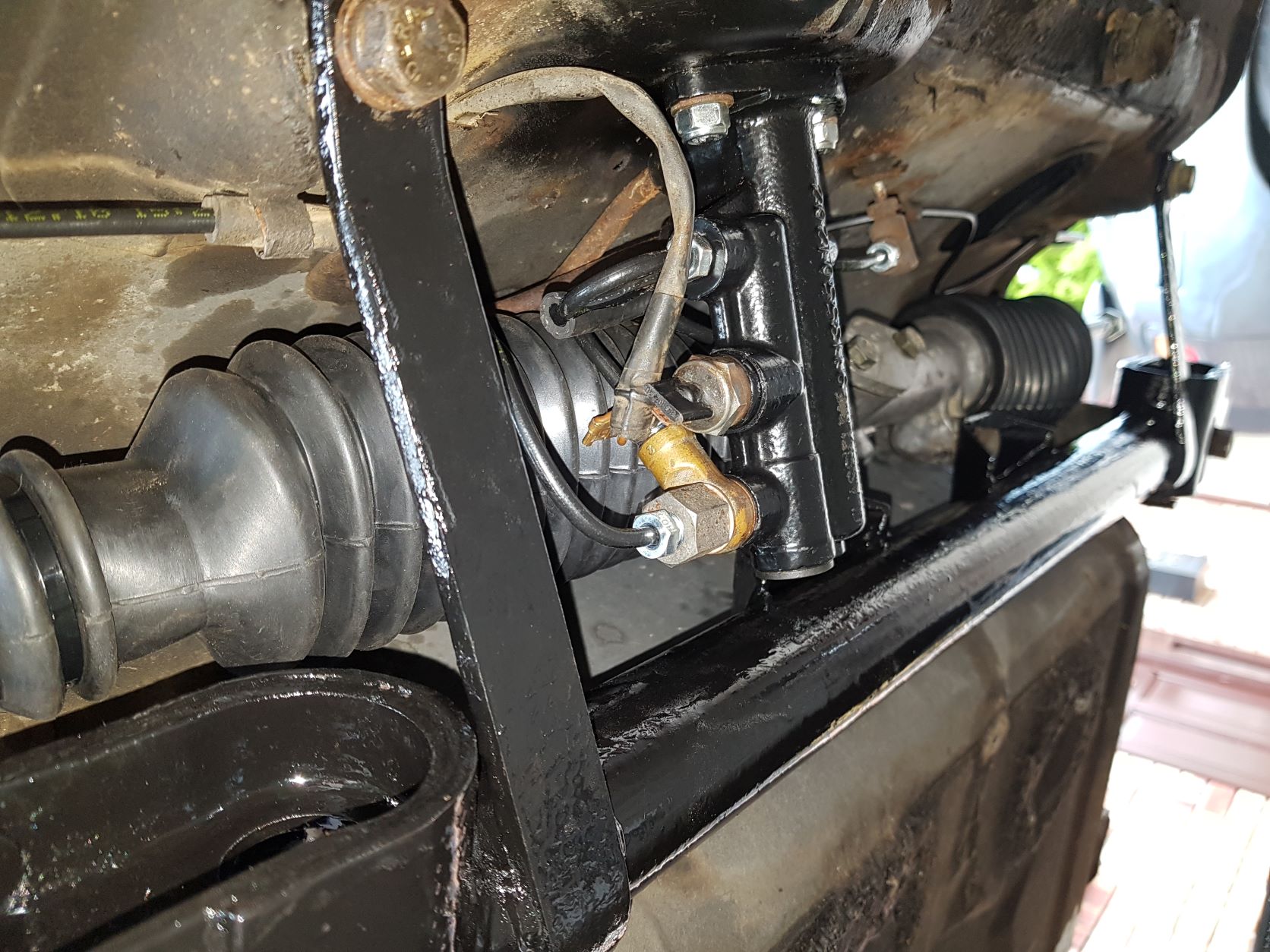

Got started on the front suspension last week, managed to clean and re-grease the rack, put on the new turbo tie rods, and do the MC and brake line install. The rest of the suspension was fighting me, looks original so have some ceased bolts to overcome. Raining this week, so returned to the the engine in the shed, all ready for big day tomorrow, mating the case halves. Attached Image Attached Image
