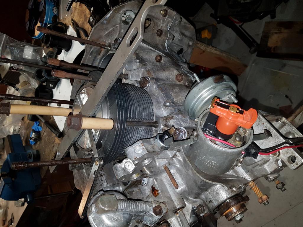

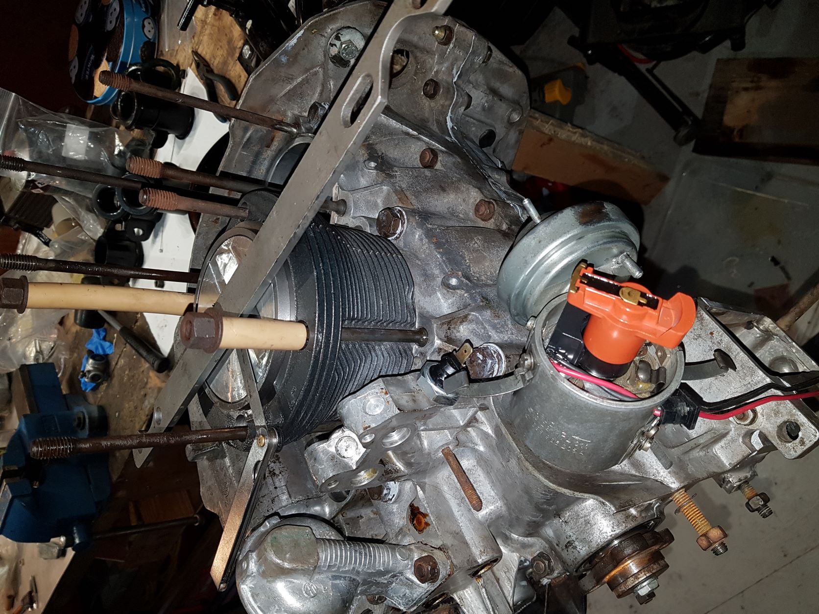

Got the short block together ok last week (IMG:style_emoticons/default/beer3.gif) awaiting on the heads from the machine shop, so just testing CR with the AA 96mm pistons. I'm at .65mm deck height which will be 8.9 CR from what I understand (assuming 3cc for dish and 57cc for stock heads) will check difference with shims that came in the gasket pack to see what difference I get next, I'm assuming I want to get it down a bit but will do some more reading.

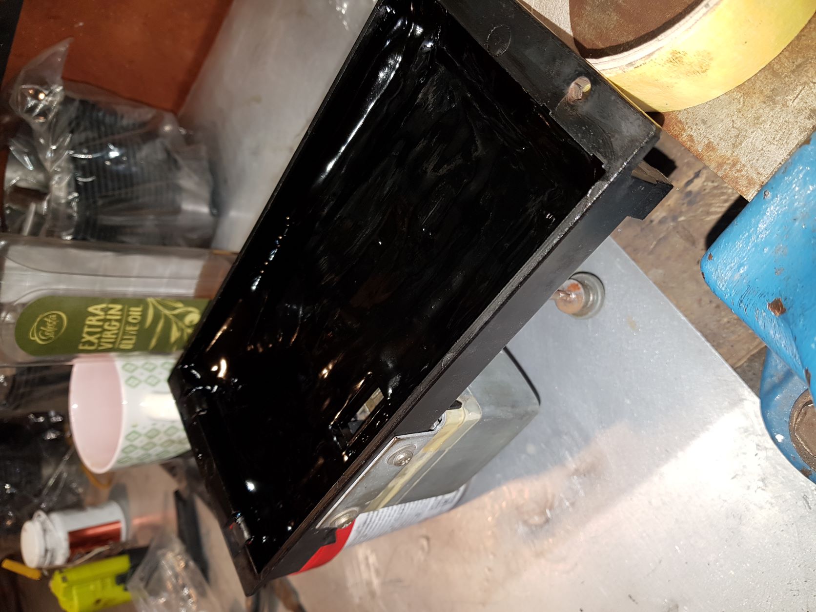

Also cleaning and soldered the replay board some time ago, but was unsure about re-potting, decided to use an underbody wax seal, which is very close to the original look and has benefit it can be removed like the original if ever needed. will just have to test how it does with heat after it driers for a few weeks.
