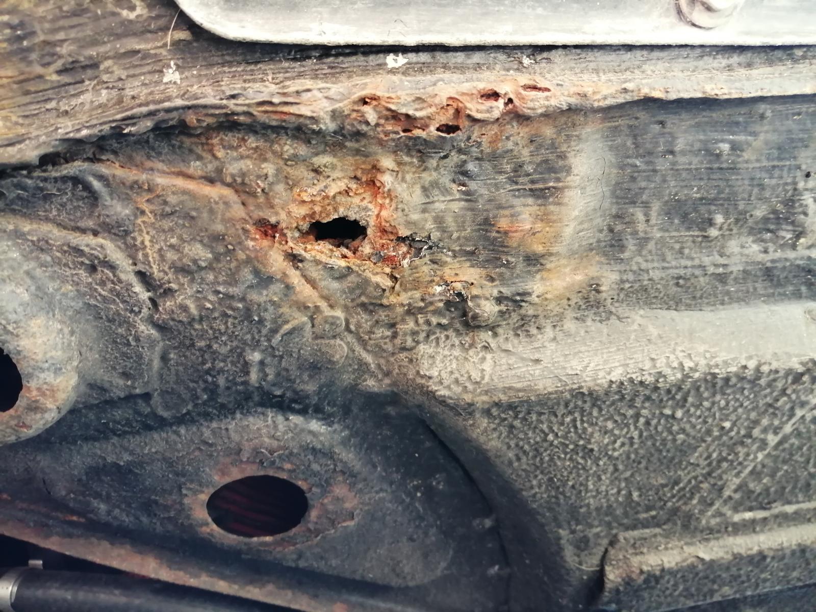

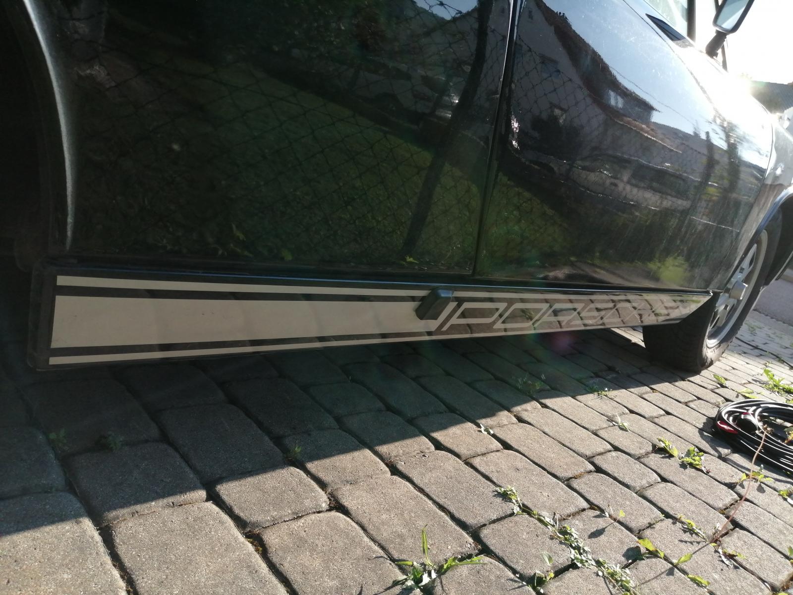

Which revealed some not so nice things.. Paint is showing some bubbles in some places.. And on some places more than just bubbles.. (IMG:style_emoticons/default/headbang.gif) Small examples:
(IMG:http://www.914world.com/bbs2/uploads_offsite/www.thesamba.com-24690-1628584207.1.jpg)
(IMG:http://www.914world.com/bbs2/uploads_offsite/www.thesamba.com-24690-1628584208.2.jpg)

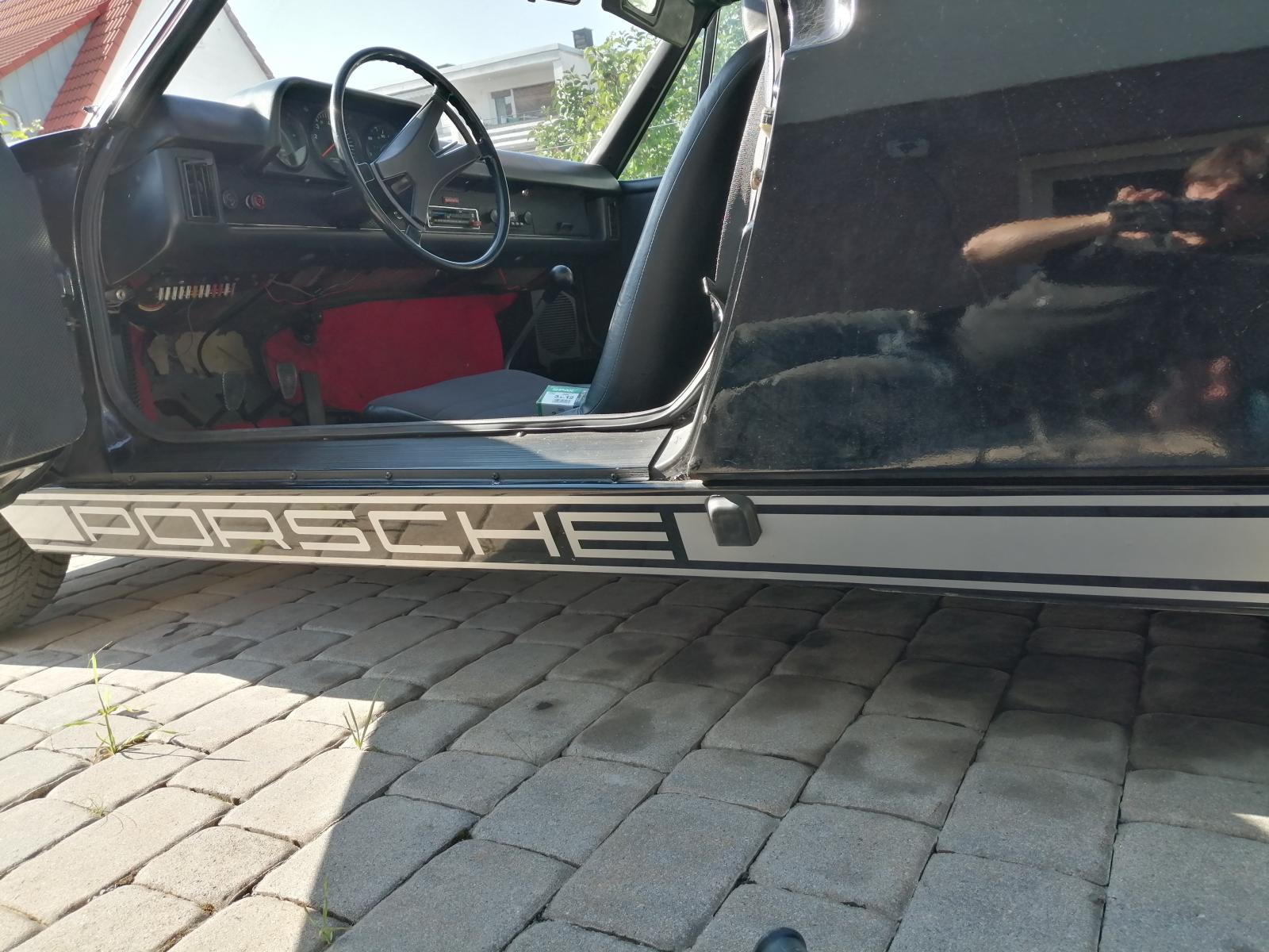

So... Let's remove the rockers (IMG:style_emoticons/default/rolleyes.gif)

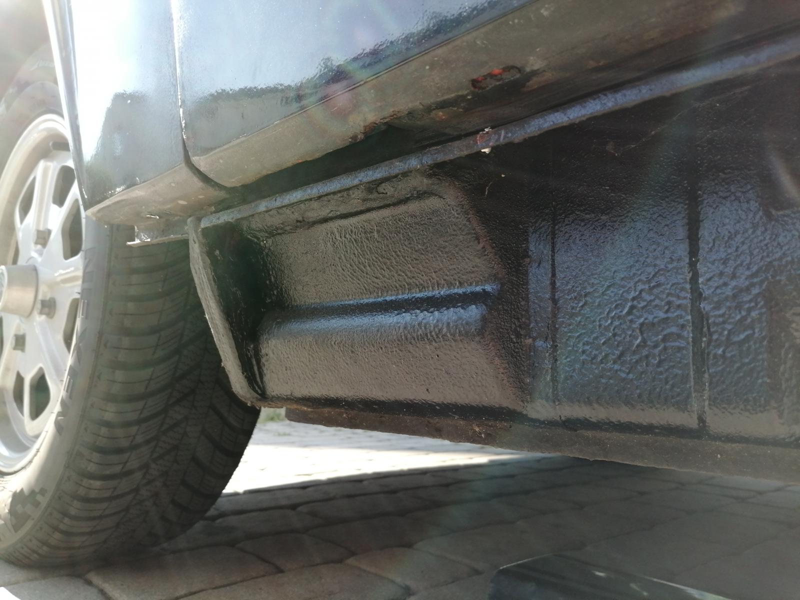

Driver's side:

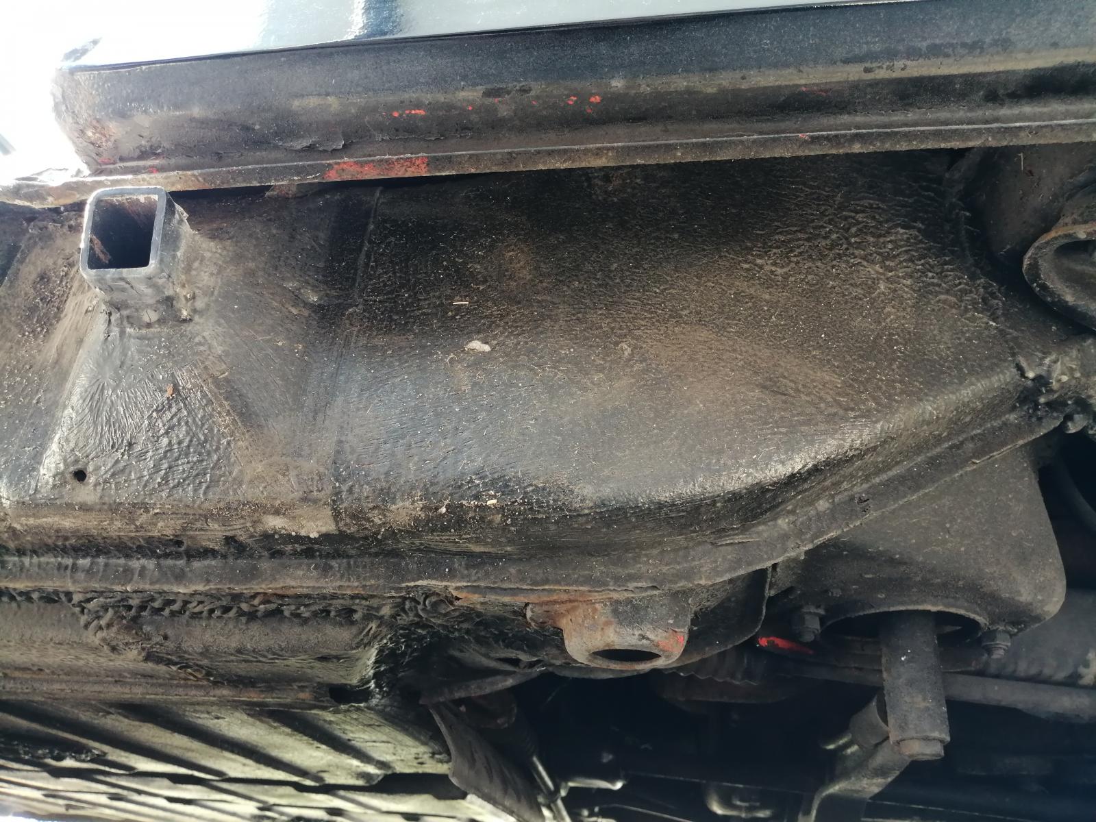

(IMG:http://www.914world.com/bbs2/uploads_offsite/www.thesamba.com-24690-1628584209.3.jpg)

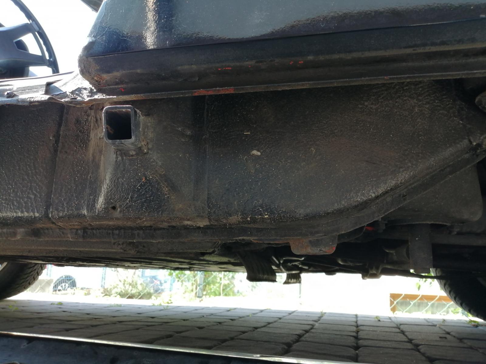

And under it no surprises, looks good (IMG:style_emoticons/default/aktion035.gif)
(IMG:http://www.914world.com/bbs2/uploads_offsite/www.thesamba.com-24690-1628584209.4.jpg)
(IMG:http://www.914world.com/bbs2/uploads_offsite/www.thesamba.com-24690-1628584209.5.jpg)
(IMG:http://www.914world.com/bbs2/uploads_offsite/www.thesamba.com-24690-1628584210.6.jpg)

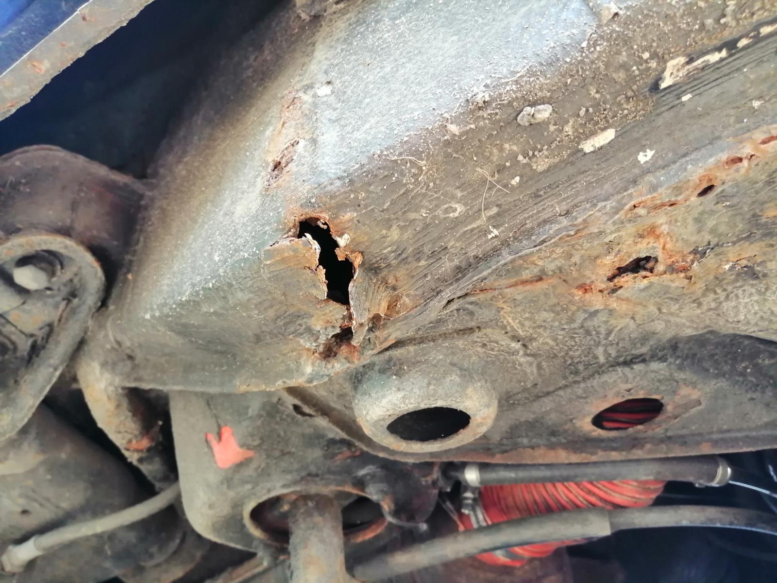

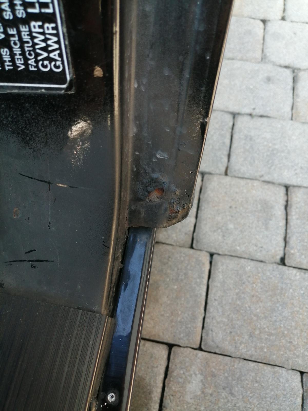

And the passenger side..
(IMG:http://www.914world.com/bbs2/uploads_offsite/www.thesamba.com-24690-1628584210.7.jpg)

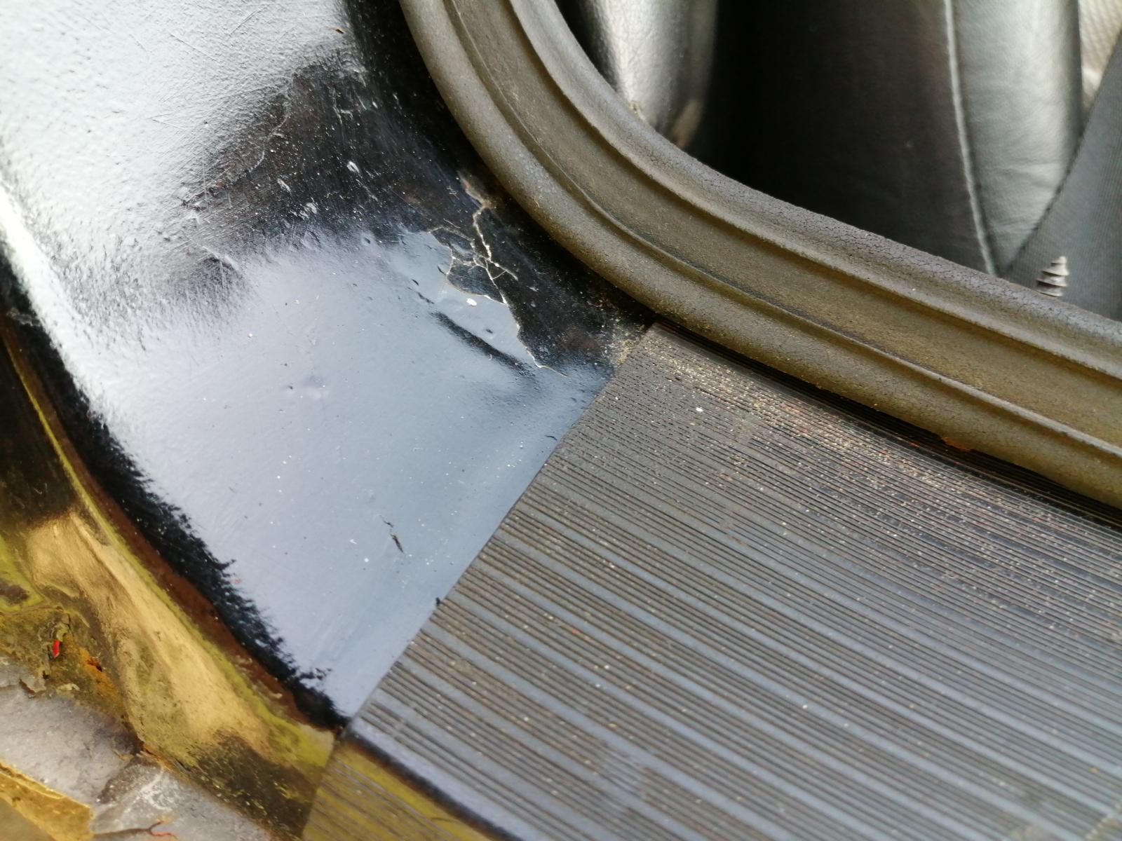

Well, under the door sill is not that bad:
(IMG:http://www.914world.com/bbs2/uploads_offsite/www.thesamba.com-24690-1628584211.8.jpg)

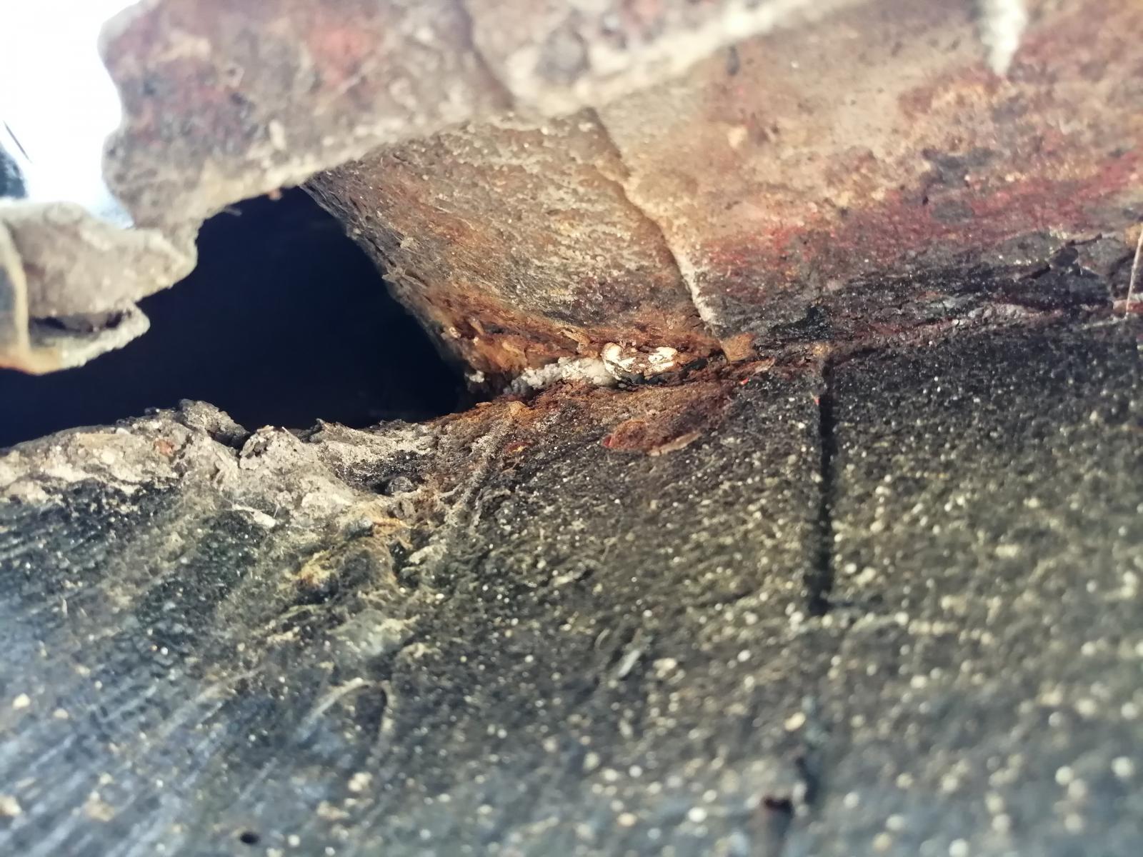

But under the long.. Well fiberglass was well hidden: (IMG:style_emoticons/default/sad.gif) (IMG:style_emoticons/default/sad.gif) (IMG:style_emoticons/default/icon8.gif)
(IMG:http://www.914world.com/bbs2/uploads_offsite/www.thesamba.com-24690-1628584211.9.jpg)
(IMG:http://www.914world.com/bbs2/uploads_offsite/www.thesamba.com-24690-1628584211.10.jpg)

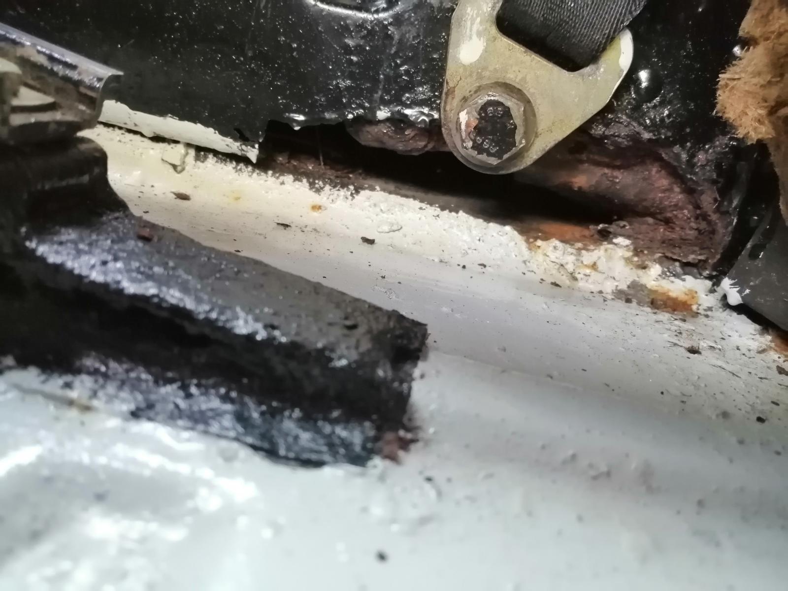

And on the inside under the belt fixation was also nicely fiberglassed (IMG:style_emoticons/default/headbang.gif) (IMG:style_emoticons/default/chair.gif) (IMG:style_emoticons/default/icon8.gif)
(IMG:http://www.914world.com/bbs2/uploads_offsite/www.thesamba.com-24690-1628584212.11.jpg)
