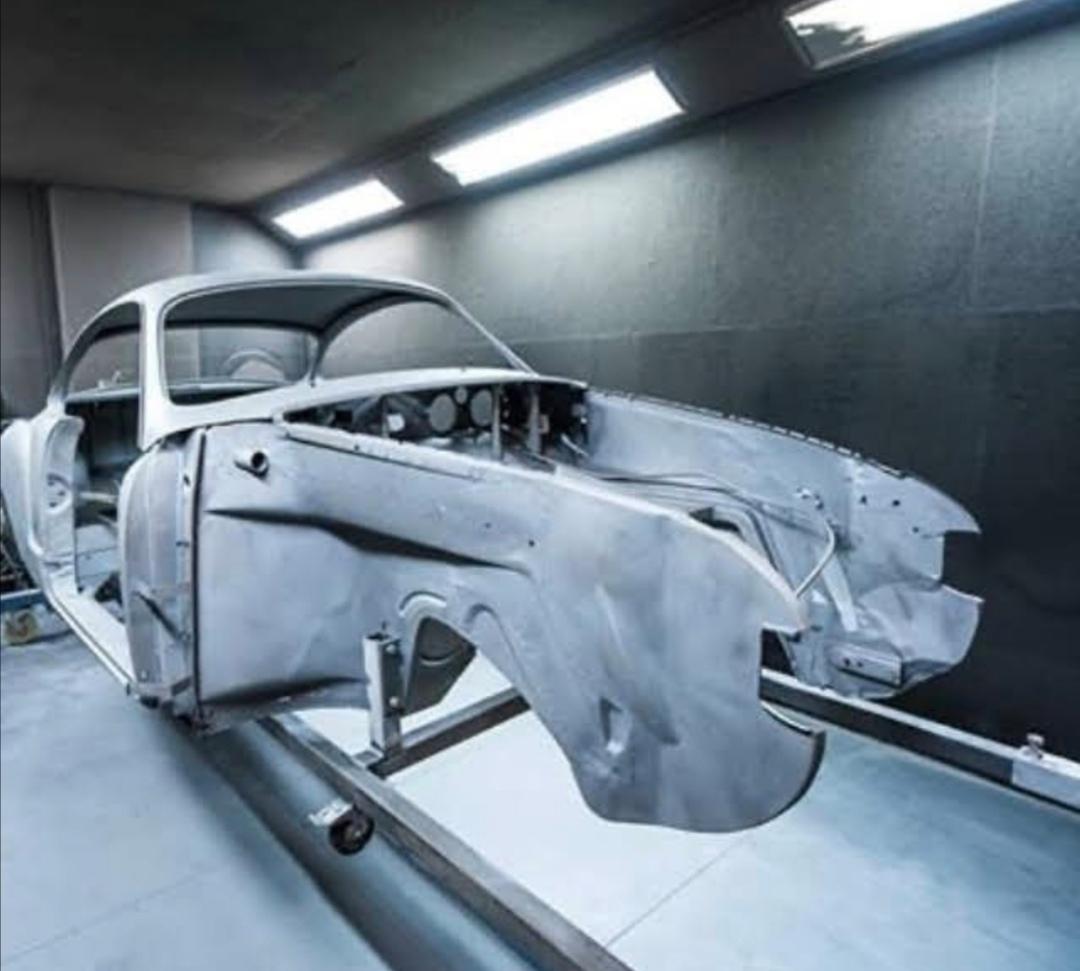

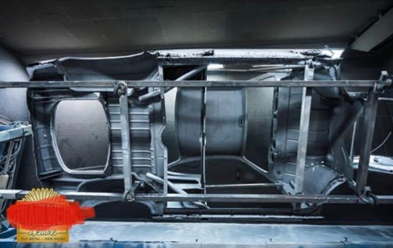

I thought a lot about it yesterday.. I think I will do it like that :
-put door braces
-remove the engine, tank,..
-put the car on jackstands using long wood to get the jackstands out of the way
-remove the front and back axles
-make a frame like this one (it's my ghia) :
(IMG:http://www.914world.com/bbs2/uploads_offsite/www.thesamba.com-24690-1628746838.1.jpg)
(IMG:http://www.914world.com/bbs2/uploads_offsite/www.thesamba.com-24690-1628746839.2.jpg)
that will be fixed to as many points as possible (front suspensions points, engine mount, gearbox mount,... to be both stable and usable as a jig for the long/eventually suspension console. Bonus will be to be able to mount it on my rotisserie (IMG:style_emoticons/default/biggrin.gif)
Sounds like a plan or ?
