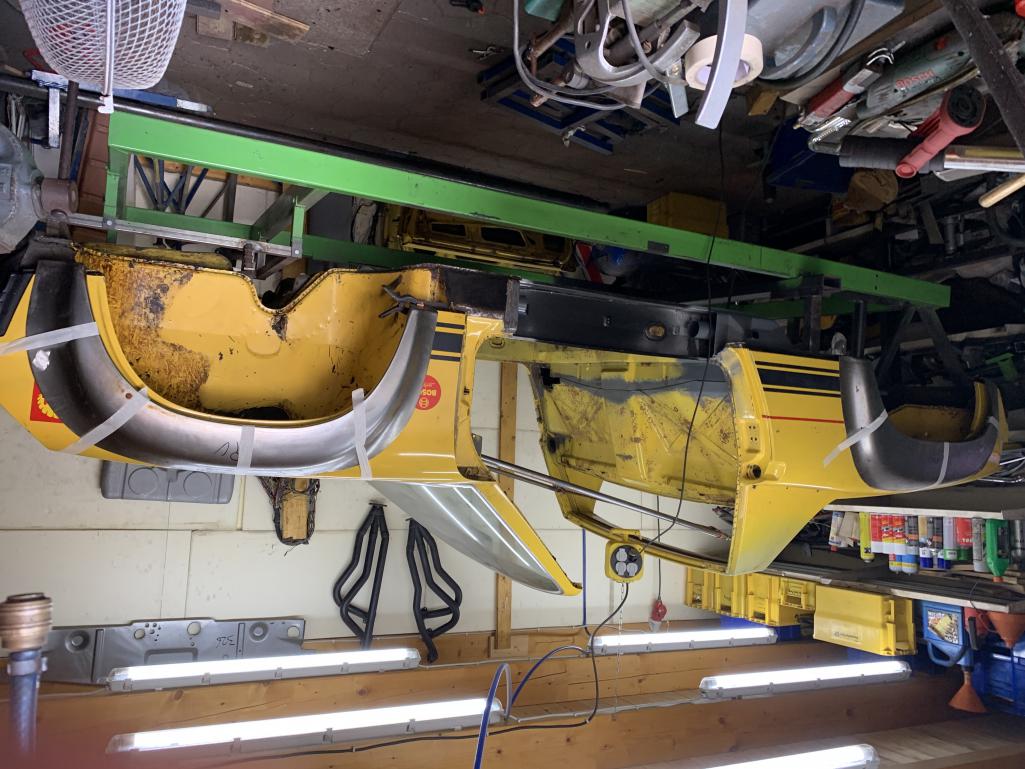

Hey Antoine, I‘am realy sorry about to see the issues on your car. These are nearly the same issues then my car had. In dont think there is a way for a quick repair
In your case I would make a patch to the rustholes at the long big enough to stiffen the area and Drive the car until your Karmann is back to road.
I'm pretty sure you'll find more to do at the 914 while your're at work on it.
For a propper repair you have to build a frame like that
This is combined with a rotisserie. I dont think there is a need for a celette bench.
You‘ll need to replace the inner long in the enginebay and as far I can see also the outer long. If you have to repair both, this can be done without cutting or removing the quaterpanel. But you have to remove the engine mount and the suspension console.
The panels from Restoration Design (they do a great Job for the 914 community) are a good startingpoint. I have highly modified them to meet my requirements.
If you have to replace the inner long in the passenger bay, Mittelmotor is a good source. They made good panel with the right dimensions for a reasonable price.

TRS63   So, as I said, before going further, I repaired pr...   Nov 19 2021, 03:18 AM
TRS63   So, next update ! I removed the triangle at th...   Nov 26 2021, 03:20 AM
wonkipop   great stuff @TRS63 . since you are a dedicated L...   Nov 26 2021, 03:57 AM
TRS63   Thanks for the kind words ! :beer2: I did not...   Nov 27 2021, 12:57 PM
TRS63   So, I finished welding the seat belt mounting poin...   Dec 6 2021, 02:59 AM
