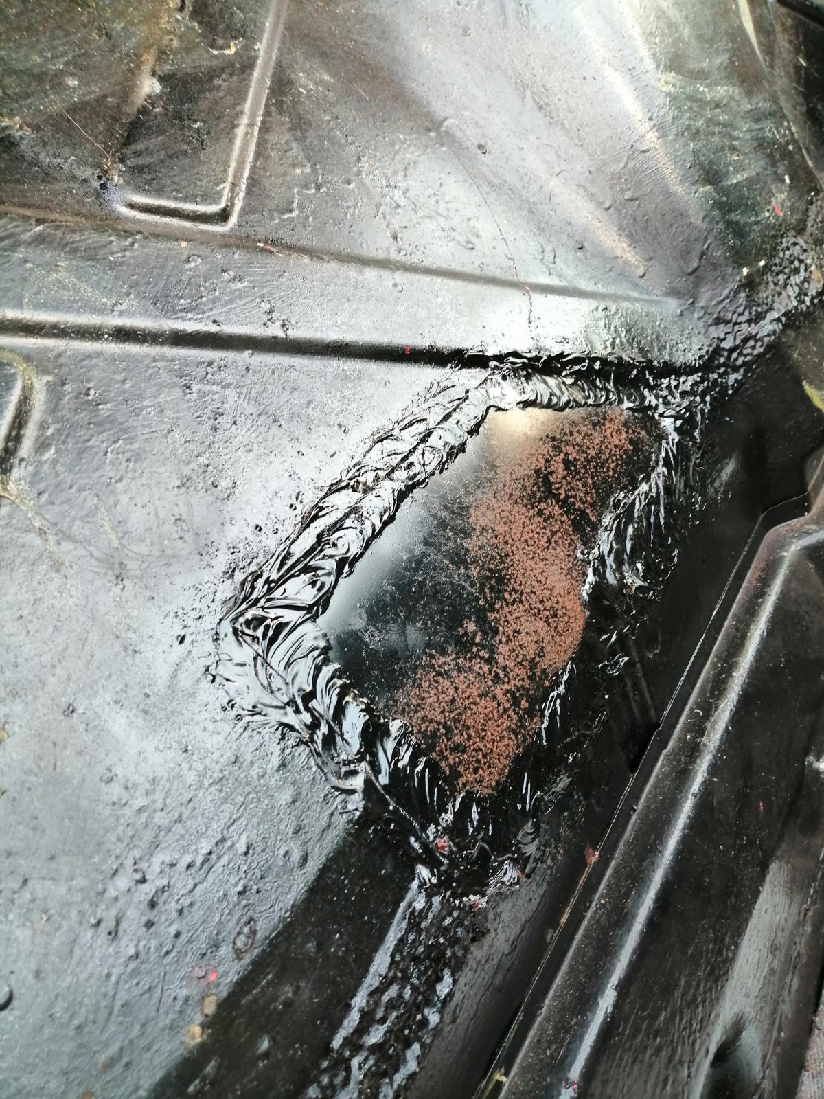

So, I asked my qualified employee (aka my 5 years old boy who is already wrenching with me as much as possible !) to remove the interior (except the driver's seat to drive it to my shop tomorrow) to better see what we got.. Well, rust (IMG:style_emoticons/default/laugh.gif) (IMG:style_emoticons/default/headbang.gif)

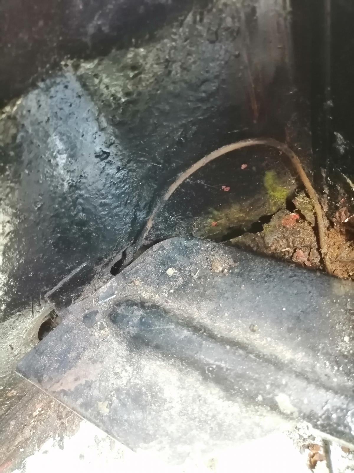

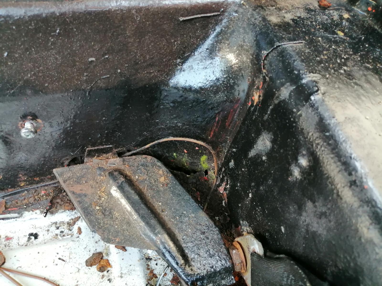

Driver's side, in the corner: (IMG:style_emoticons/default/sad.gif)
(IMG:http://www.914world.com/bbs2/uploads_offsite/www.thesamba.com-24690-1629123067.1.jpg)
(IMG:http://www.914world.com/bbs2/uploads_offsite/www.thesamba.com-24690-1629123068.2.jpg)

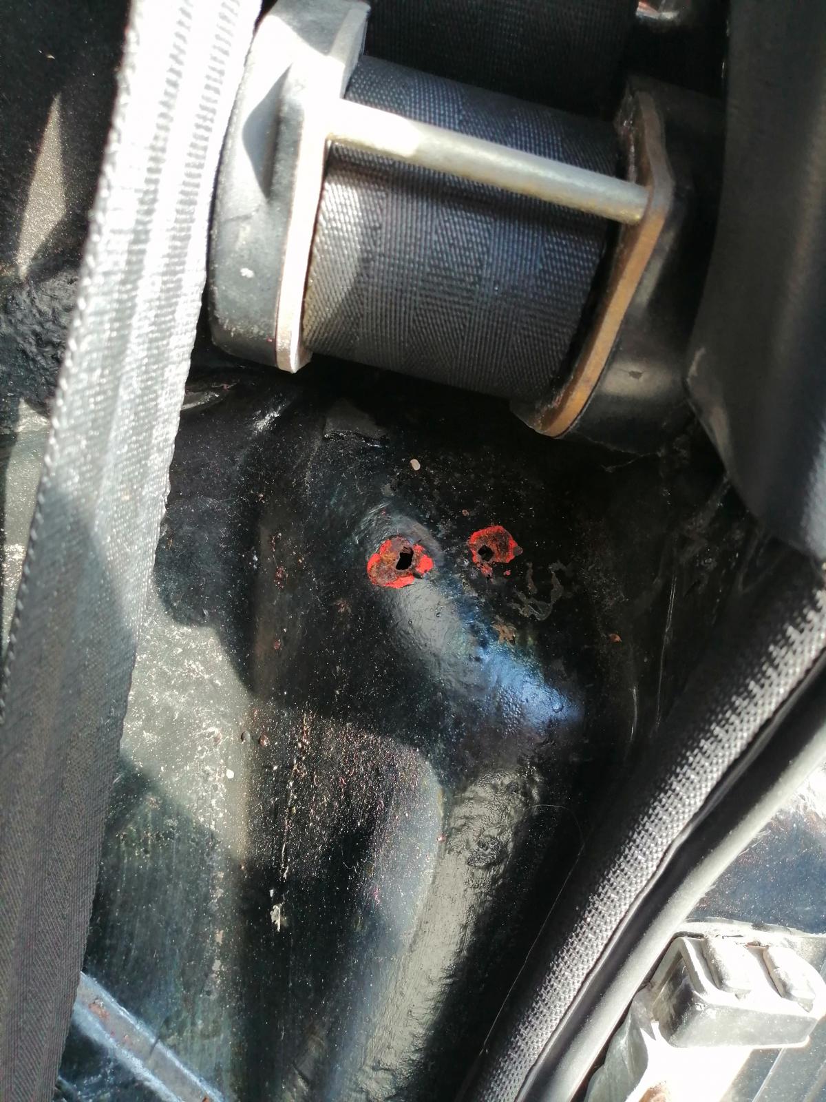

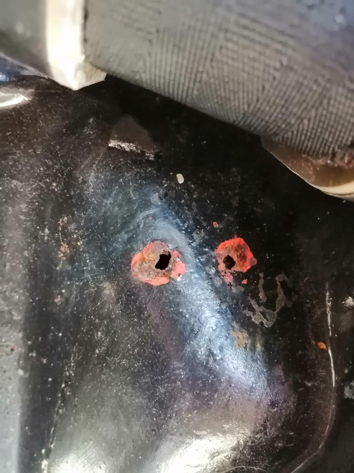

And under the seat belt up in the firewall, I don't know how it rusted here, was no hole, just rust where I got through with the screwdriver.. (IMG:style_emoticons/default/unsure.gif)
(IMG:http://www.914world.com/bbs2/uploads_offsite/www.thesamba.com-24690-1629123069.3.jpg)
(IMG:http://www.914world.com/bbs2/uploads_offsite/www.thesamba.com-24690-1629123069.4.jpg)

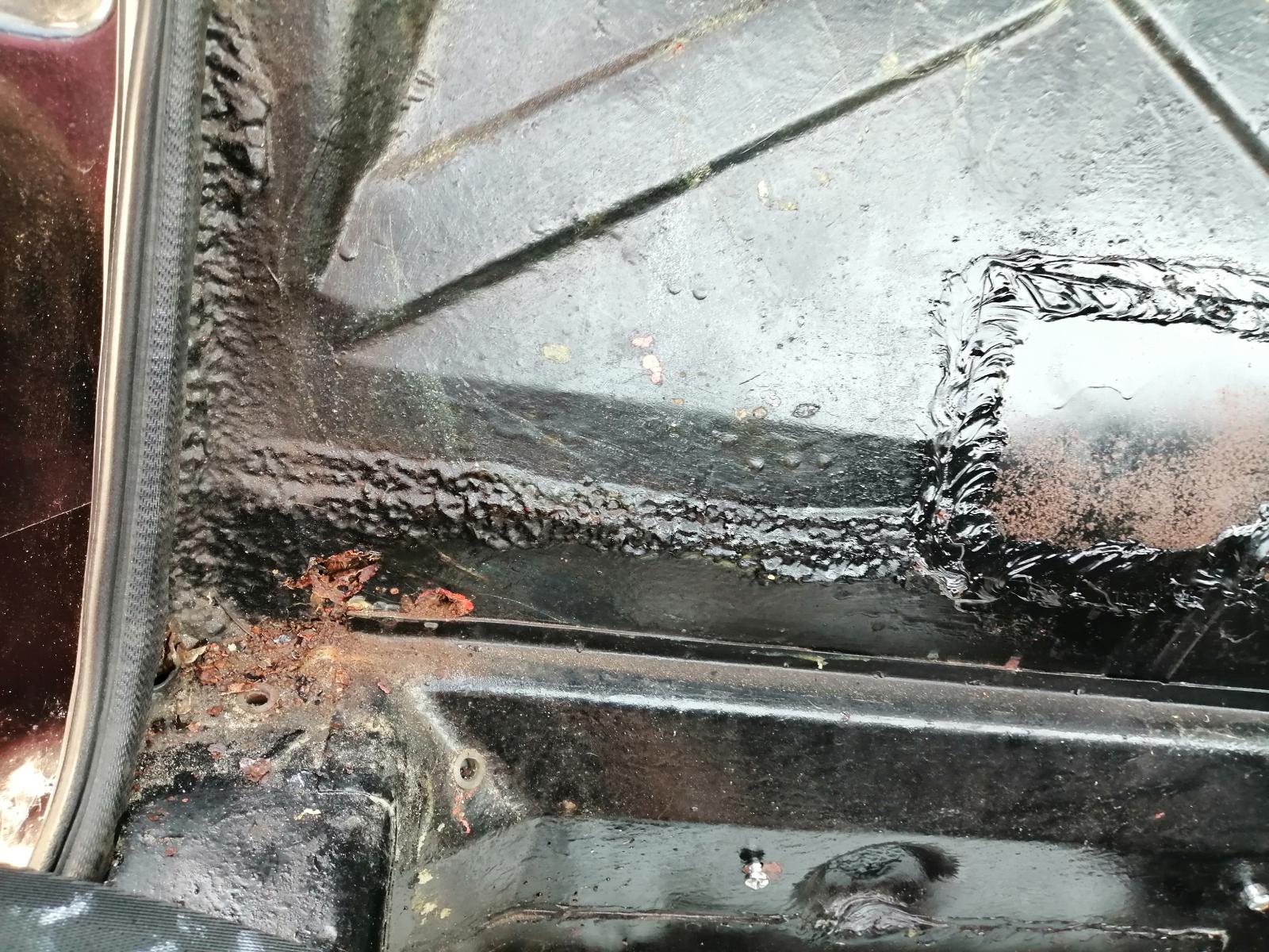

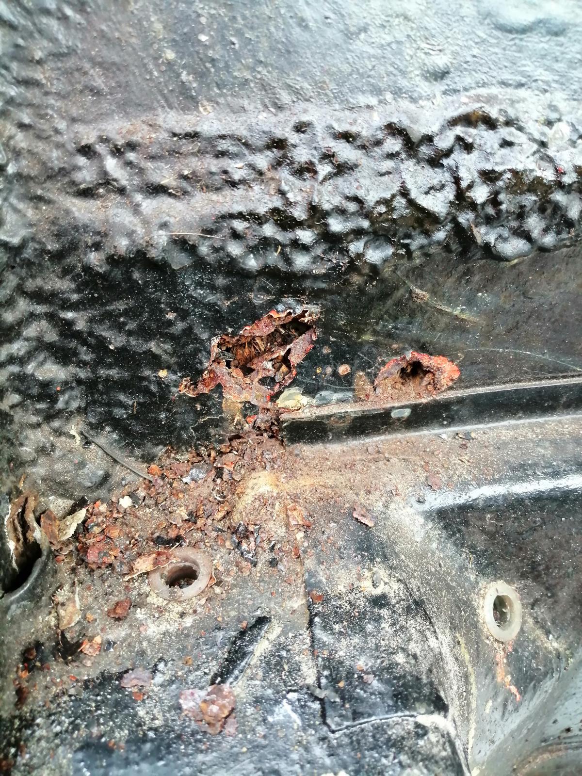

On the passenger side I only found some bad fixes from the past..
(IMG:http://www.914world.com/bbs2/uploads_offsite/www.thesamba.com-24690-1629123069.5.jpg)
(IMG:http://www.914world.com/bbs2/uploads_offsite/www.thesamba.com-24690-1629123070.6.jpg)
(IMG:http://www.914world.com/bbs2/uploads_offsite/www.thesamba.com-24690-1629123070.7.jpg)
Well.. I'm in for real.. Not that I don't like it (metalshaping is my passion and I love welding, especially TIG) but this one is planned as a driver so will try to get it back on the road as fast as possible (IMG:style_emoticons/default/rolleyes.gif) (IMG:style_emoticons/default/smile.gif)
