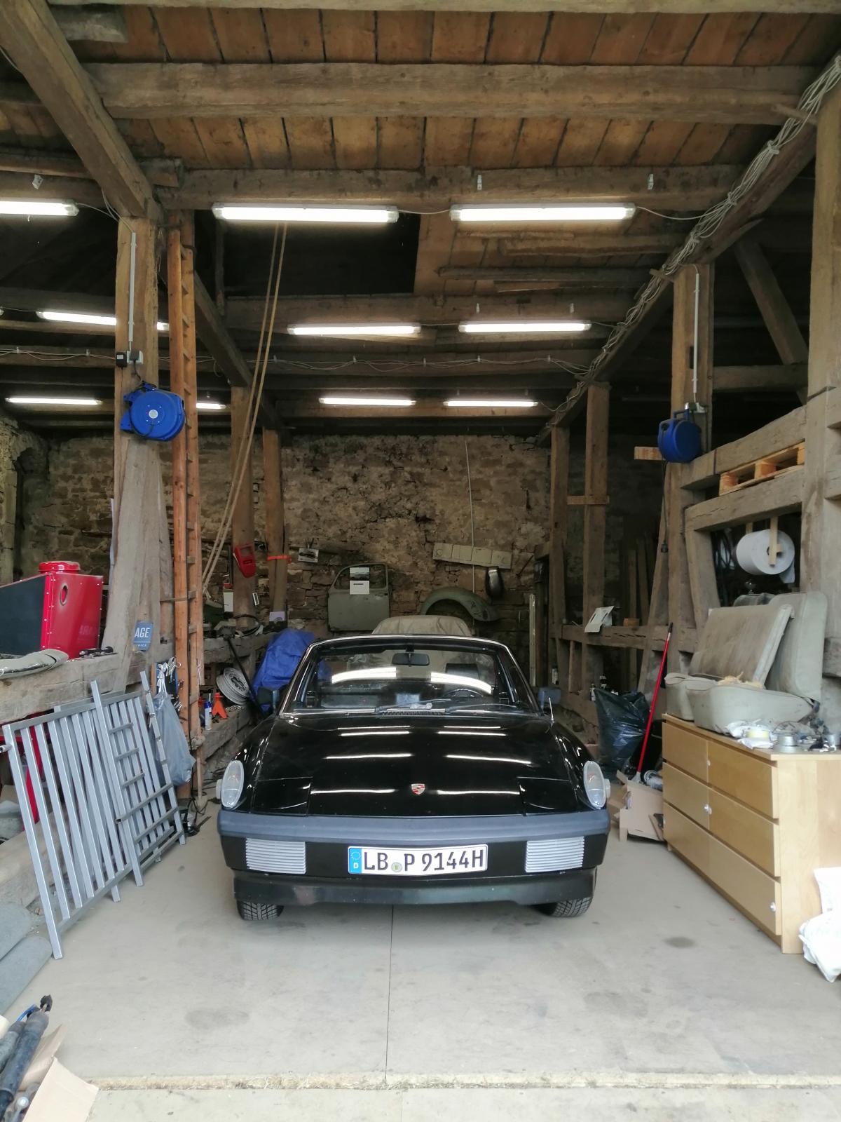

So.. The 914 is in my shop (IMG:style_emoticons/default/shades.gif)
(IMG:http://www.914world.com/bbs2/uploads_offsite/www.thesamba.com-24690-1629280036.1.jpg)

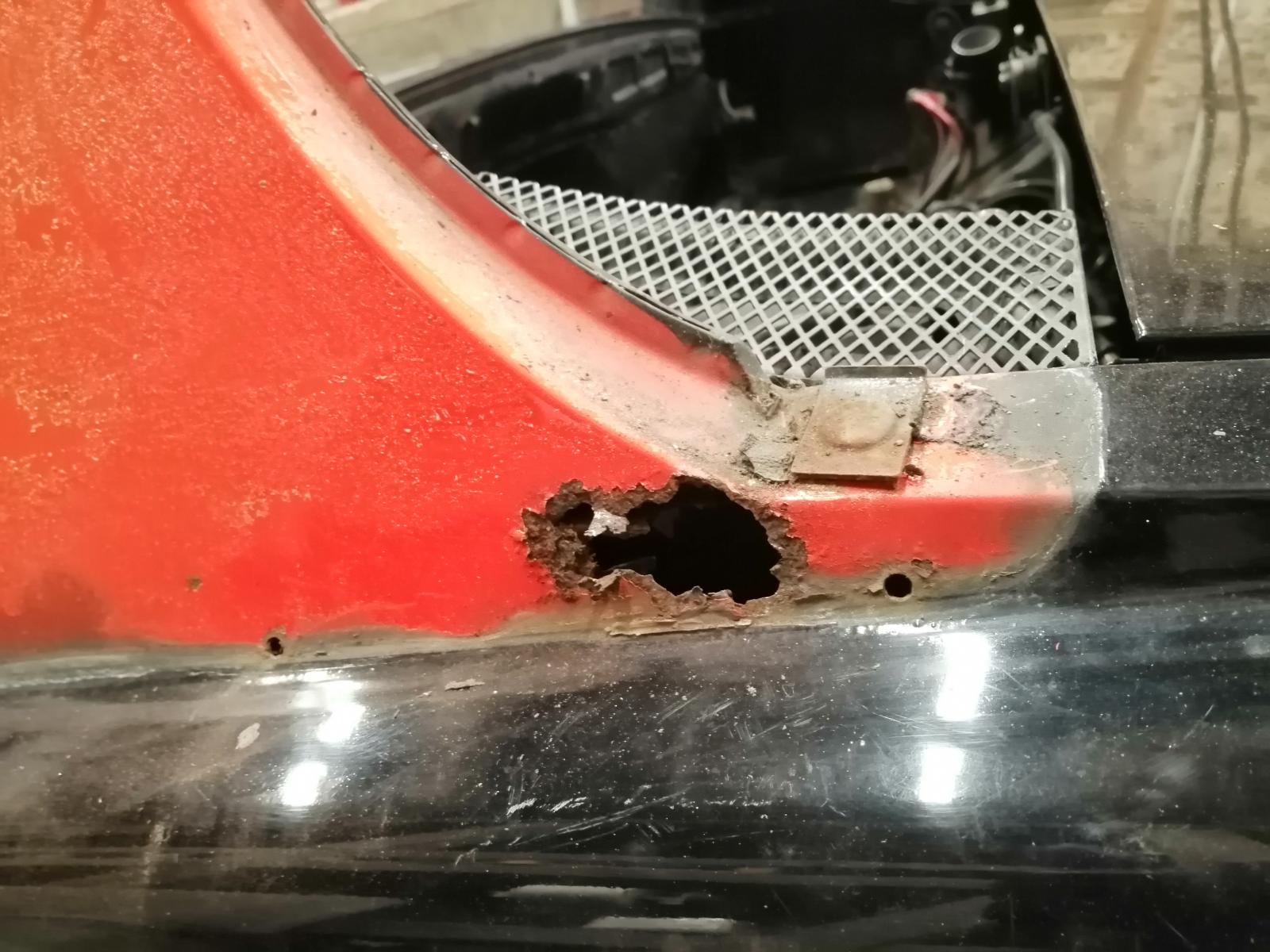

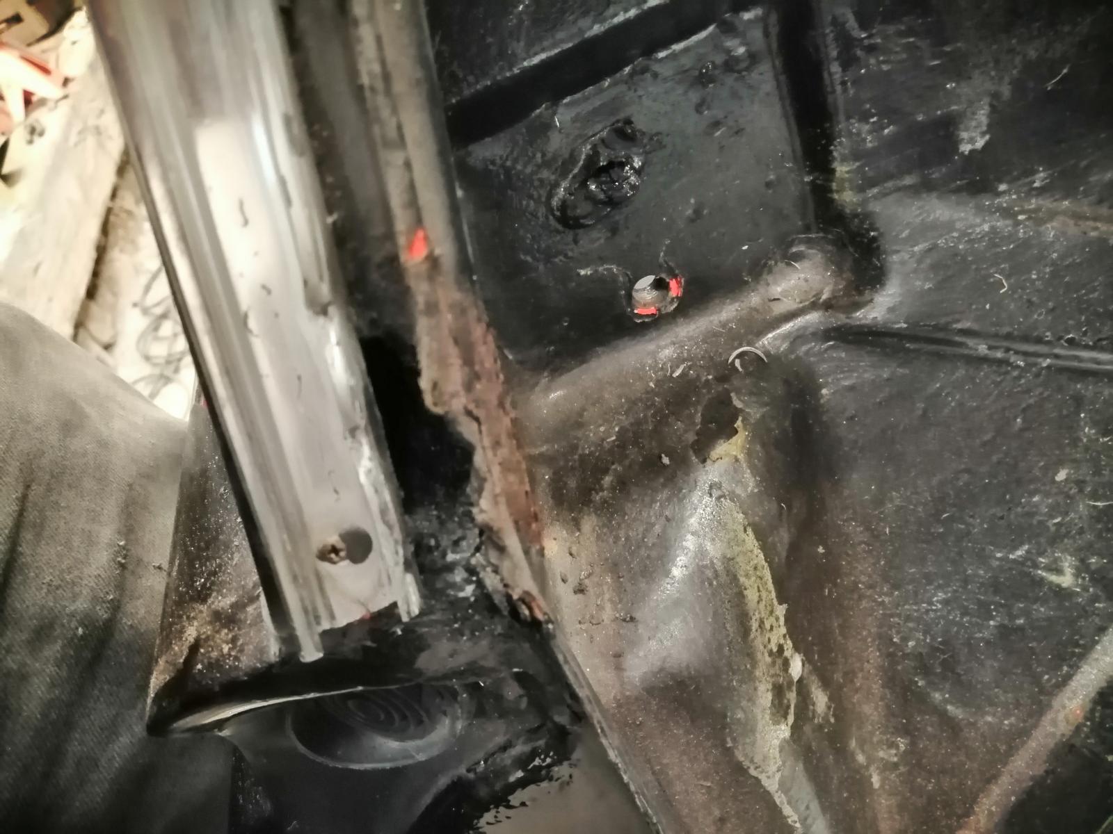

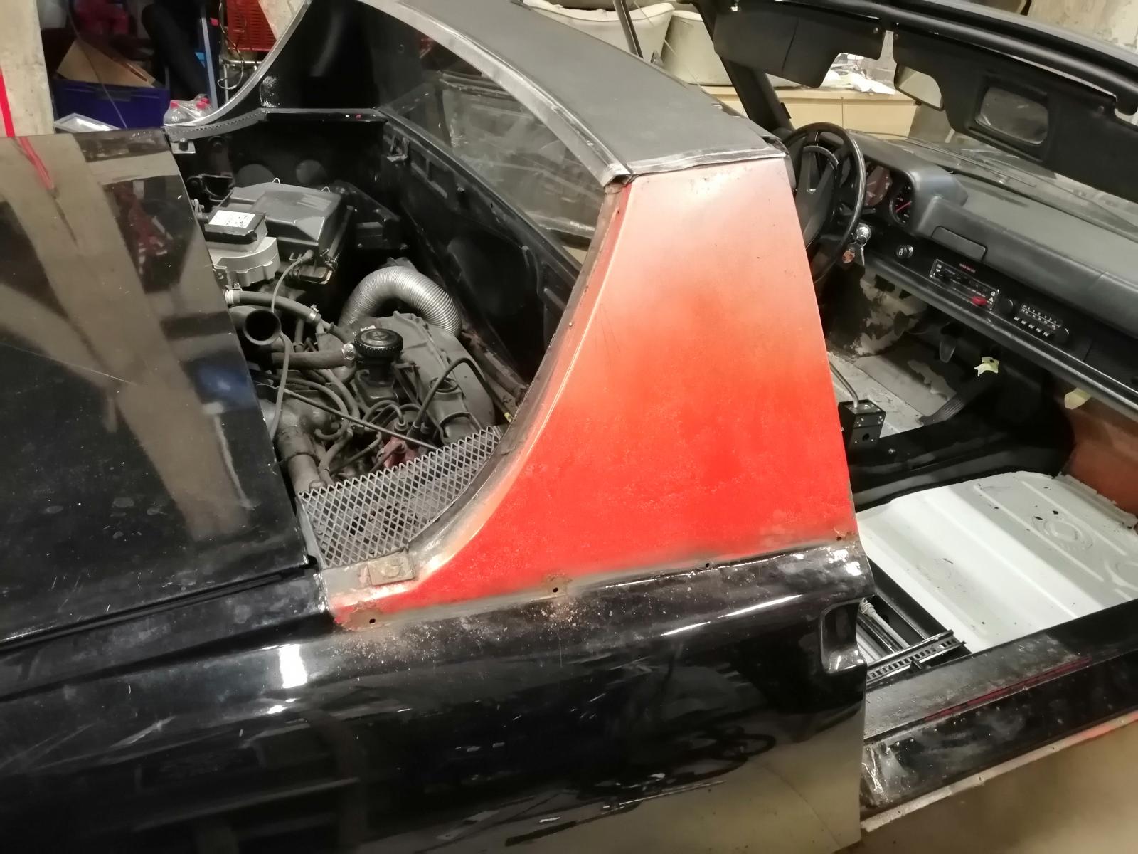

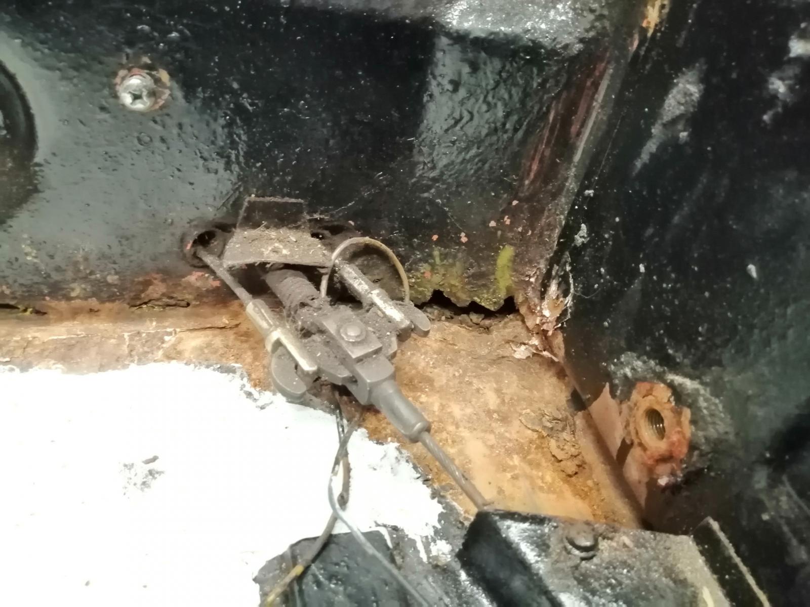

And I made some more disassembly, and checked the B-pillar behind the sail panel where I expected a lot of work..

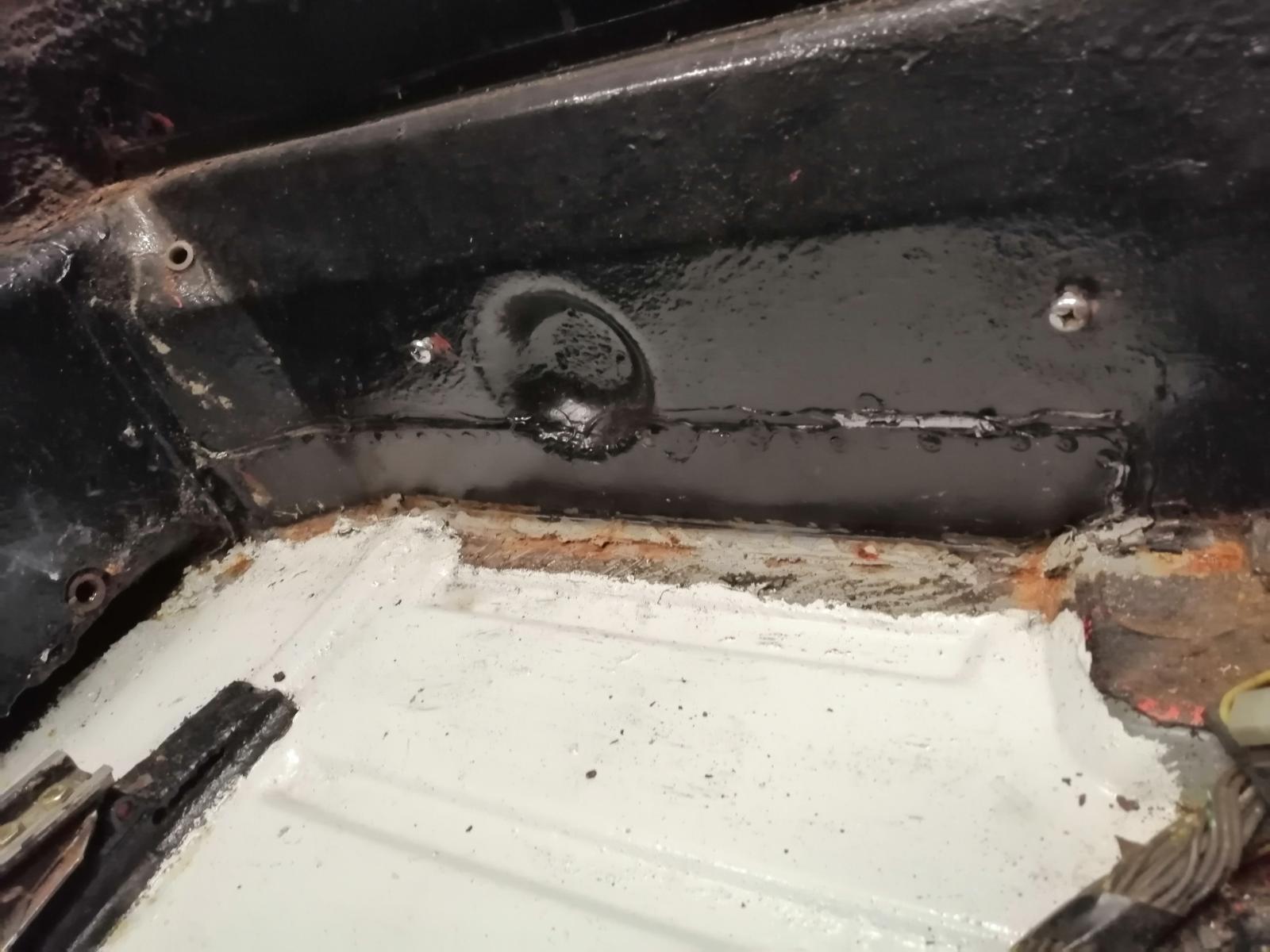

Passenger side is quite a good surprise, except this hole that could be foreseen:
(IMG:http://www.914world.com/bbs2/uploads_offsite/www.thesamba.com-24690-1629280036.2.jpg)

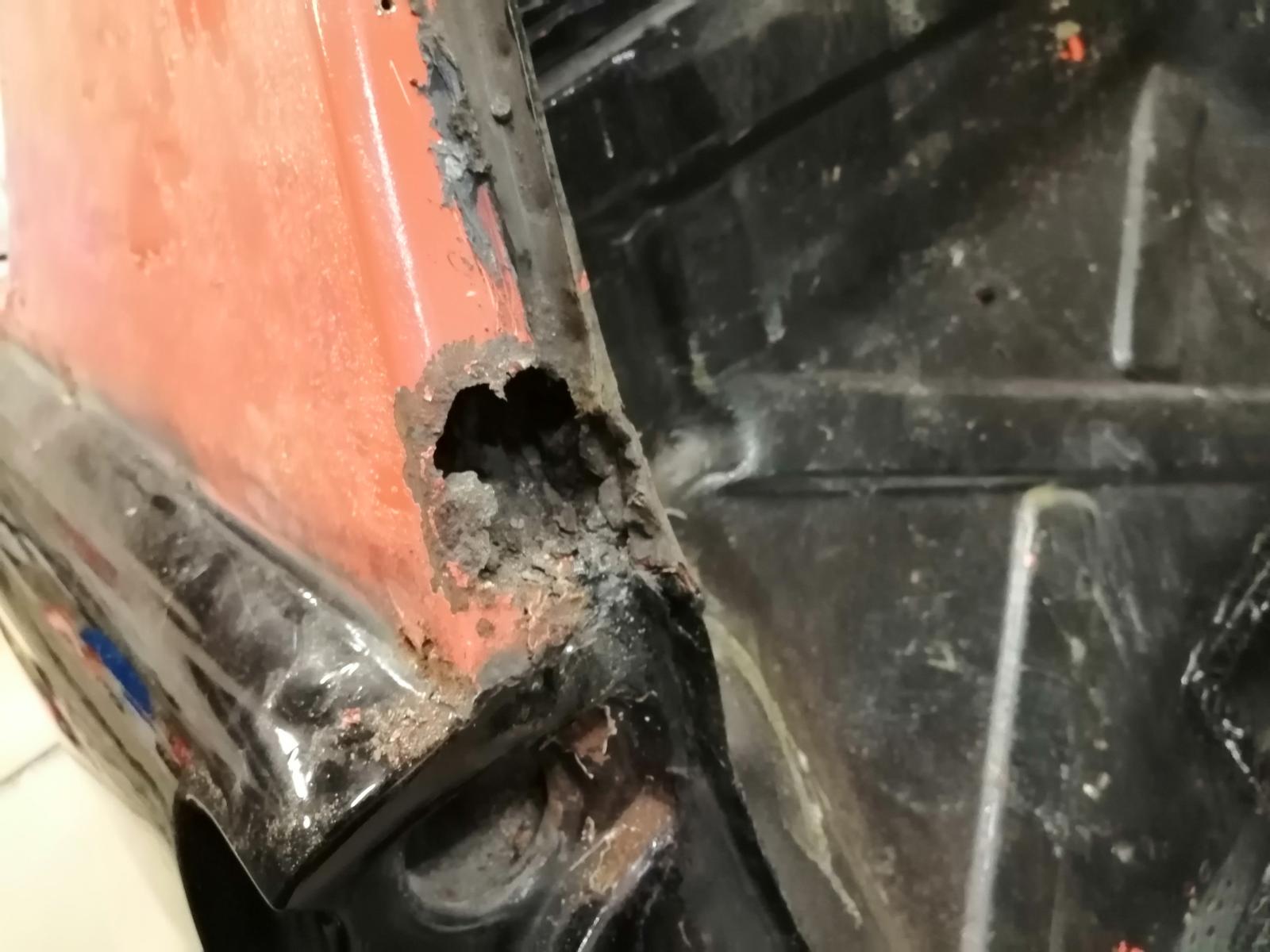

And is real:
(IMG:http://www.914world.com/bbs2/uploads_offsite/www.thesamba.com-24690-1629280037.3.jpg)
The rest is good (IMG:style_emoticons/default/biggrin.gif)

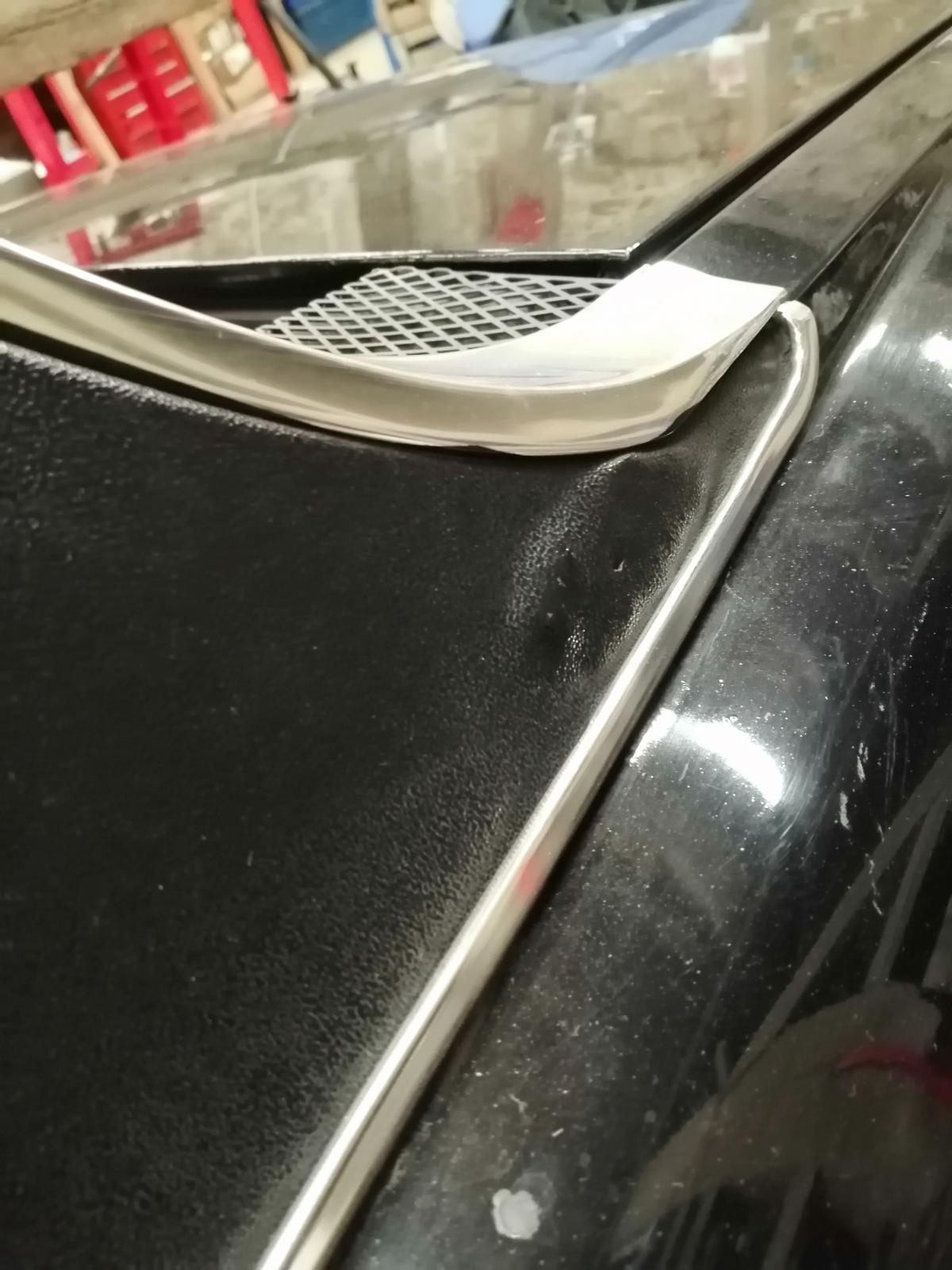

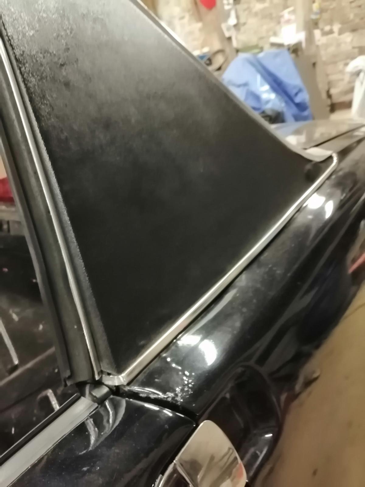

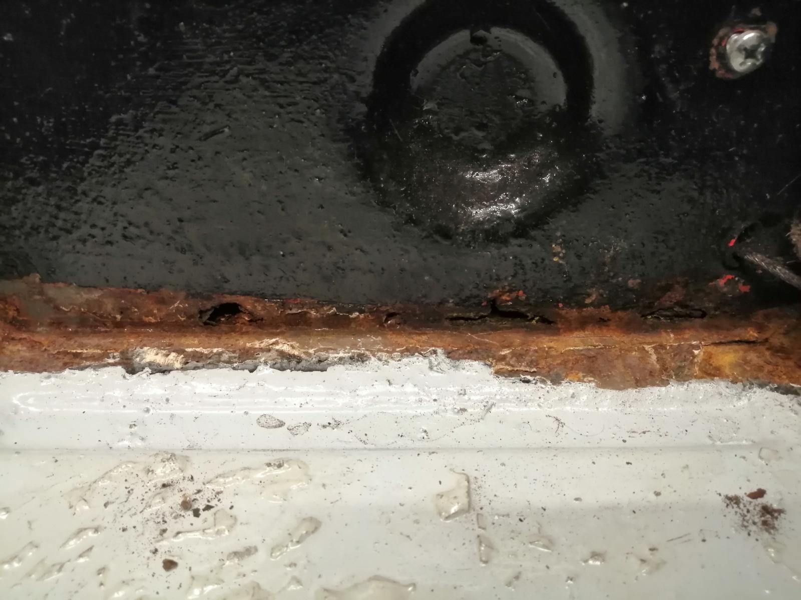

Driver side had developped some.. Let's say waves..
(IMG:http://www.914world.com/bbs2/uploads_offsite/www.thesamba.com-24690-1629280038.5.jpg)
(IMG:http://www.914world.com/bbs2/uploads_offsite/www.thesamba.com-24690-1629280038.6.jpg)

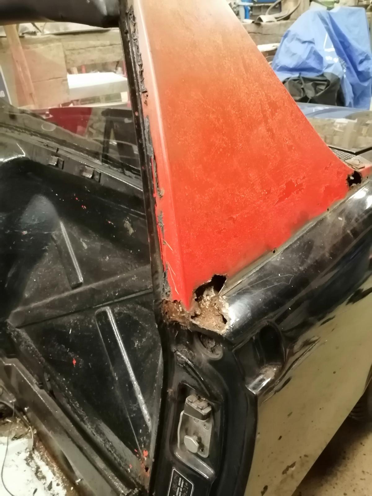

And here there are a bit more damages.. (IMG:style_emoticons/default/sad.gif)
(IMG:http://www.914world.com/bbs2/uploads_offsite/www.thesamba.com-24690-1629280038.7.jpg)
(IMG:http://www.914world.com/bbs2/uploads_offsite/www.thesamba.com-24690-1629280039.8.jpg)
Well, I know the condition now, and nothing that really scares me (IMG:style_emoticons/default/smile.gif)

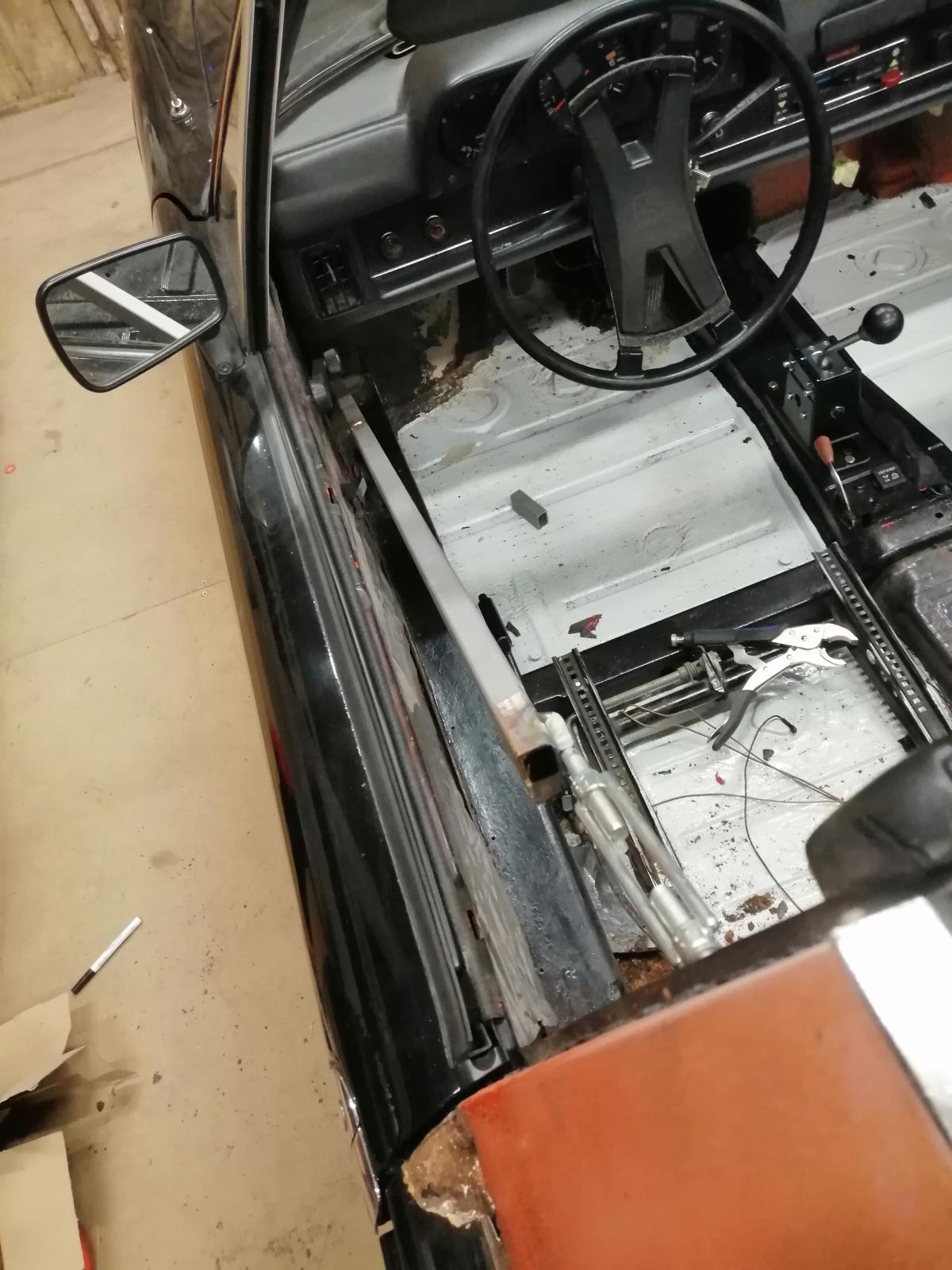

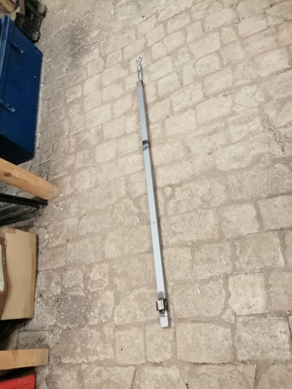

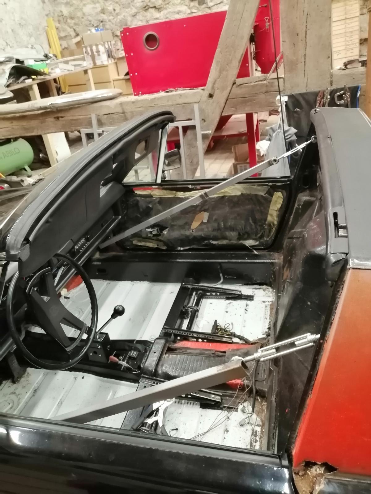

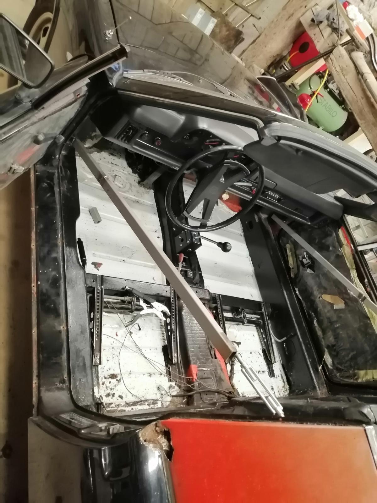

Then I built the necessary door braces, made to be able to keep the doors, in order to always be able to check the gaps (IMG:style_emoticons/default/smile.gif)
(IMG:http://www.914world.com/bbs2/uploads_offsite/www.thesamba.com-24690-1629280039.9.jpg)
And mounted:
(IMG:http://www.914world.com/bbs2/uploads_offsite/www.thesamba.com-24690-1629280039.10.jpg)
(IMG:http://www.914world.com/bbs2/uploads_offsite/www.thesamba.com-24690-1629280040.11.jpg)
(IMG:http://www.914world.com/bbs2/uploads_offsite/www.thesamba.com-24690-1629280040.12.jpg)
