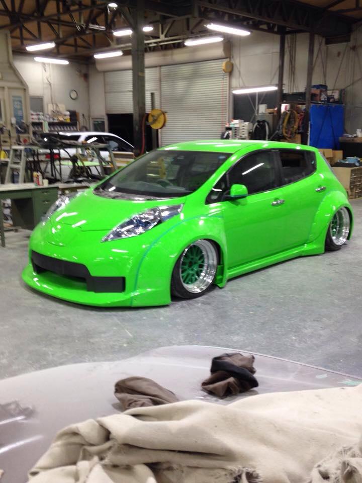

Want a fun EV, Nissan Leaf widebody
(IMG:http://www.914world.com/bbs2/uploads_offsite/s1.cdn.autoevolution.com-431-1629883933.1.jpg)
