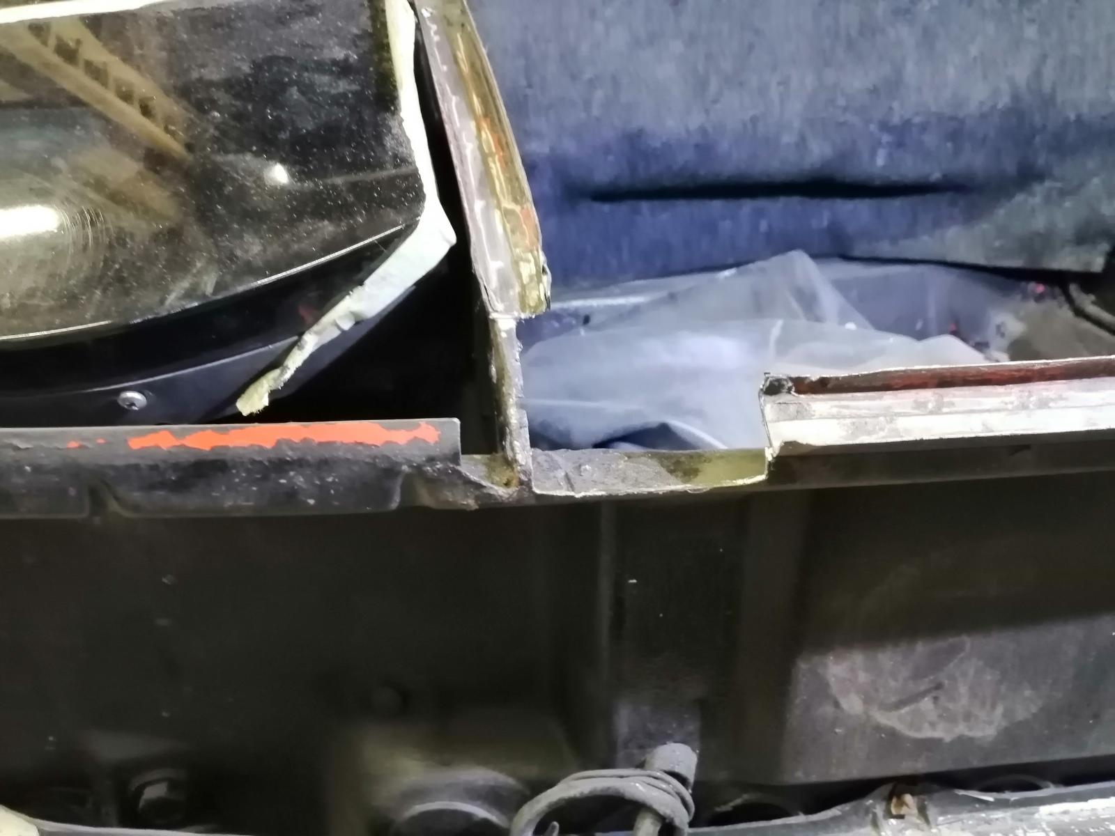

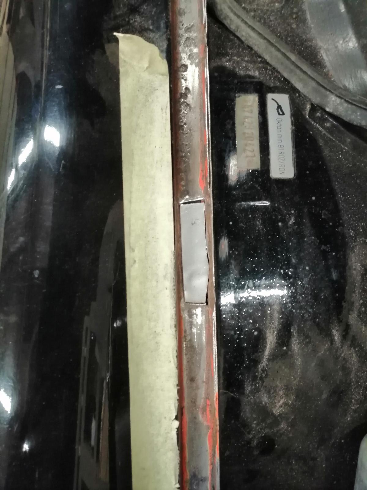

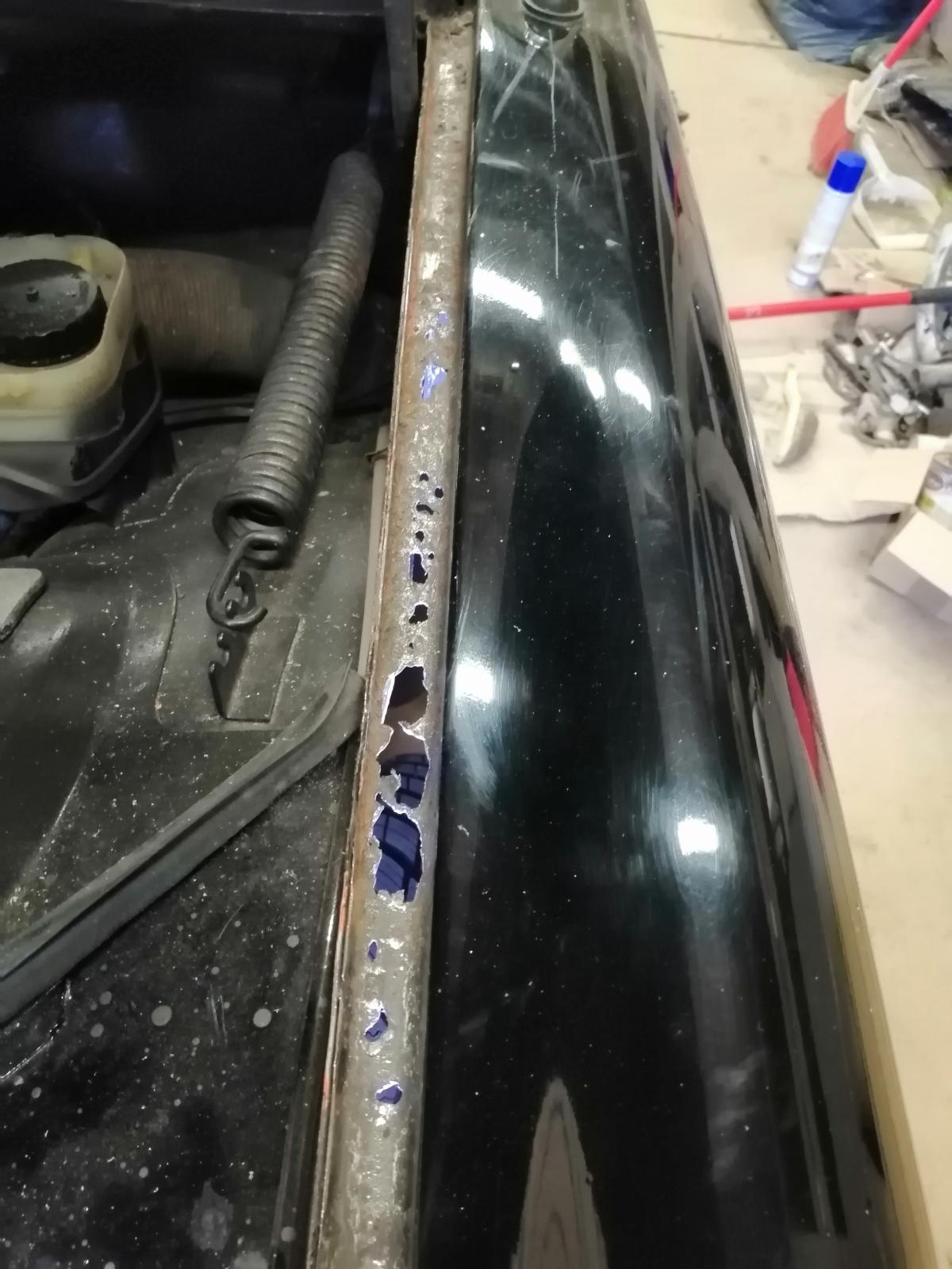

So, already a lot happened to the 914 this week!

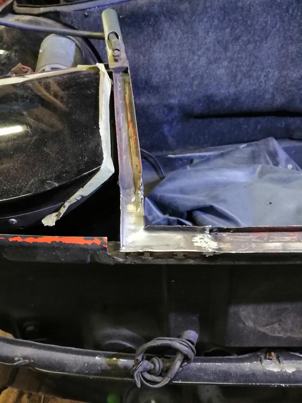

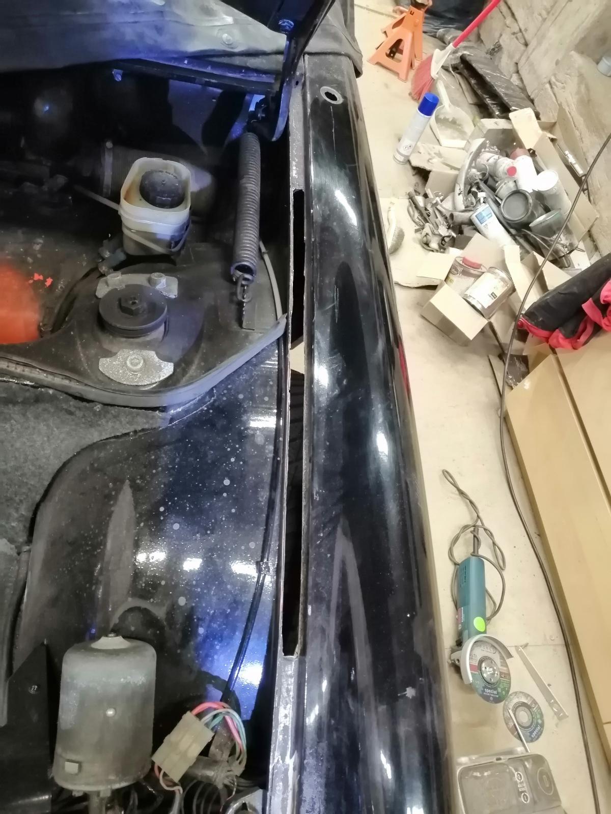

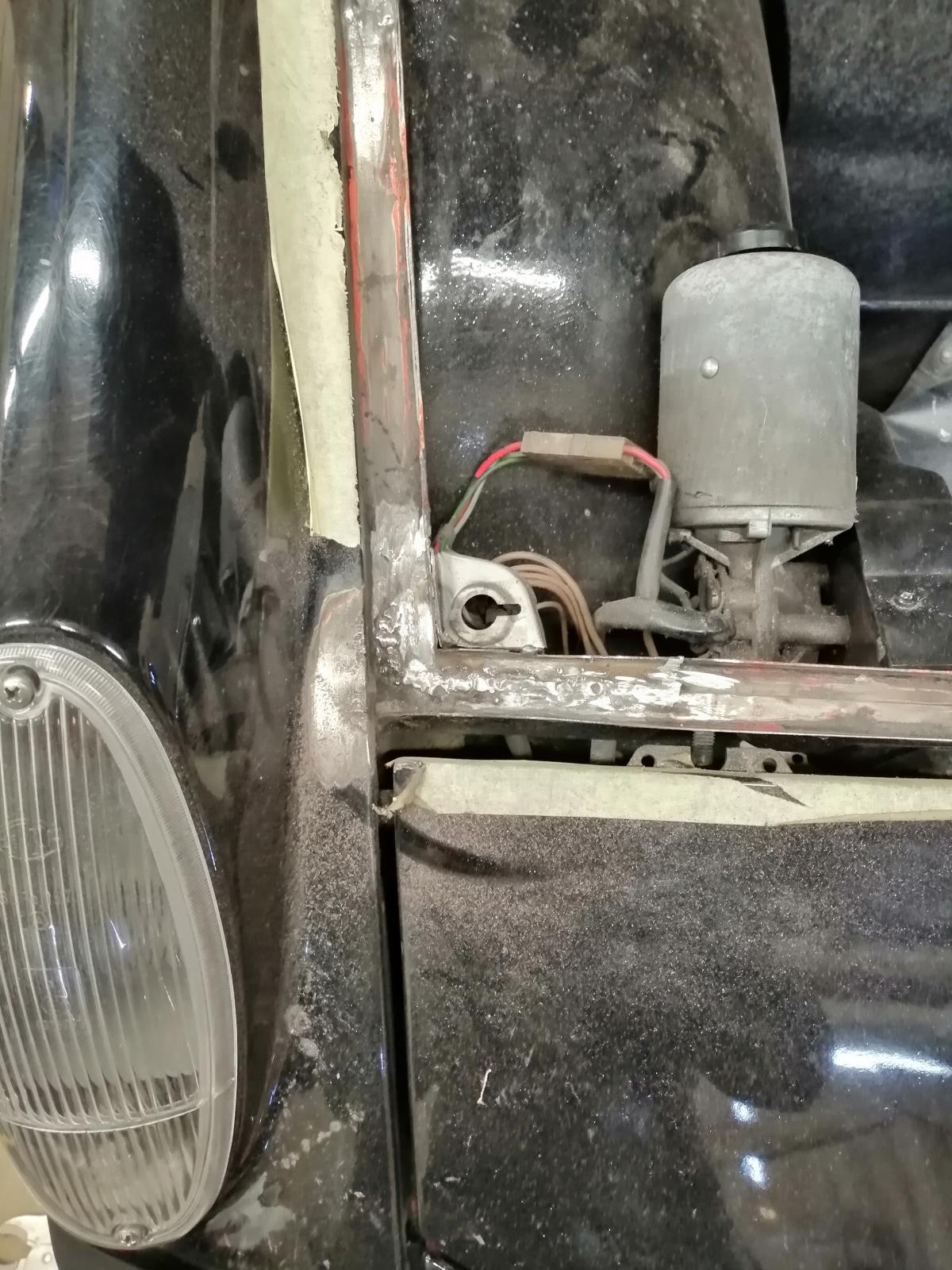

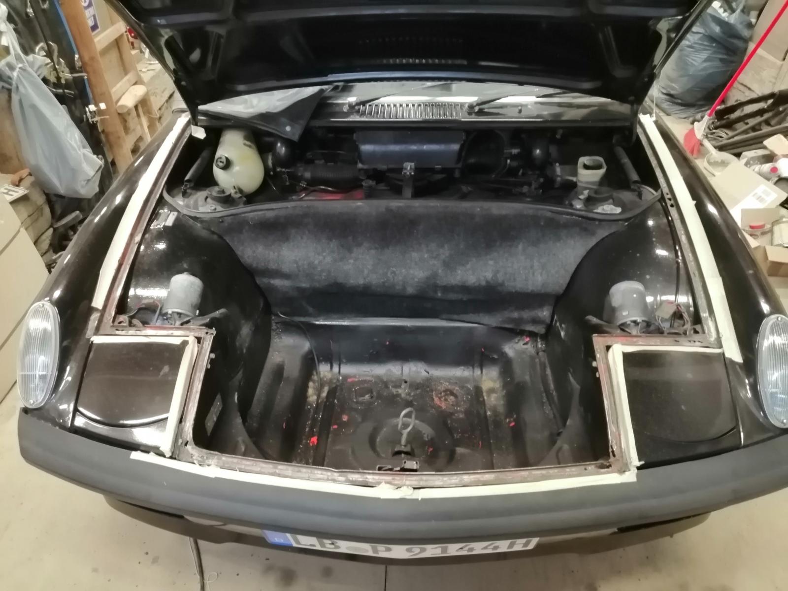

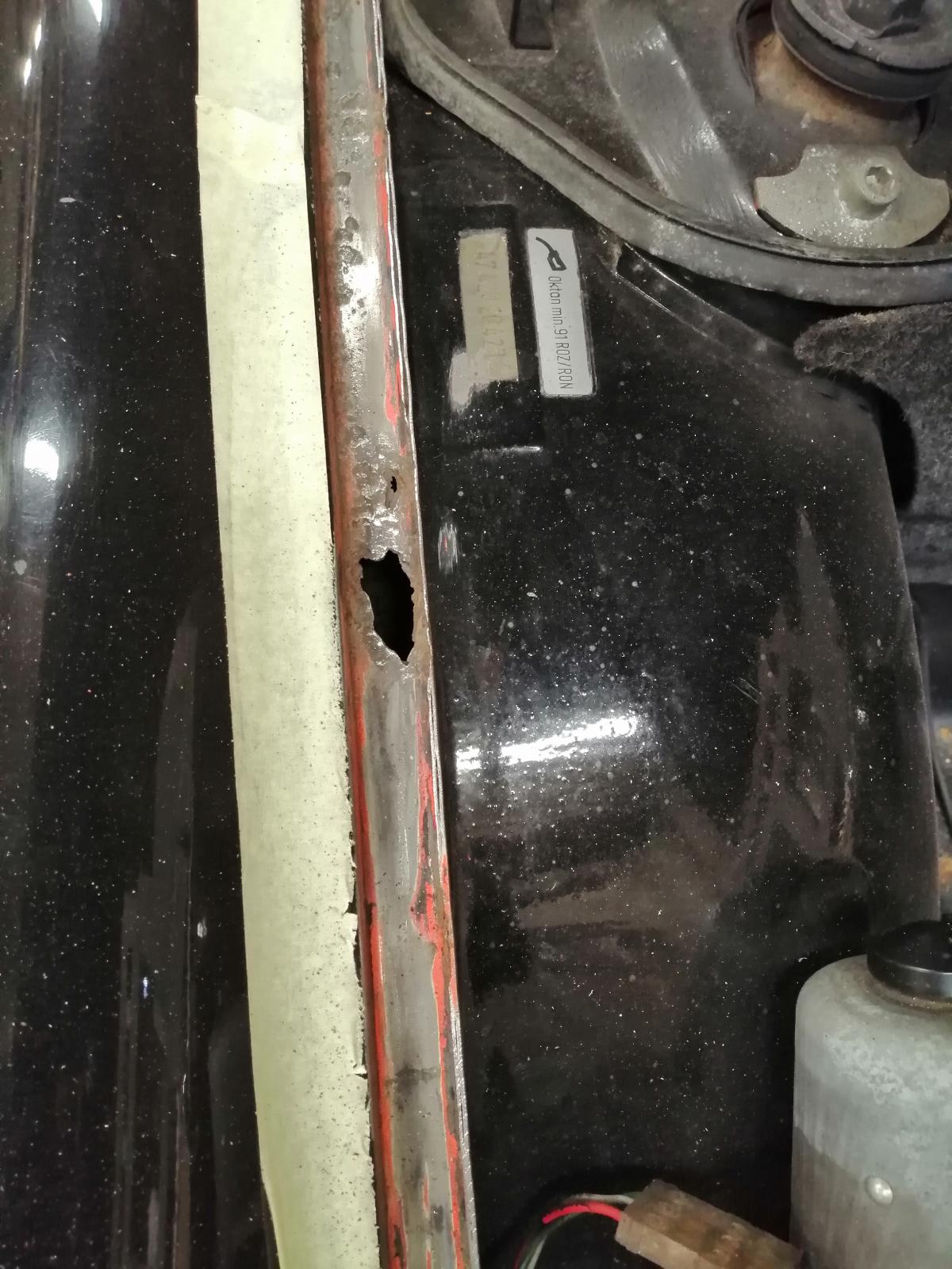

I started upfront by pulling out the frunk seal to check the condition under it..
(IMG:http://www.914world.com/bbs2/uploads_offsite/www.thesamba.com-24690-1630251910.1.jpg)

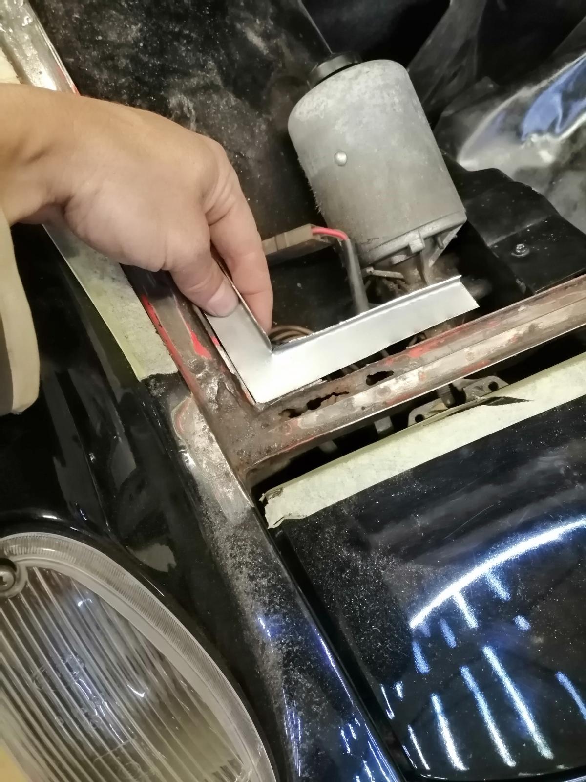

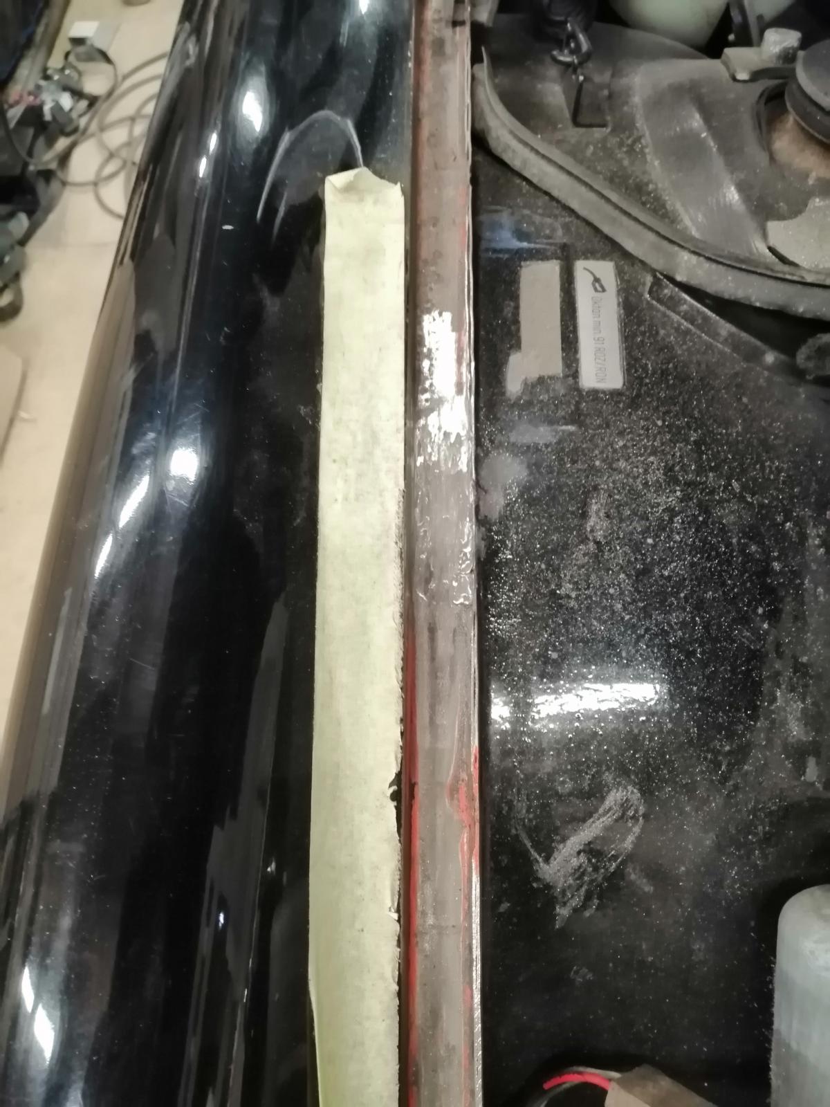

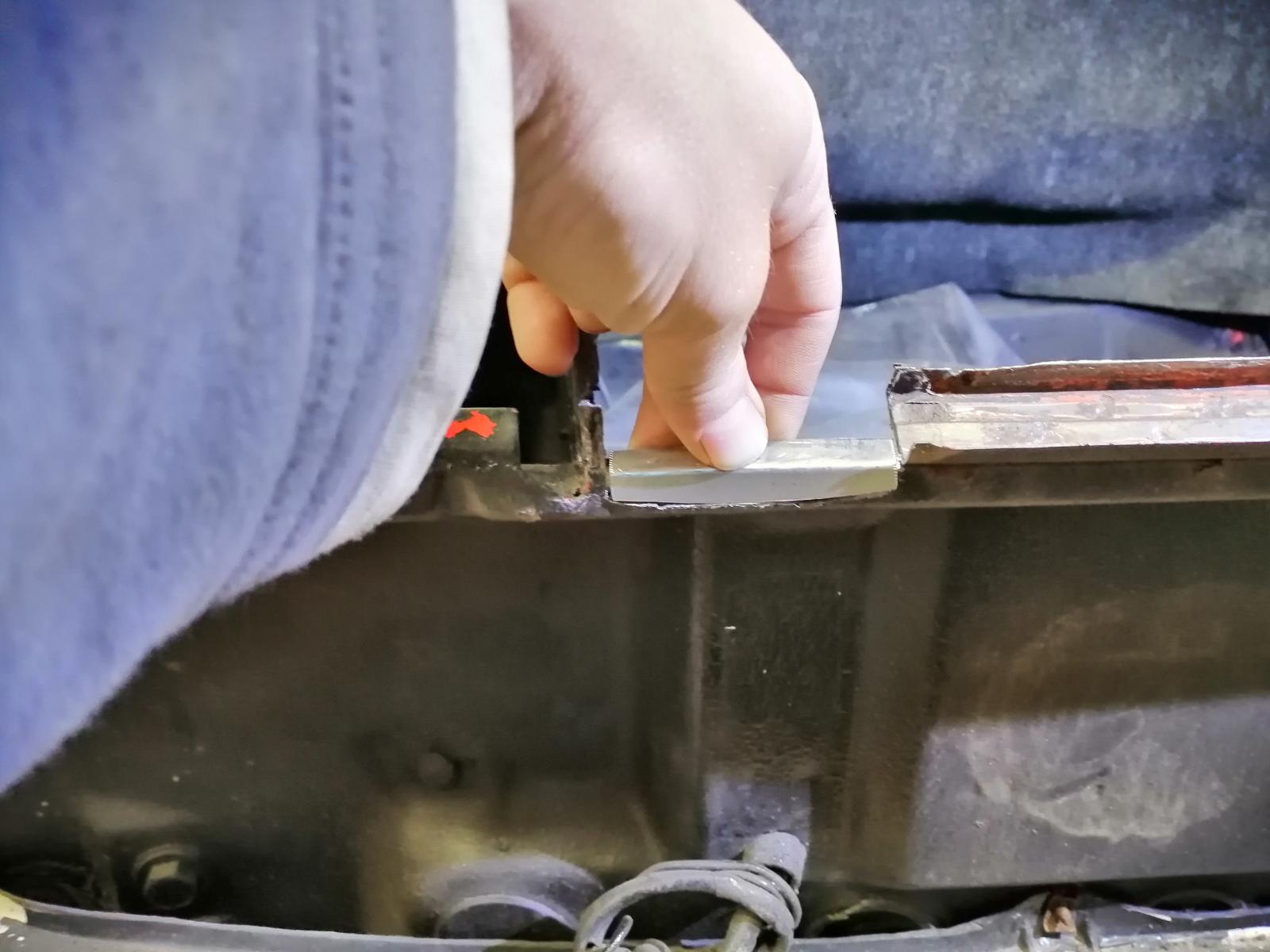

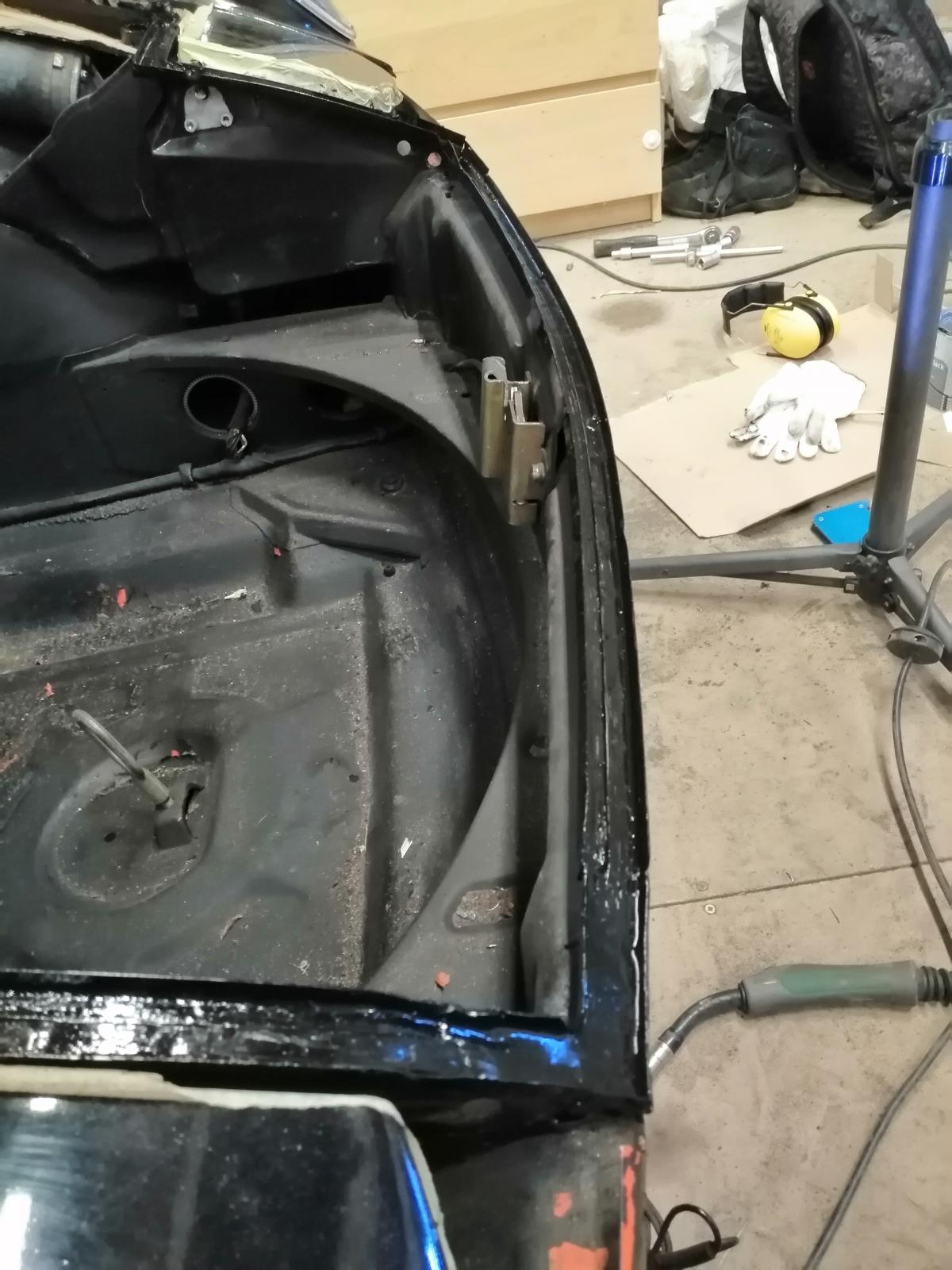

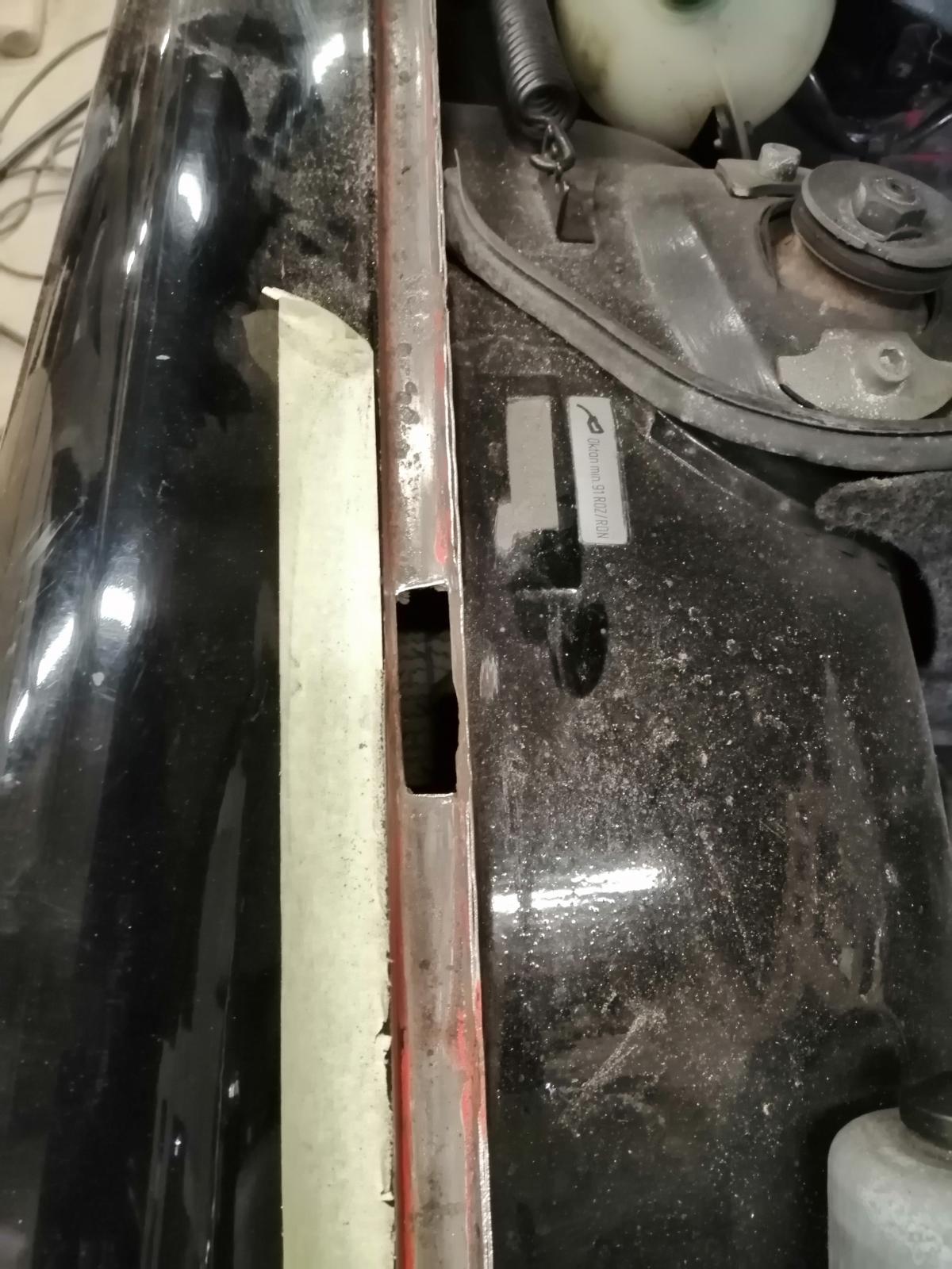

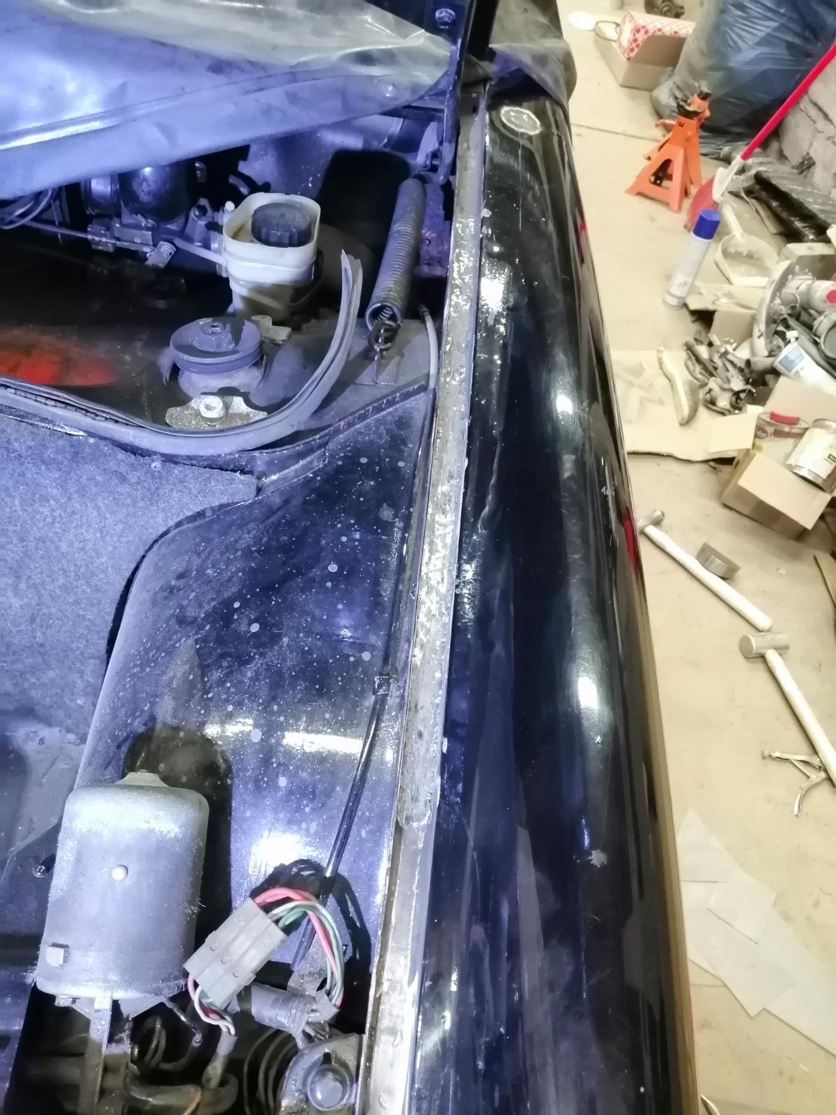

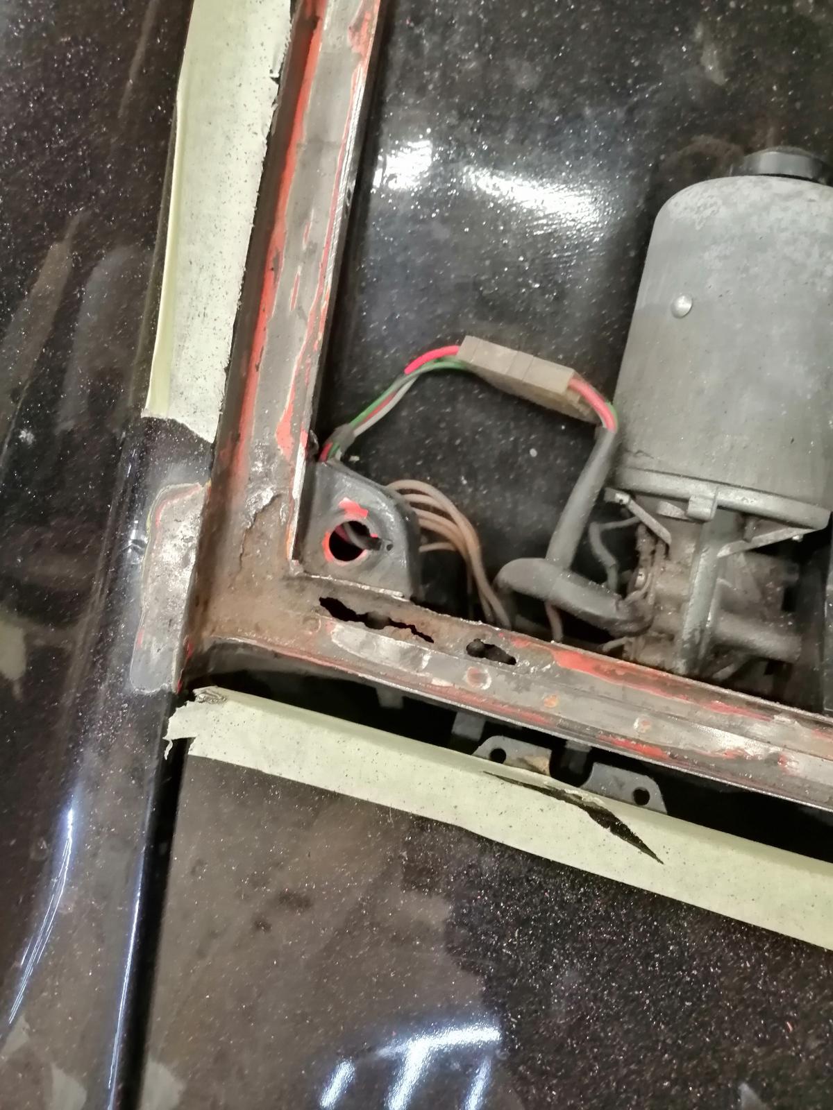

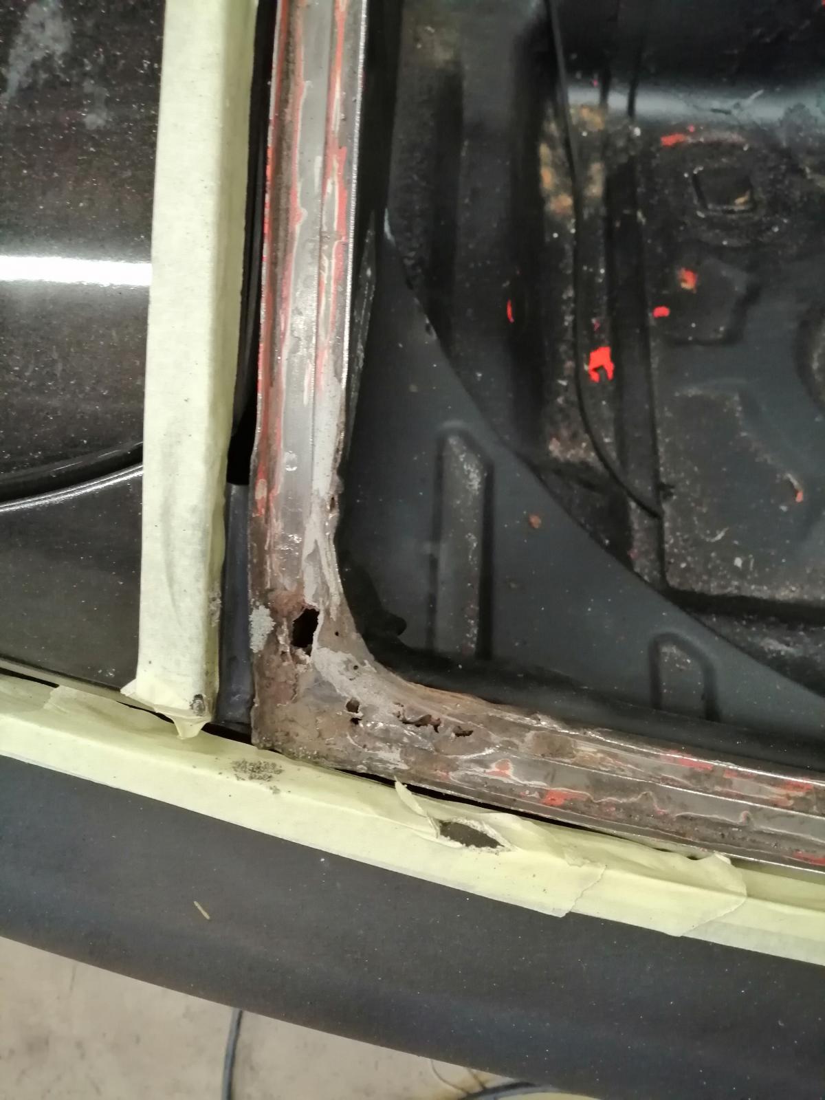

And I found holes after holes. I cut each of them and replaced with metal, I won't bore you with every single picture but here are a couple of examples, like here :
(IMG:http://www.914world.com/bbs2/uploads_offsite/www.thesamba.com-24690-1630251911.2.jpg)
(IMG:http://www.914world.com/bbs2/uploads_offsite/www.thesamba.com-24690-1630251911.3.jpg)
(IMG:http://www.914world.com/bbs2/uploads_offsite/www.thesamba.com-24690-1630251911.4.jpg)
(IMG:http://www.914world.com/bbs2/uploads_offsite/www.thesamba.com-24690-1630251912.5.jpg)

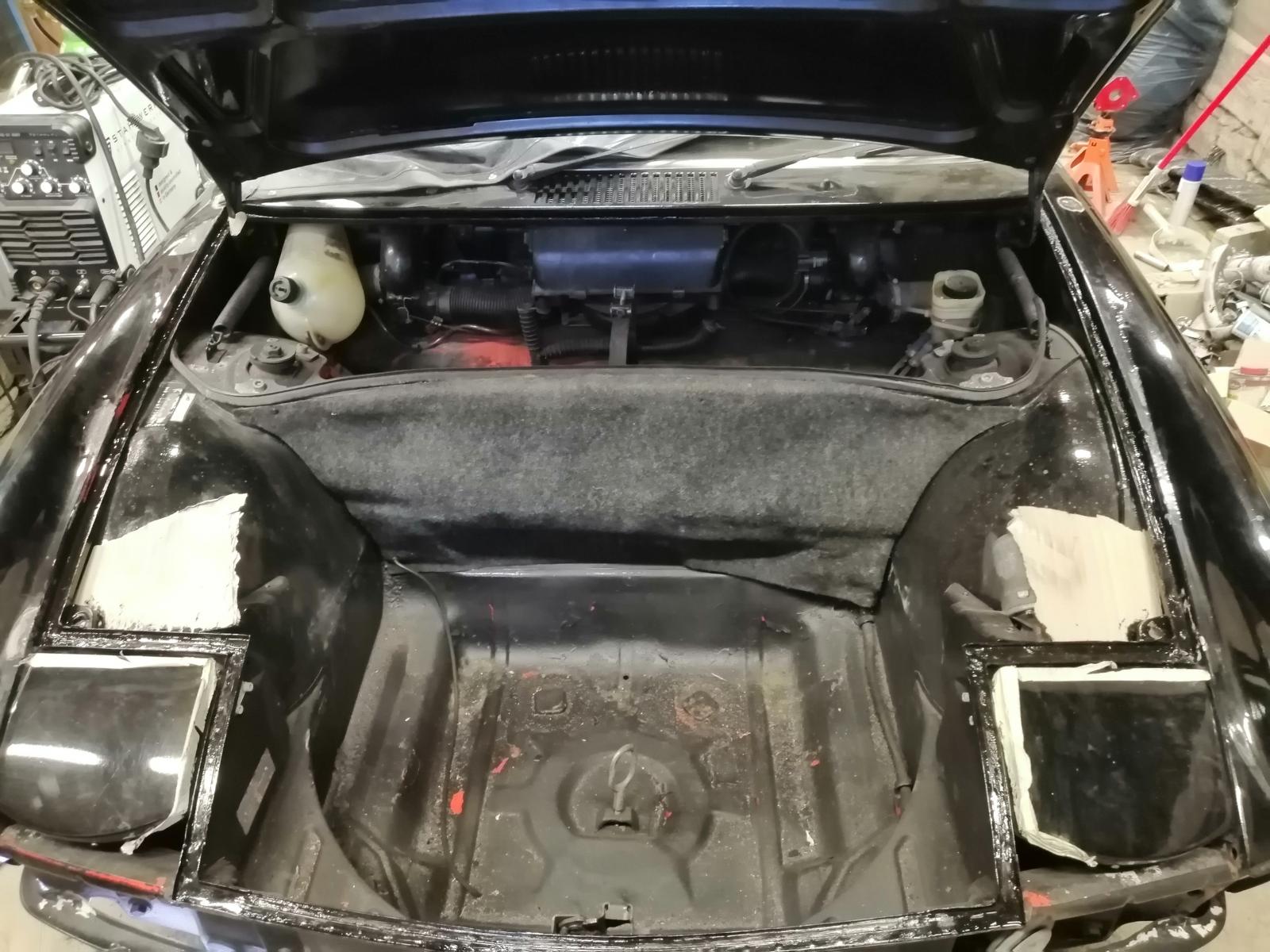

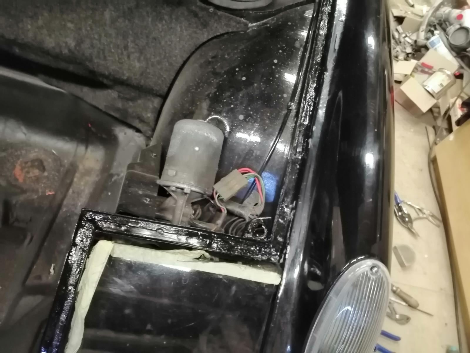

Afterward I put some primer and some paint for complete protection:
(IMG:http://www.914world.com/bbs2/uploads_offsite/www.thesamba.com-24690-1630251916.17.jpg)
(IMG:http://www.914world.com/bbs2/uploads_offsite/www.thesamba.com-24690-1630251916.18.jpg)
(IMG:http://www.914world.com/bbs2/uploads_offsite/www.thesamba.com-24690-1630251916.19.jpg)

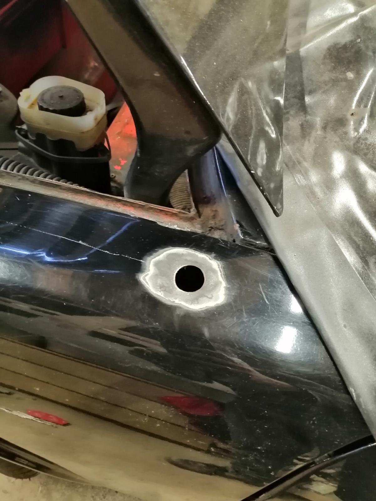

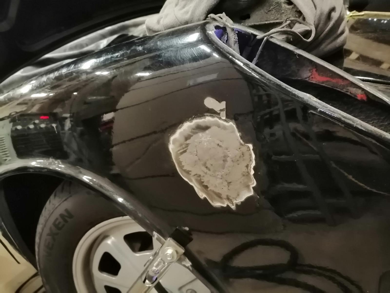

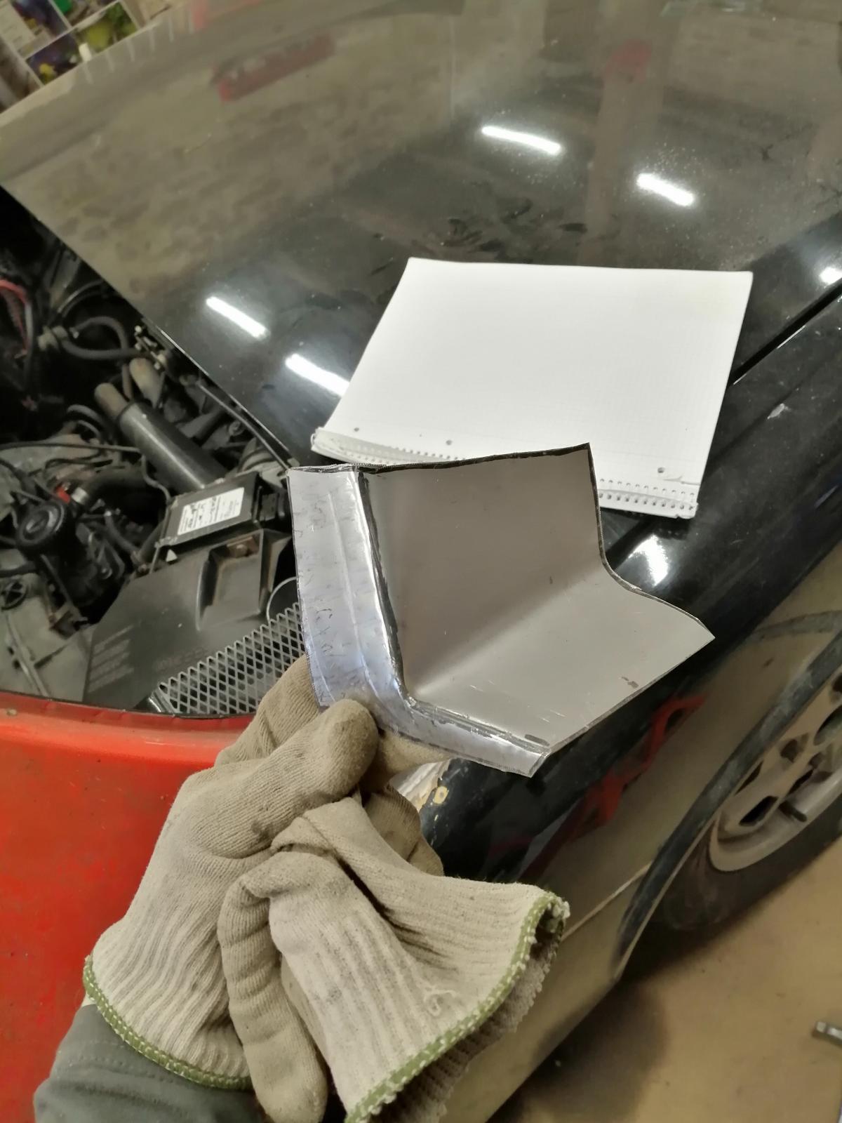

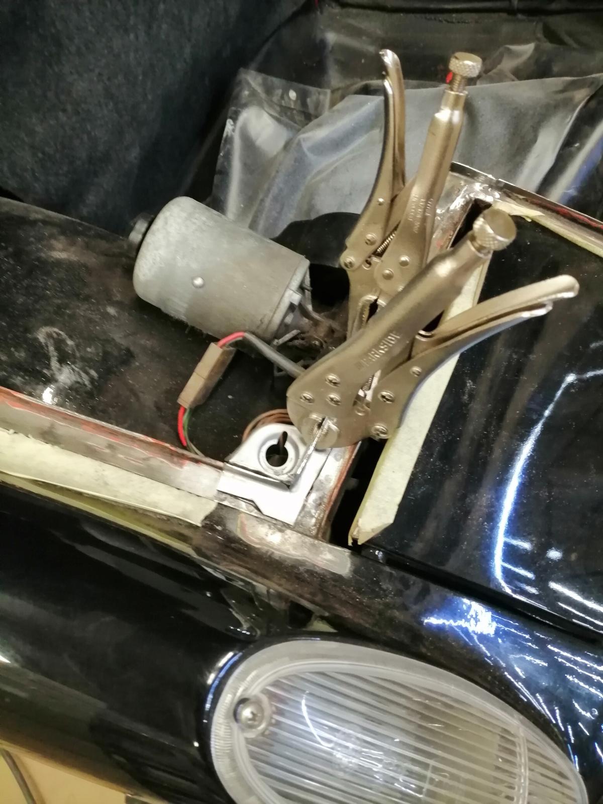

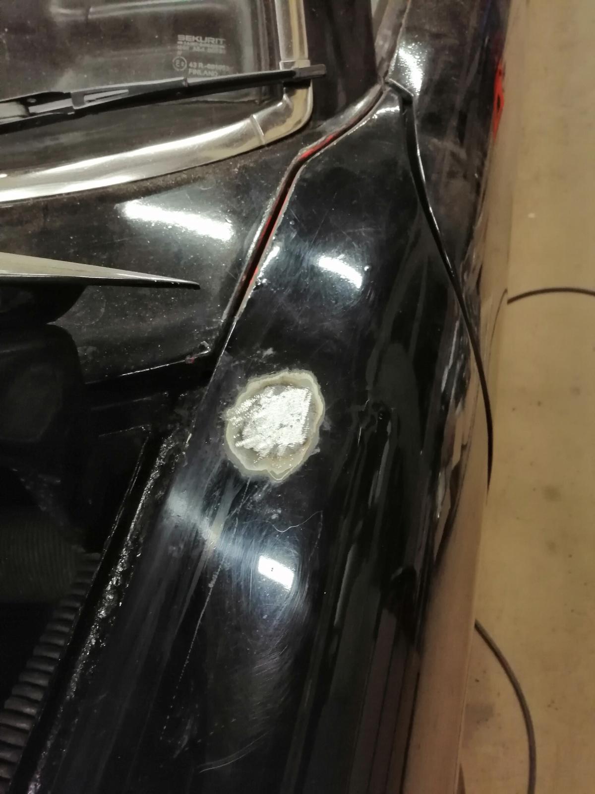

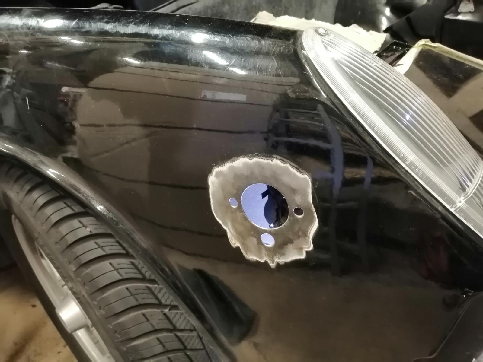

As I was already working on the front, I removed the side markers and the antenna (no radio on a lightweight project !) :
(IMG:http://www.914world.com/bbs2/uploads_offsite/www.thesamba.com-24690-1630251917.20.jpg)
(IMG:http://www.914world.com/bbs2/uploads_offsite/www.thesamba.com-24690-1630251917.21.jpg)
(IMG:http://www.914world.com/bbs2/uploads_offsite/www.thesamba.com-24690-1630251917.22.jpg)
(IMG:http://www.914world.com/bbs2/uploads_offsite/www.thesamba.com-24690-1630251918.23.jpg)

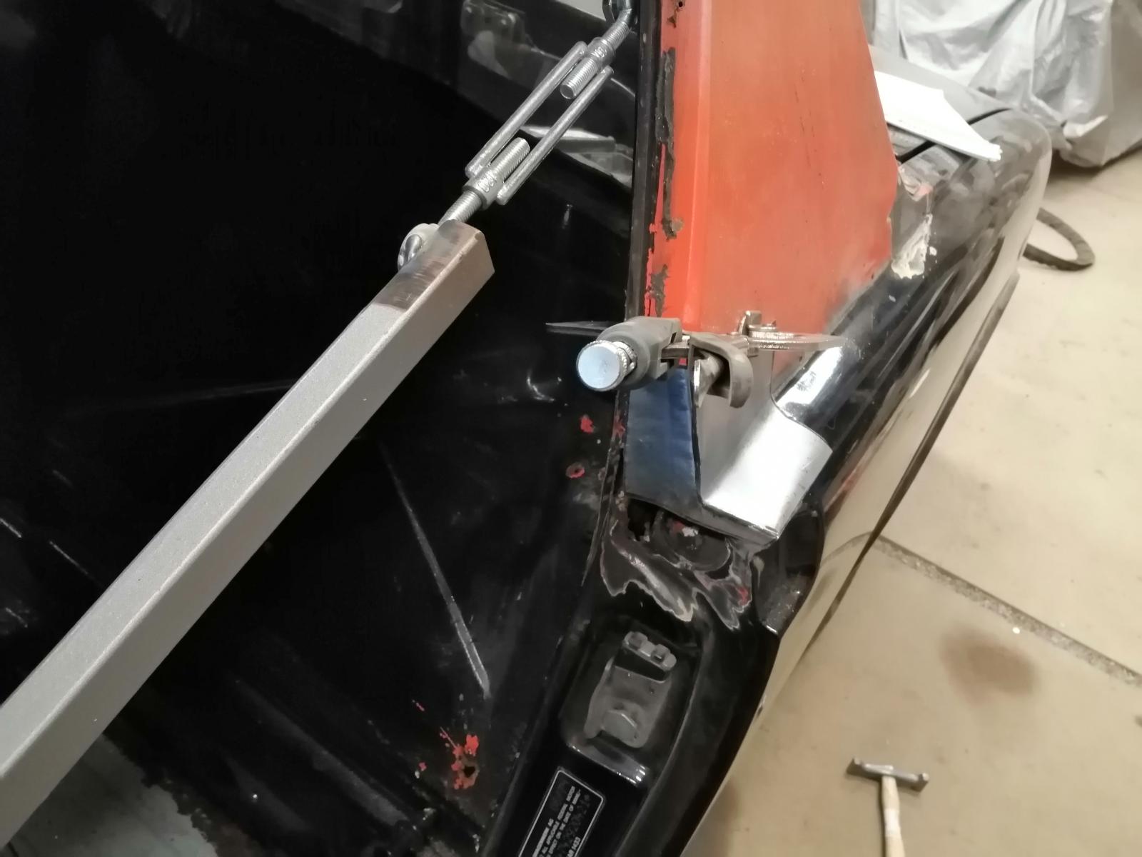

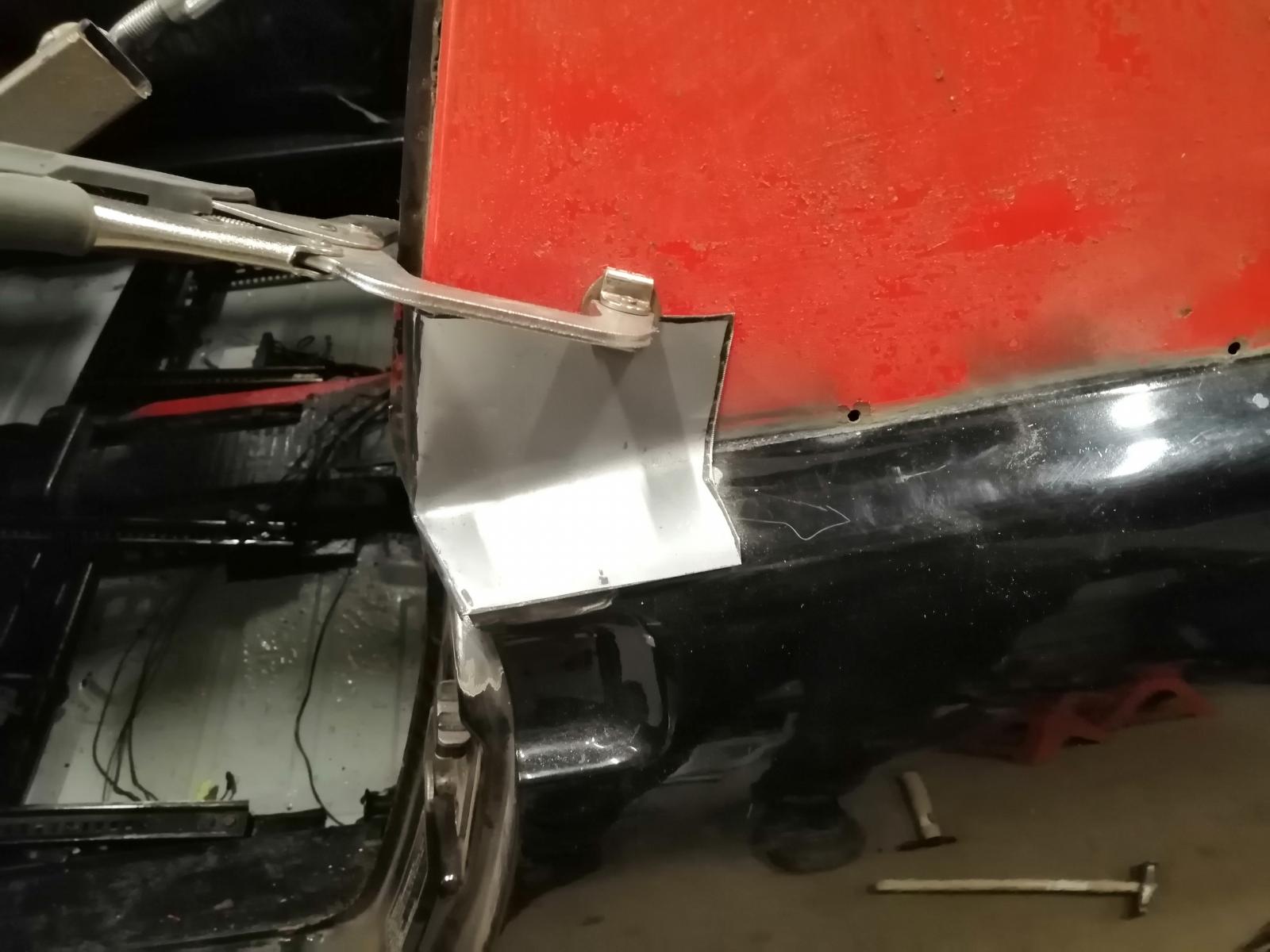

And started the first part for my B-Pillar:
(IMG:http://www.914world.com/bbs2/uploads_offsite/www.thesamba.com-24690-1630251918.24.jpg)
(IMG:http://www.914world.com/bbs2/uploads_offsite/www.thesamba.com-24690-1630251918.25.jpg)
(IMG:http://www.914world.com/bbs2/uploads_offsite/www.thesamba.com-24690-1630251919.26.jpg)
The next update comes as soon as I have some time to post it!
