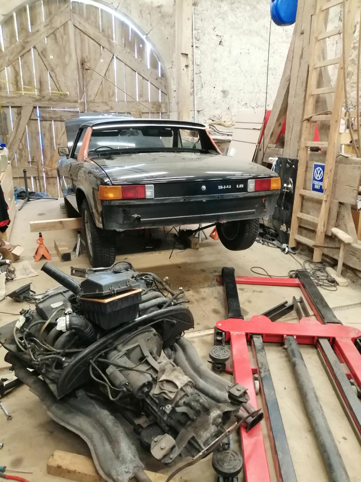

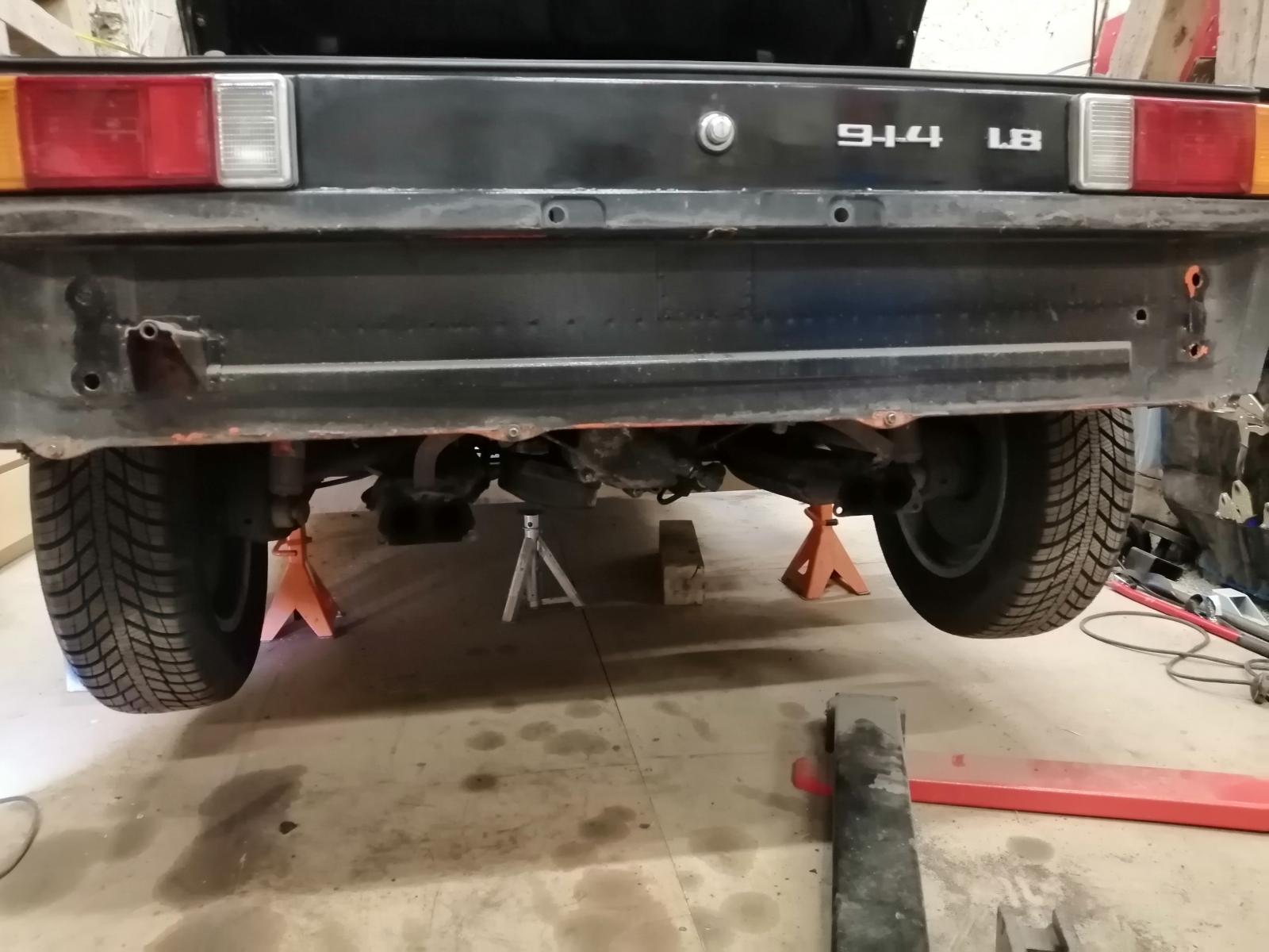

I put the rear up in the air:
(IMG:http://www.914world.com/bbs2/uploads_offsite/www.thesamba.com-24690-1630610255.1.jpg)
And removed the engine :
(IMG:http://www.914world.com/bbs2/uploads_offsite/www.thesamba.com-24690-1630610256.2.jpg)

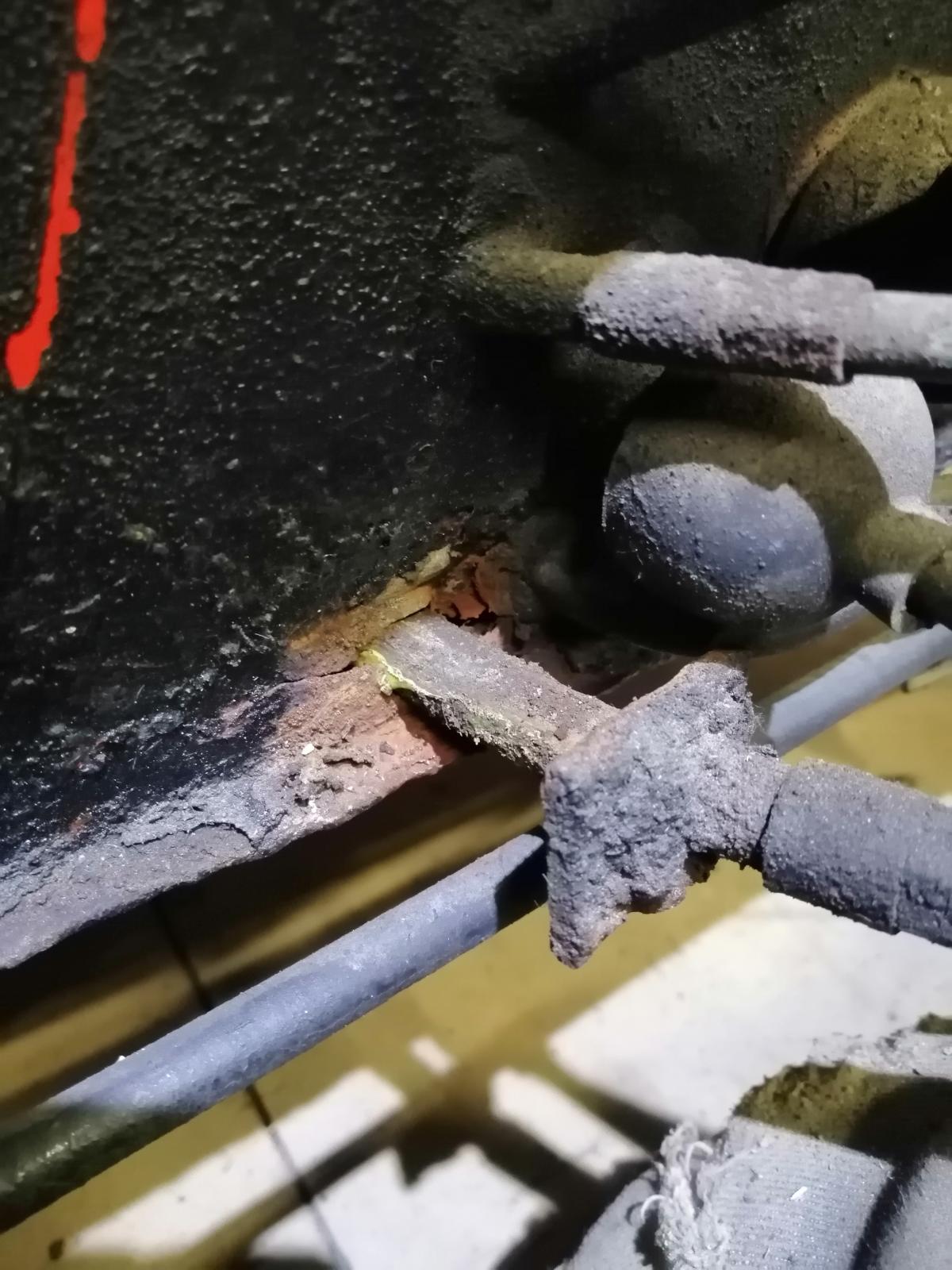

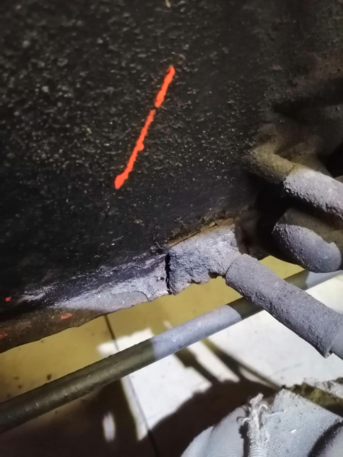

And the started to investigate..
Found some rust here at the bottom of the firewall :
(IMG:http://www.914world.com/bbs2/uploads_offsite/www.thesamba.com-24690-1630610256.3.jpg)

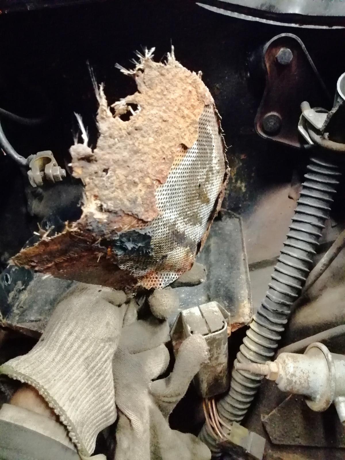

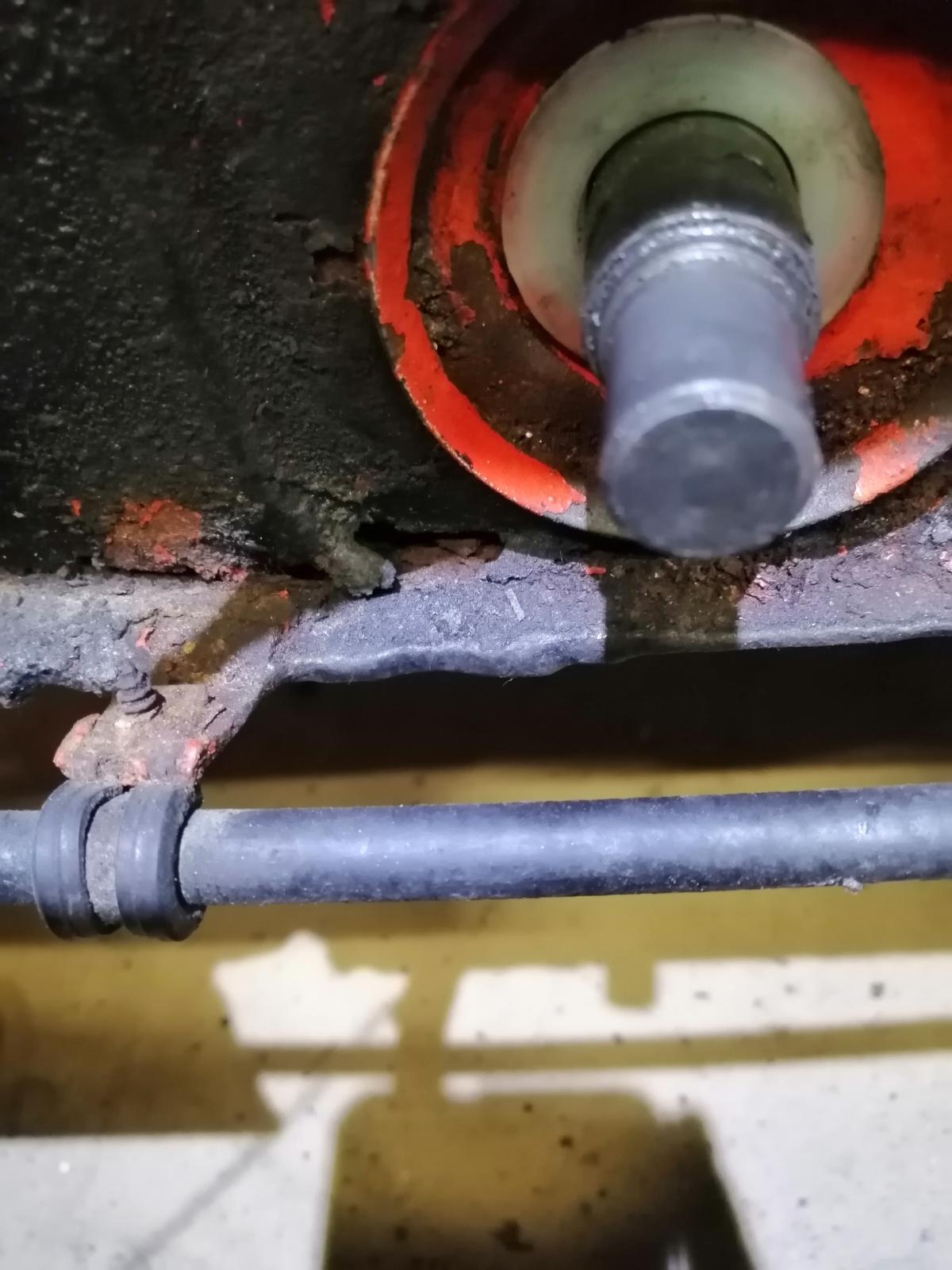

And what looked like a "sh**ty fix" for the clutch cable tube:
(IMG:http://www.914world.com/bbs2/uploads_offsite/www.thesamba.com-24690-1630610257.4.jpg)
Is worse than that..the tube just moves freely like that!!
(IMG:http://www.914world.com/bbs2/uploads_offsite/www.thesamba.com-24690-1630610257.5.jpg)

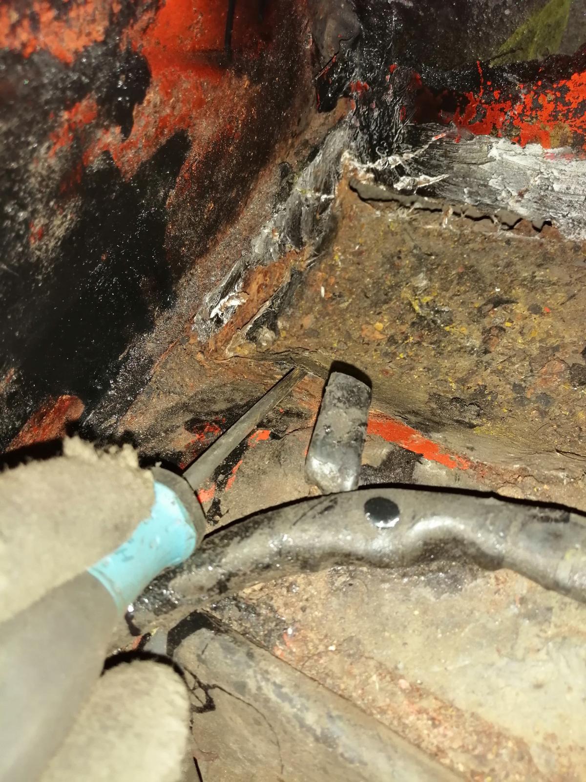

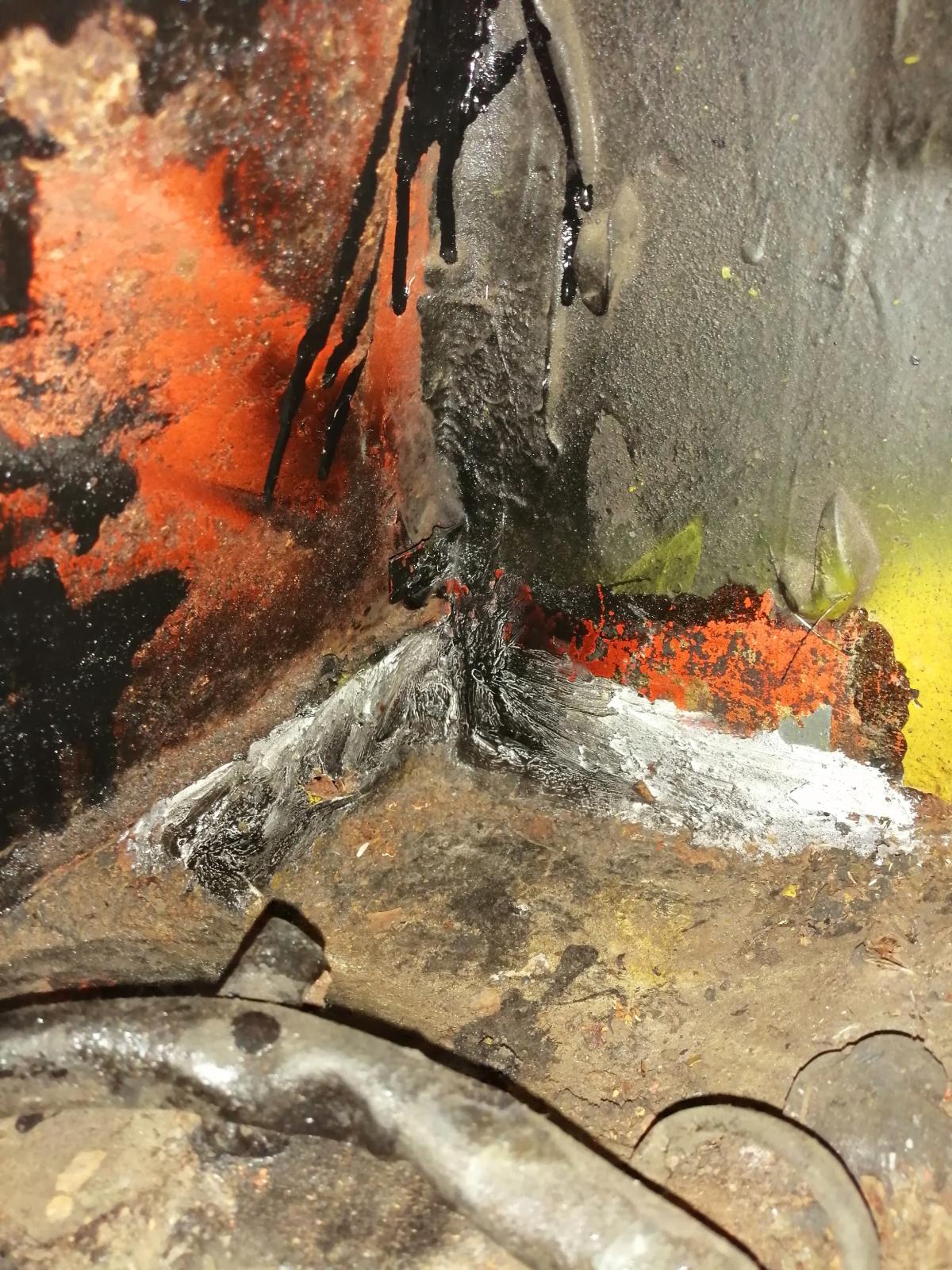

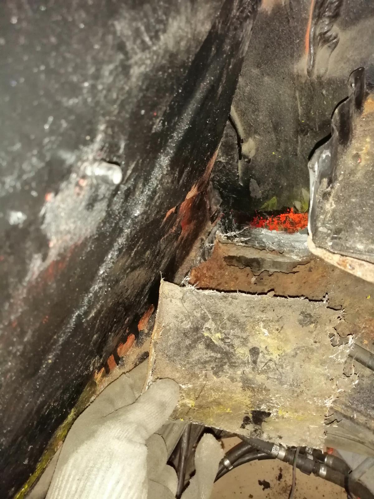

And the big question.. The hell hole.. Well, when I bought it, I couldn't disassemble much so I checked with my hand - no holes - and tried with a screwdriver-everything robust.. So I thought to be safe..
Then I checked after engine removal:
(IMG:http://www.914world.com/bbs2/uploads_offsite/www.thesamba.com-24690-1630610257.6.jpg)
And after a better check with my screwdriver..
(IMG:http://www.914world.com/bbs2/uploads_offsite/www.thesamba.com-24690-1630610258.7.jpg)

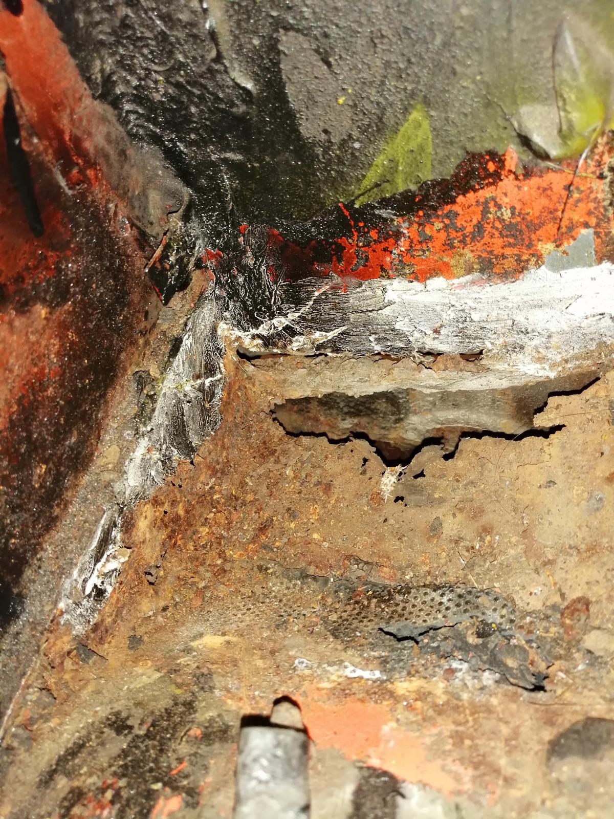

Here is what I found:
(IMG:http://www.914world.com/bbs2/uploads_offsite/www.thesamba.com-24690-1630610258.8.jpg)
(IMG:http://www.914world.com/bbs2/uploads_offsite/www.thesamba.com-24690-1630610258.9.jpg)
A real disaster:
(IMG:http://www.914world.com/bbs2/uploads_offsite/www.thesamba.com-24690-1630610259.10.jpg)

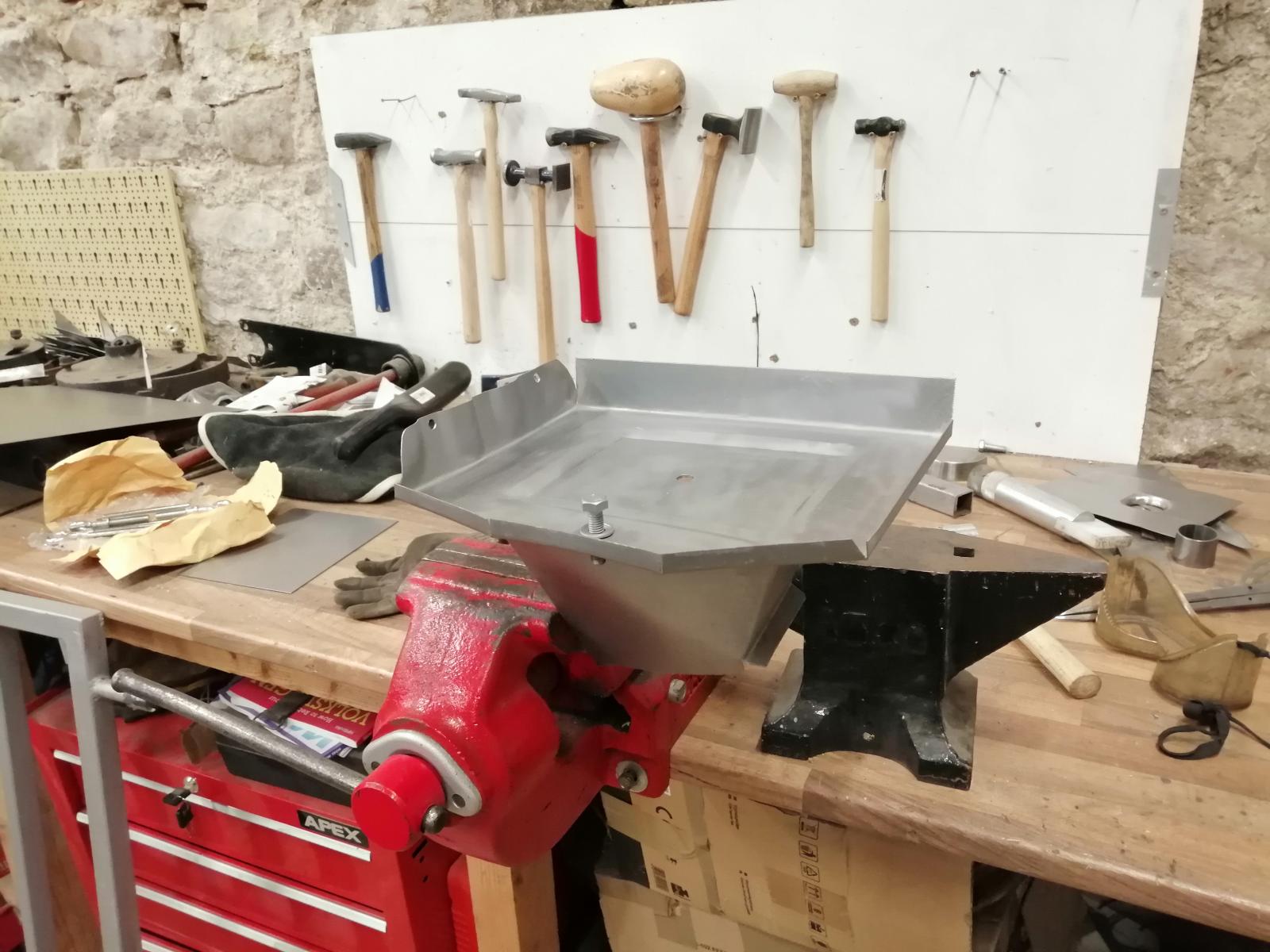

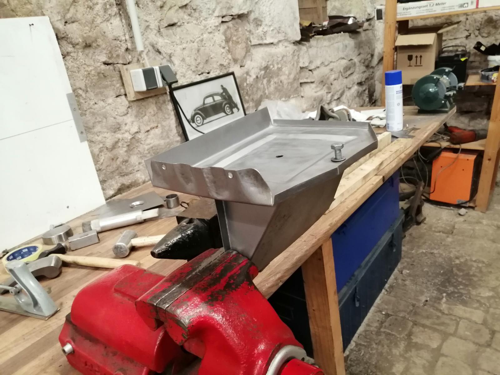

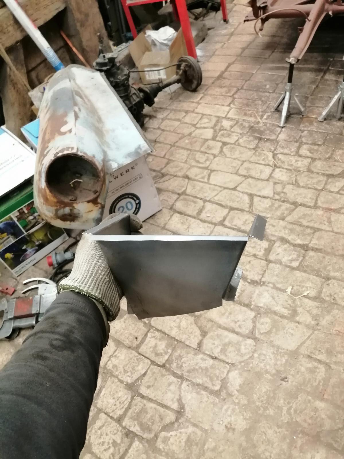

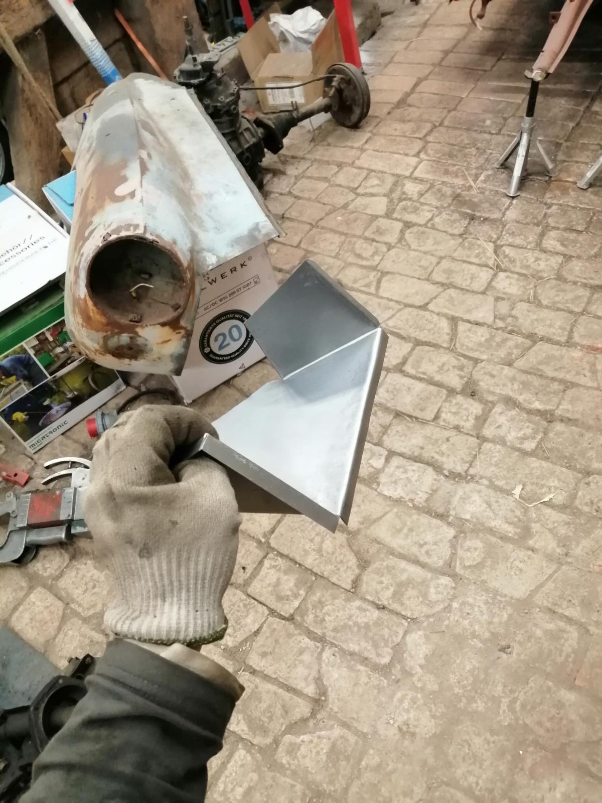

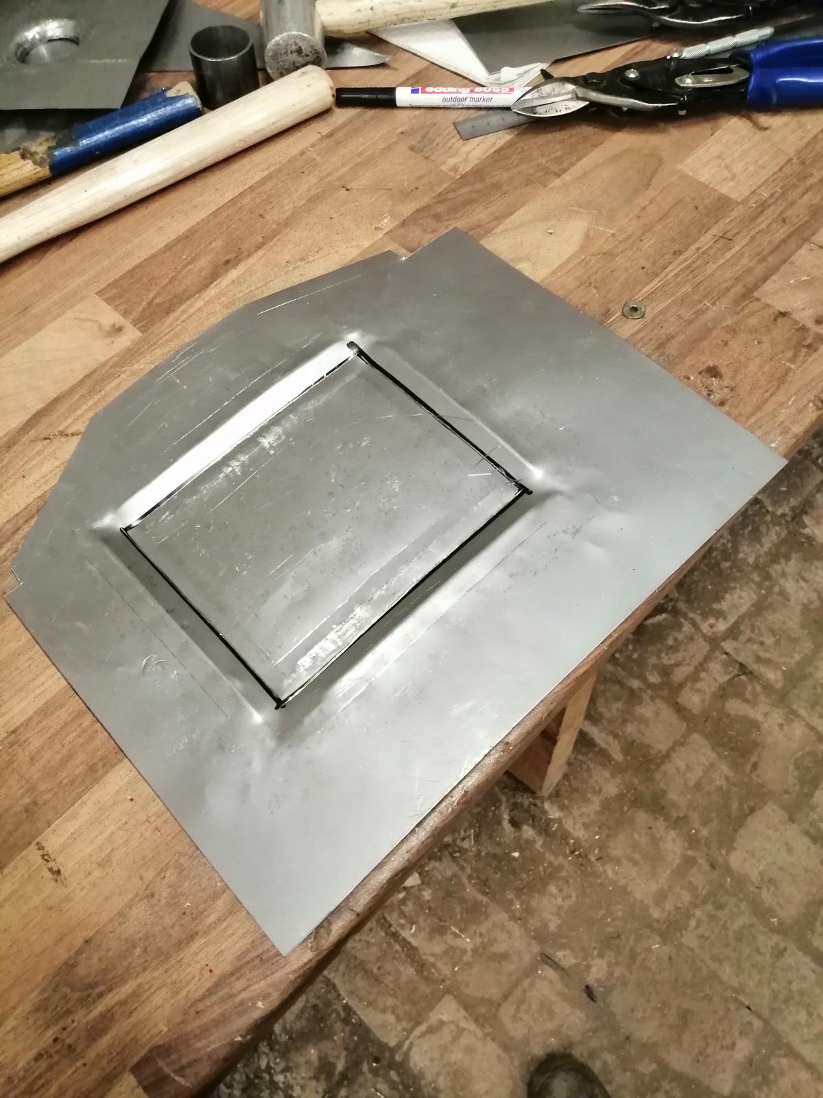

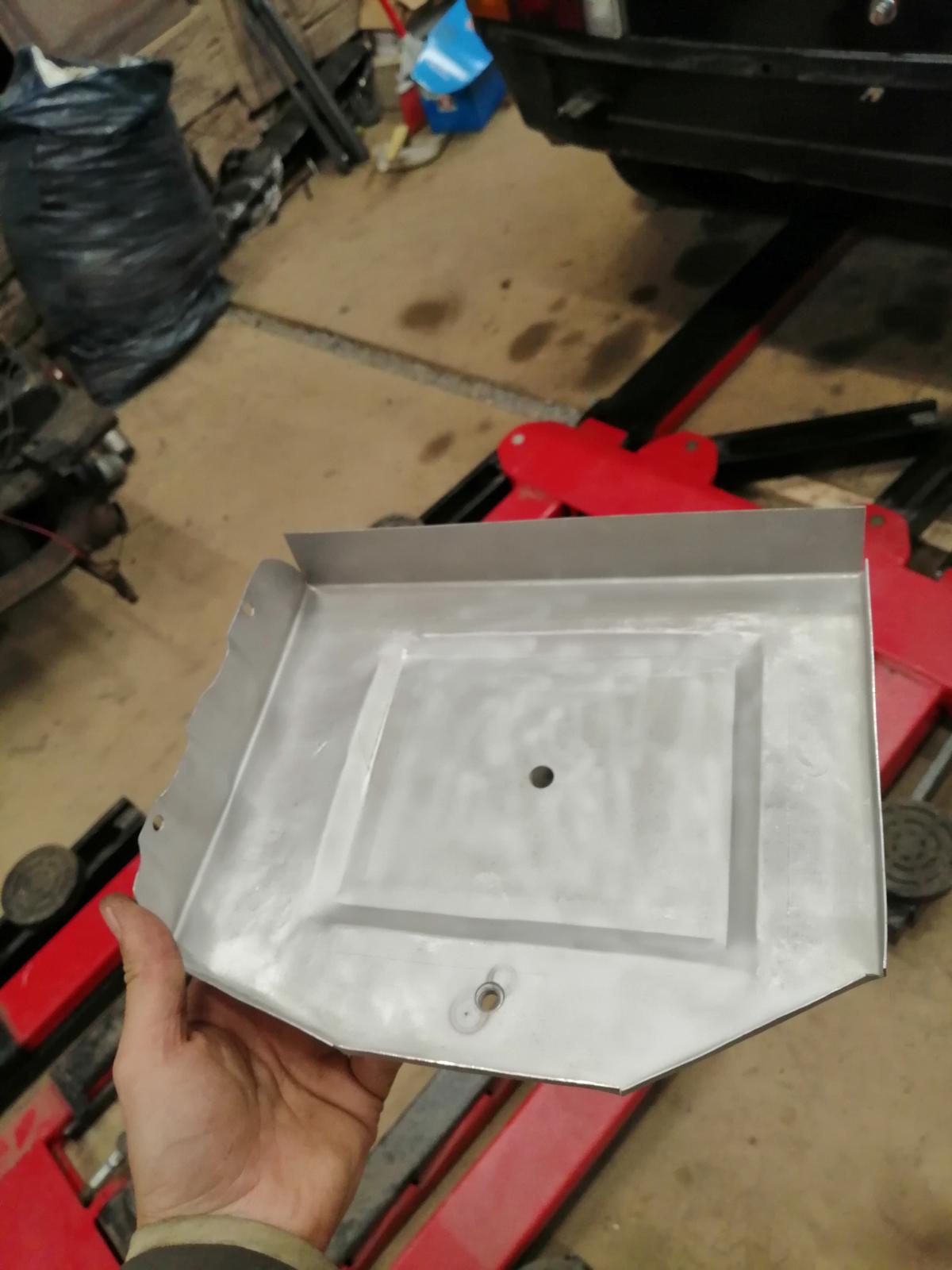

But I am not a guy that let something like that discorage himself. So I need to remove my battery tray to check further and make my plan.. But before that, and before probably destroying the old one by disassembling.. I built the replacement one:
(IMG:http://www.914world.com/bbs2/uploads_offsite/www.thesamba.com-24690-1630610259.11.jpg)
(IMG:http://www.914world.com/bbs2/uploads_offsite/www.thesamba.com-24690-1630610260.12.jpg)
(IMG:http://www.914world.com/bbs2/uploads_offsite/www.thesamba.com-24690-1630610260.13.jpg)
(IMG:http://www.914world.com/bbs2/uploads_offsite/www.thesamba.com-24690-1630610260.14.jpg)
(IMG:http://www.914world.com/bbs2/uploads_offsite/www.thesamba.com-24690-1630610261.15.jpg)

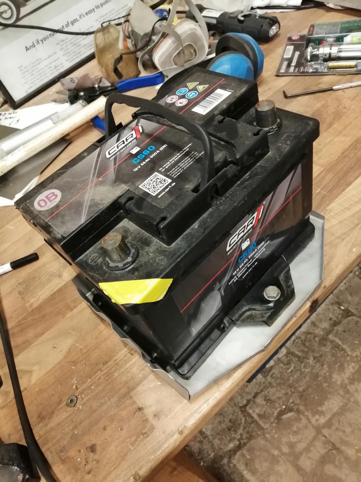

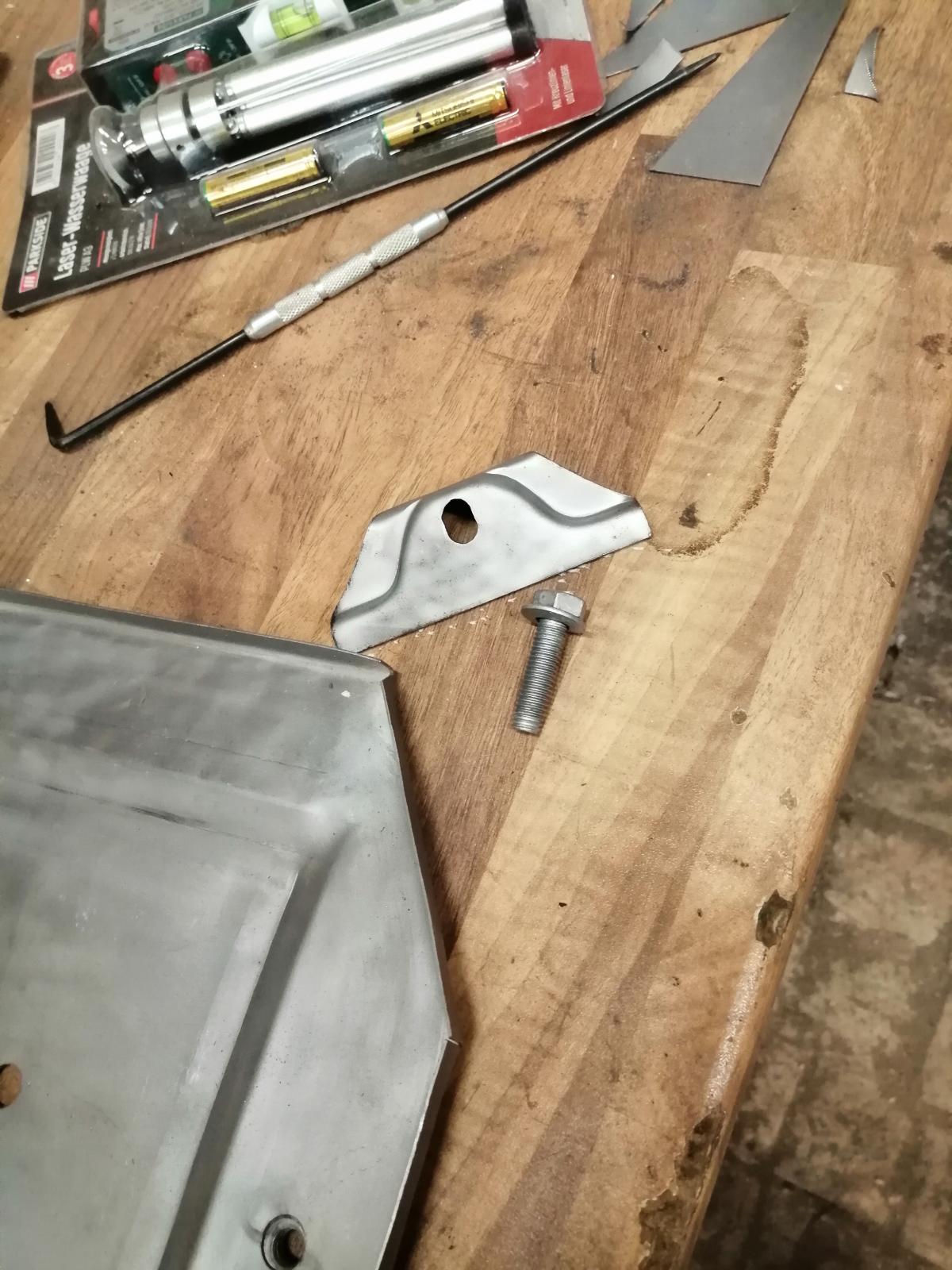

Check with the battery and the fixation sandblasted:
(IMG:http://www.914world.com/bbs2/uploads_offsite/www.thesamba.com-24690-1630610261.16.jpg)
(IMG:http://www.914world.com/bbs2/uploads_offsite/www.thesamba.com-24690-1630610261.17.jpg)

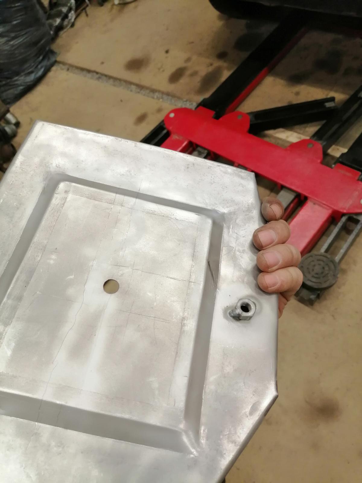

And the bottom part:
(IMG:http://www.914world.com/bbs2/uploads_offsite/www.thesamba.com-24690-1630610262.18.jpg)
(IMG:http://www.914world.com/bbs2/uploads_offsite/www.thesamba.com-24690-1630610262.19.jpg)
(IMG:http://www.914world.com/bbs2/uploads_offsite/www.thesamba.com-24690-1630610263.20.jpg)
Ready to go after the hell hole repair:
(IMG:http://www.914world.com/bbs2/uploads_offsite/www.thesamba.com-24690-1630610263.21.jpg)
(IMG:http://www.914world.com/bbs2/uploads_offsite/www.thesamba.com-24690-1630610263.22.jpg)
