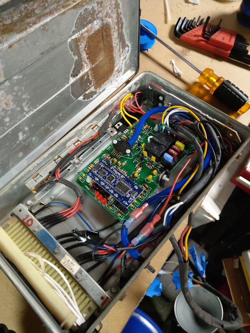

For 15 or so years I ran various Megasquirt builds through a 100% unmolested d-jet wiring harness just to show it could be done. It was a continuous evolution that I kept hacking new features into over the years.
This was the final version I pulled out of the car last year to replace it with a Microsquirt and fully custom harness. There was more I was going to add to it but decided it was time to switch over to something a little more "sane'
You probably wont recognize the board because its not an officially licensed MS board but rather a custom board based on the early 2.2 circuit diagram.
Dont try this at home...
Seriously, after 15 years I can give you all the reasons you dont want to do something like this.
This was how it originally looked before the additional inline hacks to add more functionality.
I wont show you the earlier versions I ran using the official Megasquirt 2.2 board as they were not at all pretty. I was in my 20s, poor, and still had a lot to learn. Think my first running MS conversion cost me somewhere around 100 bucks. Things have changed a lot since then.
