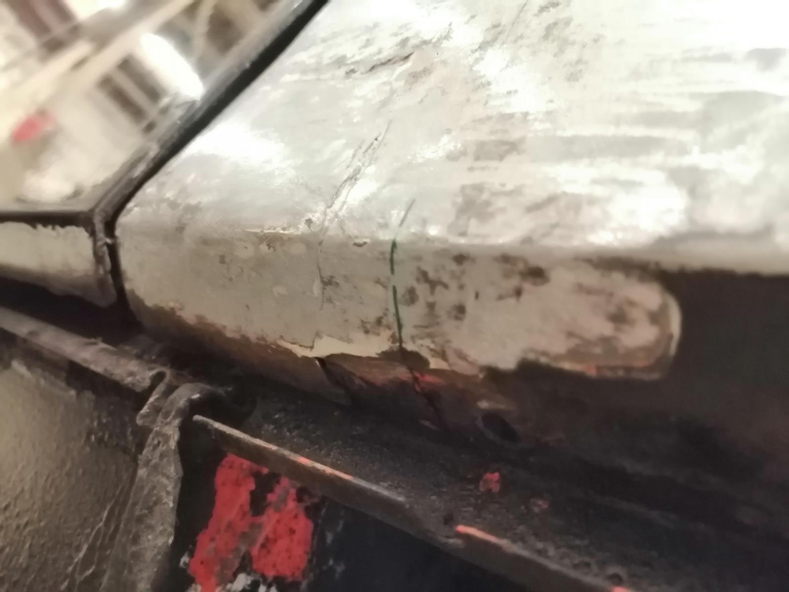

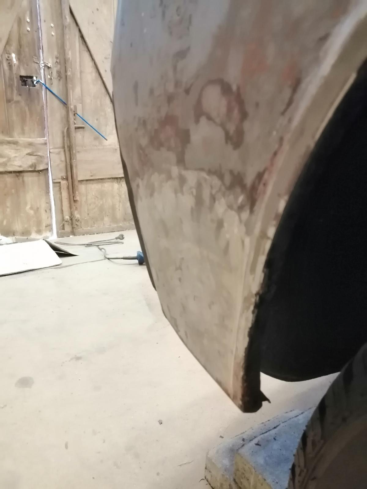

So, I did some more work on this toy and an update is long overdue!

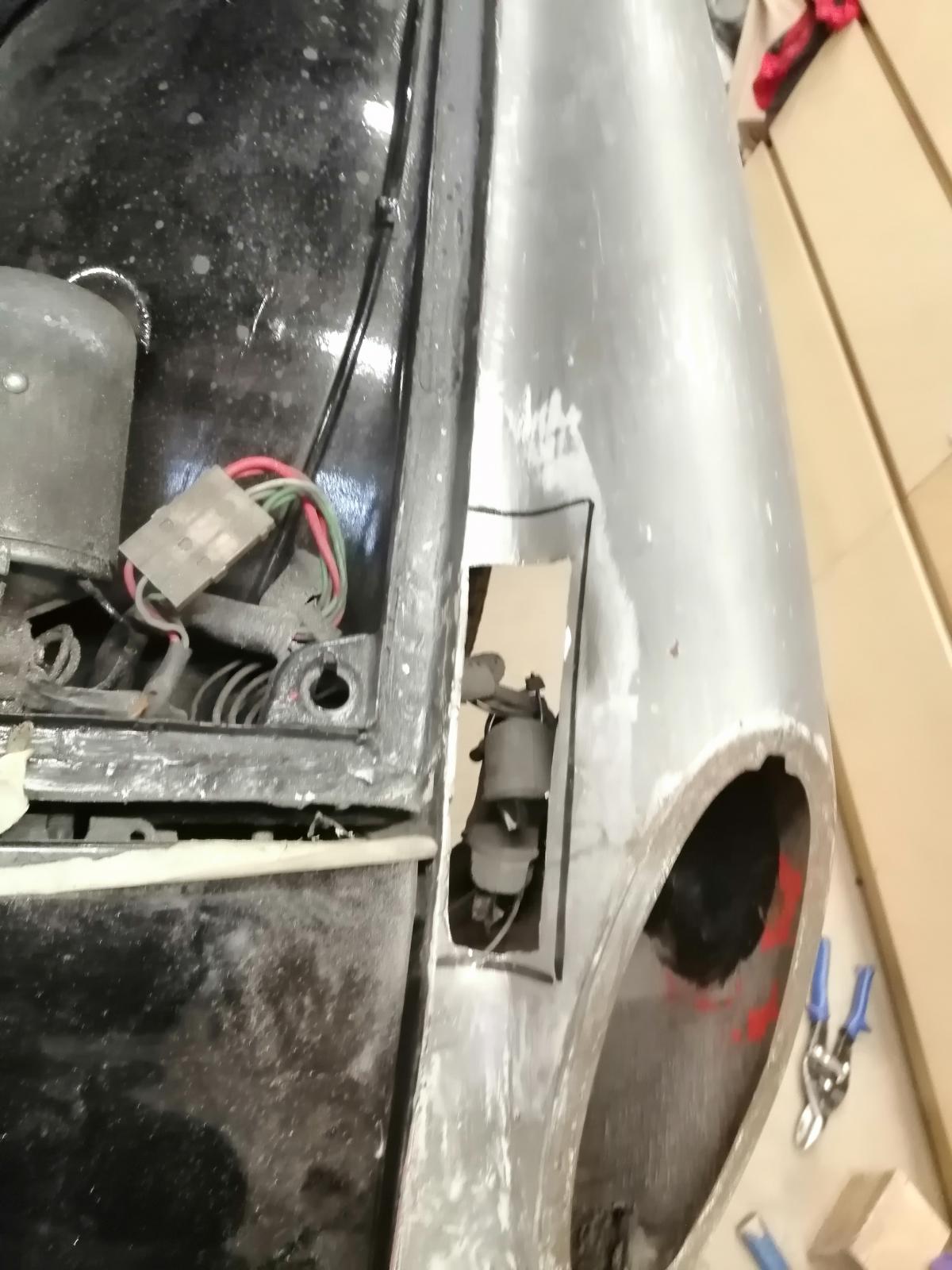

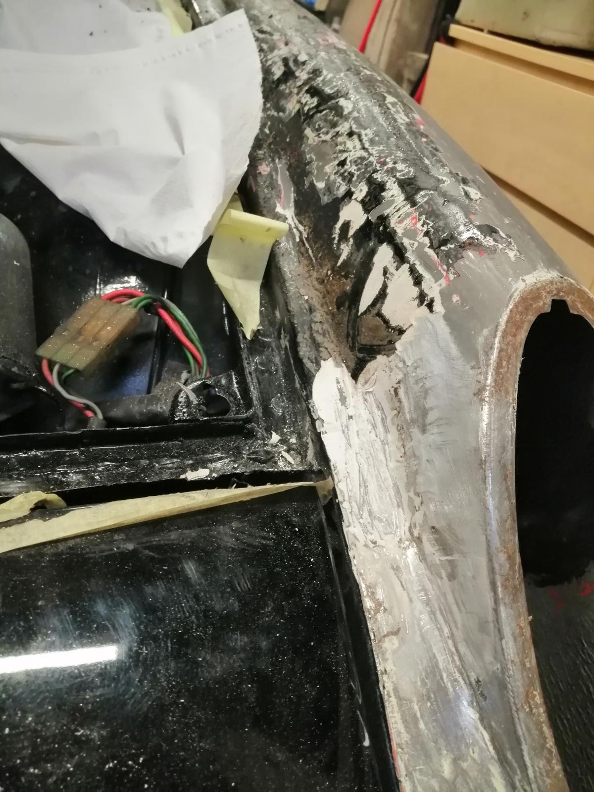

As I already did start the work on the front, I decided to make sûre nothing is hidden there under the paint..
(IMG:http://www.914world.com/bbs2/uploads_offsite/www.thesamba.com-24690-1631714664.1.jpg)

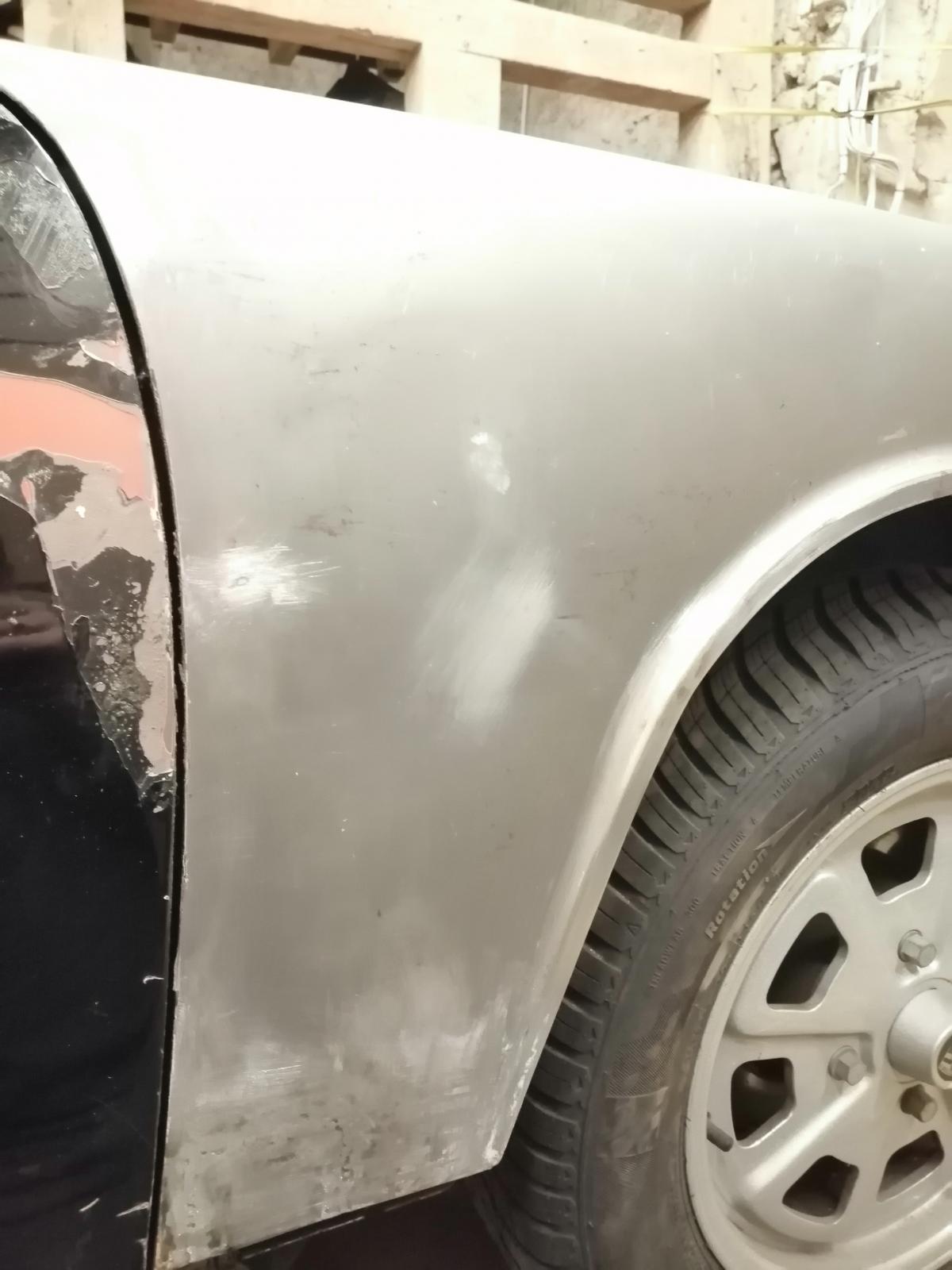

Well of course some (bondo-) surprises were there...

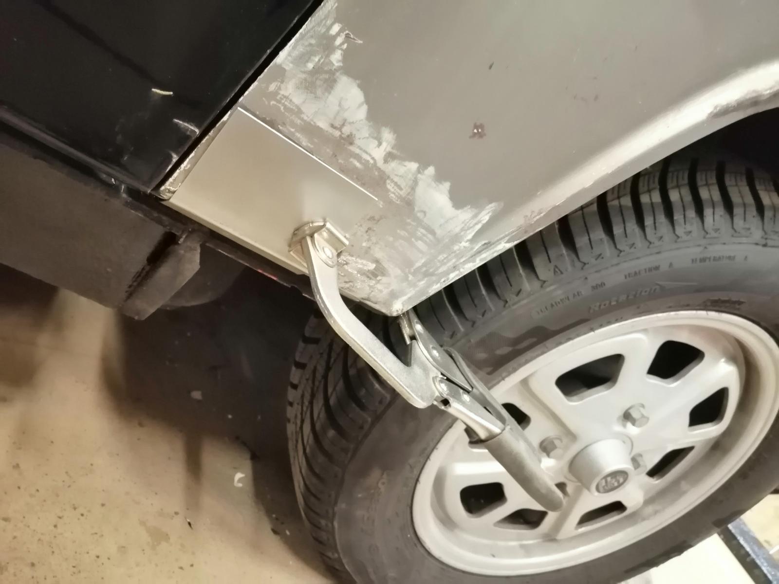

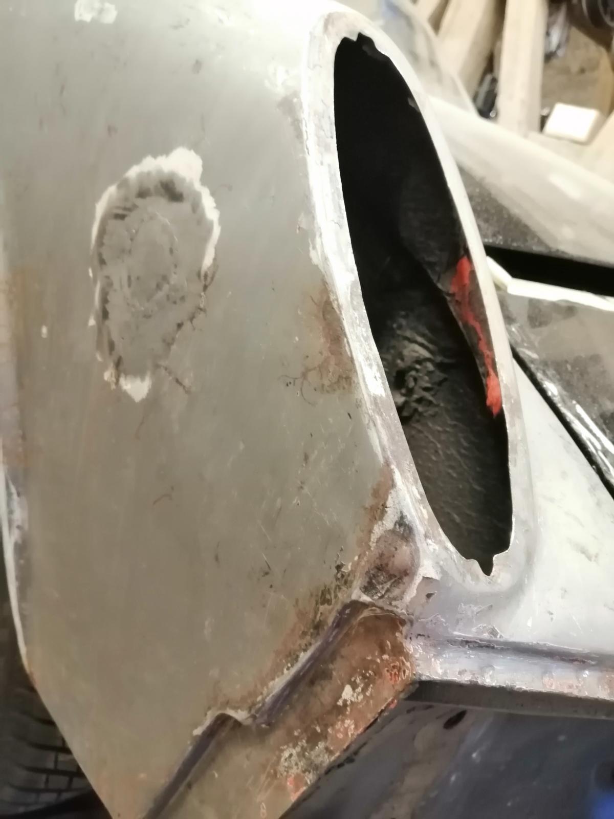

Here a big dent, that I took care of using dolly/hammer:
(IMG:http://www.914world.com/bbs2/uploads_offsite/www.thesamba.com-24690-1631714665.2.jpg)

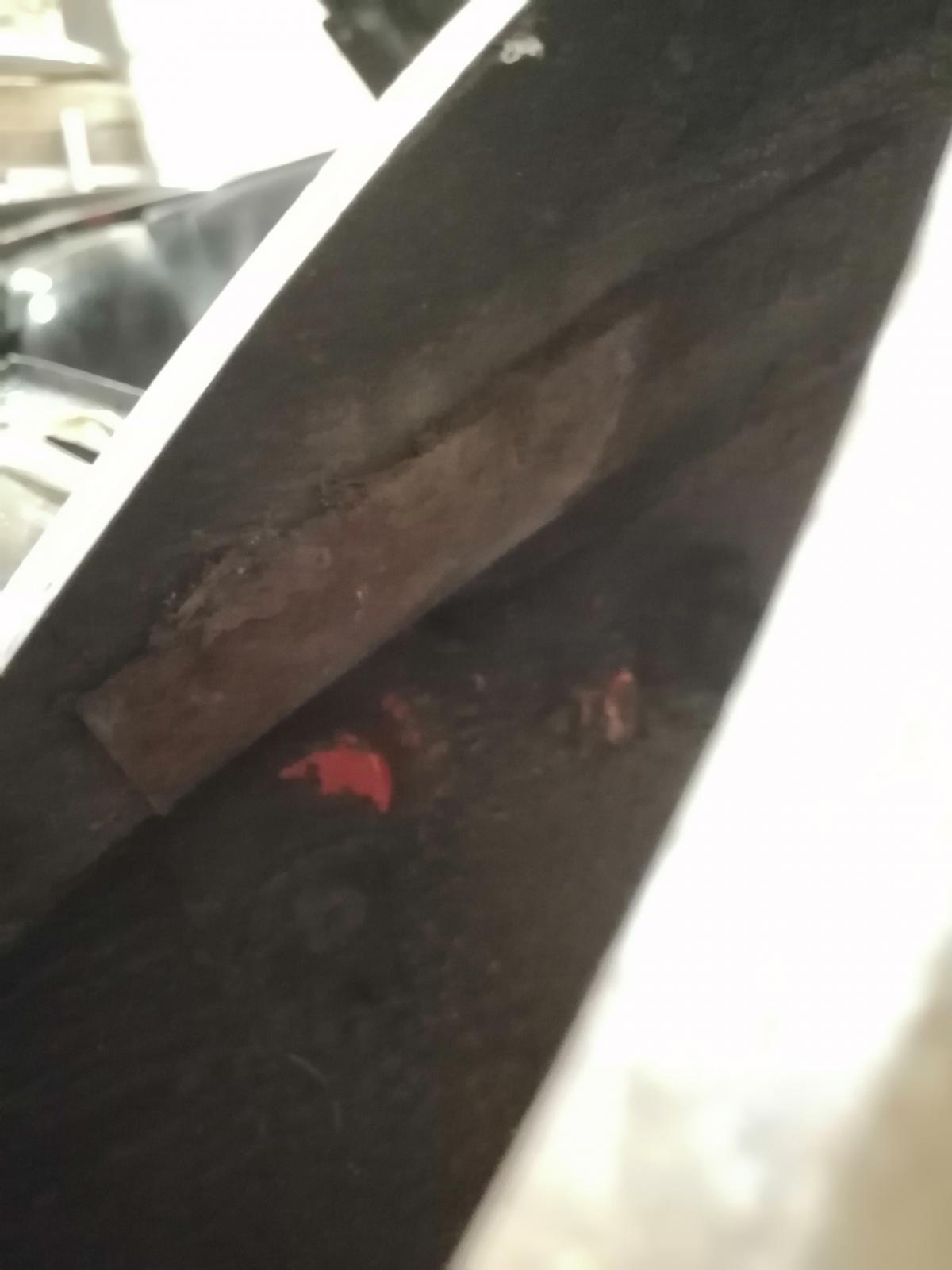

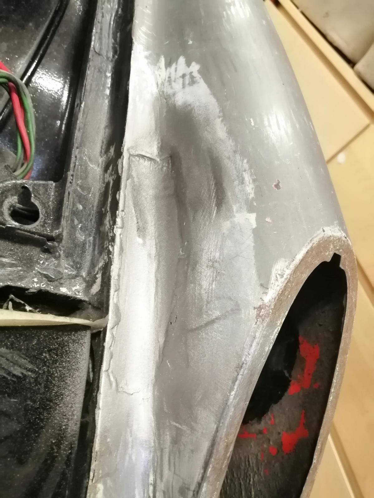

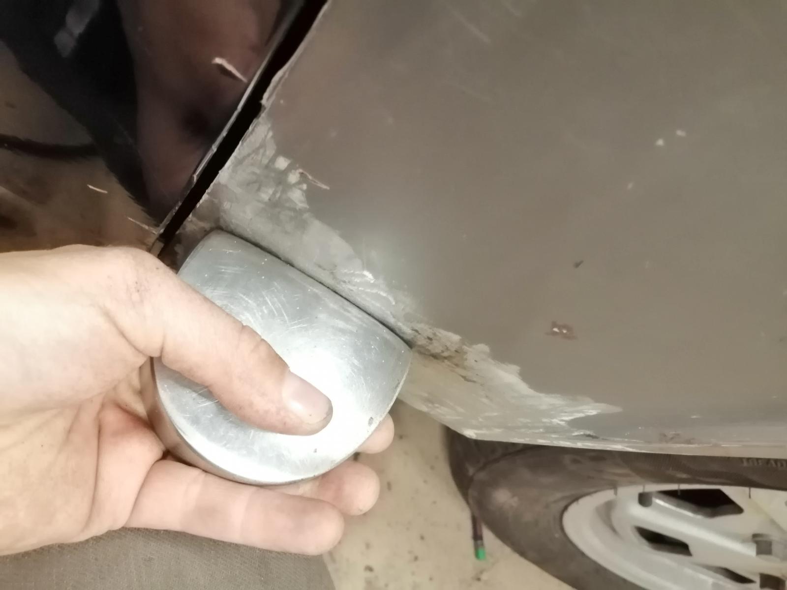

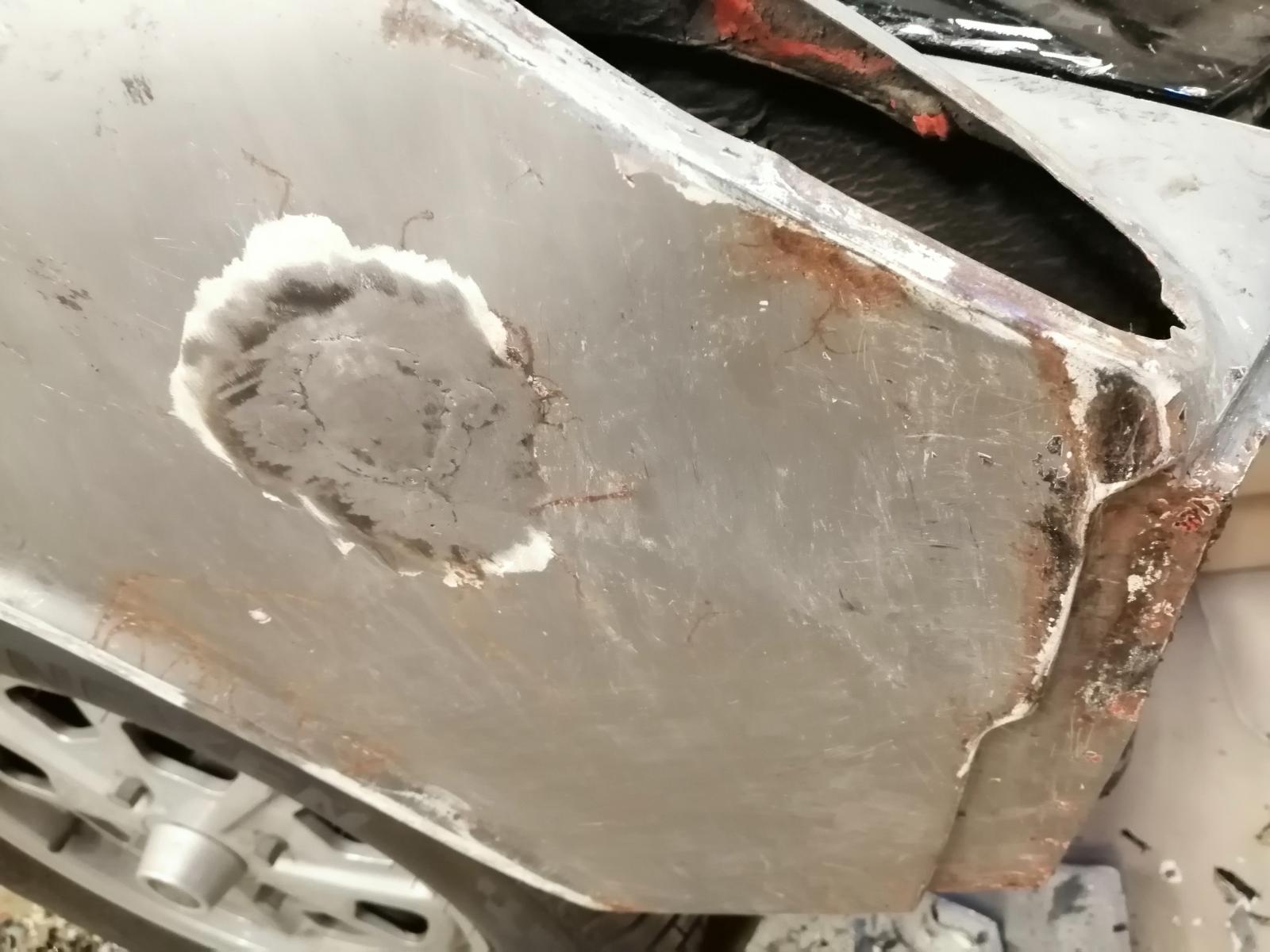

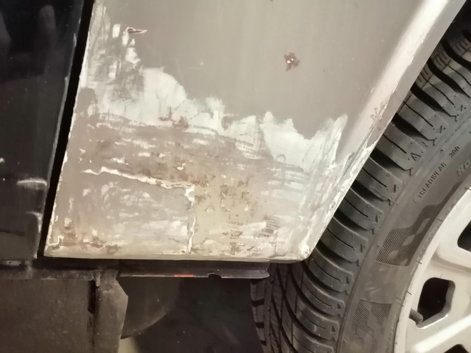

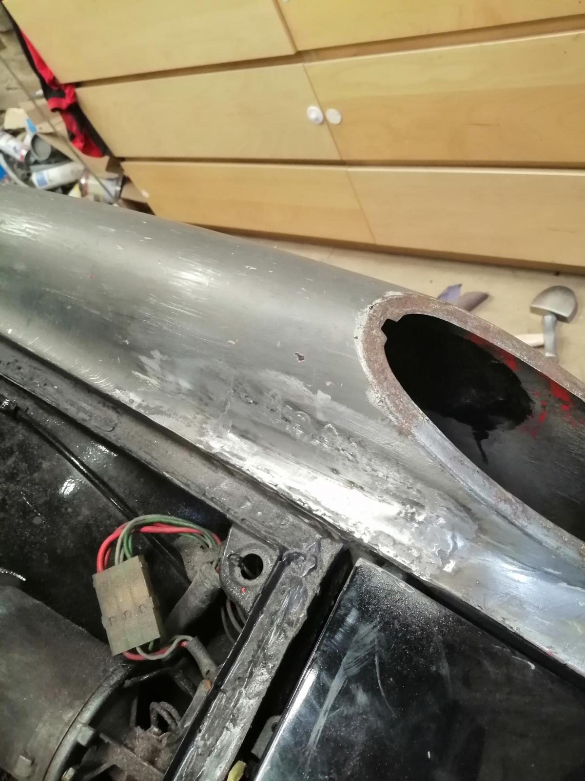

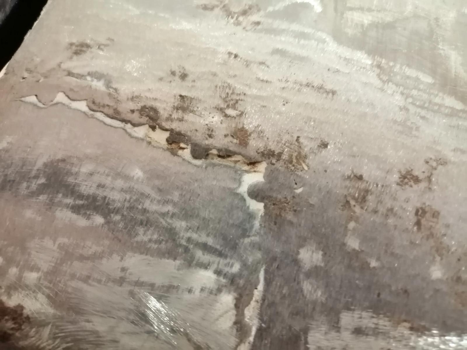

And here.. There was a lot of bondo and under it a "fix", by the way of a plate under the rust hole.. Here to see:
(IMG:http://www.914world.com/bbs2/uploads_offsite/www.thesamba.com-24690-1631714665.3.jpg)
(IMG:http://www.914world.com/bbs2/uploads_offsite/www.thesamba.com-24690-1631714665.4.jpg)
(IMG:http://www.914world.com/bbs2/uploads_offsite/www.thesamba.com-24690-1631714666.5.jpg)

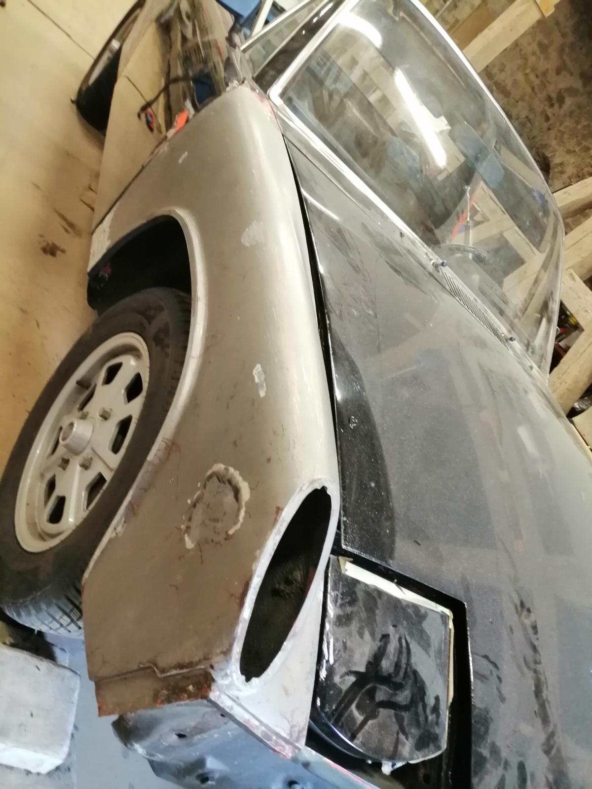

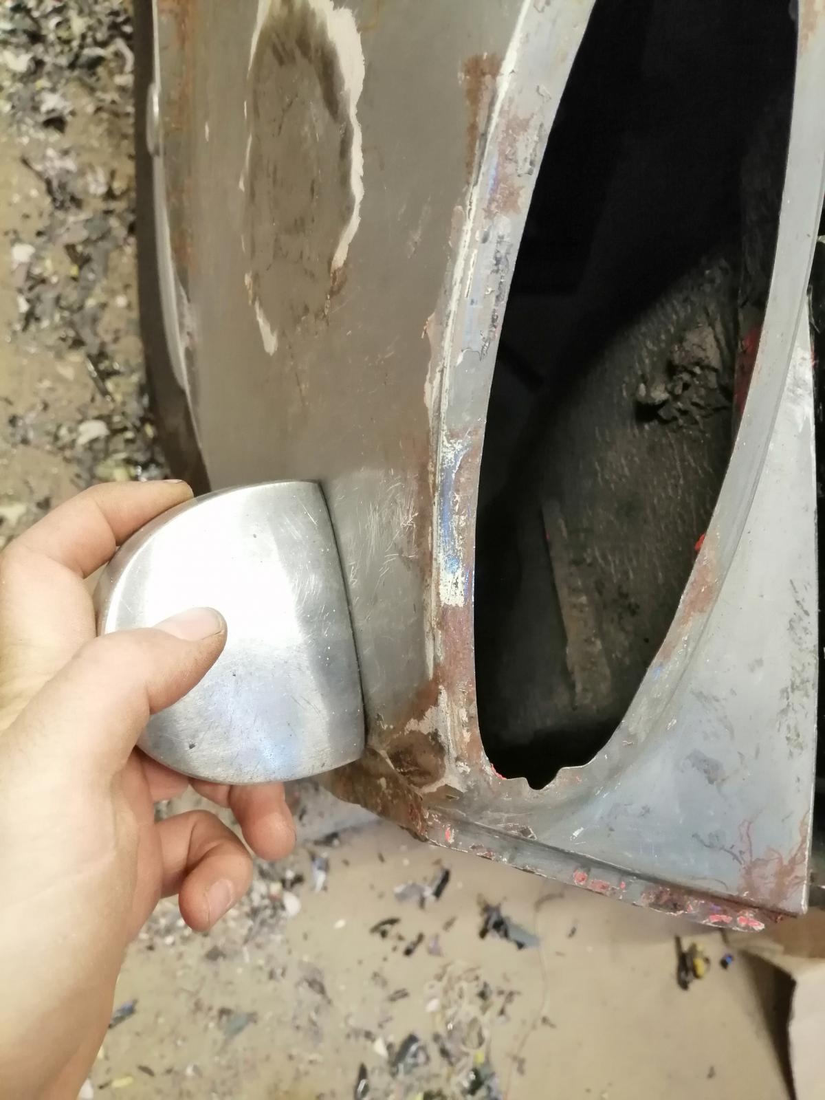

So I of course couldn't let it, so cut this bad work:
(IMG:http://www.914world.com/bbs2/uploads_offsite/www.thesamba.com-24690-1631714666.6.jpg)

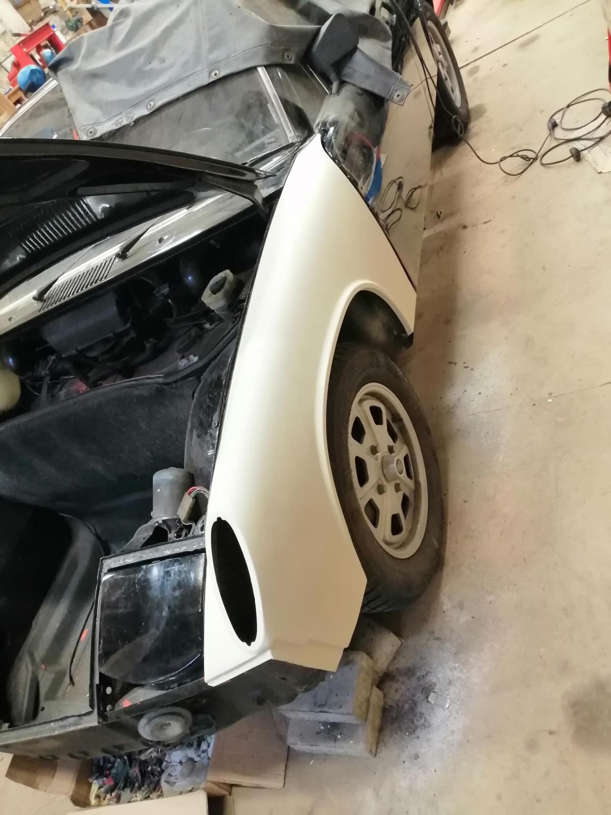

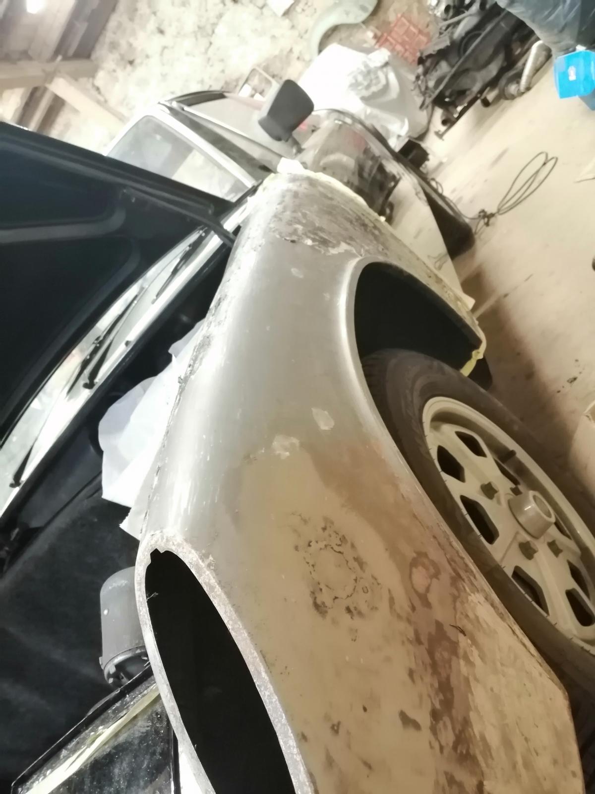

And TIG welded a real patch:
(IMG:http://www.914world.com/bbs2/uploads_offsite/www.thesamba.com-24690-1631714666.7.jpg)

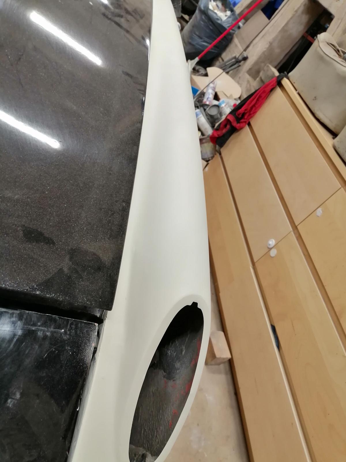

And put it in primer:
(IMG:http://www.914world.com/bbs2/uploads_offsite/www.thesamba.com-24690-1631714667.8.jpg)
(IMG:http://www.914world.com/bbs2/uploads_offsite/www.thesamba.com-24690-1631714667.9.jpg)
Same on the other side :
Big dent here was hidden under bondo:
(IMG:http://www.914world.com/bbs2/uploads_offsite/www.thesamba.com-24690-1631714667.10.jpg)
So dolly/hammer:
(IMG:http://www.914world.com/bbs2/uploads_offsite/www.thesamba.com-24690-1631714668.11.jpg)
(IMG:http://www.914world.com/bbs2/uploads_offsite/www.thesamba.com-24690-1631714668.12.jpg)
(IMG:http://www.914world.com/bbs2/uploads_offsite/www.thesamba.com-24690-1631714668.13.jpg)
And in the back there was also a surprise:
(IMG:http://www.914world.com/bbs2/uploads_offsite/www.thesamba.com-24690-1631714669.14.jpg)
(IMG:http://www.914world.com/bbs2/uploads_offsite/www.thesamba.com-24690-1631714669.15.jpg)
Yes, again a plate welded quite behind the panel.. And on the bottom not welded :
(IMG:http://www.914world.com/bbs2/uploads_offsite/www.thesamba.com-24690-1631714669.16.jpg)
So.. Patch prepared :
(IMG:http://www.914world.com/bbs2/uploads_offsite/www.thesamba.com-24690-1631714670.17.jpg)
And welded:
(IMG:http://www.914world.com/bbs2/uploads_offsite/www.thesamba.com-24690-1631714670.18.jpg)
Now we are flat:
(IMG:http://www.914world.com/bbs2/uploads_offsite/www.thesamba.com-24690-1631714670.19.jpg)
Stay tuned, work is ongoing here!
Antoine
