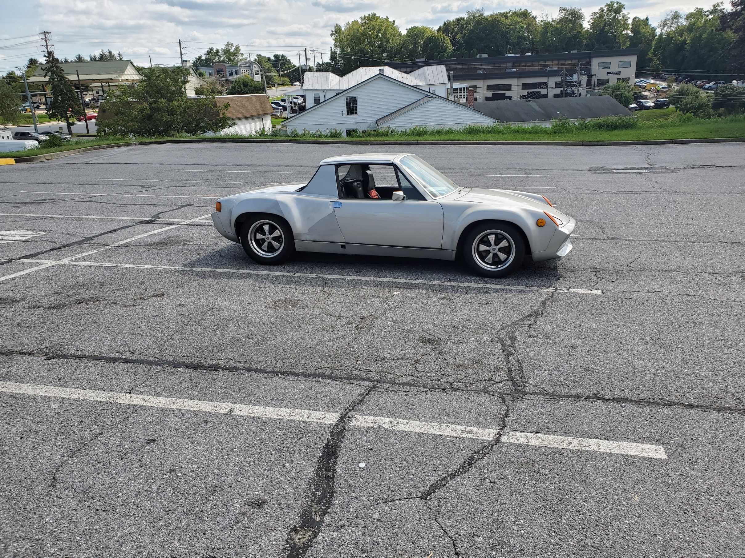

First drive in a little less than a year
Under new power

nditiz1   First drive in a little less than a year Under new...   Sep 20 2021, 01:28 PM

nditiz1   She drove decent, but could be better. She sound...   Sep 20 2021, 07:09 PM

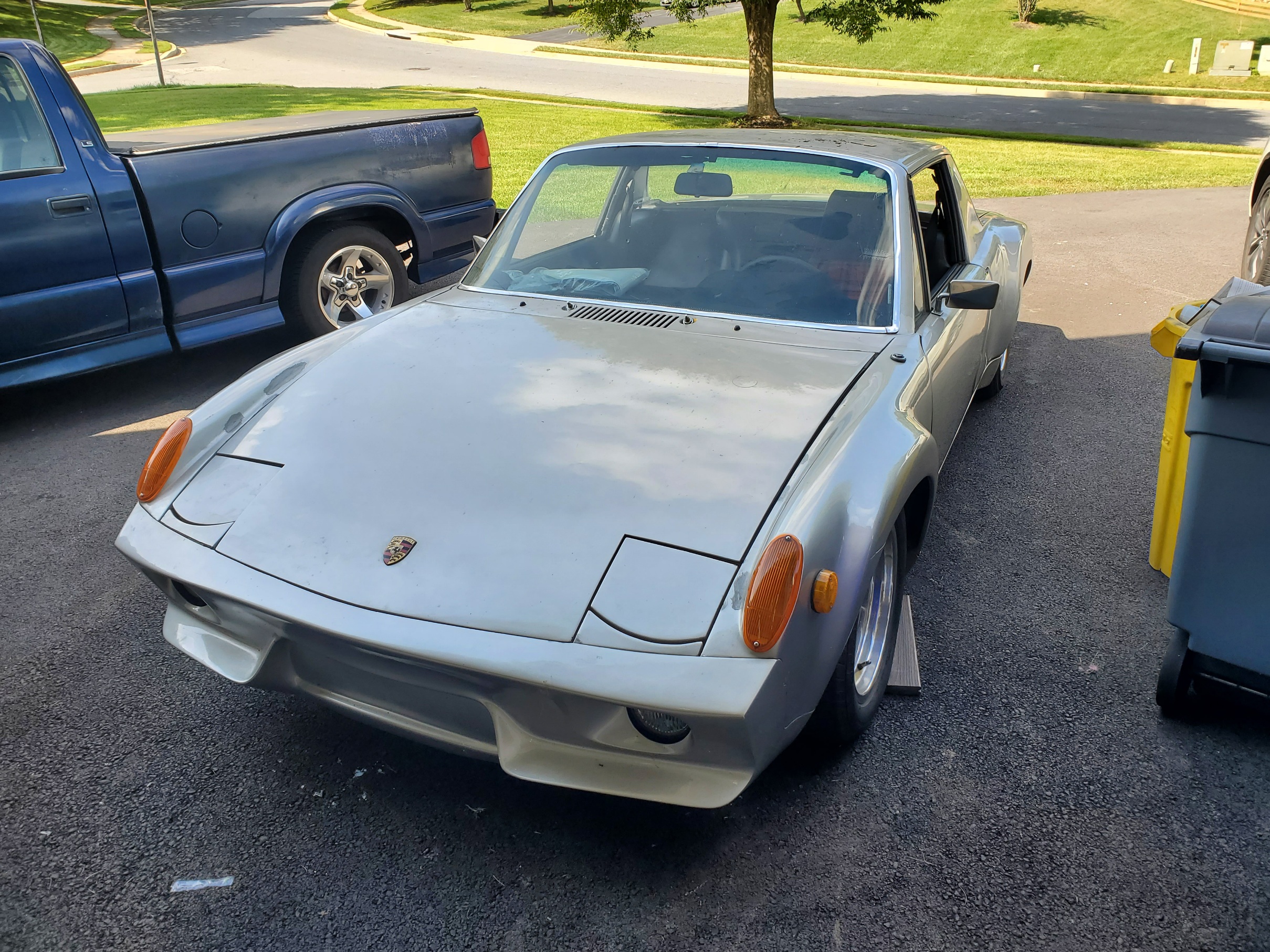

nditiz1   Felt a little defeated today. Can't seem to g...   Sep 21 2021, 06:46 PM
