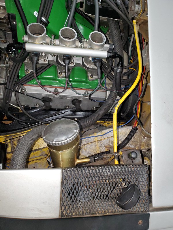

Here is the current state of affairs.
2.7 - ITB twin plug EFI
(IMG:http://www.914world.com/bbs2/uploads_offsite/live.staticflickr.com-18763-1628735514.1.jpg)

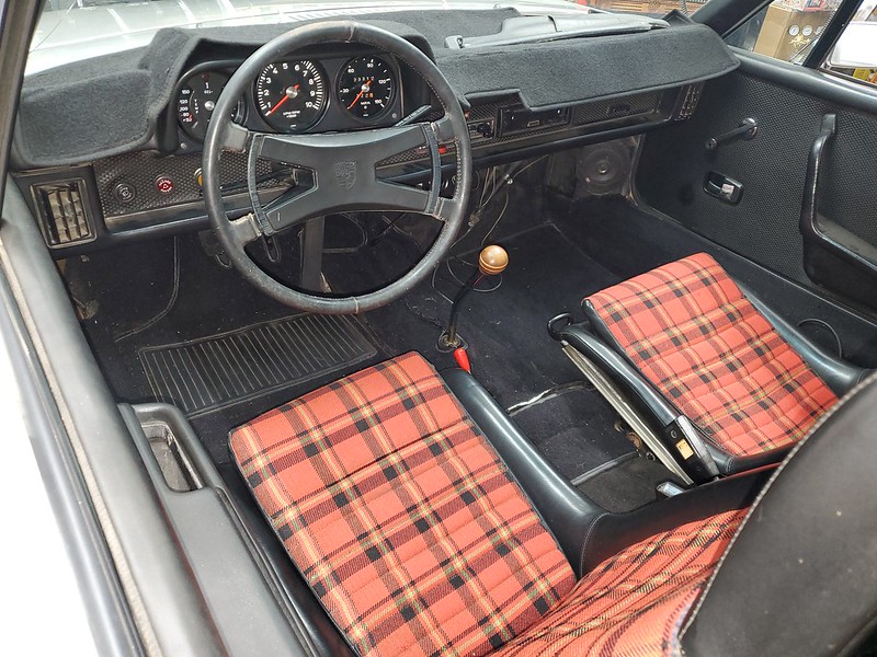

More things to raise the spirit regarding how much oil is escaping while running.
Passenger (driver) seat is back in.
GT engine handle installed.
Items left:
Install engine lid. Wanted to convert it to a GT one, but ran out of time.
