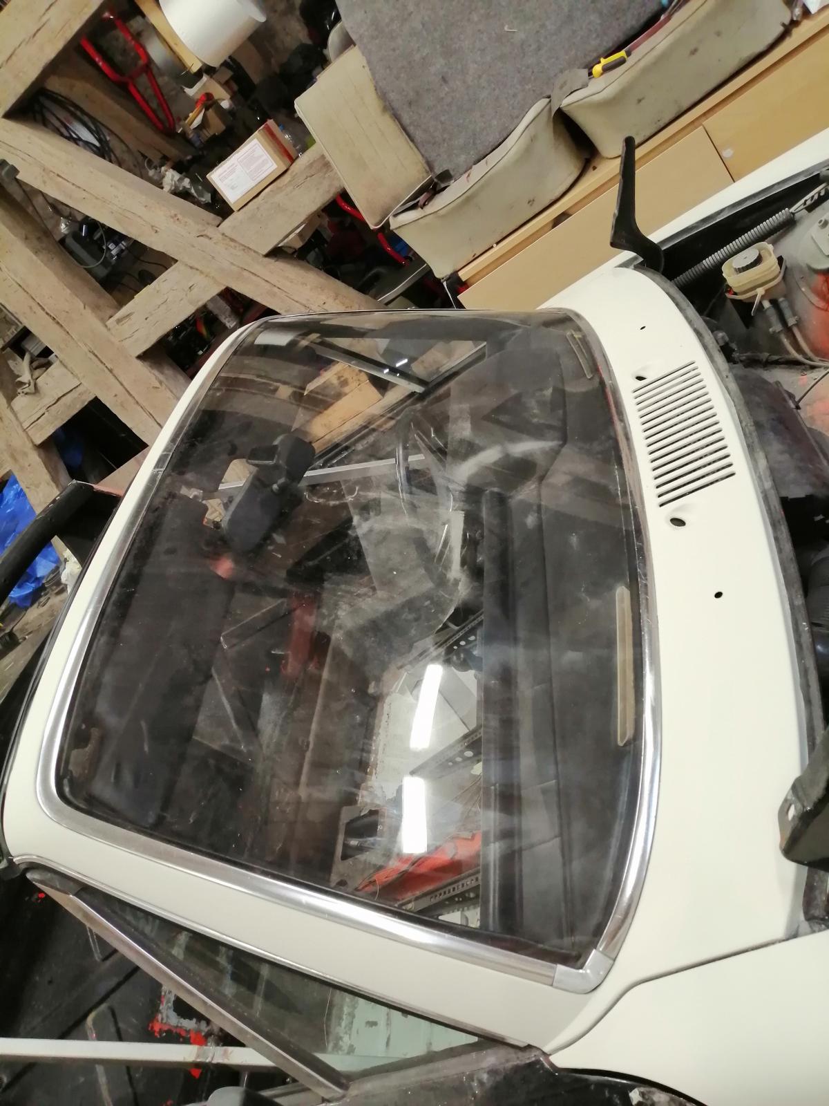

-drive drive drive drive (made 1000miles the first month with it (IMG:style_emoticons/default/aktion035.gif) )
-in the future: repair the rust, paint it original color back, improve the handling (it still has no sway bars, shocks are quite old, frame stiffener will be ordered,..), some interior modification,.. goal is to keep it usable on the street, while lightening it where possible and putting some more power (I am in love with the sound of a 6 but might keep it a big 4 for weight and legal reasons..).
Some pictures:

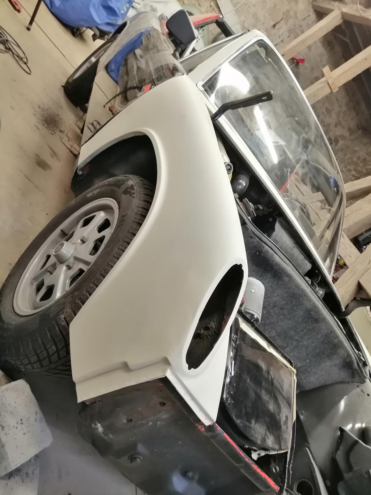

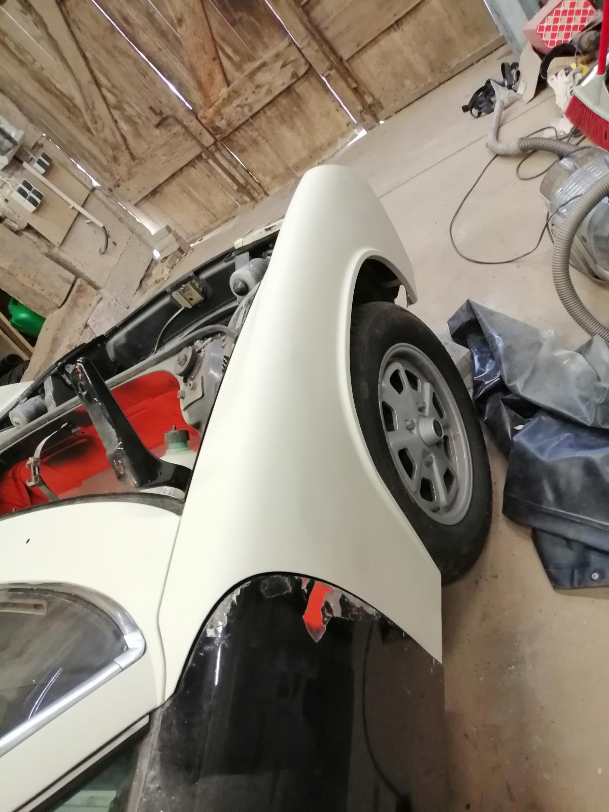

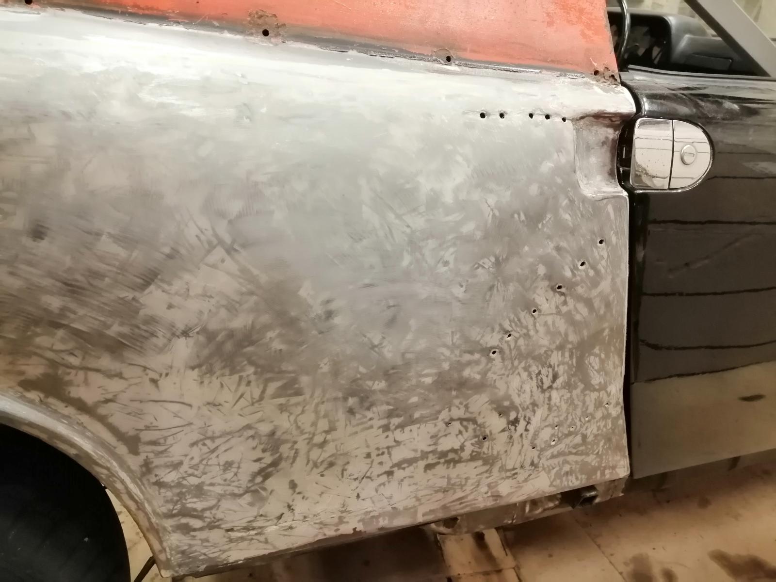

So, that was the next logical step..primer on the passenger side fender (IMG:style_emoticons/default/biggrin.gif) (and all around the windshield after taking it also to bare metal (IMG:style_emoticons/default/smile.gif) ) :

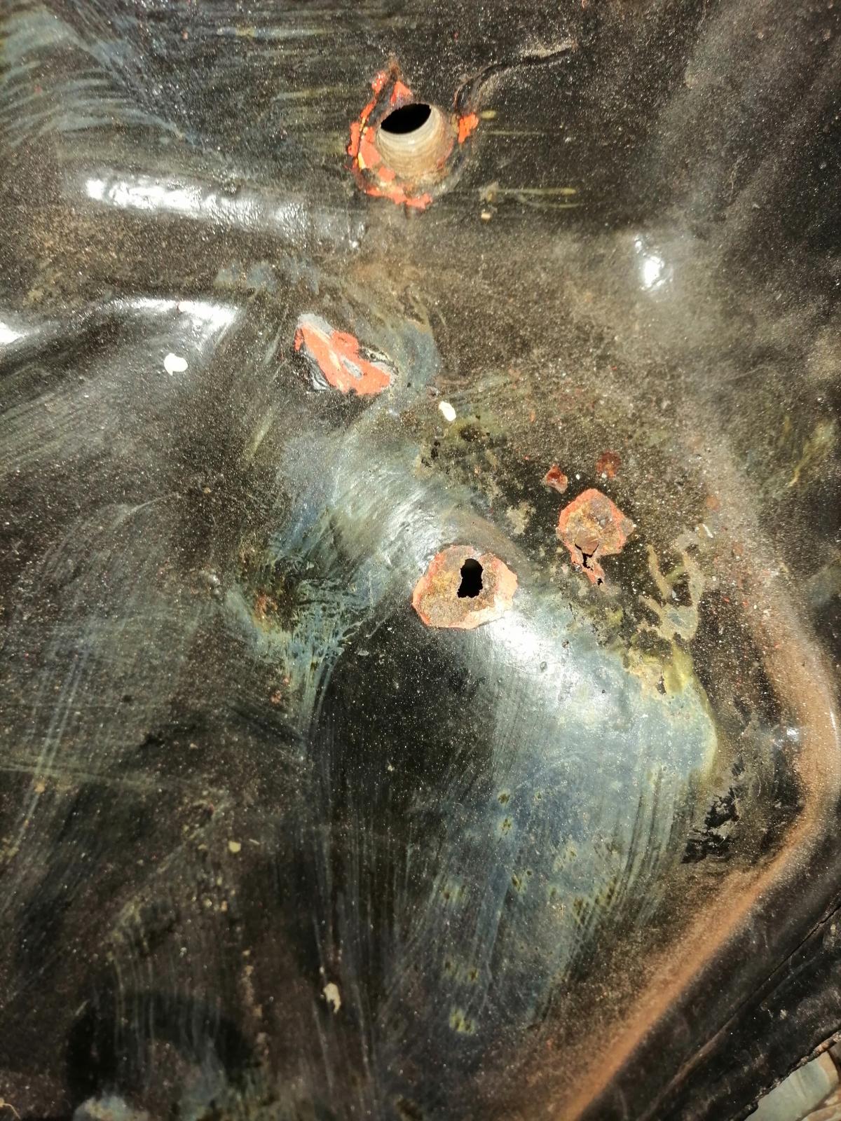

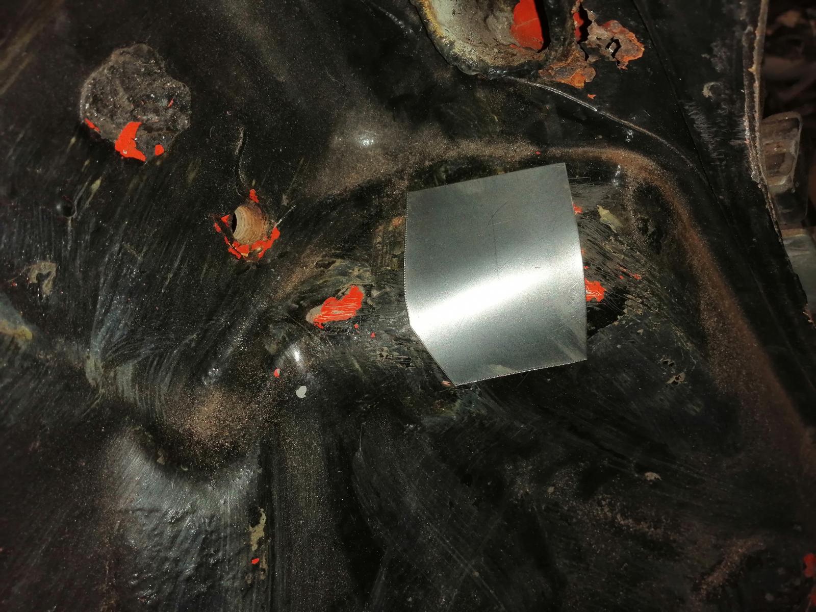

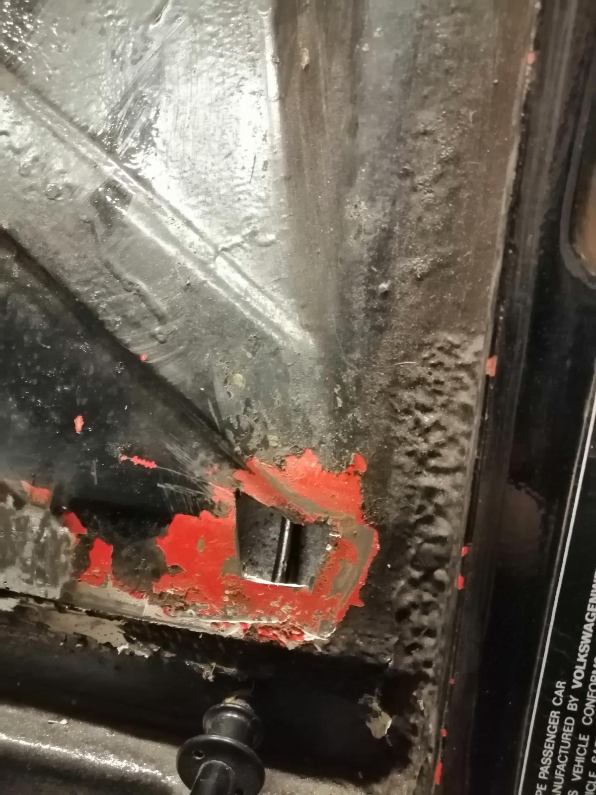

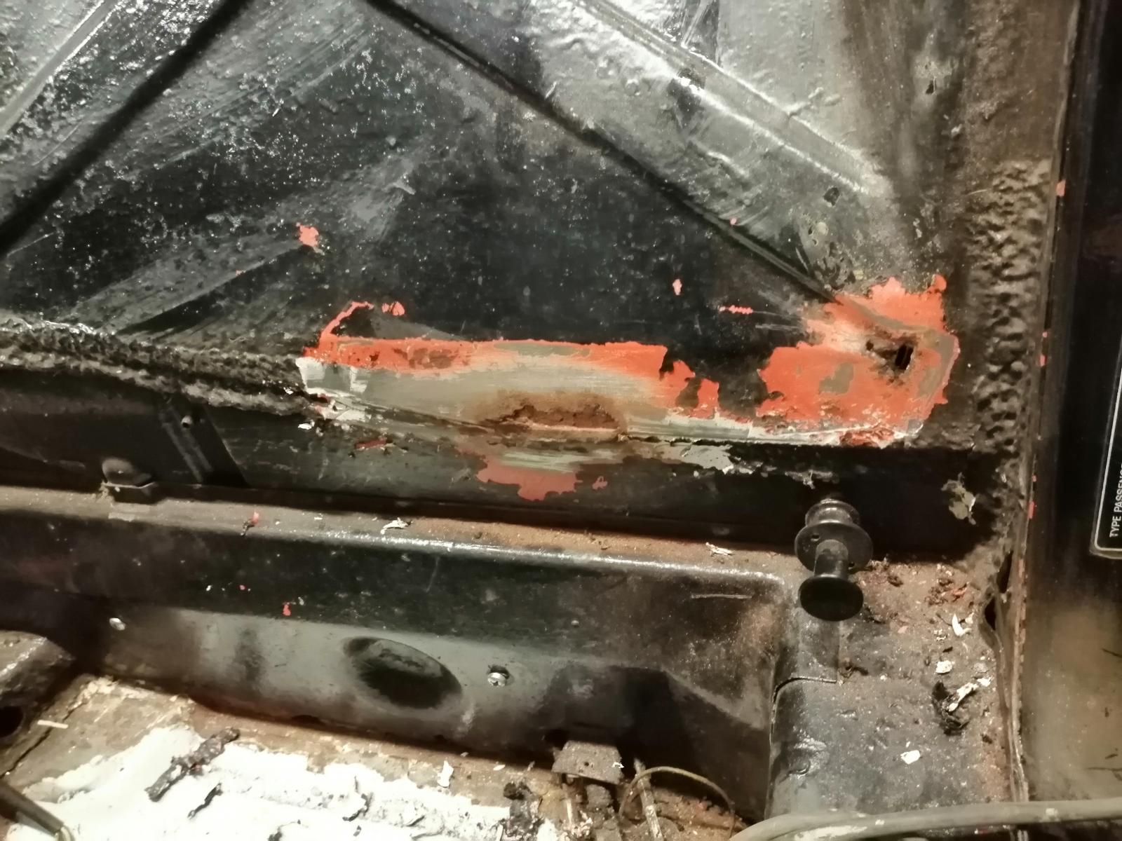

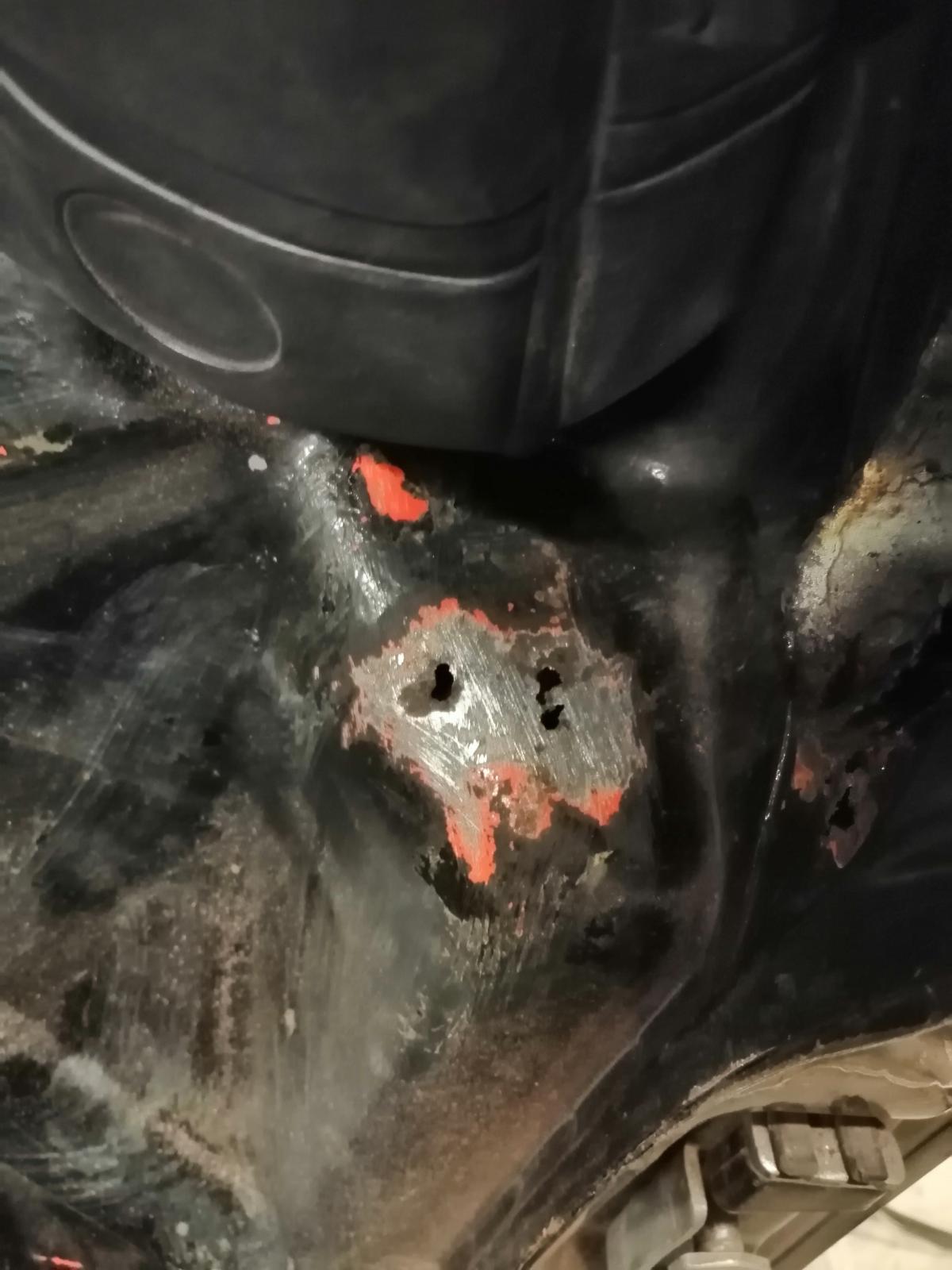

And I took care of a few holes on the driver's side firewall: (IMG:style_emoticons/default/welder.gif)
(IMG:http://www.914world.com/bbs2/uploads_offsite/www.thesamba.com-24690-1632406371.4.jpg)
(IMG:http://www.914world.com/bbs2/uploads_offsite/www.thesamba.com-24690-1632406372.5.jpg)
(IMG:http://www.914world.com/bbs2/uploads_offsite/www.thesamba.com-24690-1632406372.6.jpg)
(IMG:http://www.914world.com/bbs2/uploads_offsite/www.thesamba.com-24690-1632406373.7.jpg)
(IMG:http://www.914world.com/bbs2/uploads_offsite/www.thesamba.com-24690-1632406373.8.jpg)
(IMG:http://www.914world.com/bbs2/uploads_offsite/www.thesamba.com-24690-1632406373.9.jpg)
(IMG:http://www.914world.com/bbs2/uploads_offsite/www.thesamba.com-24690-1632406374.10.jpg)
(IMG:http://www.914world.com/bbs2/uploads_offsite/www.thesamba.com-24690-1632406374.11.jpg)
(IMG:http://www.914world.com/bbs2/uploads_offsite/www.thesamba.com-24690-1632406374.12.jpg)

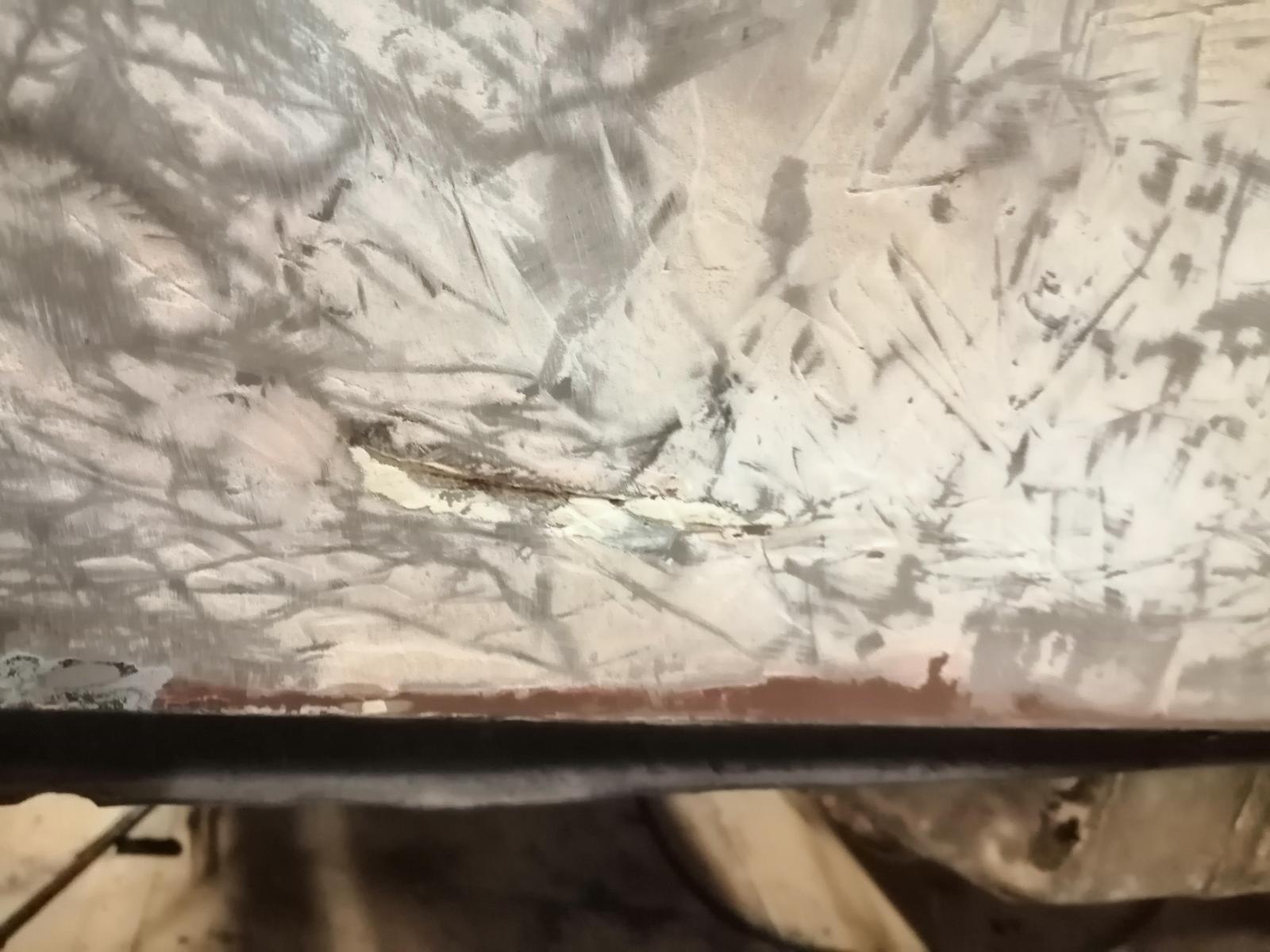

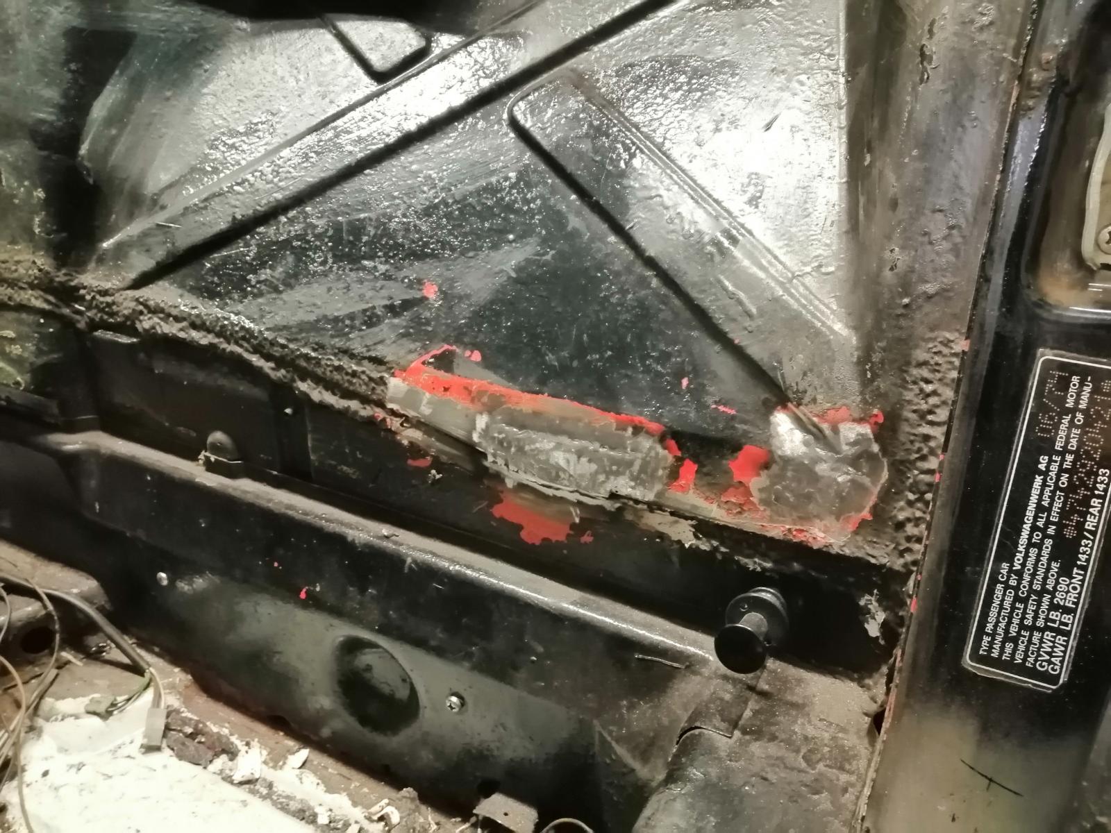

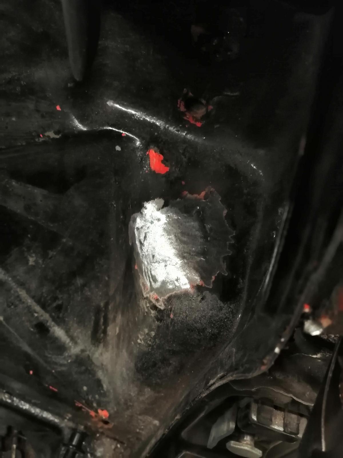

For the bottom part, I will wait to have the body on the cart/body frame as not only the bottom of the firewall but also the floor is affected. More on that later (IMG:style_emoticons/default/smile.gif)

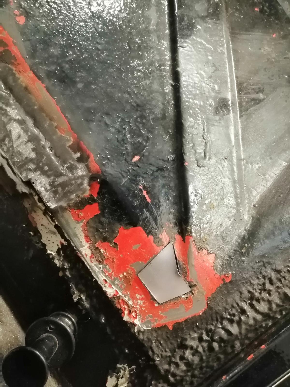

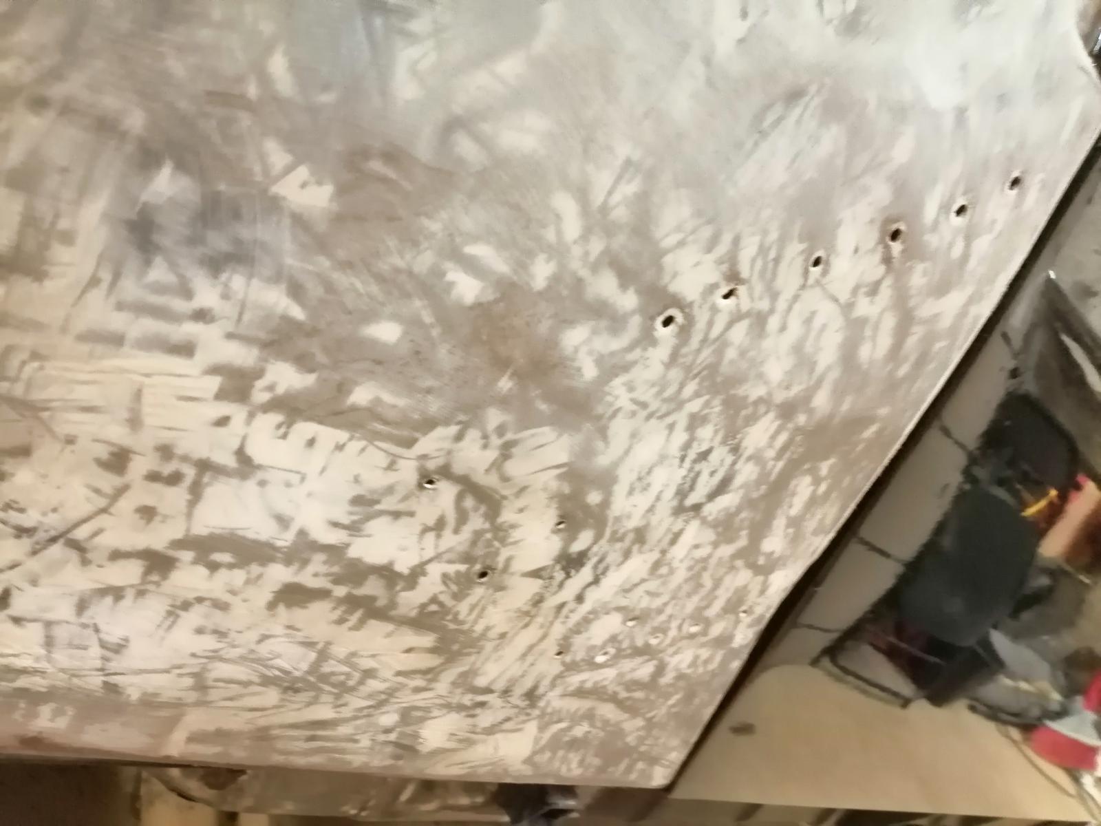

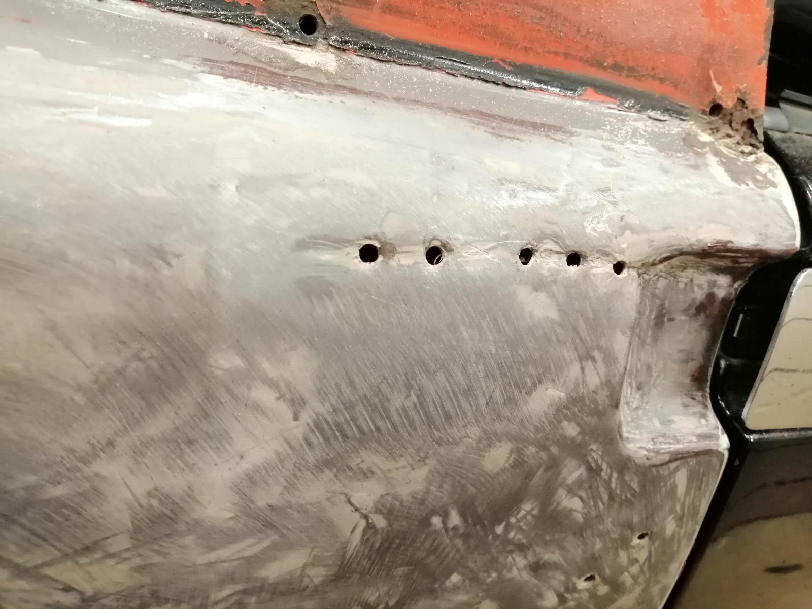

Before starting the body frame /hell hole fix, I wanted to check how the quarter is (part of me knowing I might have to cut it to repair right the right long).. Here the result, quite impressive.. (IMG:style_emoticons/default/blink.gif) (IMG:style_emoticons/default/blink.gif) (IMG:style_emoticons/default/headbang.gif)
(IMG:http://www.914world.com/bbs2/uploads_offsite/www.thesamba.com-24690-1632406375.13.jpg)
(IMG:http://www.914world.com/bbs2/uploads_offsite/www.thesamba.com-24690-1632406375.14.jpg)
(IMG:http://www.914world.com/bbs2/uploads_offsite/www.thesamba.com-24690-1632406375.15.jpg)
(IMG:http://www.914world.com/bbs2/uploads_offsite/www.thesamba.com-24690-1632406376.16.jpg)

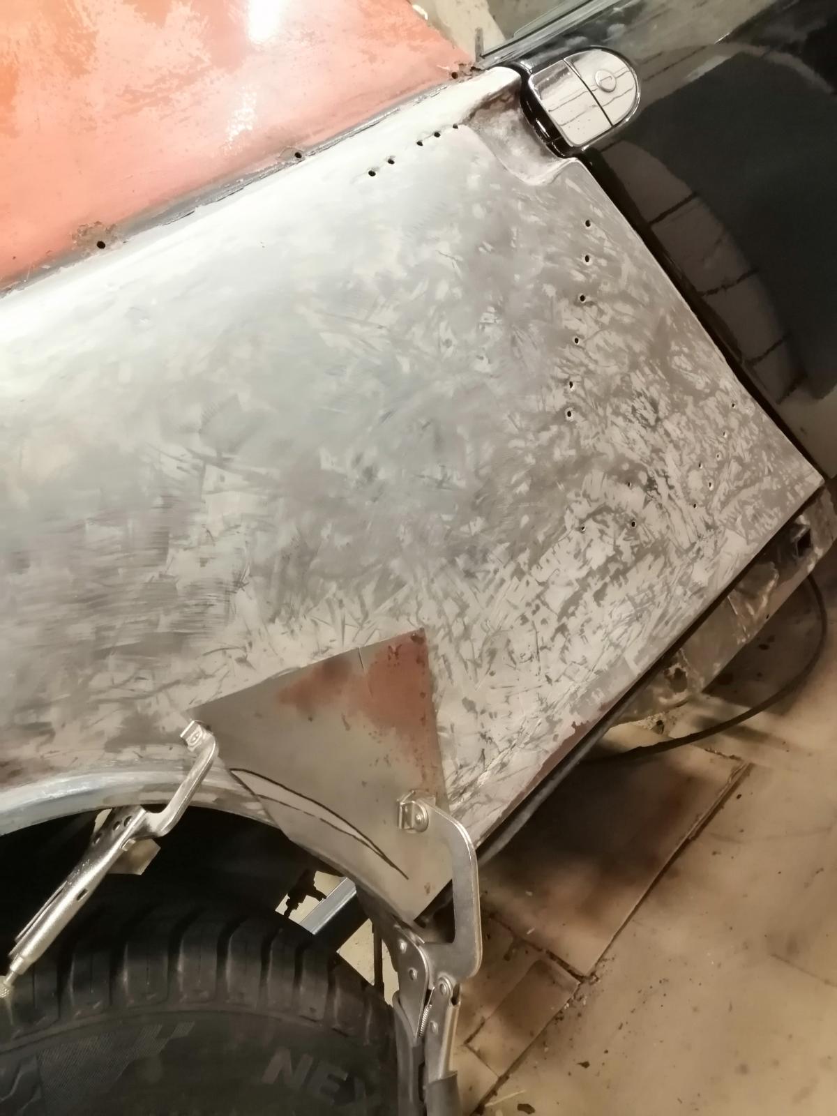

So now I know it.. I will build from scratch that quarter panel and cut it, repair the long, weld my new panel. (IMG:style_emoticons/default/sunglasses.gif)
Just for fun I made a small test panel to try the shape of the wheel opening:
(IMG:http://www.914world.com/bbs2/uploads_offsite/www.thesamba.com-24690-1632406376.17.jpg)

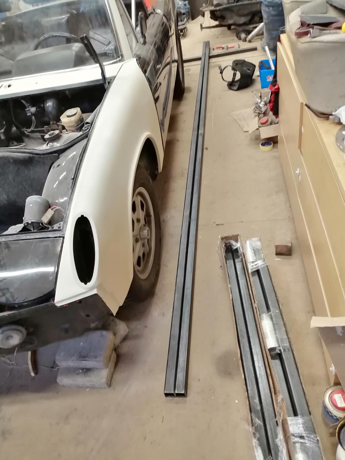

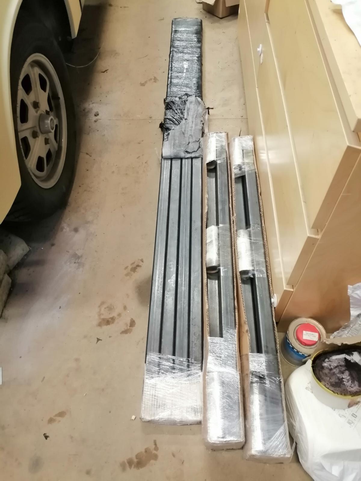

But I hadn't a large enough sheet metal piece to start on the quarter panel so I starte on my body frame..
Fresh metal came:
(IMG:http://www.914world.com/bbs2/uploads_offsite/www.thesamba.com-24690-1632406376.18.jpg)
Welded the long part:
(IMG:http://www.914world.com/bbs2/uploads_offsite/www.thesamba.com-24690-1632406377.19.jpg)
Rest will follow with all the fixations I planned (bumpers, engine, gearbox, front axle, back axle,..) to keep the body square du ring welding.
