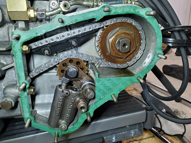

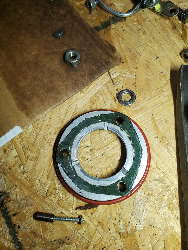

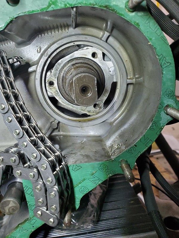

So I think I found the culprit (fingers crossed) on the 4/5/6 side. A new gasket with locktite 574 and a recheck of the cam timing will hopefully seal that up.

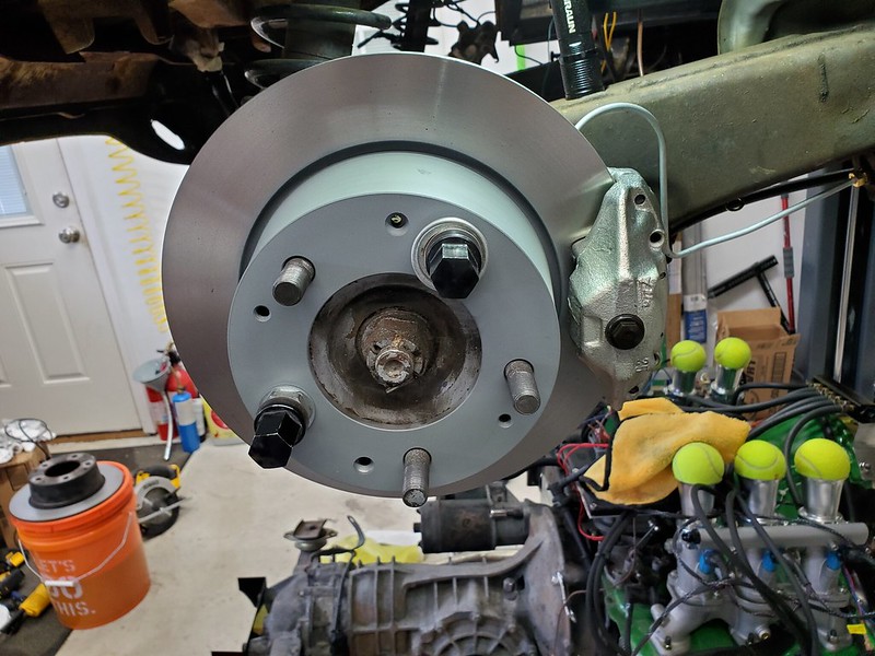

Also, I wasn't thrilled about the run out on the rear rotors. I had them turned and they went out of spec so new Sebro's it is.

ClayPerrine   Why did you use a coarse wood screw to pull the ca...   Oct 5 2021, 10:48 AM
nditiz1   Only you would spot that Clay Hahahaha. I did hav...   Oct 5 2021, 12:48 PM
