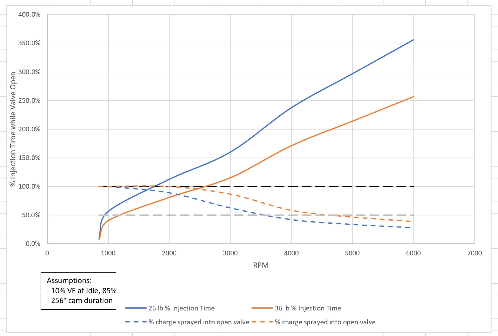

Pulses of ~10 ms aren't too bad.
But...
I don't see where you add an engine pumping efficiency (VE) into the air flow calculation. I didn't check your calcs from a PV=nRT sense so I'm assuming those are correct in terms of air/fuel mass flows with perfect cylinder filling.
The engine is only going to be pumping maybe 10-30%* 'efficiently' at idle making your actual fuel flow requirements much less. Pulses of 0.96 ms are too short. Most injectors have 1-1.5 ms latency (voltage and fuel pressure dependent).
*Edit: Found a post showing Falcor76 has ~20% VE @ idle so I think these numbers are somewhat reasonable.

Excellent! Yes, there's a little obscure note in the chart that says VE is calculated at 100%. This is all new to me so I was going to refine the values to include more realistic VE numbers later. Any guidance on some standard VE values to plug in? So far I've only found typical values at max HP.
This is obviously critical to the analysis. So assuming 10% VE, the idle pulse width should be around 1.3 ms with 26 lb injectors and, as you said, 0.96 ms with 36 lb. That puts the nail in the coffin for the larger injectors it seems. It seems even the 26 lb injectors might be pushing the limit. Assuming 20% VE at idle, I get a 2.7 ms pulse width with the 26s (1.9 ms with 36s).
Playing with VE a little and assuming a static 85% through the range above idle stretches out the theoretic band where sequential could potentially benefit. I've added curves for % of charge sprayed into open valves below with a reference line at 50% to show the point where sequential is no different from batch. Once I have more realistic guestimate numbers for VE, I'll post updated tables.
