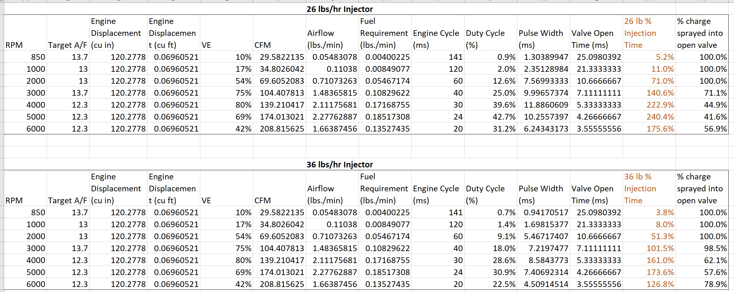

Well no reason to stop this insanity now, so here's more fun with math. I found a good discussion about VE vs engine speed for a stock 2.0L on Pelican. It didn't provide a nice table of VEs I would have liked, but led to enough info to make some WAGs to get closer with my chicken scratch estimates. I learned that VE typically follows the torque curve with peak VE being at about the same engine speed as peak torque. I also learned that typical peak VE values for 4 cylinder, 2 valve, overhead cam engines is 75-80% So I plotted a graph using 10% VE at idle to represent worst case in terms of small pulse width and max of 80% at about 3800 rpm which looks about where the 2.0L peaks (I was too lazy to look up the actual peak), and I dropped it to 60% @ 5800 rpm - again, just trying to match the shape of the torque curve. Then I had Excel calculate a polynomial equation for the shape and used that to plug in VE values in my tables. Whew - we're into some nerd shit now!
The results are interesting.
With this adjustment, both injectors extend the range where sequential would spray more of the charge into open valves than batch. Really intriguing is that the 36 lb injectors would still be spraying all or nearly all of the charge into open valves into the low 3ks which would be potential efficiency gains even into highway cruising speeds. In fact, the 36 lb never dips below 50% of charge going into open valves. But... there is still that pesky 0.94 ms pulse width @ idle. It would be nice to know what that minimum VE would actually be because even at 20% VE, the minimum pulse width climbs to 1.9 ms which might just be doable with MS3.
