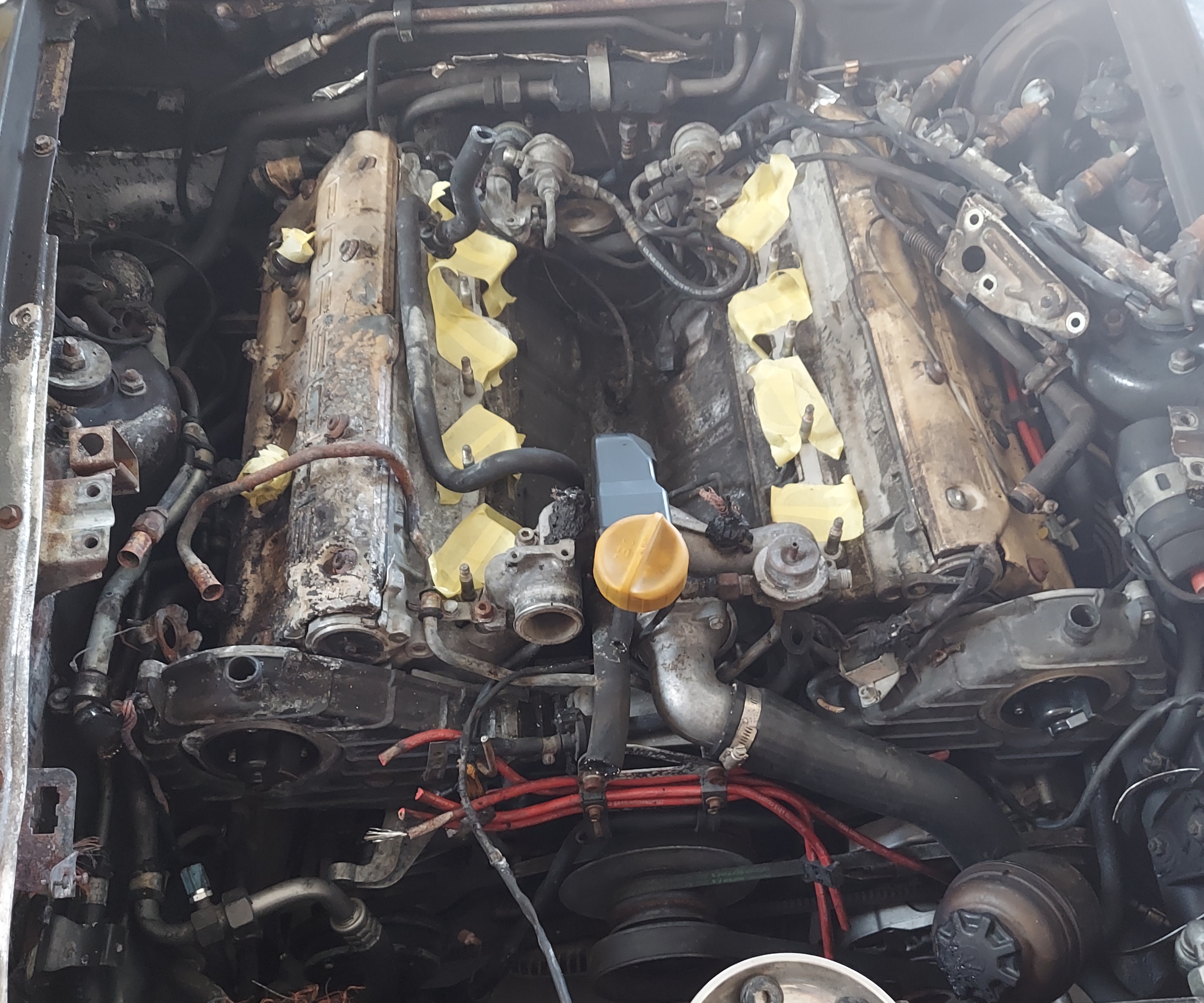

mb911   Rented a storage spot and ordered a hood, wiring ...   Jan 21 2021, 05:47 PM
mb911   RE: OT bought a shark   Jan 21 2021, 05:47 PM
Superhawk996   :blowtorch: :yikes:   Jan 21 2021, 06:06 PM
mb911   And some replacement harnesses.. I need to check...   Jan 21 2021, 07:21 PM
ddire333   And some replacement harnesses.. I need to chec...   Jan 22 2021, 11:12 AM
mb911   And some replacement harnesses.. I need to che...   Jan 22 2021, 12:23 PM
mb911   Oh and I am the king of doable lol   Jan 22 2021, 12:24 PM
Tdskip   Oh my   Jan 22 2021, 12:27 PM
mb911   Oh my It will be all good.. this is nothing to...   Jan 22 2021, 12:35 PM
bretth   Awesome looks like fun. A few years back someone w...   Jan 22 2021, 12:35 PM
mb911   Its pretty amazing that this car is very plug and...   Jan 22 2021, 01:12 PM

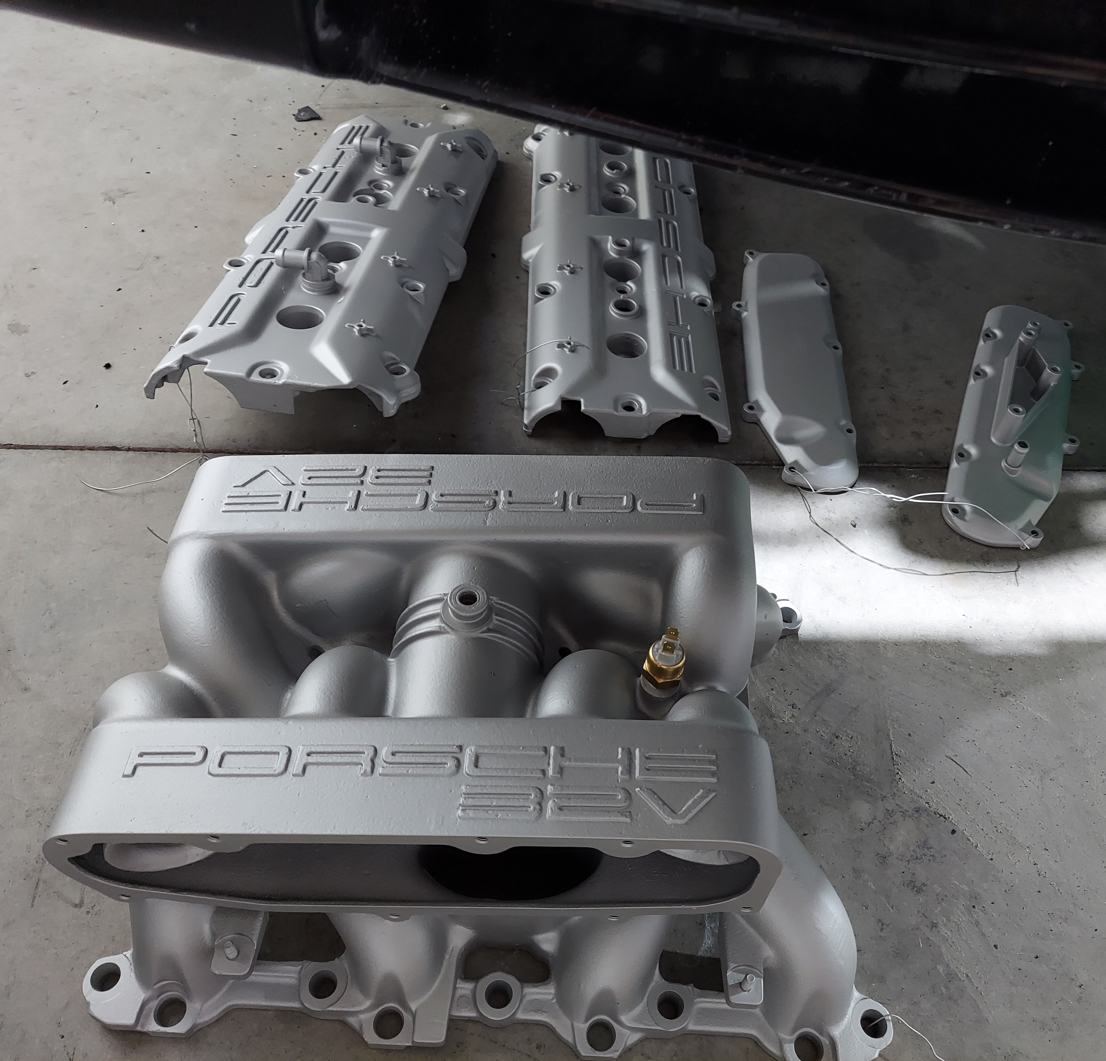

mb911   Making headway.   Oct 26 2021, 04:52 AM
Tdskip   Very tidy   Oct 26 2021, 07:23 AM
ddire333   Just pick a day your feeling very patient to assem...   Oct 26 2021, 08:28 AM
mb911   Well I have all winter. Still the last big purchas...   Oct 26 2021, 09:58 AM
ddire333   Well I have all winter. Still the last big purcha...   Oct 26 2021, 10:38 AM
Tdskip   Which will be absolutely worth it once you can get...   Oct 26 2021, 10:07 AM

mb911   Headway. Man there is alot of connections on this.   Jan 6 2022, 04:38 PM
mepstein   Needs twin turbos. :evilgrin:   Jan 6 2022, 05:34 PM
rhodyguy   There a lot of everything in that engine bay. I co...   Jan 6 2022, 06:53 PM
Tdskip   S4 and later 928’s are pretty complicated beasts...   Jan 6 2022, 07:24 PM
mb911   S4 and later 928’s are pretty complicated beast...   Jan 6 2022, 07:51 PM
