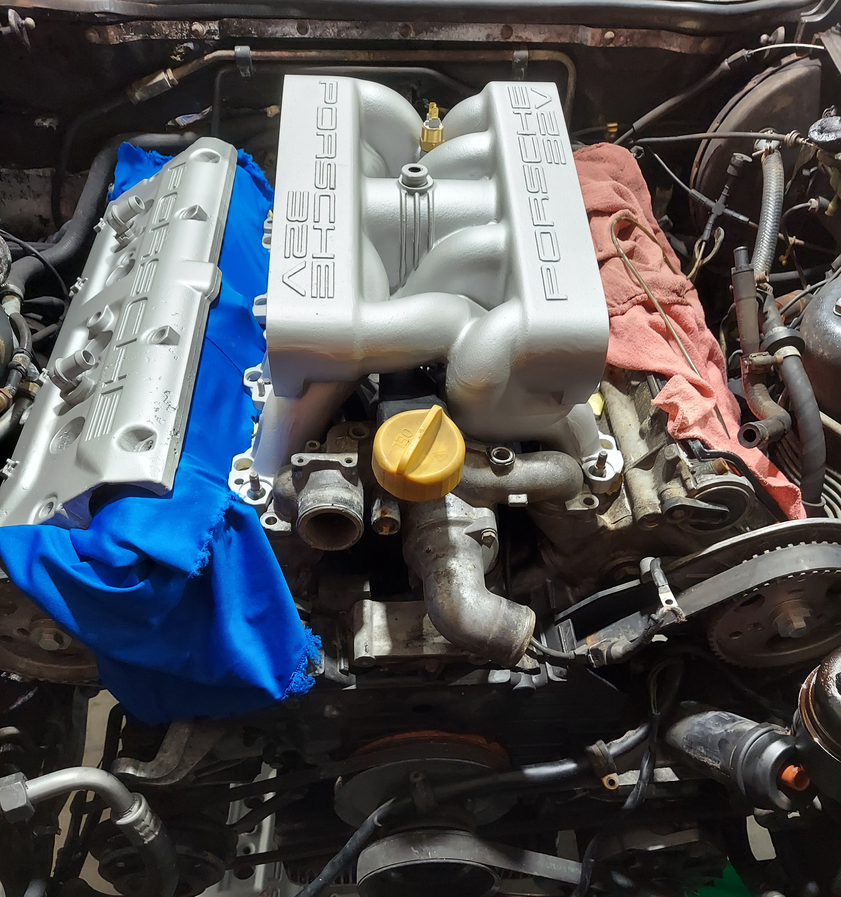

mb911   Making headway.   Oct 26 2021, 04:52 AM
Tdskip   Very tidy   Oct 26 2021, 07:23 AM
ddire333   Just pick a day your feeling very patient to assem...   Oct 26 2021, 08:28 AM
mb911   Well I have all winter. Still the last big purchas...   Oct 26 2021, 09:58 AM
ddire333   Well I have all winter. Still the last big purcha...   Oct 26 2021, 10:38 AM
Tdskip   Which will be absolutely worth it once you can get...   Oct 26 2021, 10:07 AM

mb911   Headway. Man there is alot of connections on this.   Jan 6 2022, 04:38 PM
mepstein   Needs twin turbos. :evilgrin:   Jan 6 2022, 05:34 PM
rhodyguy   There a lot of everything in that engine bay. I co...   Jan 6 2022, 06:53 PM
Tdskip   S4 and later 928’s are pretty complicated beasts...   Jan 6 2022, 07:24 PM
mb911   S4 and later 928’s are pretty complicated beast...   Jan 6 2022, 07:51 PM
