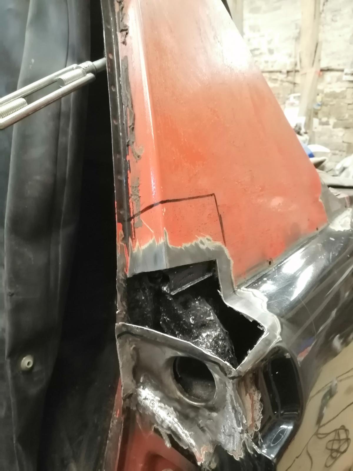

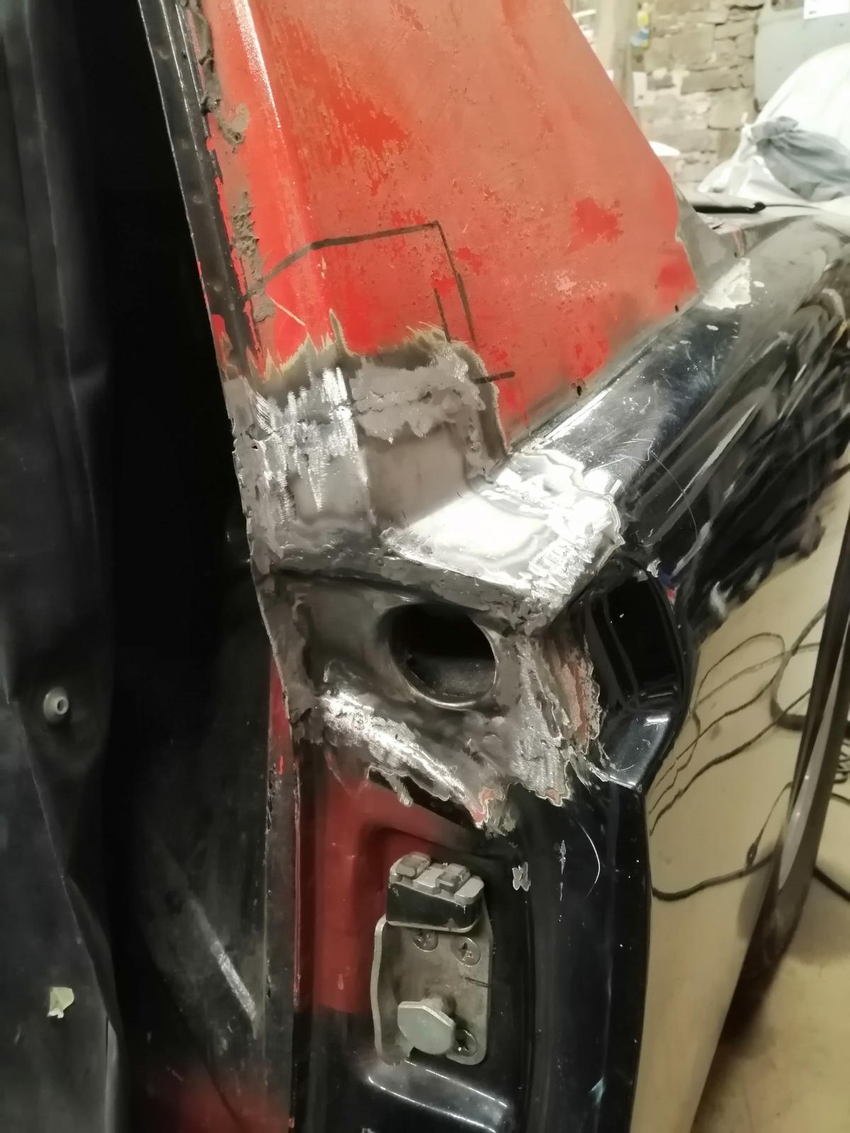

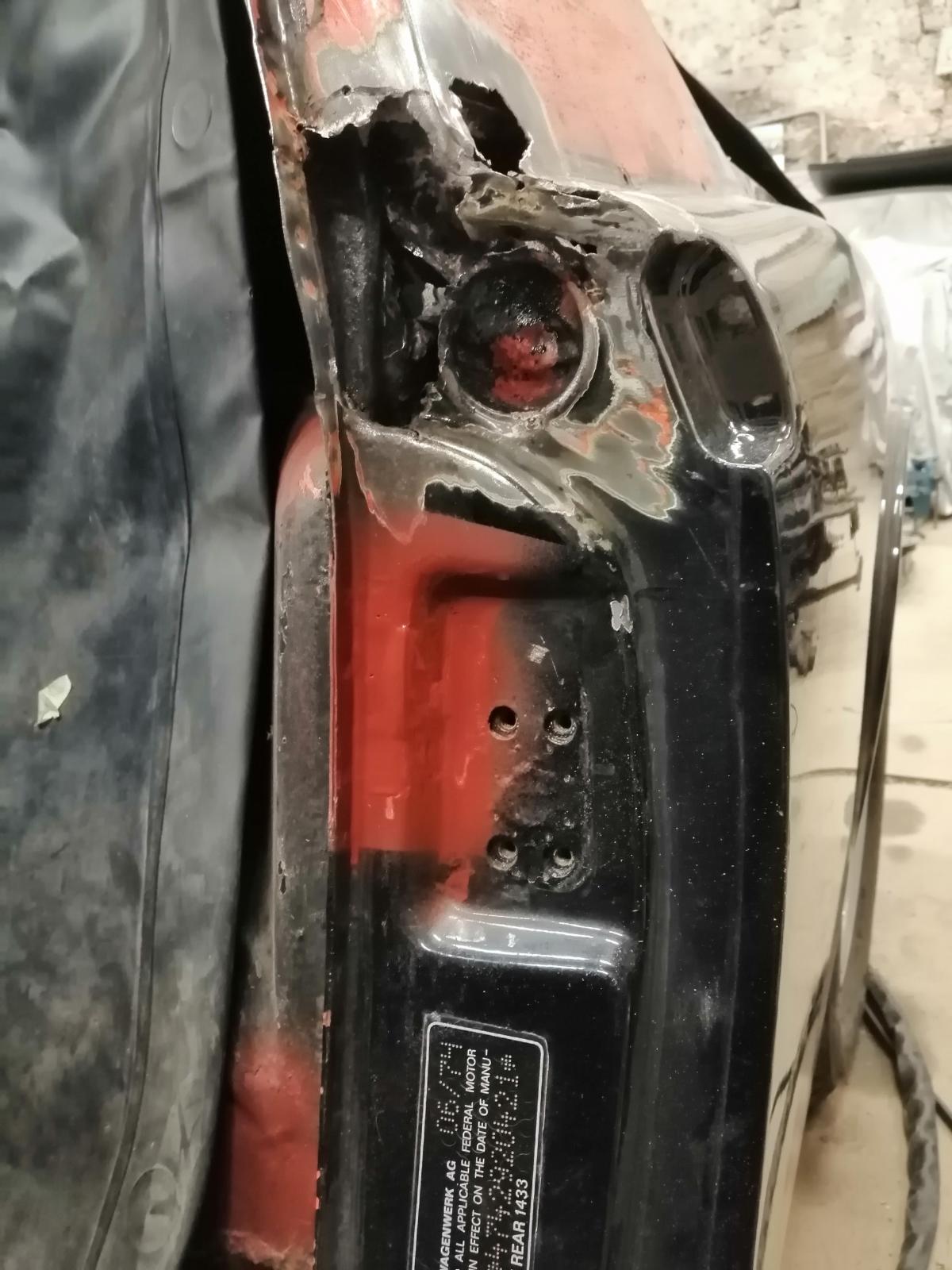

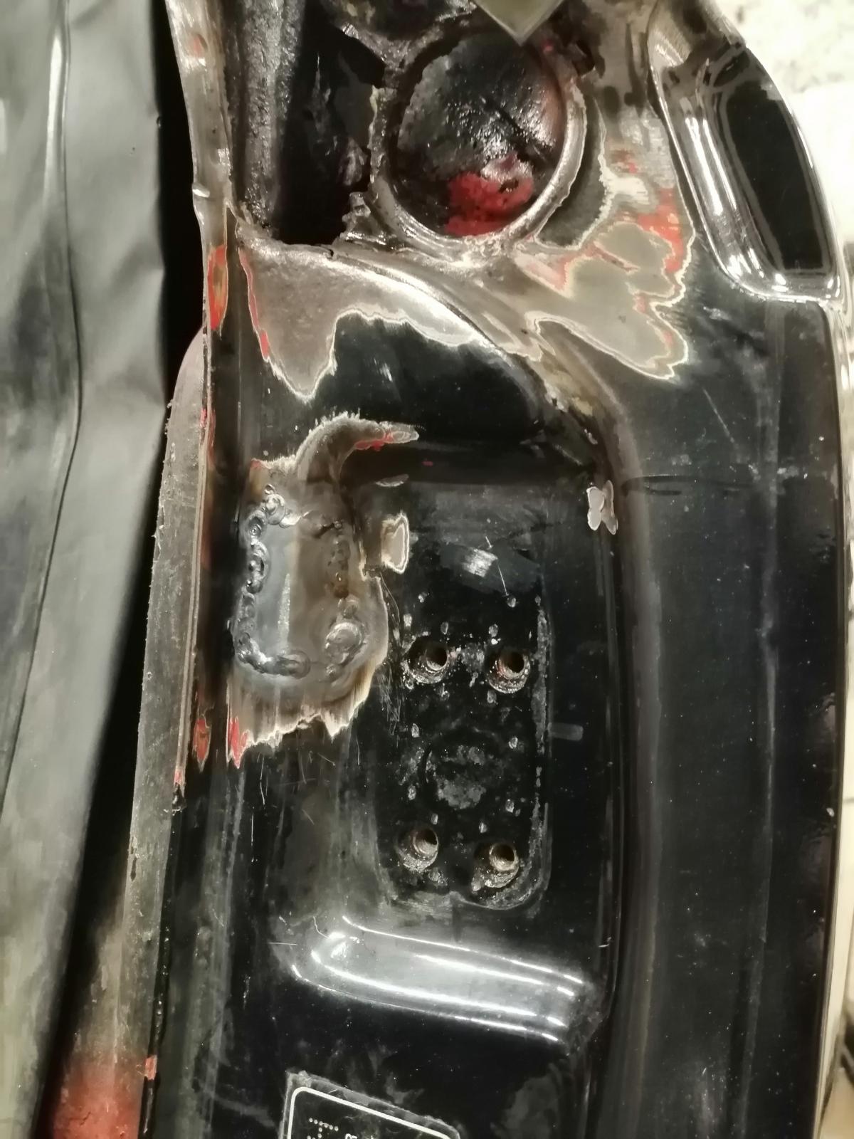

Thanks Matt! Yes the barn is really cool, crazy to think it hast been first built in 1560, partly demolished in 1714 and rebuilt in 1719..and mine since 3 small years (IMG:style_emoticons/default/wub.gif)

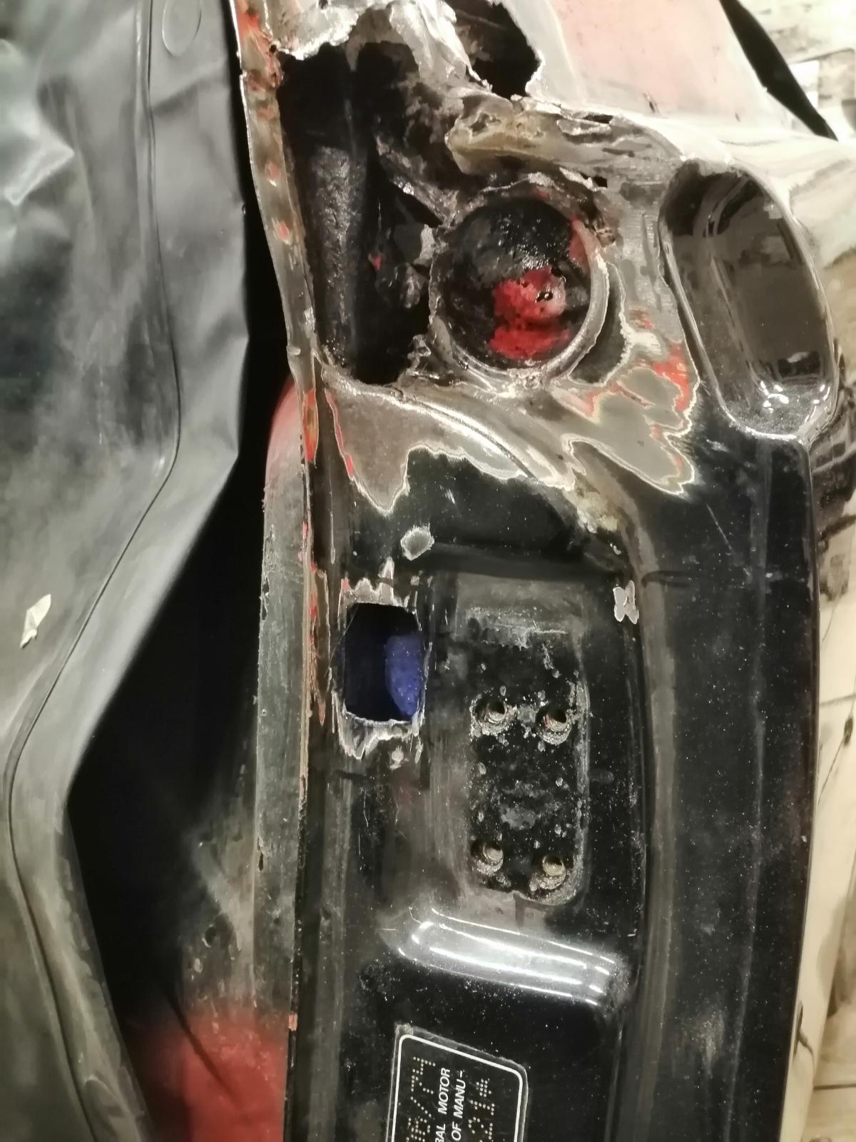

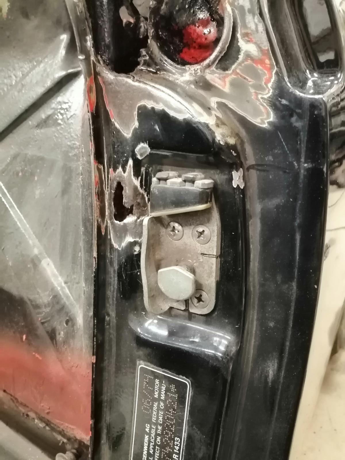

I finished the B-pillar, first with these small reparations:
Before:
(IMG:http://www.914world.com/bbs2/uploads_offsite/www.thesamba.com-24690-1635336427.1.jpg)

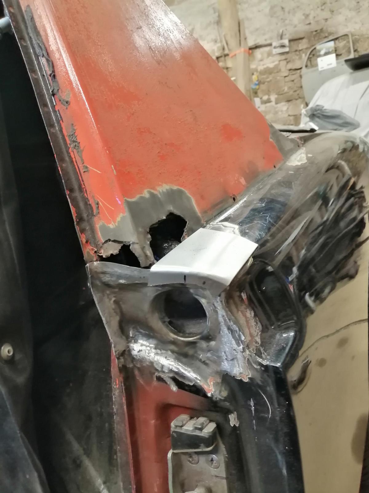

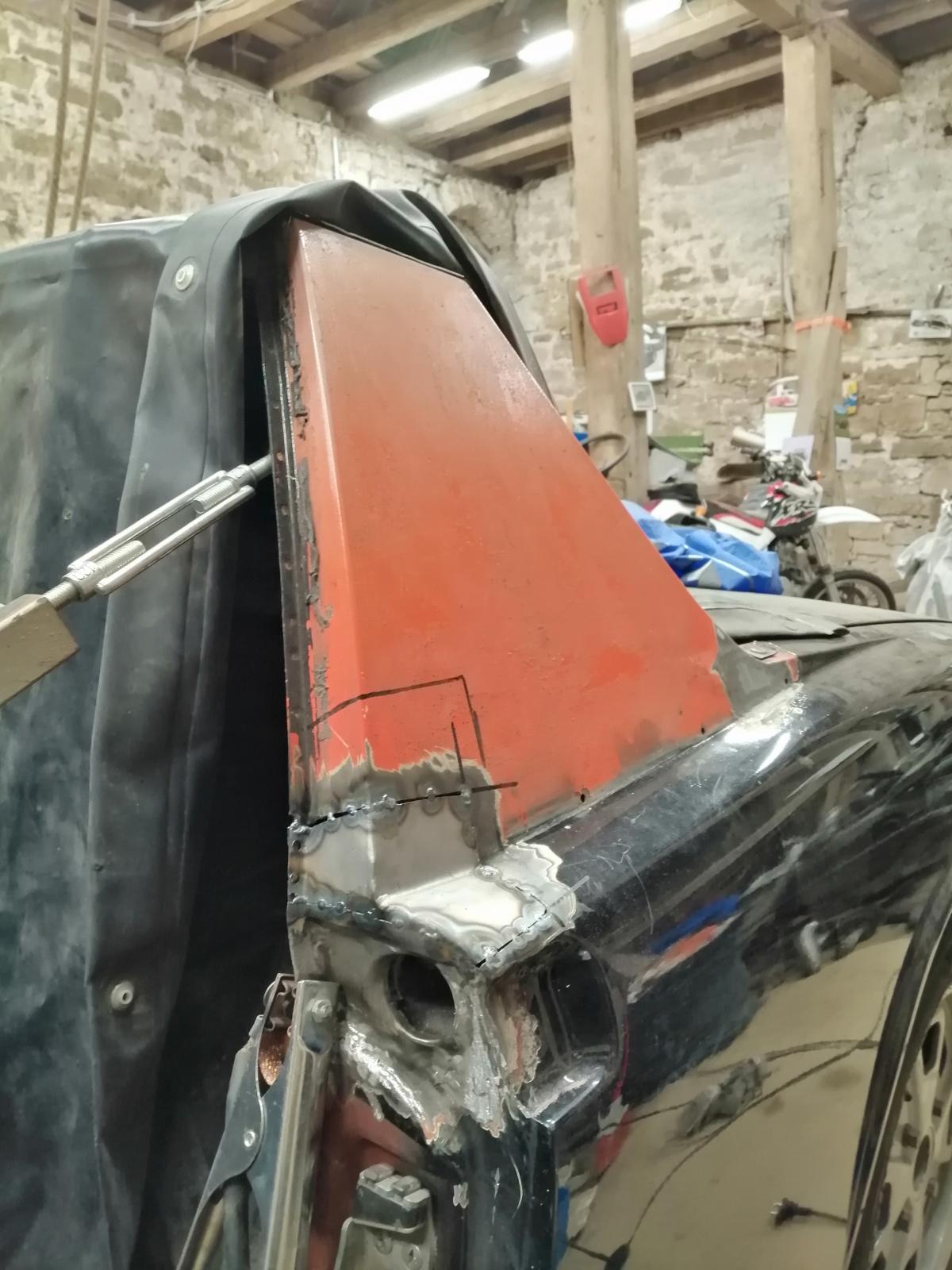

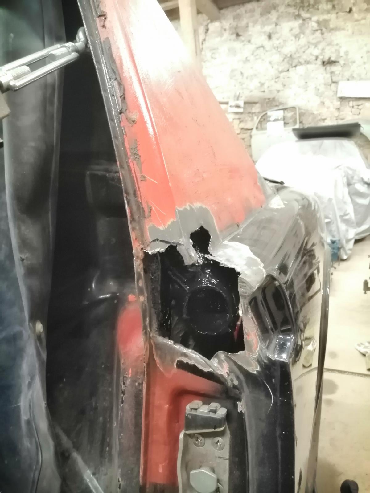

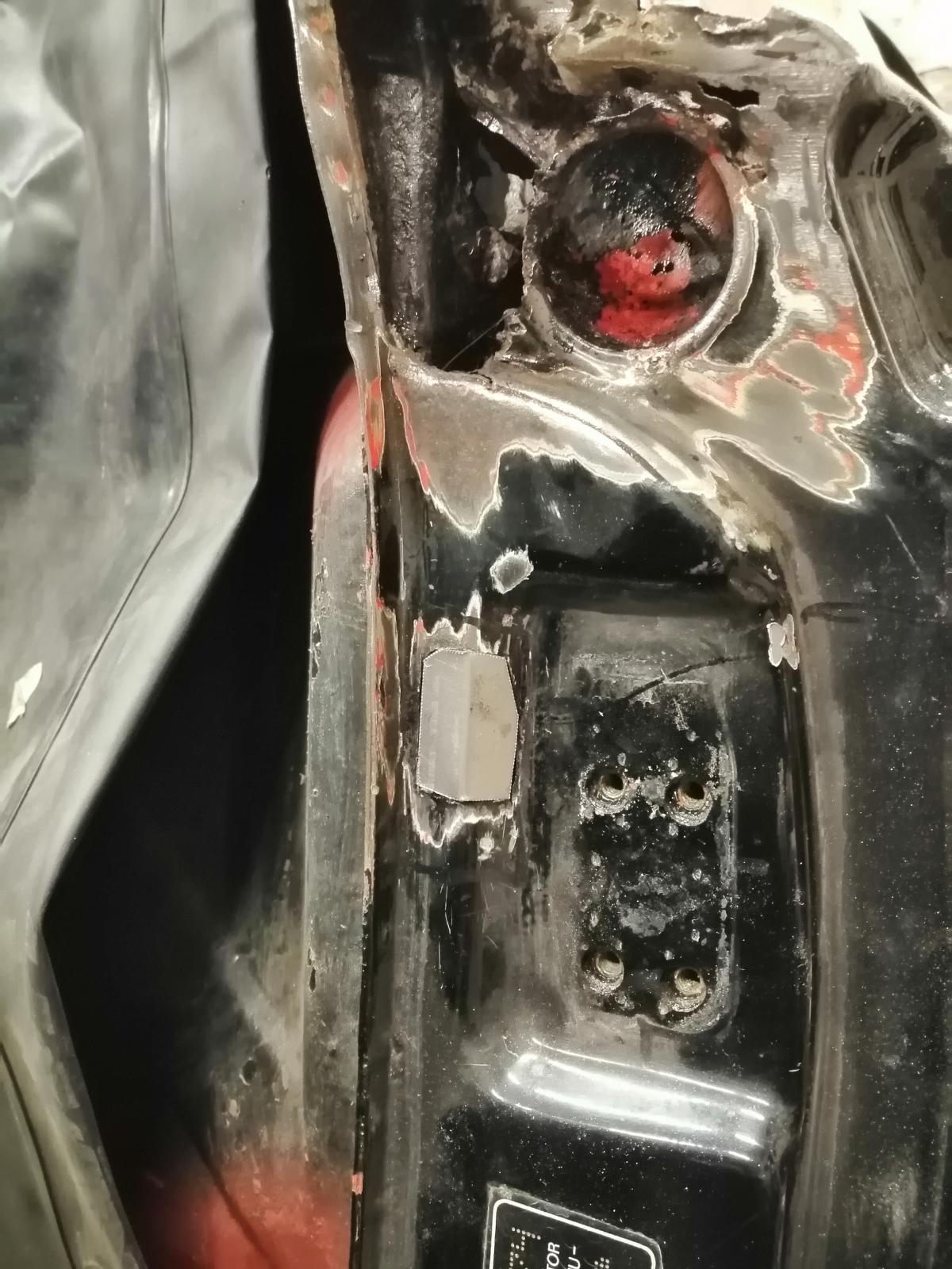

During:
(IMG:http://www.914world.com/bbs2/uploads_offsite/www.thesamba.com-24690-1635336428.2.jpg)

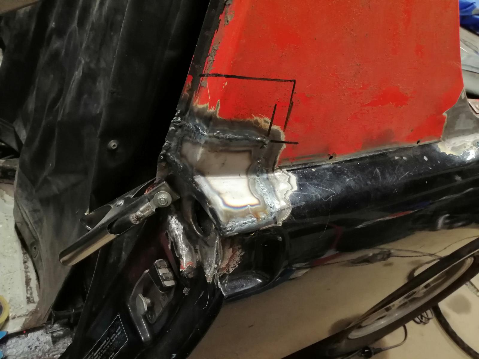

(IMG:http://www.914world.com/bbs2/uploads_offsite/www.thesamba.com-24690-1635336428.3.jpg)

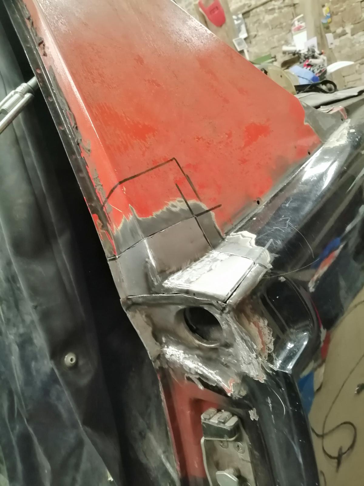

(IMG:http://www.914world.com/bbs2/uploads_offsite/www.thesamba.com-24690-1635336429.4.jpg)

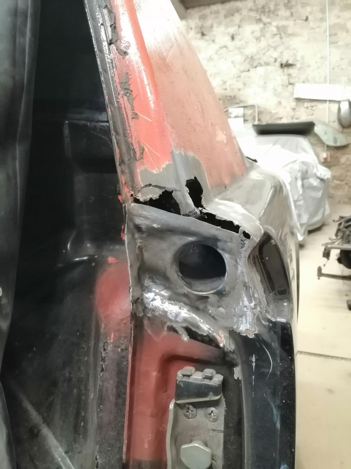

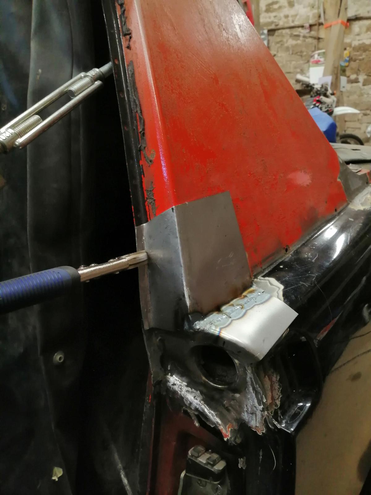

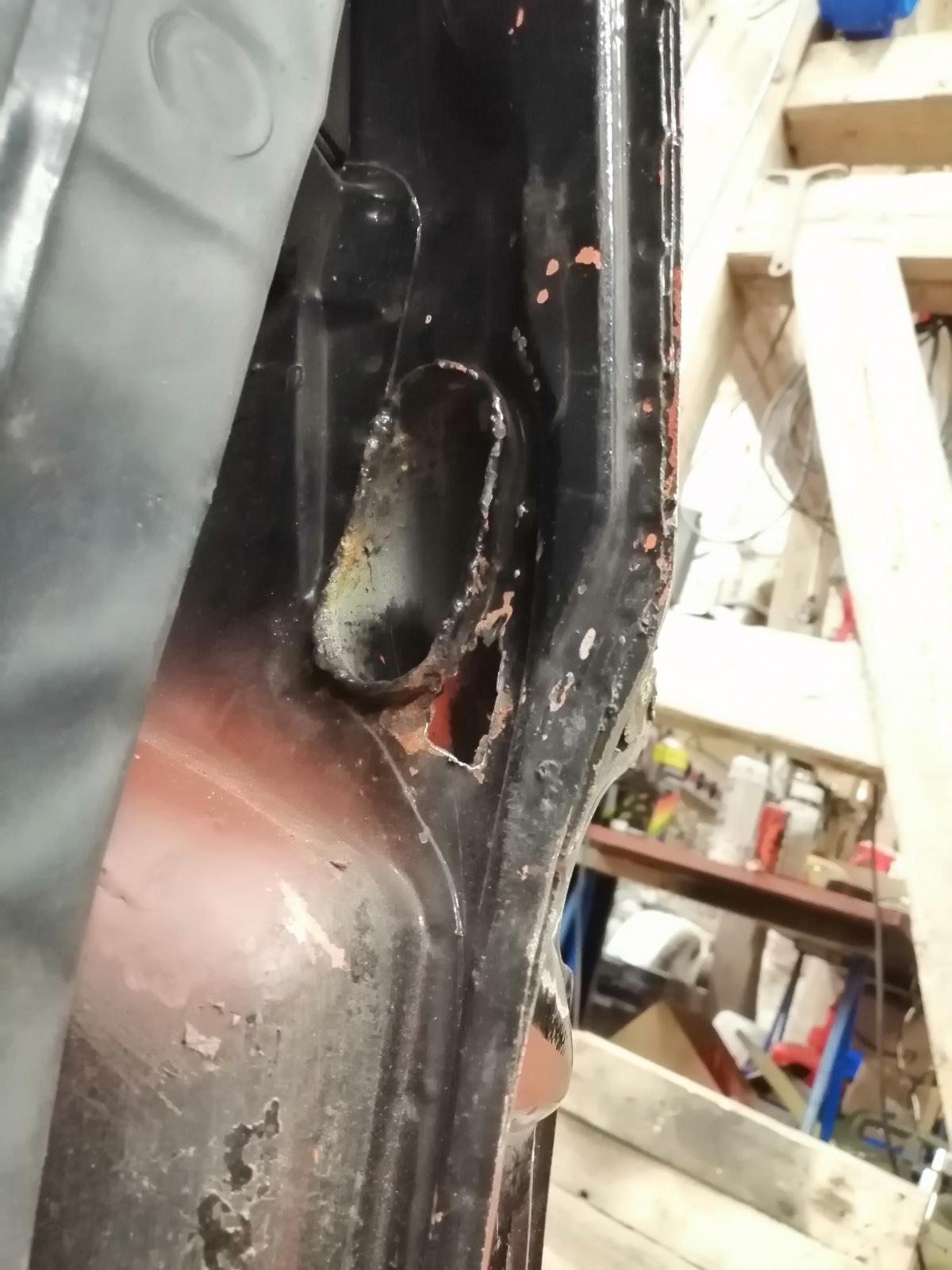

And finished:
(IMG:http://www.914world.com/bbs2/uploads_offsite/www.thesamba.com-24690-1635336429.5.jpg)

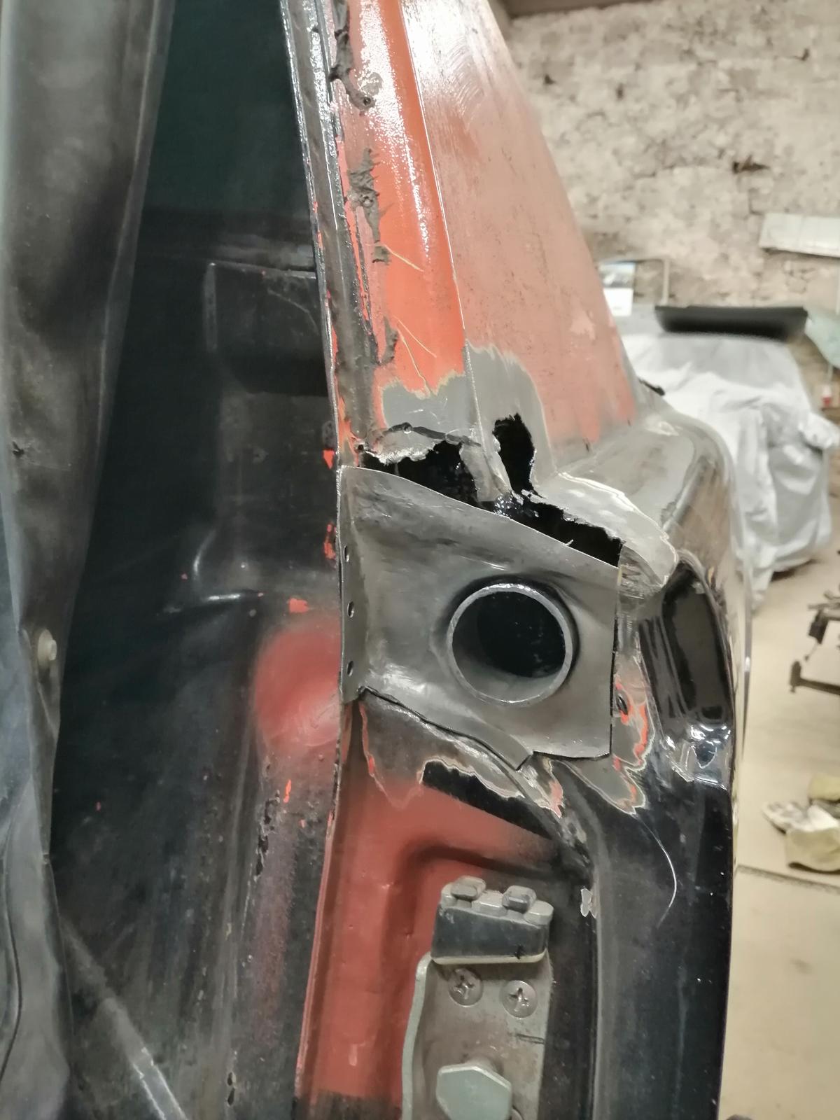

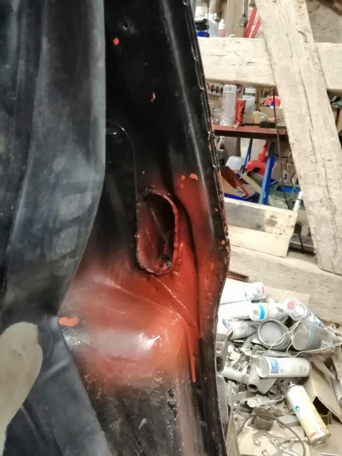

And here:
(IMG:http://www.914world.com/bbs2/uploads_offsite/www.thesamba.com-24690-1635336430.6.jpg)
(IMG:http://www.914world.com/bbs2/uploads_offsite/www.thesamba.com-24690-1635336430.7.jpg)
