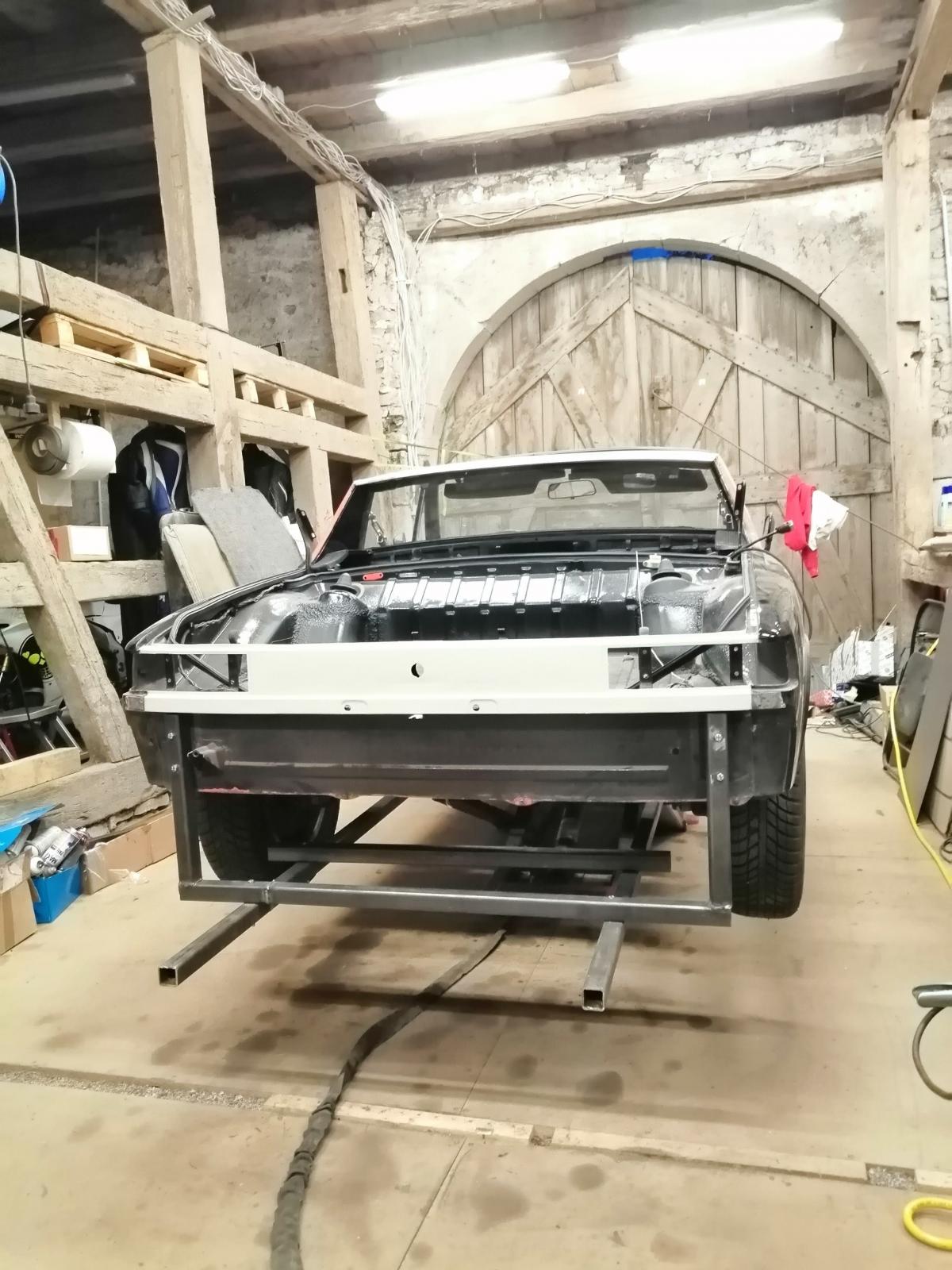

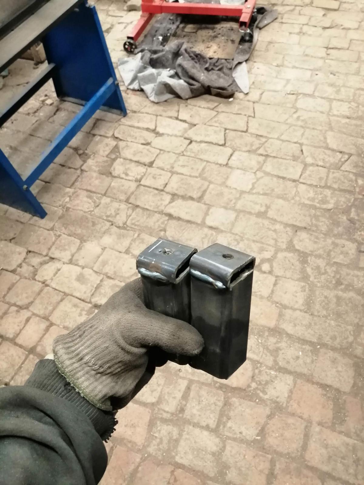

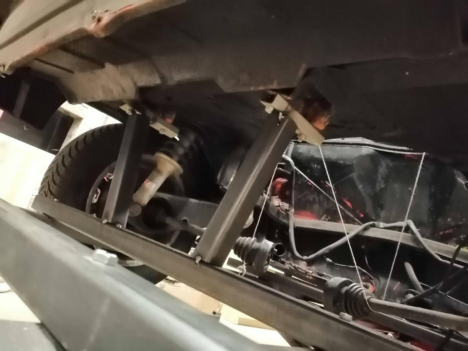

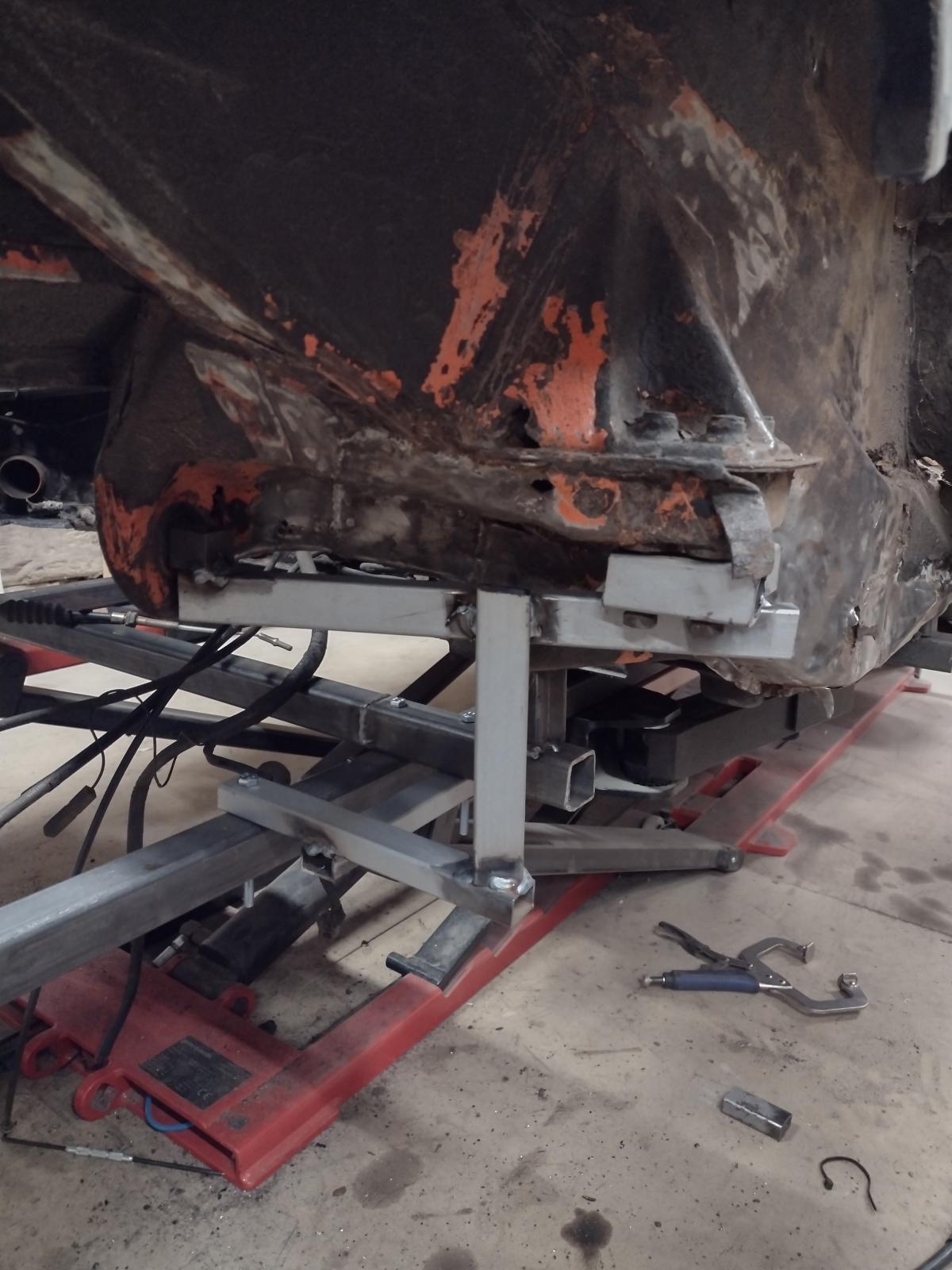

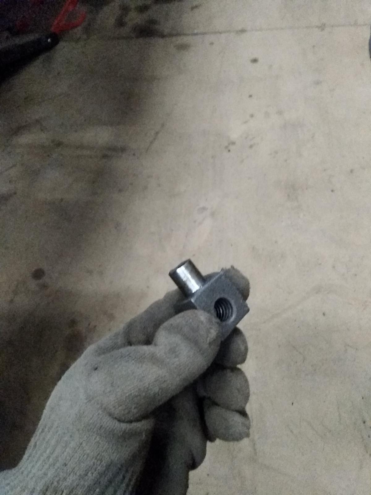

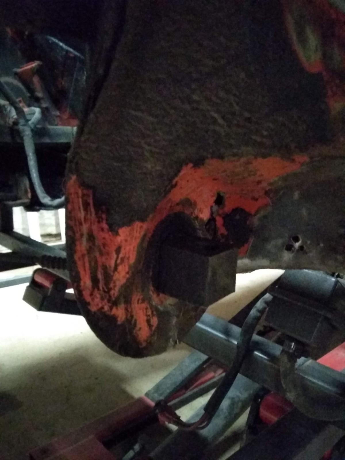

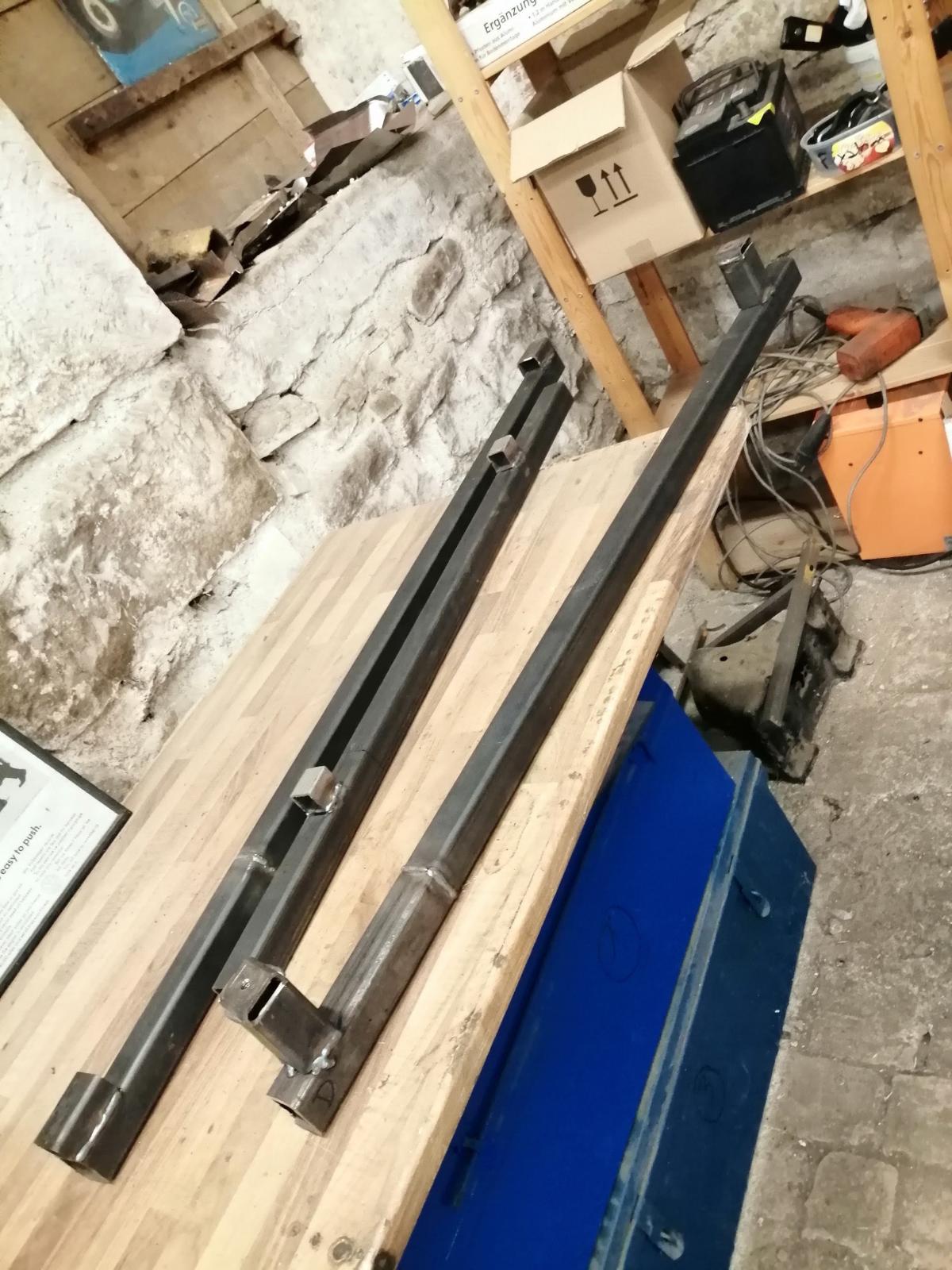

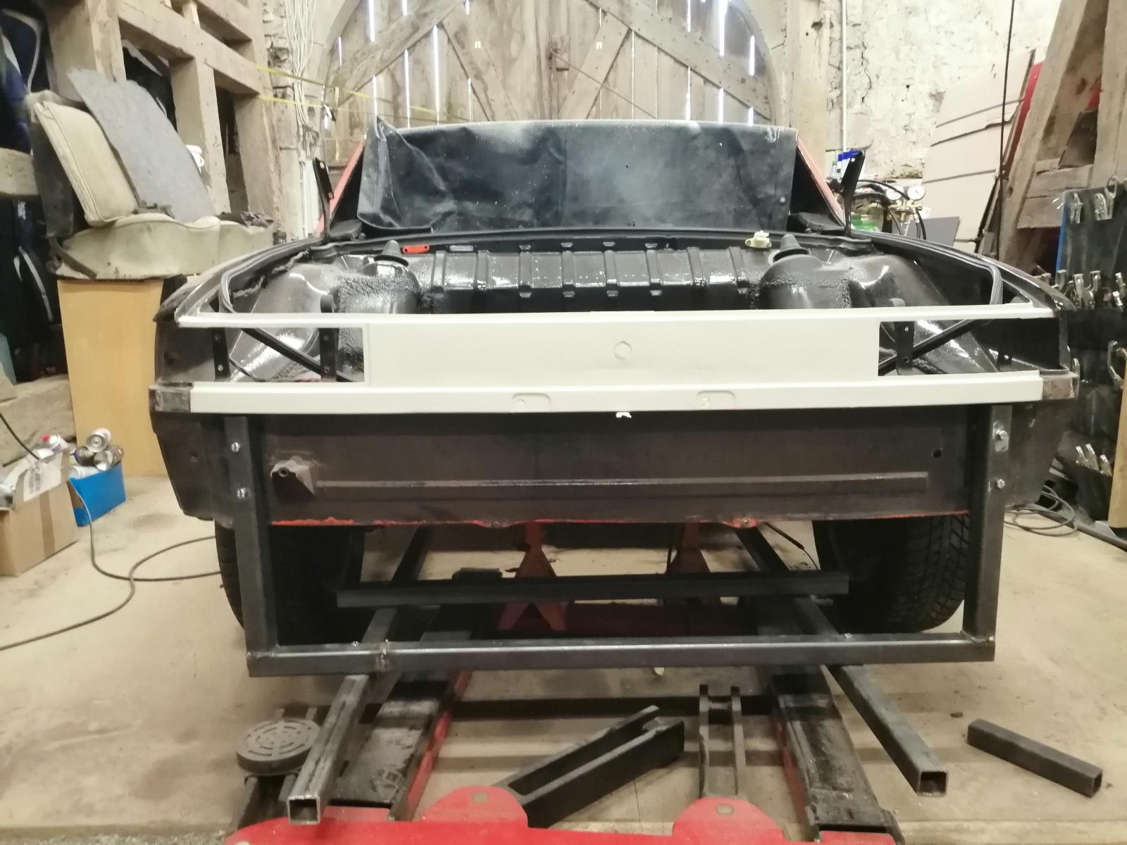

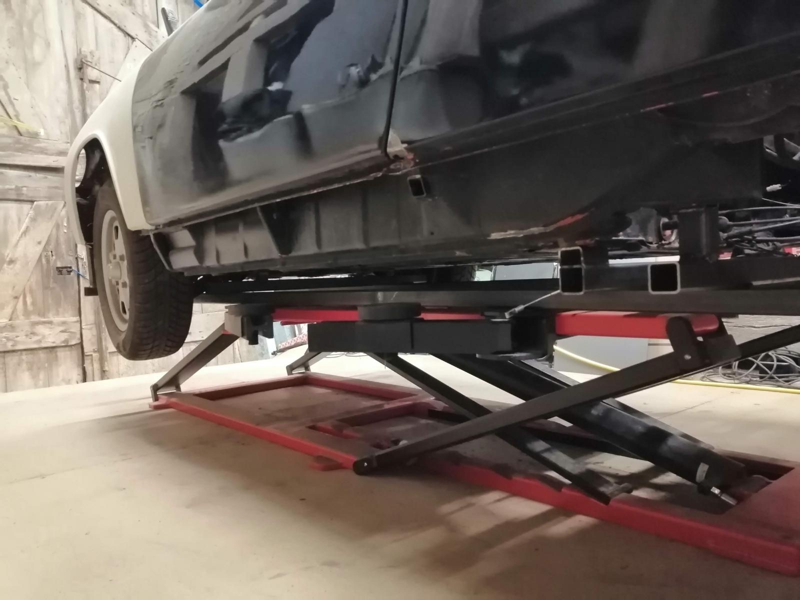

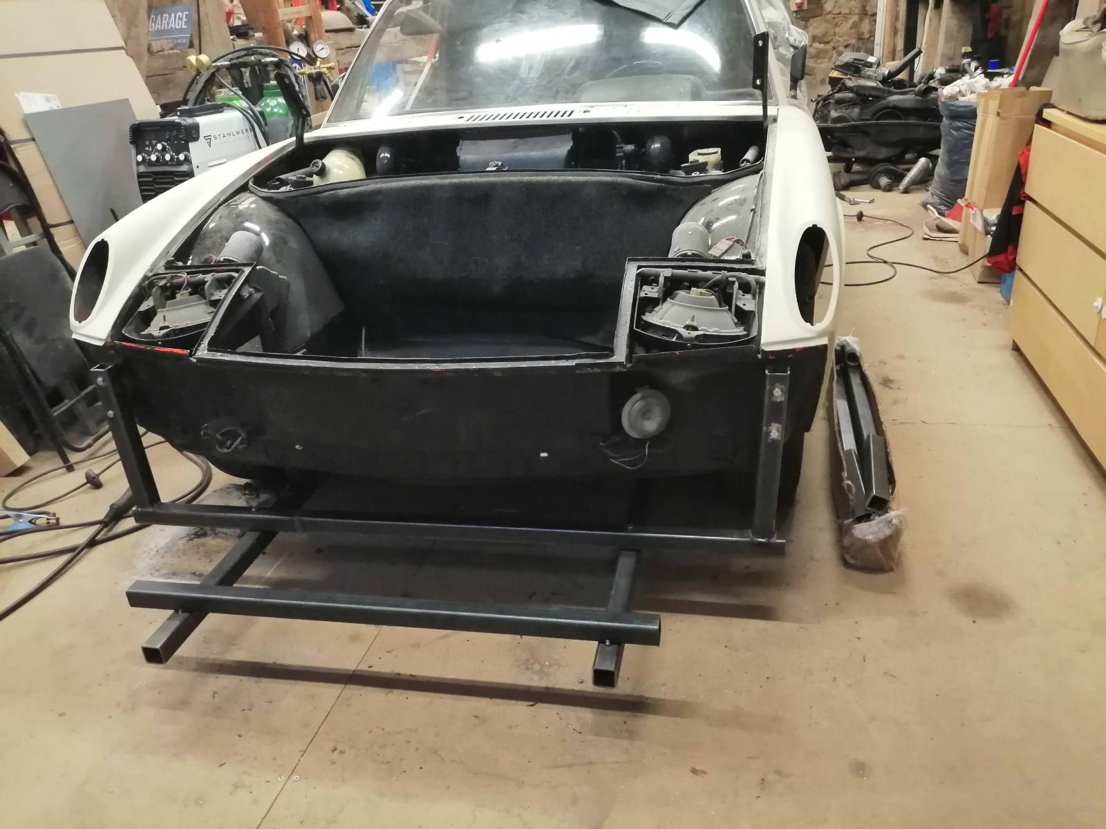

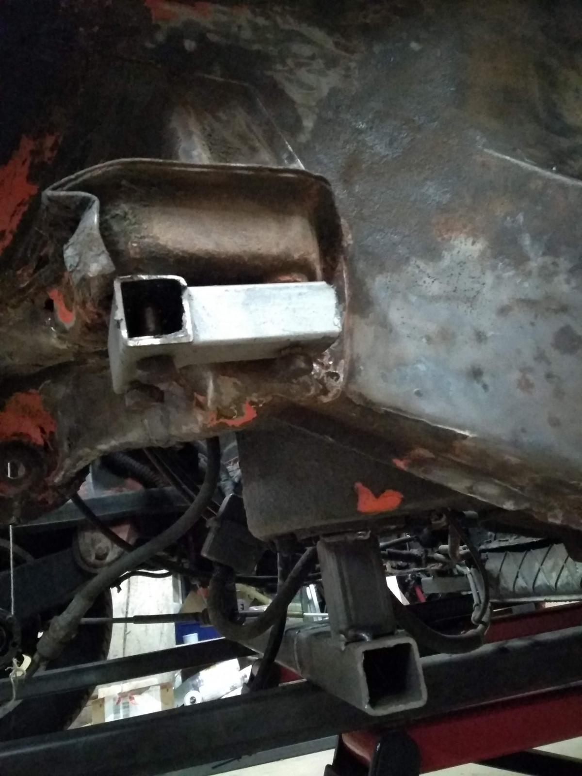

So, I made my body frame to ensure nothing moves during welding:
Every fixation is screwed to be able to remove/reuse all after.
Front:
(IMG:http://www.914world.com/bbs2/uploads_offsite/www.thesamba.com-24690-1635520452.1.jpg)
Back:
(IMG:http://www.914world.com/bbs2/uploads_offsite/www.thesamba.com-24690-1635520453.2.jpg)
Under the gearbox: (pic during tacking, fully welded after)
(IMG:http://www.914world.com/bbs2/uploads_offsite/www.thesamba.com-24690-1635520453.3.jpg)
Engine mount:
(IMG:http://www.914world.com/bbs2/uploads_offsite/www.thesamba.com-24690-1635520453.4.jpg)
(IMG:http://www.914world.com/bbs2/uploads_offsite/www.thesamba.com-24690-1635520454.5.jpg)
(IMG:http://www.914world.com/bbs2/uploads_offsite/www.thesamba.com-24690-1635520454.6.jpg)

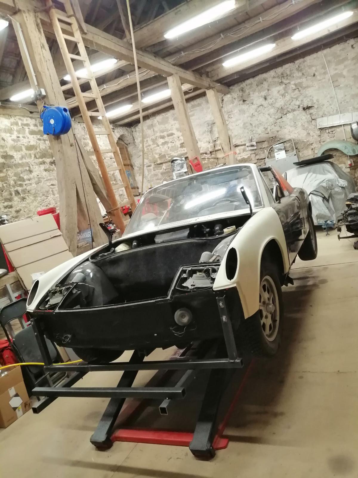

And the car is up:
(IMG:http://www.914world.com/bbs2/uploads_offsite/www.thesamba.com-24690-1635520456.11.jpg)
(IMG:http://www.914world.com/bbs2/uploads_offsite/www.thesamba.com-24690-1635520456.12.jpg)
