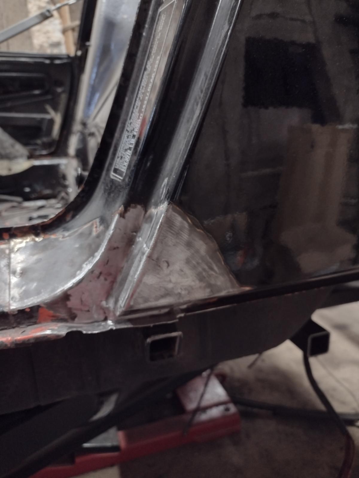

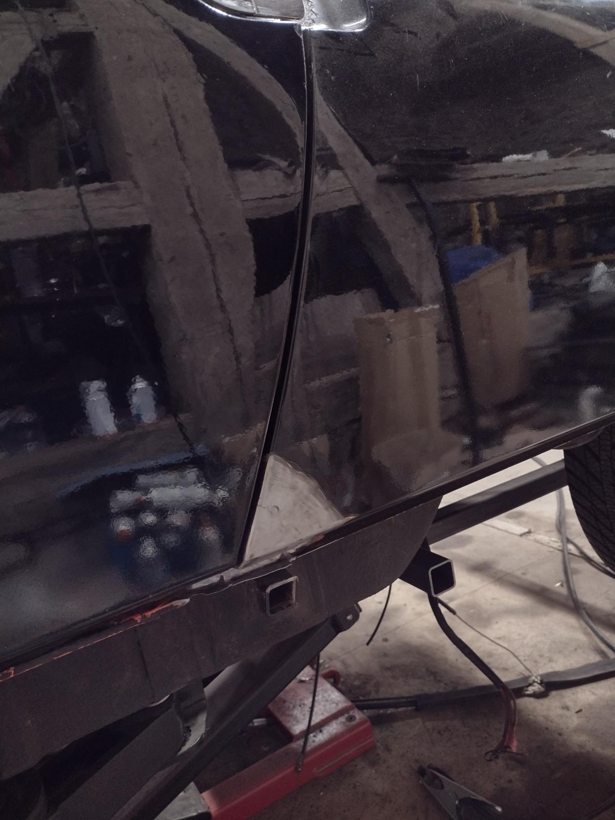

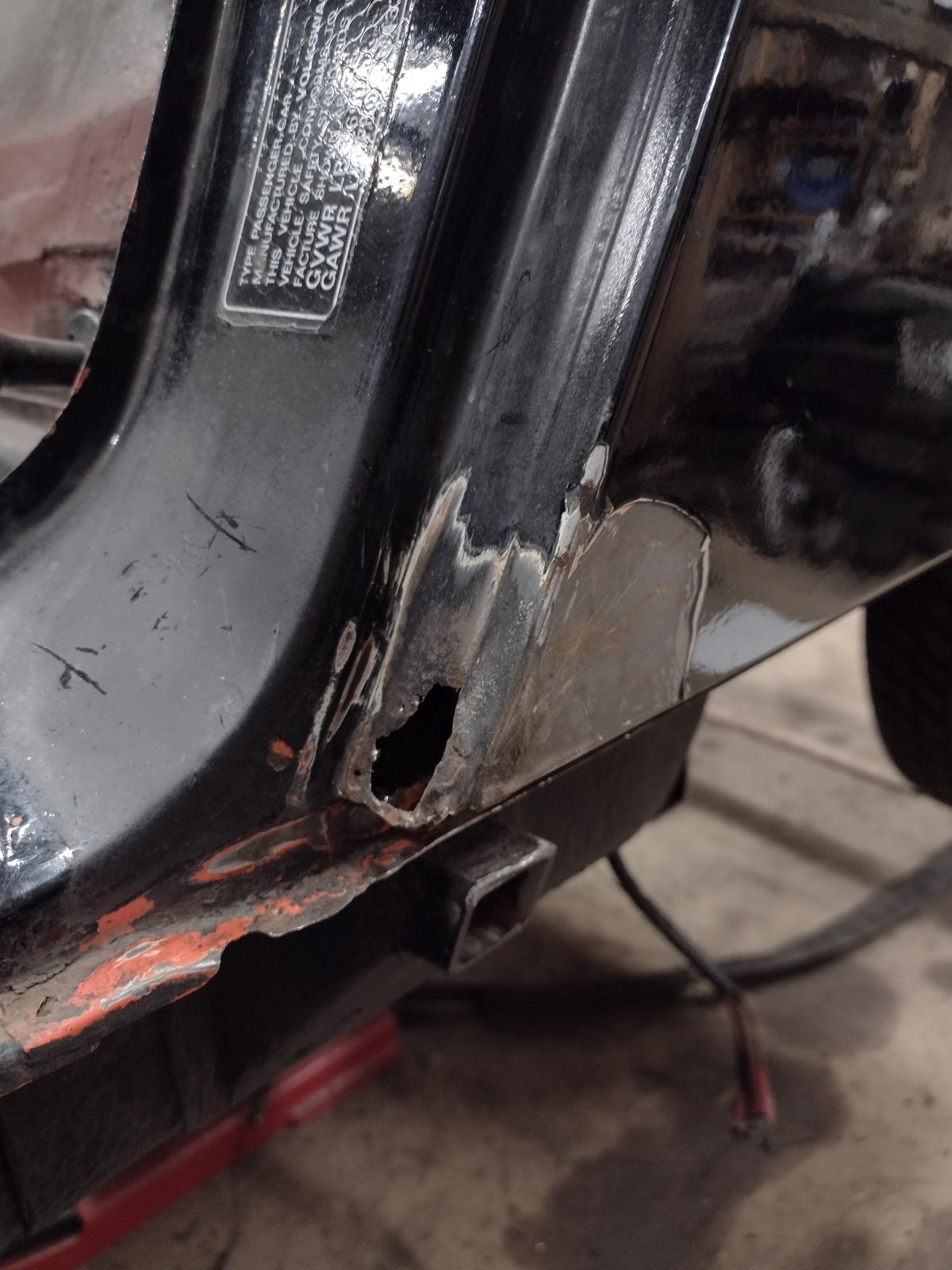

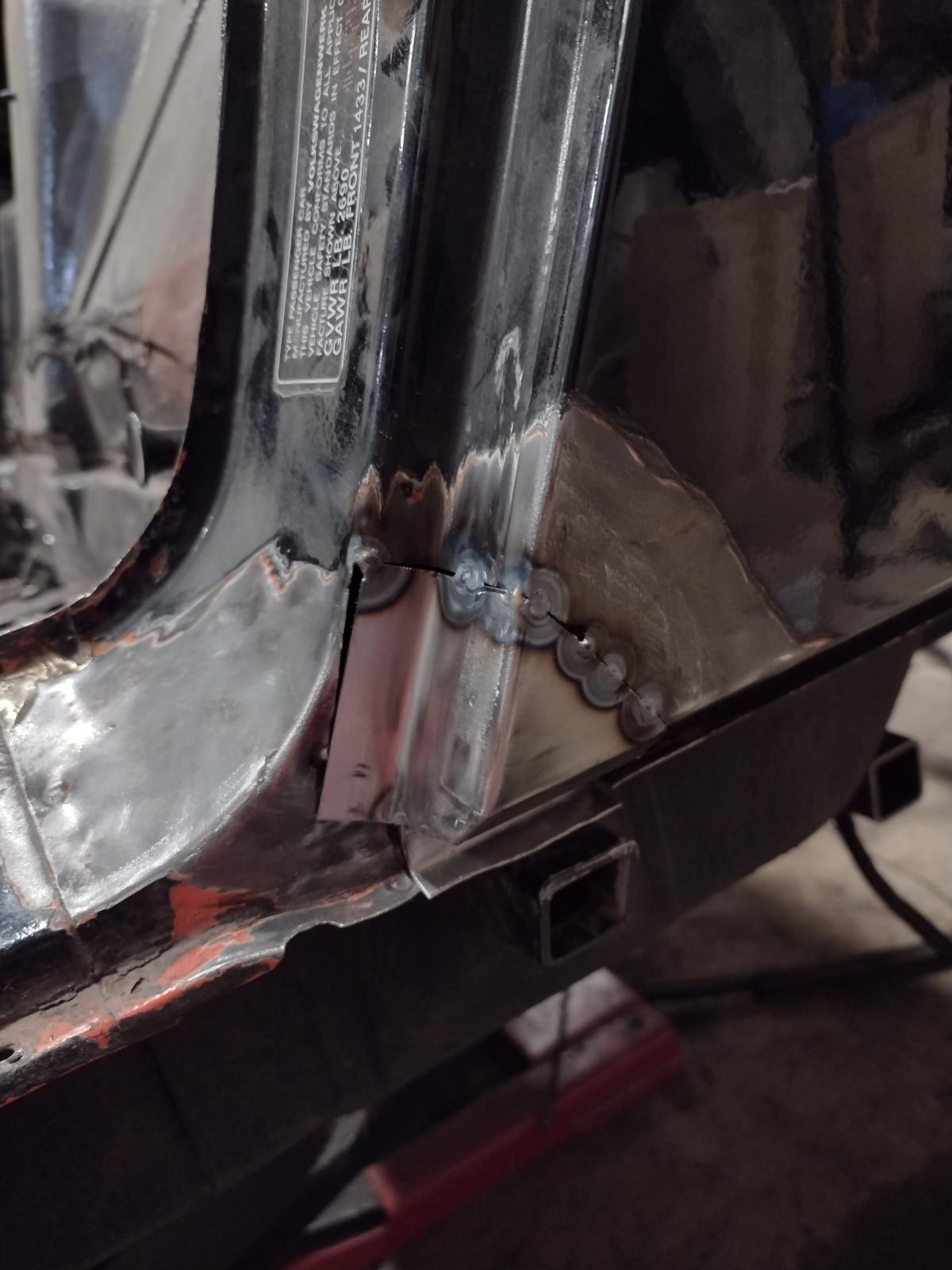

Before starting on the hellhole, I made one last repair on the driver's B-pillar.
The bottom had some holes:
(IMG:http://www.914world.com/bbs2/uploads_offsite/www.thesamba.com-24690-1635929485.1.jpg)
(IMG:http://www.914world.com/bbs2/uploads_offsite/www.thesamba.com-24690-1635929486.2.jpg)

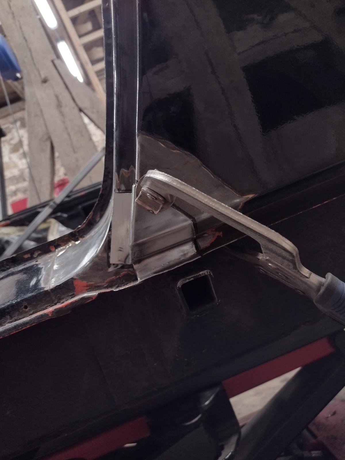

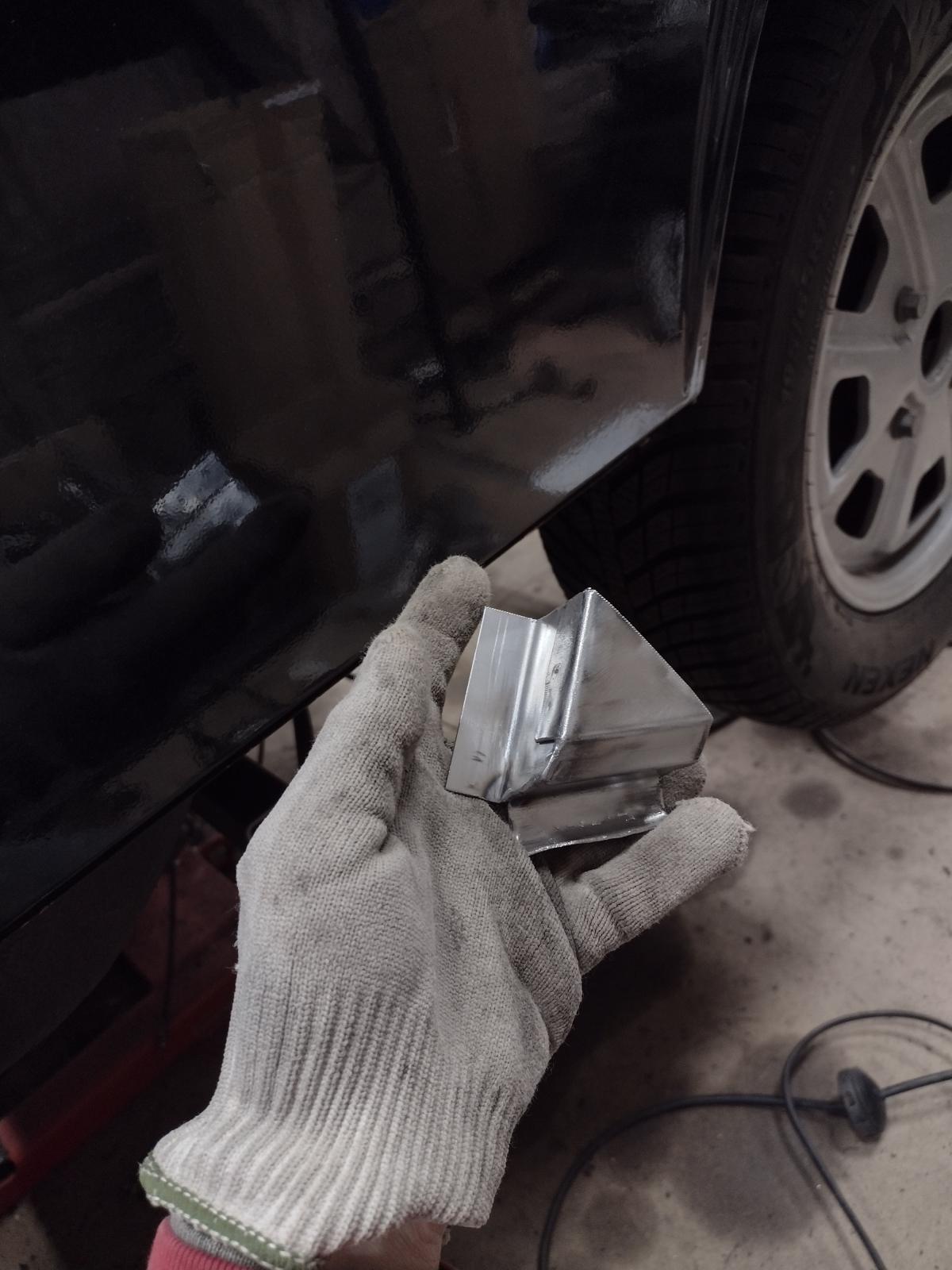

So I built the repair part in two parts as original:
(IMG:http://www.914world.com/bbs2/uploads_offsite/www.thesamba.com-24690-1635929486.3.jpg)
Adjusted:
(IMG:http://www.914world.com/bbs2/uploads_offsite/www.thesamba.com-24690-1635929486.4.jpg)
Tacked in position :
(IMG:http://www.914world.com/bbs2/uploads_offsite/www.thesamba.com-24690-1635929487.5.jpg)
And welded:
(IMG:http://www.914world.com/bbs2/uploads_offsite/www.thesamba.com-24690-1635929487.6.jpg)
(IMG:http://www.914world.com/bbs2/uploads_offsite/www.thesamba.com-24690-1635929487.7.jpg)
Stay tuned, hellhole repair comes next!

TRS63   So, as I said, before going further, I repaired pr...   Nov 19 2021, 03:18 AM
TRS63   So, next update ! I removed the triangle at th...   Nov 26 2021, 03:20 AM
wonkipop   great stuff @TRS63 . since you are a dedicated L...   Nov 26 2021, 03:57 AM
TRS63   Thanks for the kind words ! :beer2: I did not...   Nov 27 2021, 12:57 PM
TRS63   So, I finished welding the seat belt mounting poin...   Dec 6 2021, 02:59 AM
