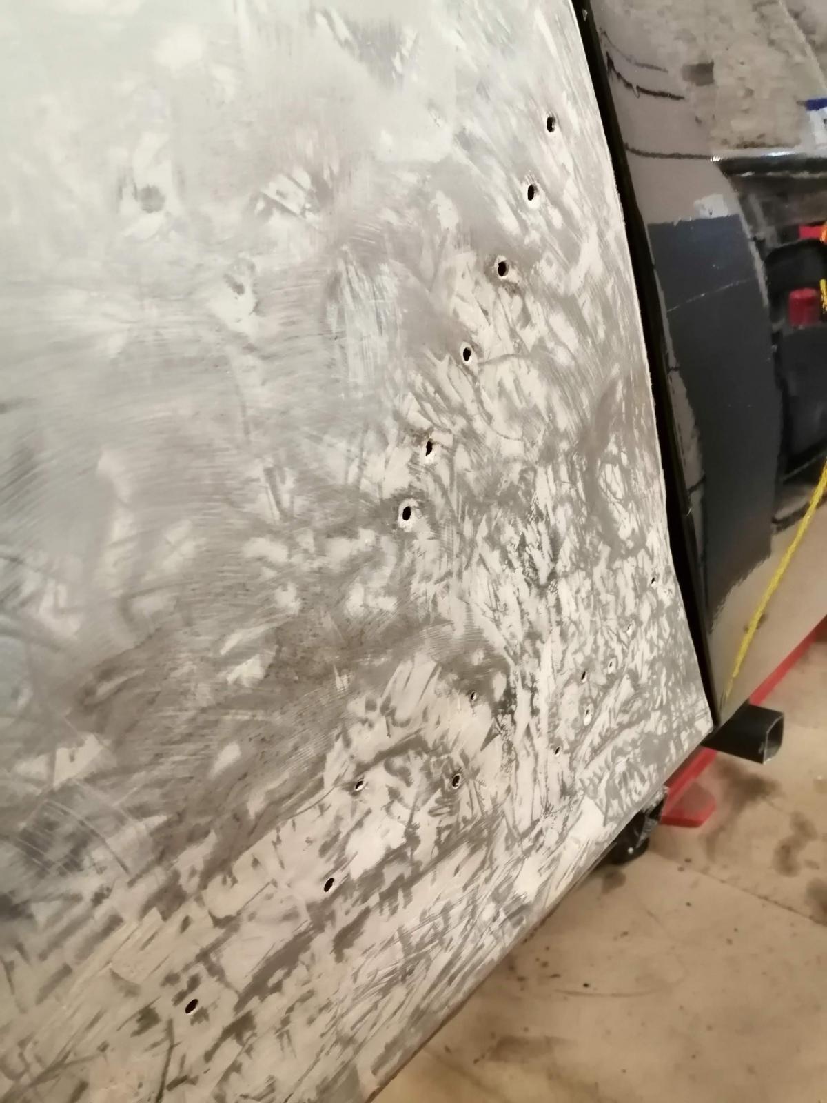

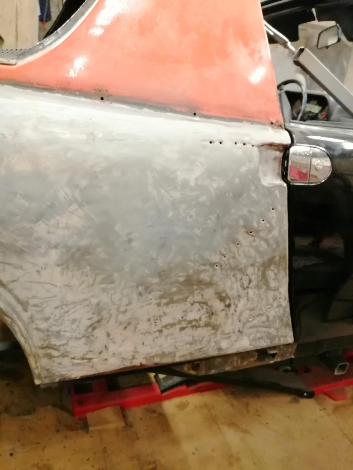

So, before removing the paint on the right rear quarter panel, I was'nt sure how to deal with it while repairing the hellhole. I knew cutting it would allow me a better access but cutting good metal is always a hard decision..
Well, from that point of view I got "lucky" (IMG:style_emoticons/default/lol-2.gif) because there is no good metal (IMG:style_emoticons/default/unsure.gif) (IMG:style_emoticons/default/lol-2.gif)
Here without paint:

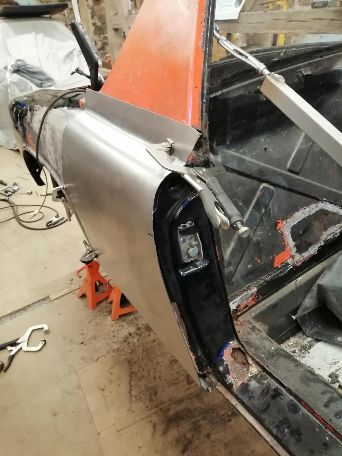

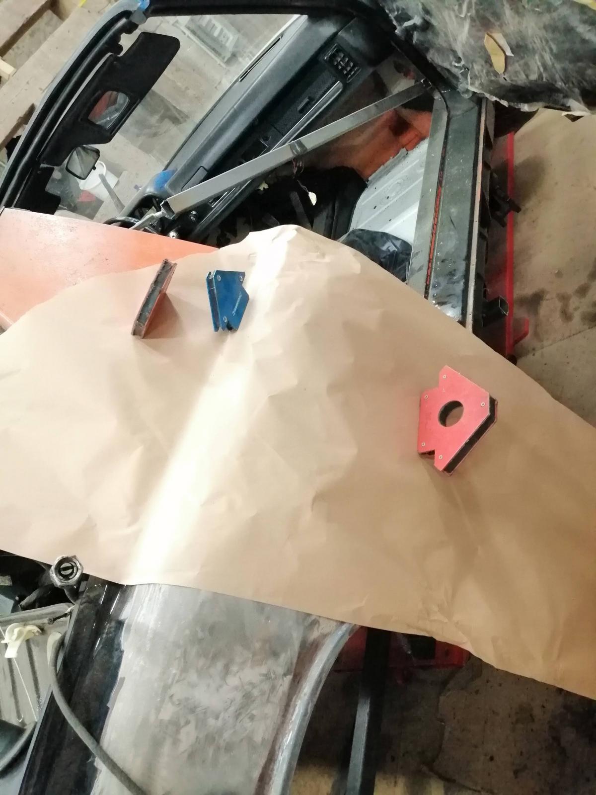

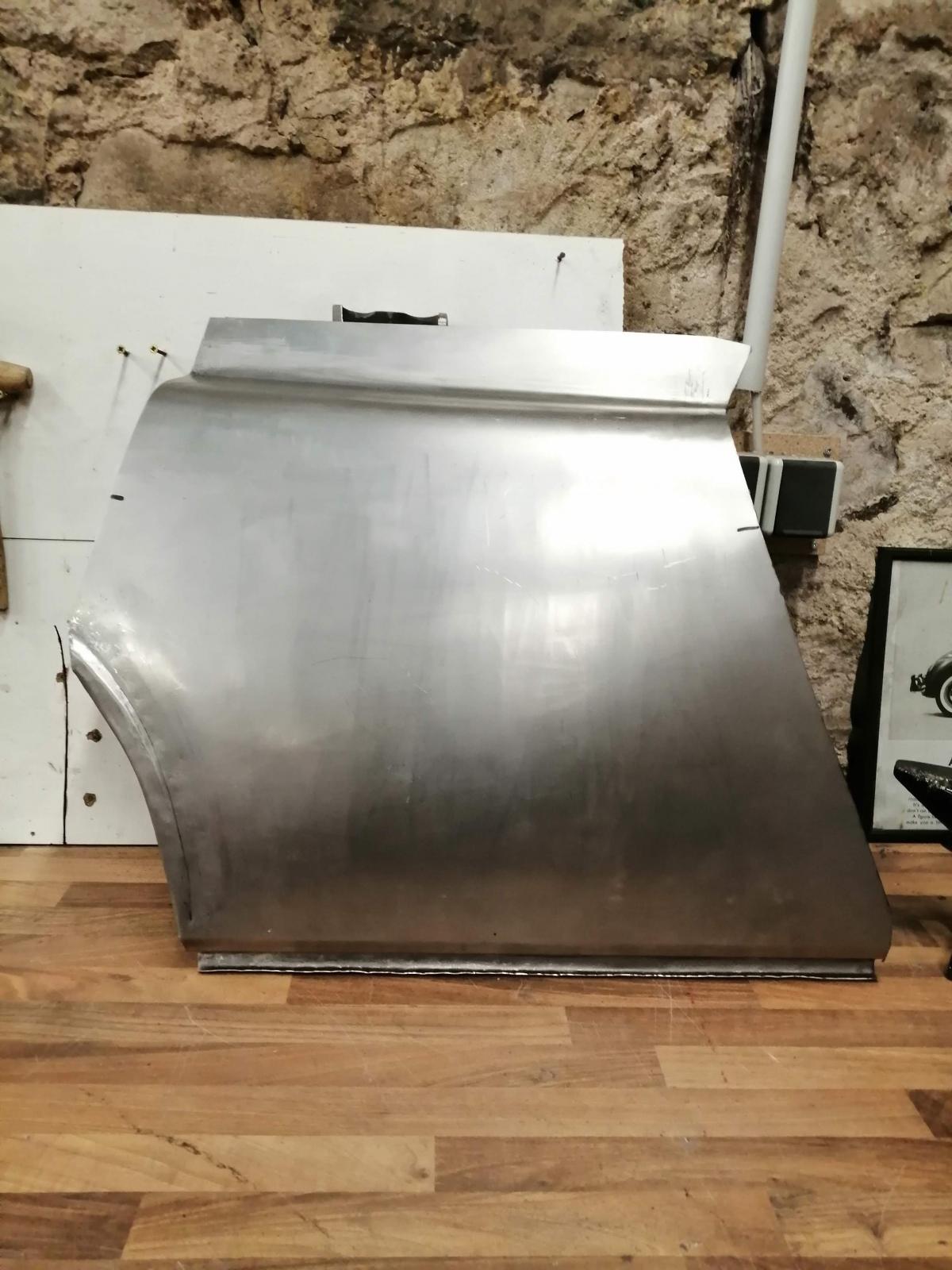

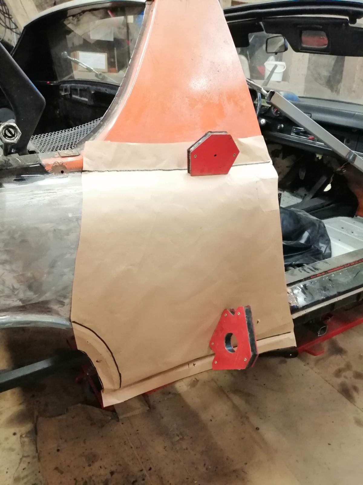

And I have a habit that I built(or make sure I have it) the part before cutting, to ensure I won't miss any measurement/positioning. So here we go !
Making my template :
(IMG:http://www.914world.com/bbs2/uploads_offsite/www.thesamba.com-24690-1636101716.3.jpg)
(IMG:http://www.914world.com/bbs2/uploads_offsite/www.thesamba.com-24690-1636101716.4.jpg)

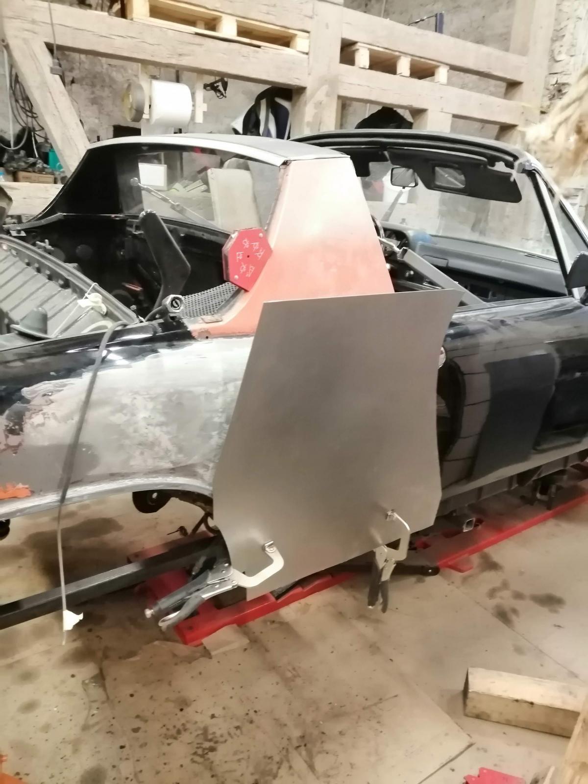

And starting :
(IMG:http://www.914world.com/bbs2/uploads_offsite/www.thesamba.com-24690-1636101716.5.jpg)
(IMG:http://www.914world.com/bbs2/uploads_offsite/www.thesamba.com-24690-1636101717.6.jpg)

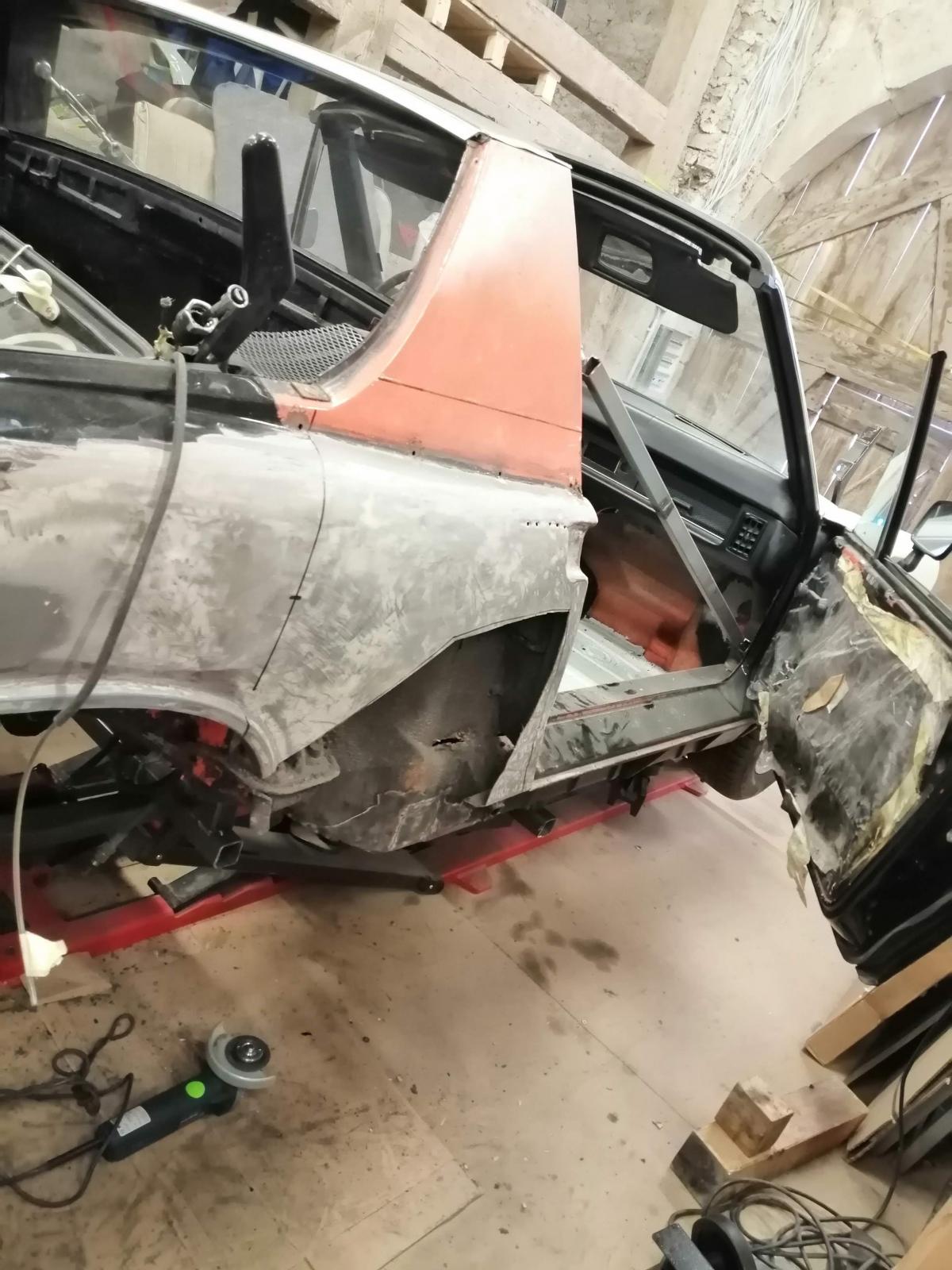

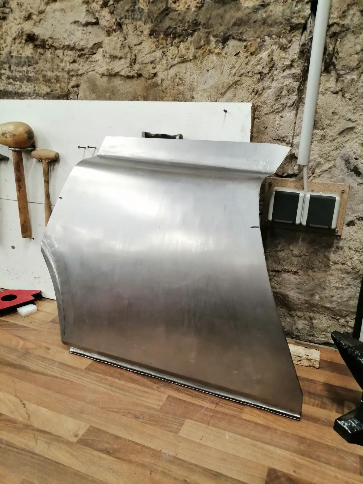

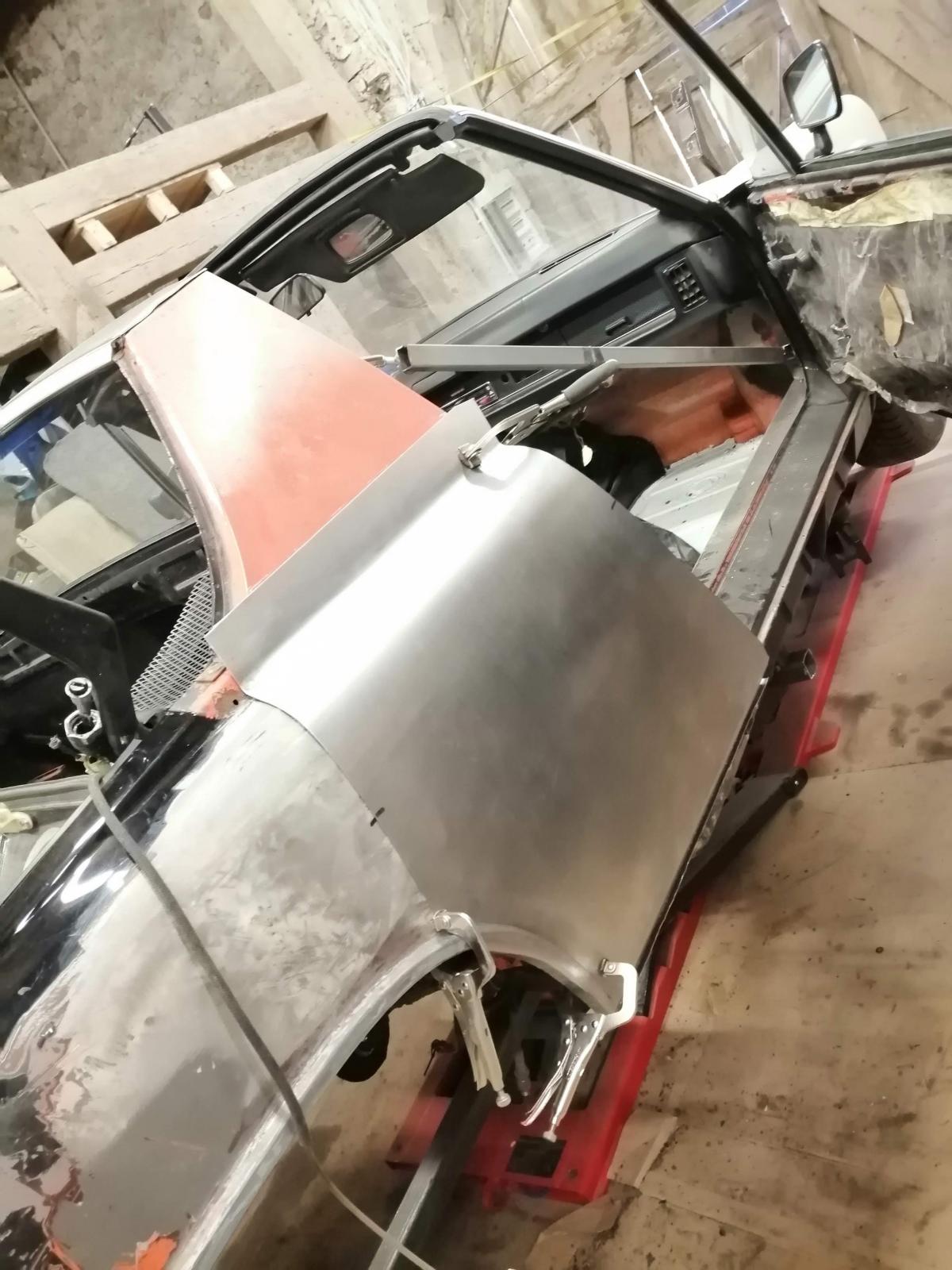

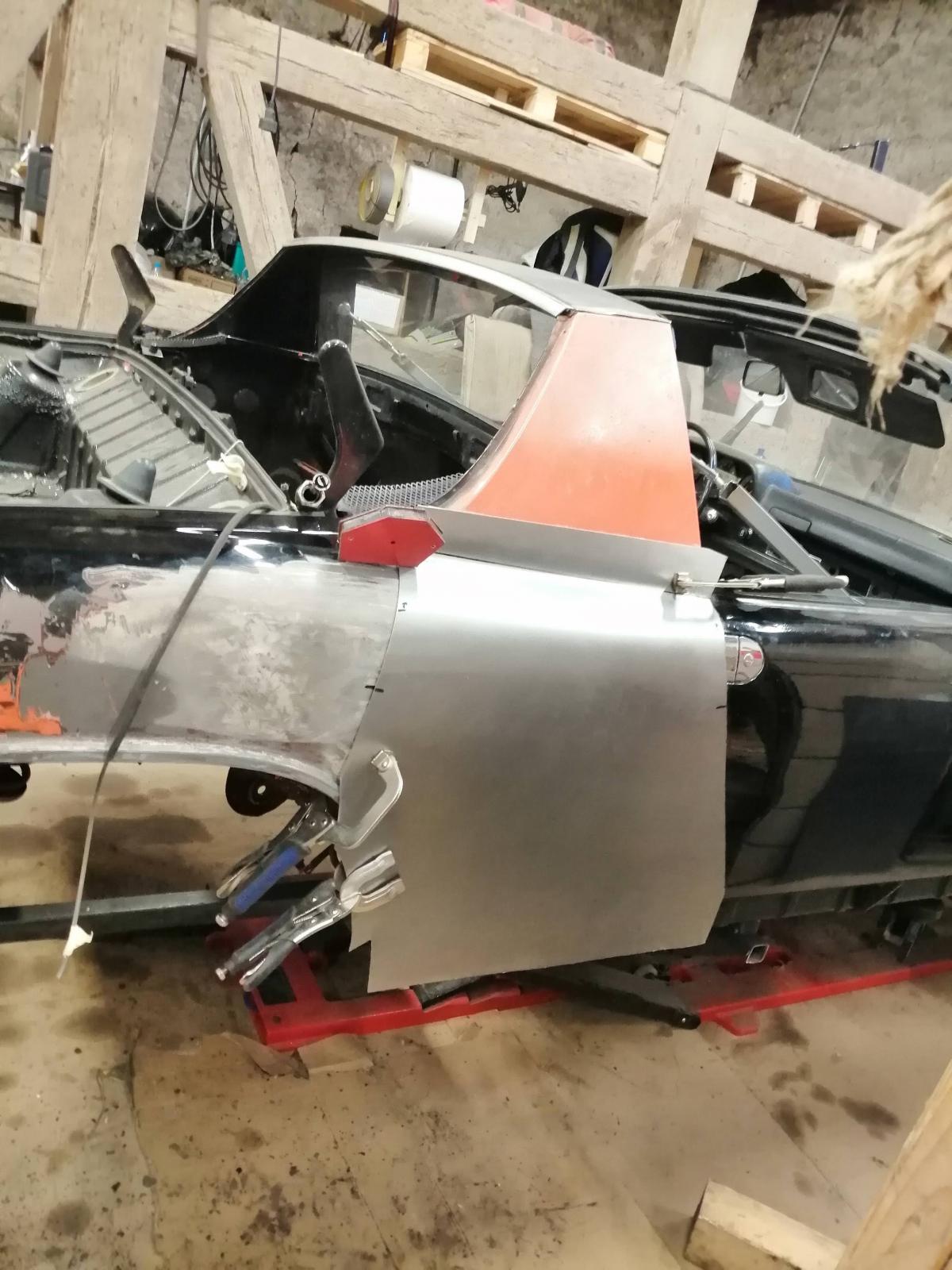

And after a couple hours:
(IMG:http://www.914world.com/bbs2/uploads_offsite/www.thesamba.com-24690-1636101717.7.jpg)
(IMG:http://www.914world.com/bbs2/uploads_offsite/www.thesamba.com-24690-1636101718.8.jpg)
(IMG:http://www.914world.com/bbs2/uploads_offsite/www.thesamba.com-24690-1636101718.9.jpg)
(IMG:http://www.914world.com/bbs2/uploads_offsite/www.thesamba.com-24690-1636101718.10.jpg)
I left the front part undone to be able to make a good door gap when it comes to that time.
So, now that this is done..cutting!
