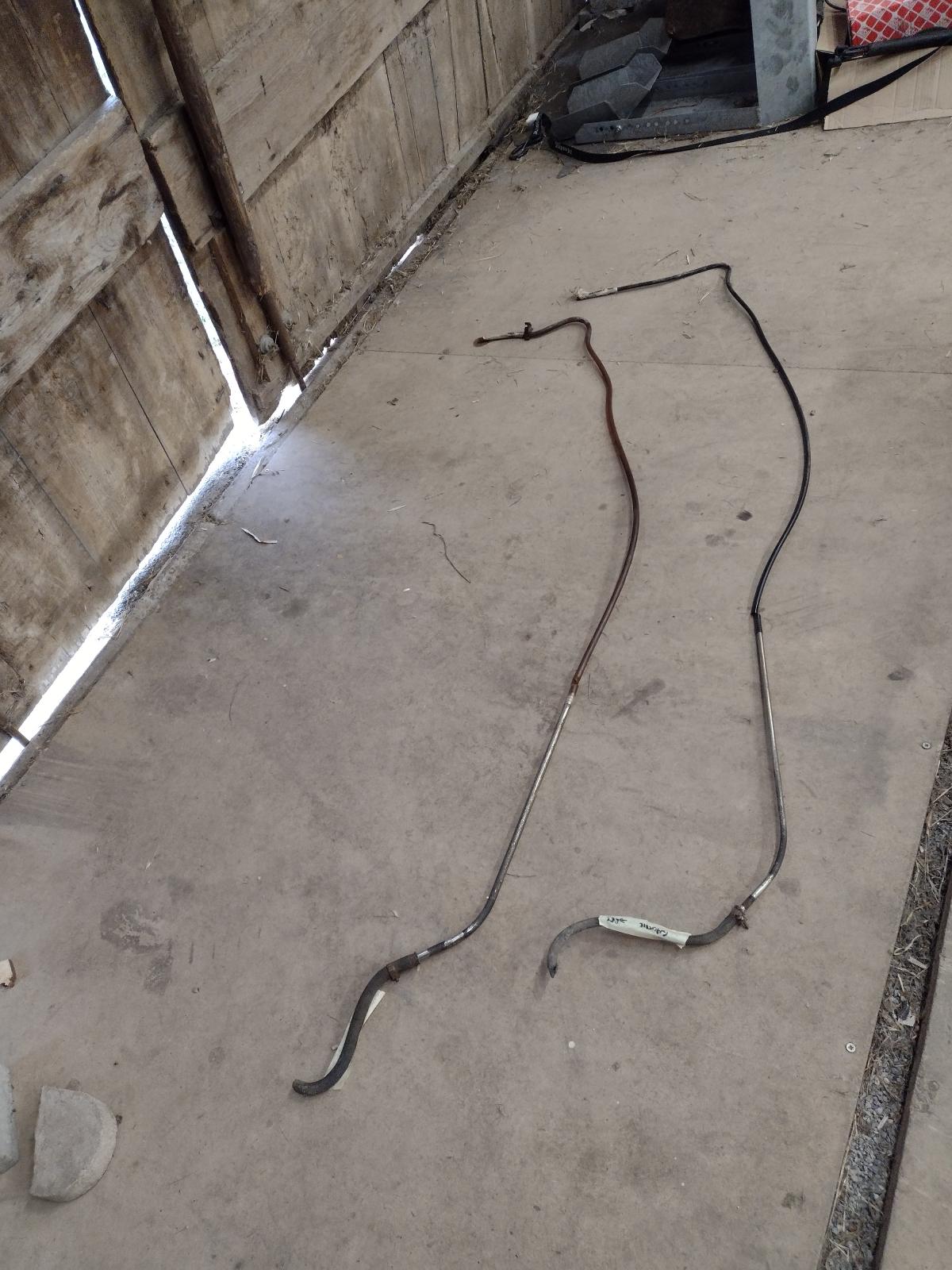

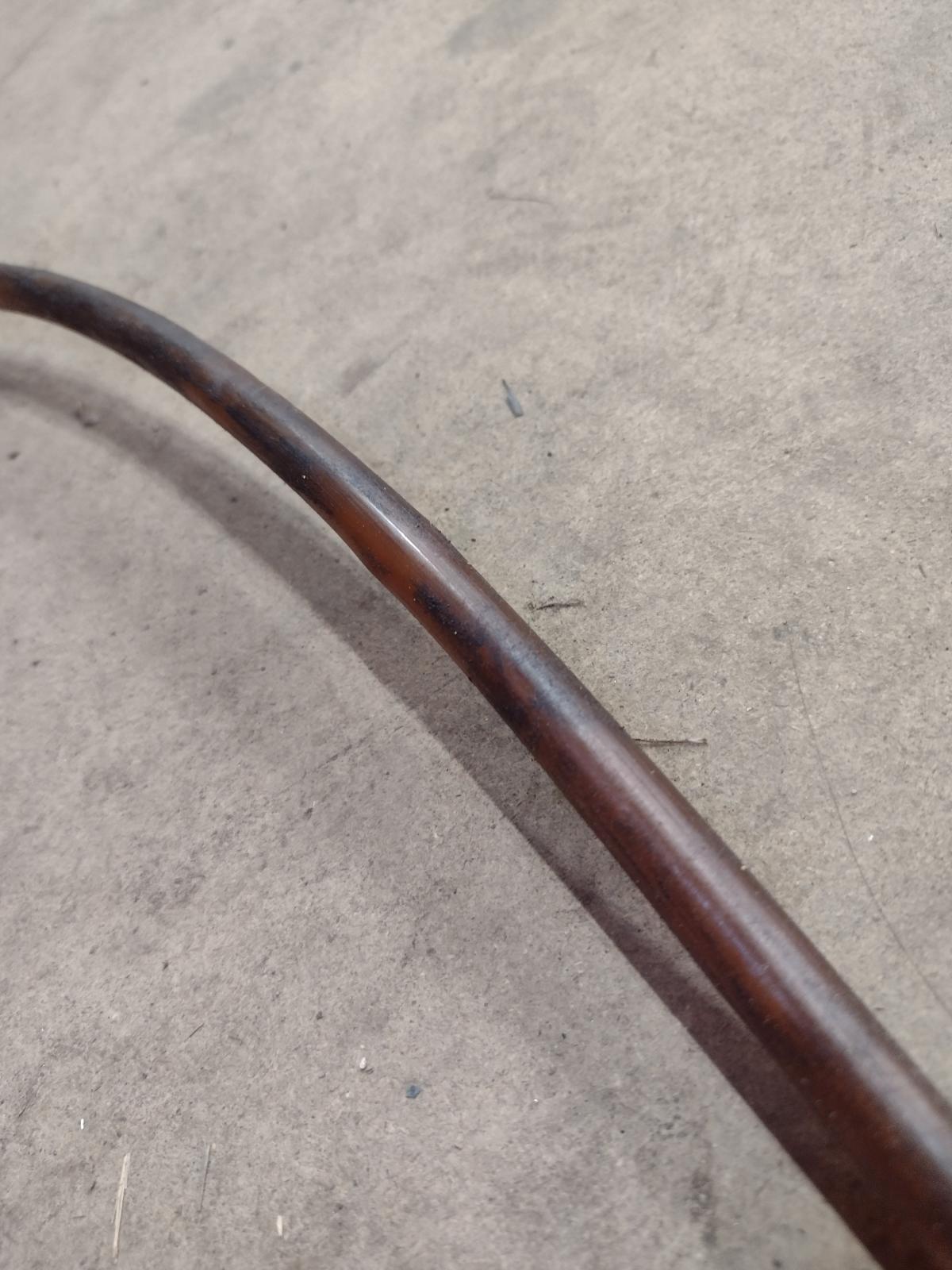

I removed the 47 years old fuel lines: (IMG:style_emoticons/default/smash.gif)
(IMG:http://www.914world.com/bbs2/uploads_offsite/www.thesamba.com-24690-1636378058.1.jpg)
(IMG:http://www.914world.com/bbs2/uploads_offsite/www.thesamba.com-24690-1636378059.2.jpg)
Stainless steel replacement is on its way! (IMG:style_emoticons/default/smile.gif)

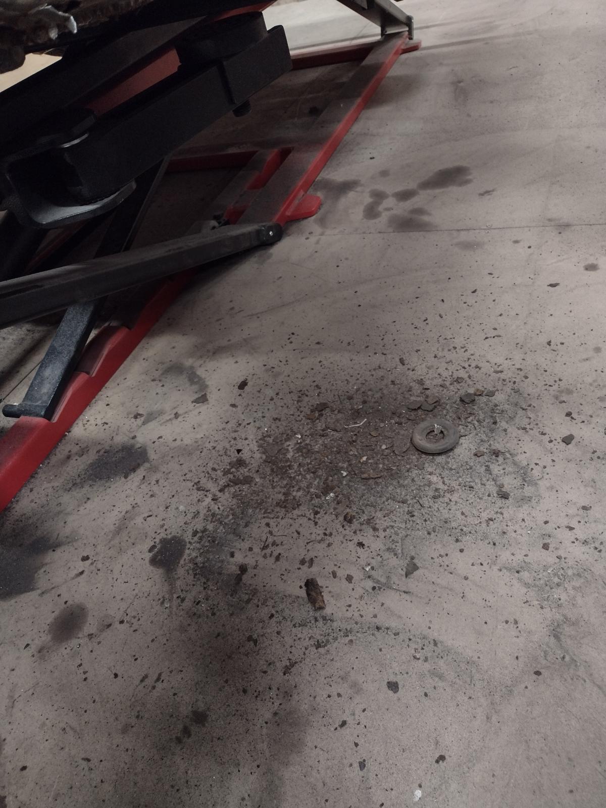

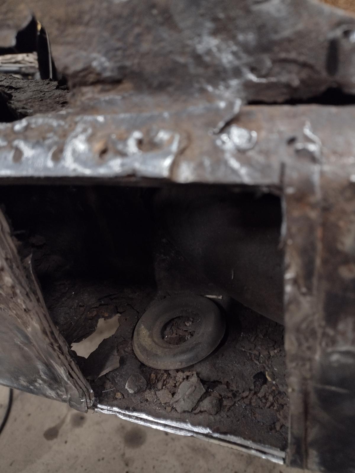

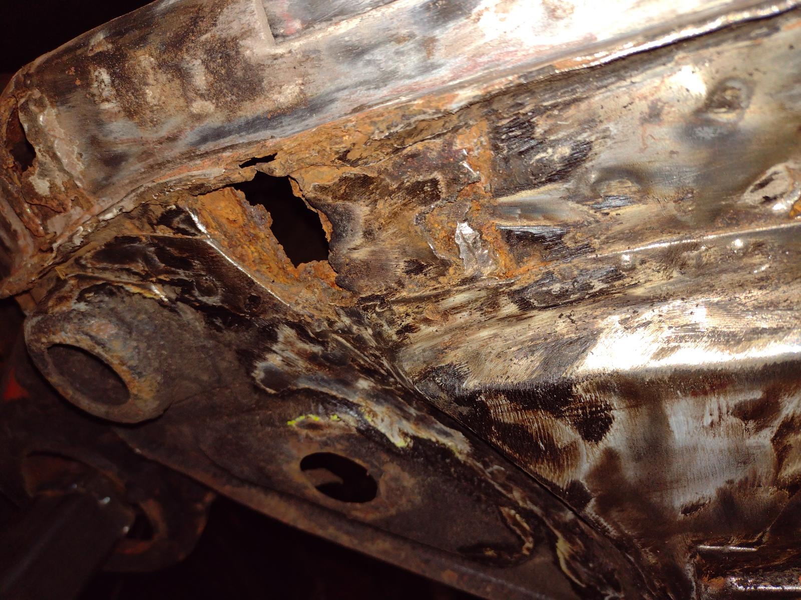

Then I looked further on the outside part of the hellhole..which doesn't look promising: (IMG:style_emoticons/default/headbang.gif)
(IMG:http://www.914world.com/bbs2/uploads_offsite/www.thesamba.com-24690-1636378060.3.jpg)
(IMG:http://www.914world.com/bbs2/uploads_offsite/www.thesamba.com-24690-1636378060.4.jpg)
(IMG:http://www.914world.com/bbs2/uploads_offsite/www.thesamba.com-24690-1636378061.5.jpg)
(IMG:http://www.914world.com/bbs2/uploads_offsite/www.thesamba.com-24690-1636378061.6.jpg)

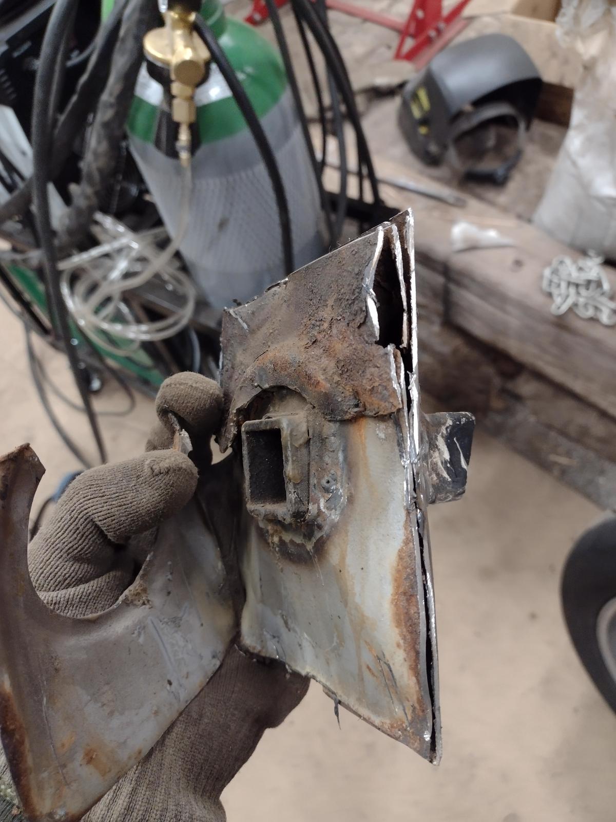

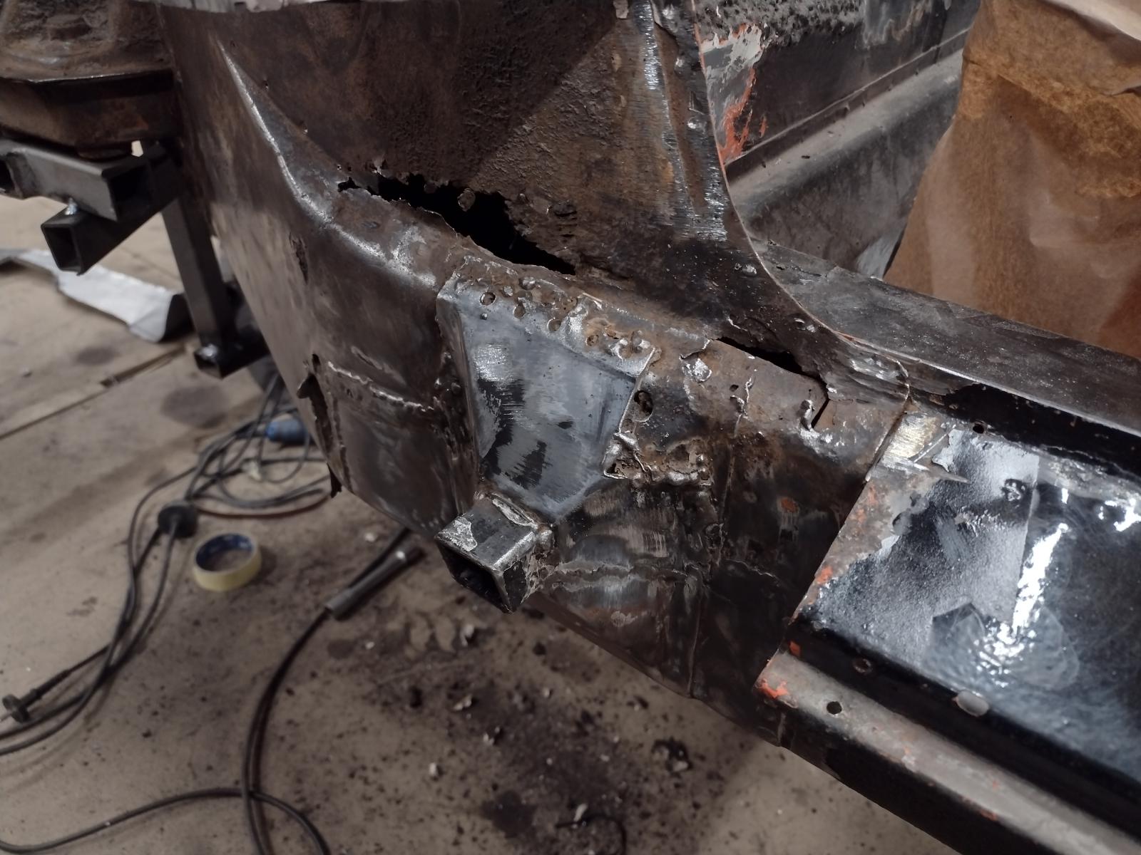

And after checking a bit inside (quite a lot of layers in this badly repaired jack point..): (IMG:style_emoticons/default/huh.gif)
(IMG:http://www.914world.com/bbs2/uploads_offsite/www.thesamba.com-24690-1636378062.7.jpg)

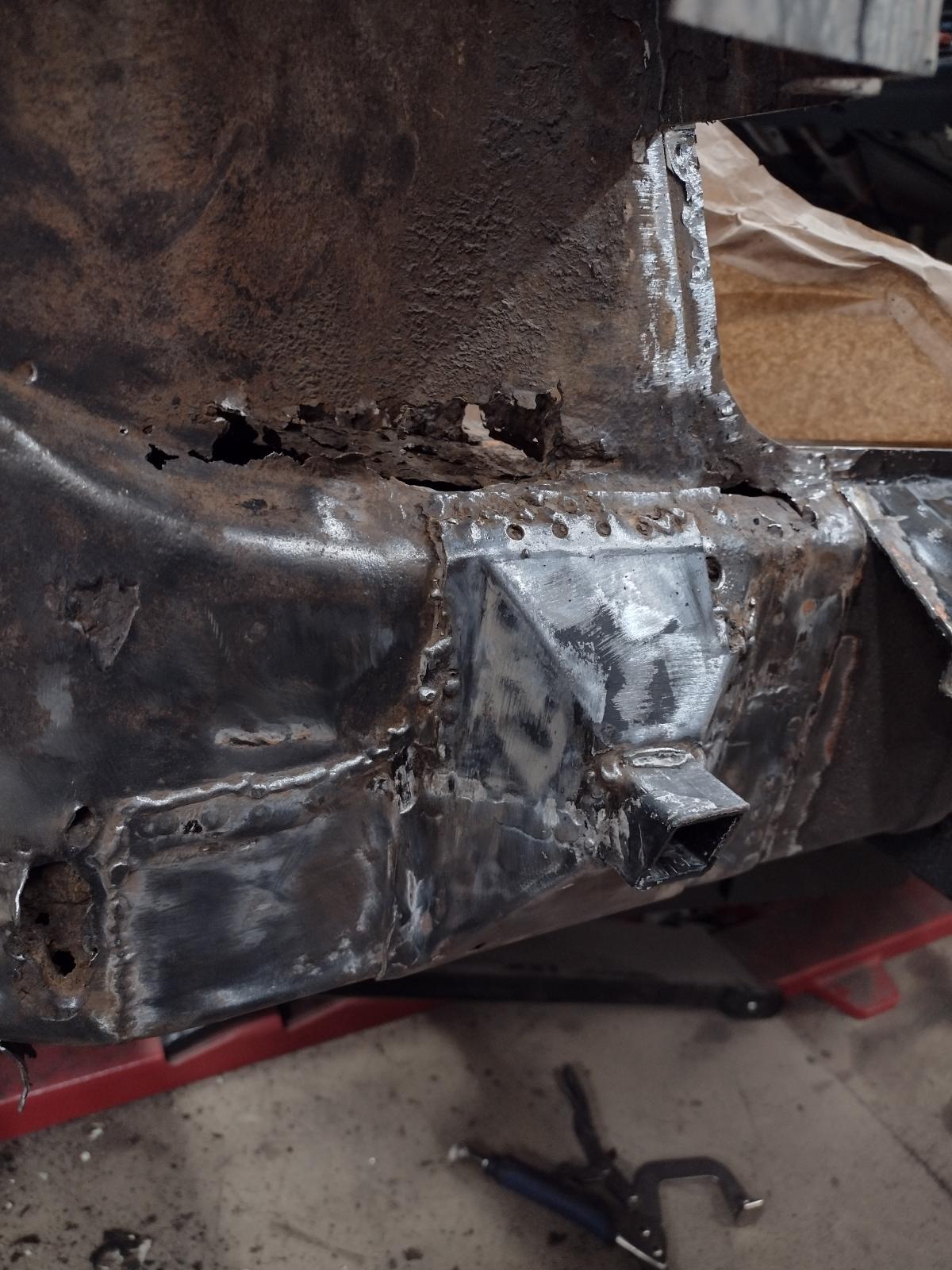

There were some findings:
(IMG:http://www.914world.com/bbs2/uploads_offsite/www.thesamba.com-24690-1636378062.8.jpg)

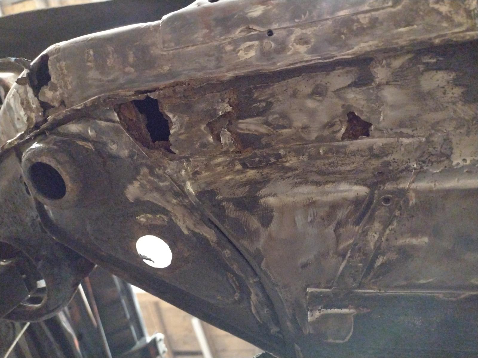

And a lot of rust falling through:
(IMG:http://www.914world.com/bbs2/uploads_offsite/www.thesamba.com-24690-1636378062.9.jpg)

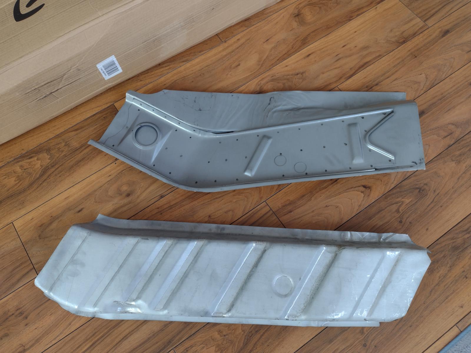

I did not want to fight forming too much thick metals so I made a small order to save me some time:
(IMG:http://www.914world.com/bbs2/uploads_offsite/www.thesamba.com-24690-1636378063.10.jpg)
