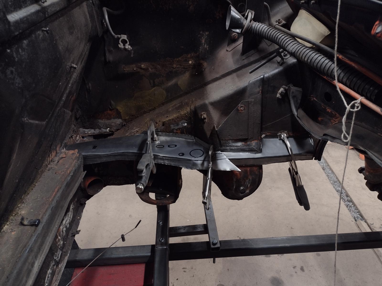

So, next on my list was the engine tray on the right..as your might remember it was not nice, so I removed it:

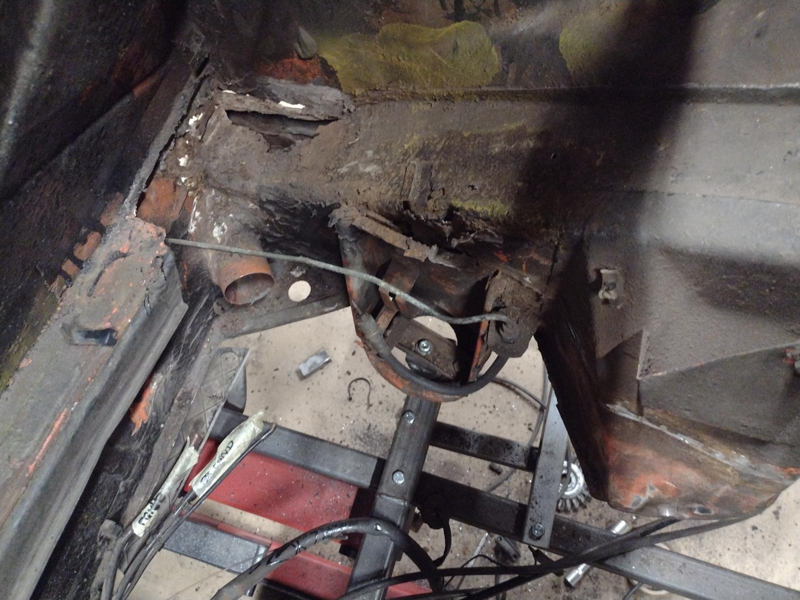

But it was even worse than I thought: (IMG:style_emoticons/default/unsure.gif)

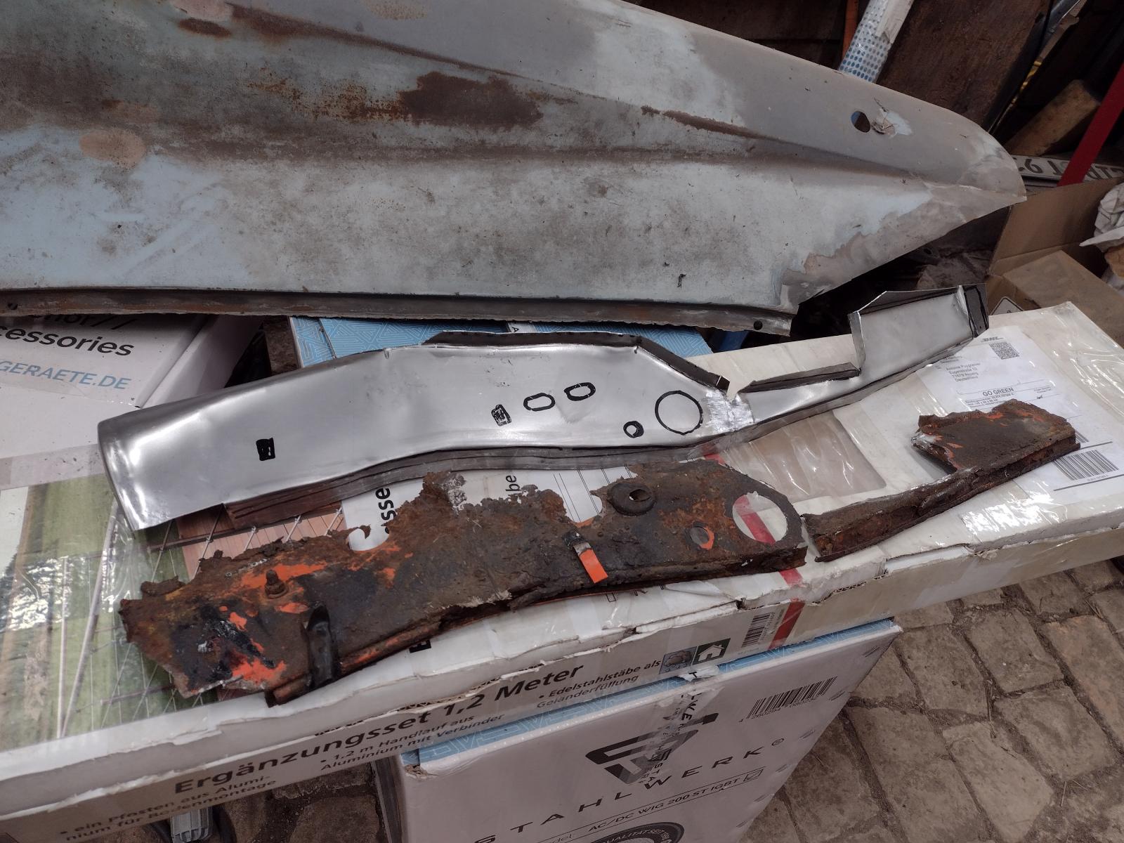

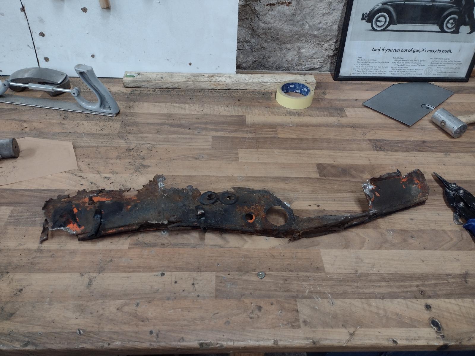

Almost not enough to use as a template! (IMG:style_emoticons/default/unsure.gif)
(IMG:http://www.914world.com/bbs2/uploads_offsite/www.thesamba.com-24690-1636547863.3.jpg)

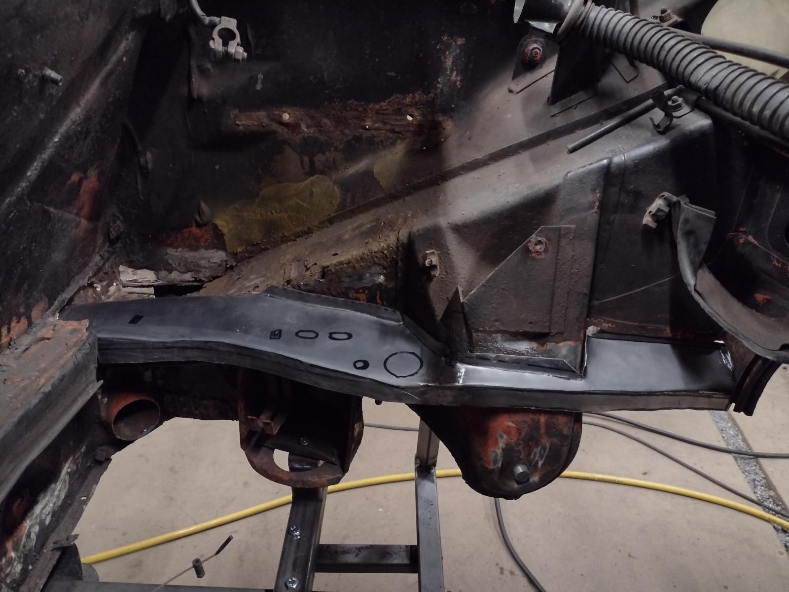

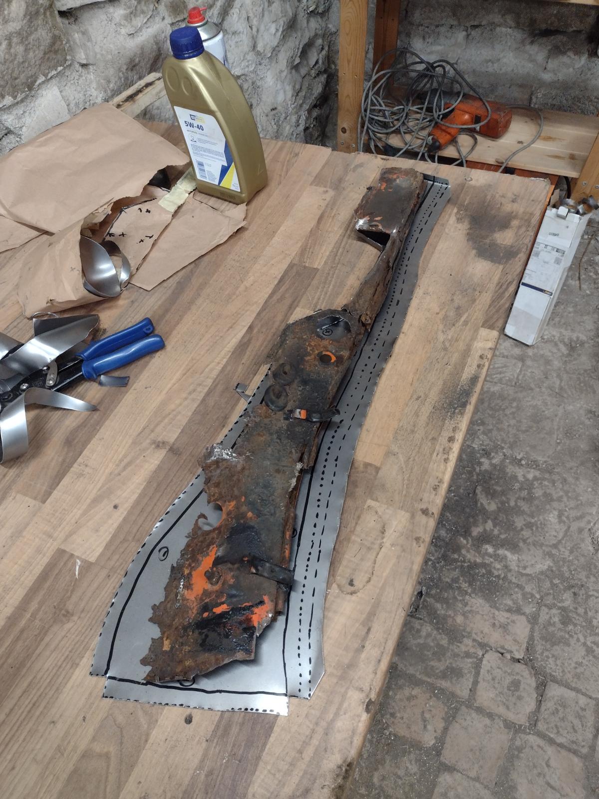

So I started to make a new one..and I had some difficulties getting the shape with so few left..I made a couple trial and in the end made it in two parts, easier to adjust and tig welded together in the end.
Here both parts getting adjusted:
(IMG:http://www.914world.com/bbs2/uploads_offsite/www.thesamba.com-24690-1636547864.4.jpg)
And welded: (IMG:style_emoticons/default/welder.gif)
(IMG:http://www.914world.com/bbs2/uploads_offsite/www.thesamba.com-24690-1636547865.5.jpg)
