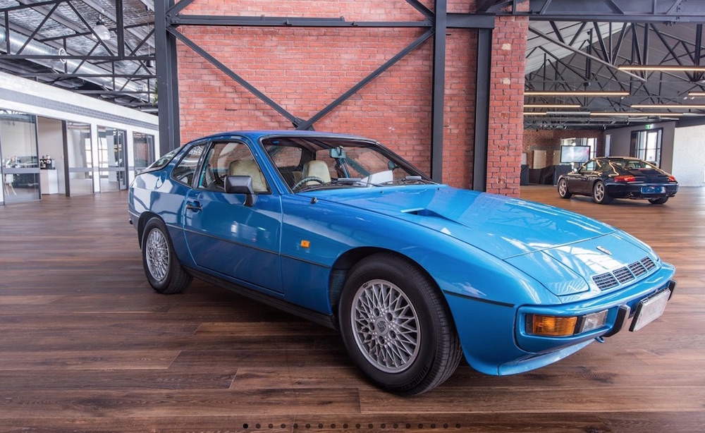

@mb911
it does look clean but i think there is something funny.
don't know my 924s well enough to spot things straight away.
but its got US bumpers!
aus cars look like this. V
euro bumpers and also flank indicators on the front guards.
sounds crazy but it could be a US car that has been imported and converted to RHD.
which seems like a crazy thing to do - when they made them RHD.
still might be worth a look.

wonkipop   nice buy @Gatornapper 924 turbos are a rare sig...   Oct 22 2021, 07:46 PM

wonkipop   nice. (flame and GTR). --- got me curious enoug...   Nov 8 2021, 09:44 PM
Maltese Falcon   nice. (flame and GTR). --- got me curious enou...   Nov 9 2021, 01:02 AM
wonkipop   [quote name='wonkipop' post='2958668' date='Nov 8...   Nov 9 2021, 03:40 AM
JamesM   nice. (flame and GTR). --- got me curious enou...   Nov 9 2021, 01:49 AM
wonkipop   [quote name='wonkipop' post='2958668' date='Nov 8...   Nov 9 2021, 03:43 AM
Gatornapper   Wonki - Now I'm really puzzled. "932...   Nov 9 2021, 05:33 PM
mb911   Wonki - Now I'm really puzzled. "932...   Nov 9 2021, 05:43 PM
wonkipop   Wonki - Now I'm really puzzled. "932...   Nov 9 2021, 05:48 PM
wonkipop   i had a check of wiki. just to see. not that it is...   Nov 9 2021, 06:20 PM
Gatornapper   Guys - Found the same on 932 search. RHD. I have...   Nov 9 2021, 06:42 PM
wonkipop   i hadn't realised the turbos are quite a small...   Nov 9 2021, 09:45 PM
wonkipop   you got me going gator. there is another one for ...   Nov 10 2021, 01:17 AM

wonkipop   @mb911 it does look clean but i think there is s...   Nov 10 2021, 03:51 PM

wonkipop   @Gatornapper . don't forget 20K aud = 14.5K u...   Nov 11 2021, 01:35 AM
Gatornapper   Wonki - I cannot imaging the cost of converting a...   Nov 11 2021, 09:30 AM
wonkipop   @Gatornapper . converting cars to RHD from LHD is...   Nov 11 2021, 05:16 PM
Gatornapper   Wonki - Lotsa priceless info in your post. Thank...   Nov 11 2021, 08:49 PM
wonkipop   i'm a bit mellower with age than i used to be....   Nov 11 2021, 09:08 PM
