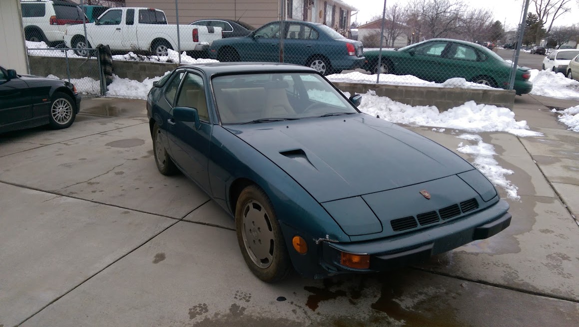

At 76, I think I've got one more project in me. My Porsche genius friend Rick found me this in Cleveland:
https://cleveland.craigslist.org/cto/d/lake...7387301032.html
And I have a contract on it for less than asking price. Friends in Cleveland looked at it closely on Wed. nite, sent me 7 close-up videos of it and gave it a huge thumbs up. Engine did run for few seconds with starter fluid, started immediately and sounded like new. Almost no rust, interior immaculate.
This is a very rare Special Edition with custom interior, wheels and two-tone paint.
Looking for a great source of info on 924's but can't find much. Nothing like 914 world.
Any pointers for a resource like 914world would be appreciated - tho I'm sure there is none.
NO - not selling the 914! My garage has room for both cars.
TIA,
GN

Been out all day driving a 944 friend Rick was looking at. Rick is a Porsche genius and encyclopedia and already told me most of the details you have noted. I've also studied everything I could find on the early 924 turbos and read what's out there.
Reason I am going for the '80 with it's "deficiencies" is this is an exceptionally rare car - both a Turbo and Special Edition with that great interior - and a rare find I'm not likely to run across again. 5 wheel lugs, all disc brakes, better turbo, etc. are not worth passing by this gem. I'm not looking for 914 handling - I have that. Looking for rare collectible old Porsche worth restoring in not too bad shape. This car nails it!
Owner bought w/5,000 miles in '86. Was honest about smallest details, wanted to revive car himself he loves it so much but realizes he's not going to do it. E.g., front right drain from sunroof stopped up or broken. But as car has been stored, dampness in floor is recent from recent heavy rain.
I found 924.org, but did not find the forum and will check that out - what I was looking for.
I'm an old mechanic so I know what to do first - fuel tank, pump, lines, filters etc. renewed. Coupe tablespoons of Marvel Mystery Oil to sit in each cylinder for several days before starting. All new belts, hoses, especially timing. Oil & filter change, coolant change/flush soon after car is running well.
Car is in amazingly good condition and I'm hoping it will start easily once the fuel system is renewed.
Welcome more thoughts as you all have them.
With my '11 Cayman S, '76 914 and '80 931 - I think I'll have an outstanding and unusual Porsche NON-911 collection!

A couple things that i remember when i brought mine back from the dead 7 or so years ago.
The fuel/vacuum system accounted for 90% of the work in getting it going again.
The car has 2 fuel pumps an external high pressure pump, and an in-tank pump with attached filter. The high pressure pump can be had fairly cheap and is no big deal to replace. The in tank pump on the other hand may have you questioning your life choices if you look at how much it costs (north of 800 bucks last time i looked). More bad news is that i hear the pumps available today have fitment issues in the 931 tanks as well. If the in tank pump has failed (which after 17 years it is almost surely frozen) you can get the car to start and idle, but it creates enough of a restriction that it impacts fueling under load. Thankfully is there a part from later 928s that can be used in place of this pump (928 201 081 04) however the nipple is larger so the fuel hose to the pump will need to be replaced as well.
The piston in the fuel distributor is most likely seized due to varnish. This is probably the most critical part of the fuel metering. Be careful getting it out as you wont want to scratch it at all.
The fuel filter installs in the reverse orientation of what you would think it would due to how the lines are routed.
There are I think 5 different formed rubber elbows in the intake system. I was able to still source them back when I got mine going, but last I looked many of them are now NLA everywhere so you may need to get creative. These have most likely cracked and all are critical for proper fuel control. the injection system on these things is very sensitive to vacuum and fuel pressure issues. One of the elbows is right off the turbo and more or less behind the water pump so plan on doing the water pump and timing belt as well as you have to go through those to get there.
Some some of the coolant hoses are shared with the NA 924 but a lot of the turbo specific coolant hoses are NLA.
931 coolant expansion tanks are (or at least were) extremely hard to come by however the VW scirocco tank is a very close fit and can be made to work.
There was a 931 specific vendor (ideola) around when i brought mine back that had a lot of cool bits for the 931 however he recently closed up shop. Not aware of many vendors that specifically cater to the 931 anymore. Thankfully Porsche has brought some of the more impossibly critical parts for this car back into production since then (see cam oiler elbow) though others like the air flow meter to turbo boot are still impossible to come by.
There is a group on facebook for 924 Carerra GTs/Turbos that I have found to be far more active than the 924 forums.
Start your hunt for a Canadian Speedometer now, the 85mph thing gets old real quick as the car easily buries the needle long before you even hit 5th gear. 160MPH speedos exist BUT the green gauges were 1 year only (like many of the 931 parts), all the US cars had the legally mandated 85 MPH speedos and all the Euro cars had KPH gauges so the green 160MPH gauges are like hens teeth. They do exist though
good luck. They are fun (and now EXTREAMLY rare cars). Seriously in 30+ years of Porsche obsession the only 931 I have ever personally seen on the road is mine. I have seen more people driving 959s and Carerra GTs.
