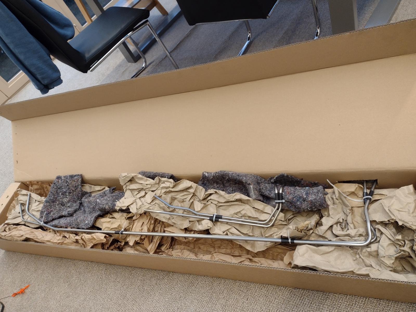

(IMG:http://www.914world.com/bbs2/uploads_offsite/www.thesamba.com-24690-1637154774.1.jpg)
With my stainless steel fuel lines:
(IMG:http://www.914world.com/bbs2/uploads_offsite/www.thesamba.com-24690-1637154774.2.jpg)

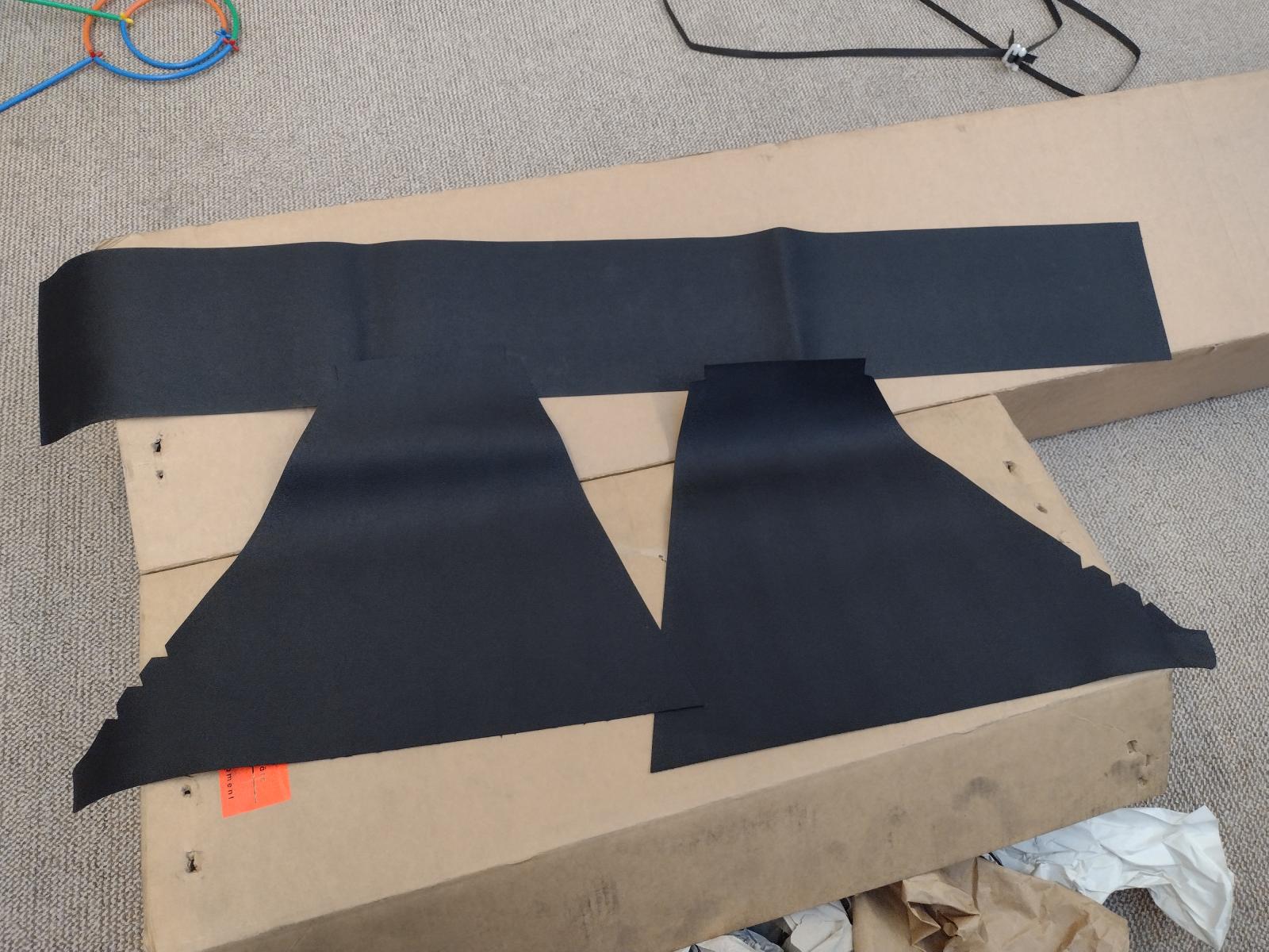

And the vinyl for the sail panel:
(IMG:http://www.914world.com/bbs2/uploads_offsite/www.thesamba.com-24690-1637154775.3.jpg)

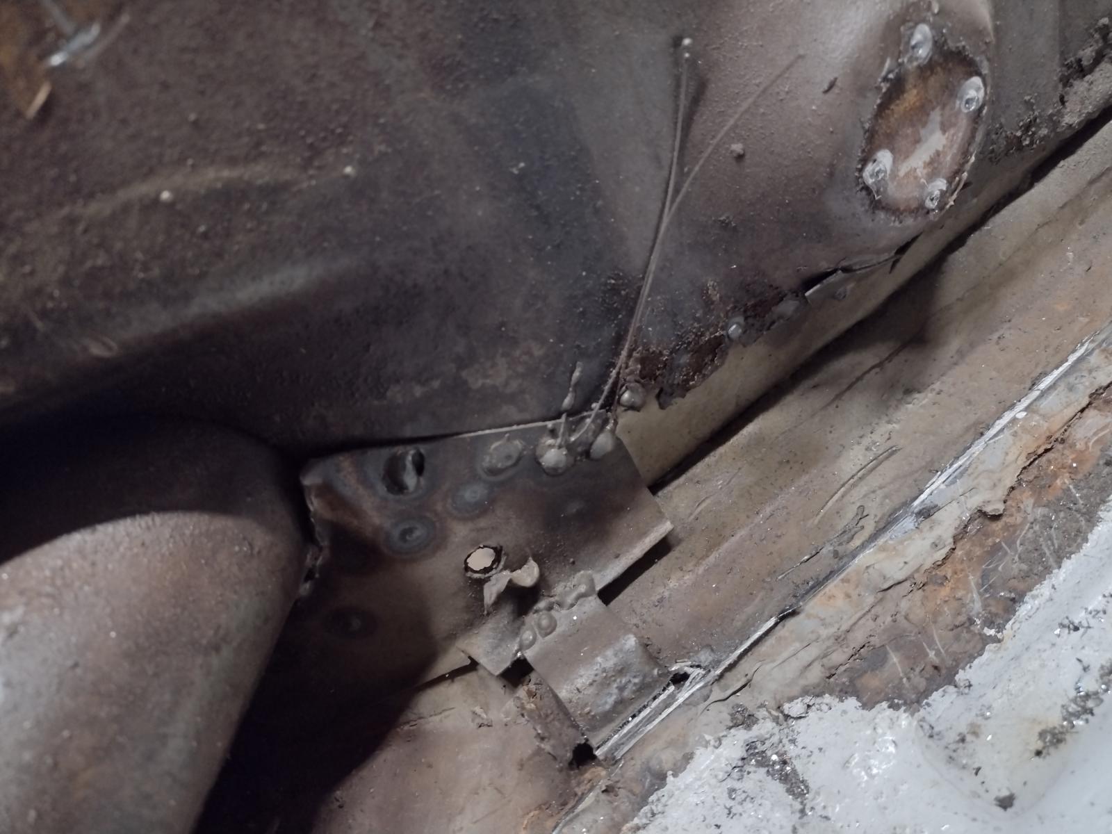

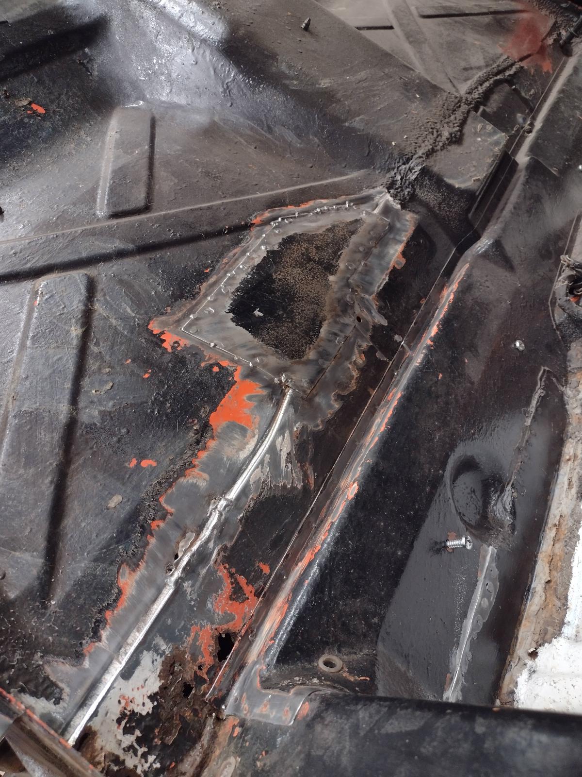

And then it was time to start on the hellhole. First making some space in the corner of the cabin..so a part ofthe firewall has to go:
(IMG:http://www.914world.com/bbs2/uploads_offsite/www.thesamba.com-24690-1637154775.4.jpg)

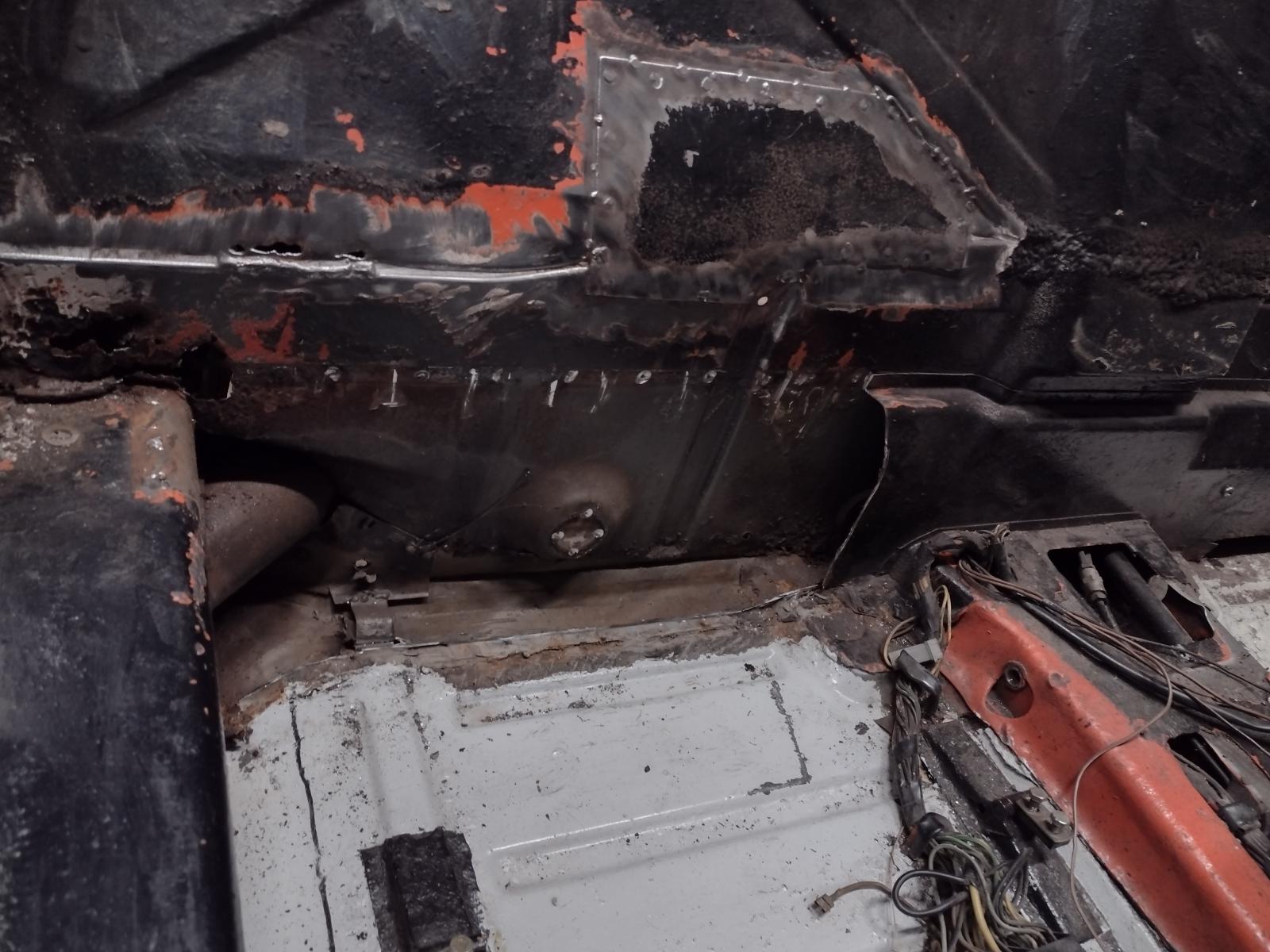

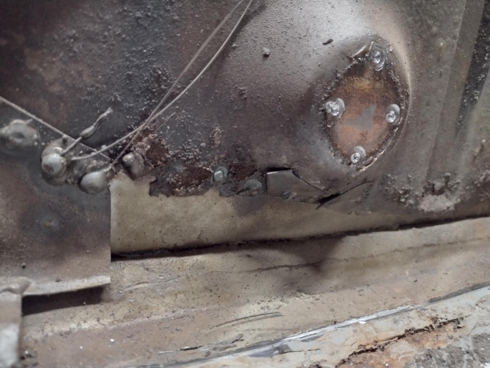

It had its issue and bad repair:
(IMG:http://www.914world.com/bbs2/uploads_offsite/www.thesamba.com-24690-1637154775.5.jpg)
(IMG:http://www.914world.com/bbs2/uploads_offsite/www.thesamba.com-24690-1637154776.6.jpg)

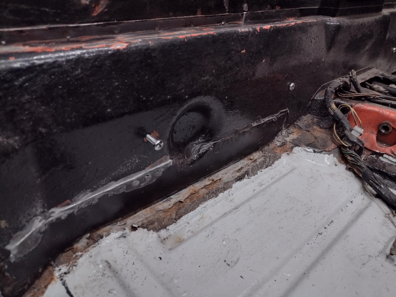

So it was time to remove as far as needed to repair it properly:
(IMG:http://www.914world.com/bbs2/uploads_offsite/www.thesamba.com-24690-1637154776.7.jpg)

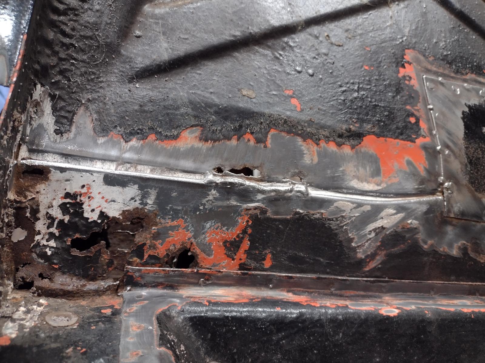

What I discovered behind it wasn't nice either:
(IMG:http://www.914world.com/bbs2/uploads_offsite/www.thesamba.com-24690-1637154776.8.jpg)
(IMG:http://www.914world.com/bbs2/uploads_offsite/www.thesamba.com-24690-1637154777.9.jpg)

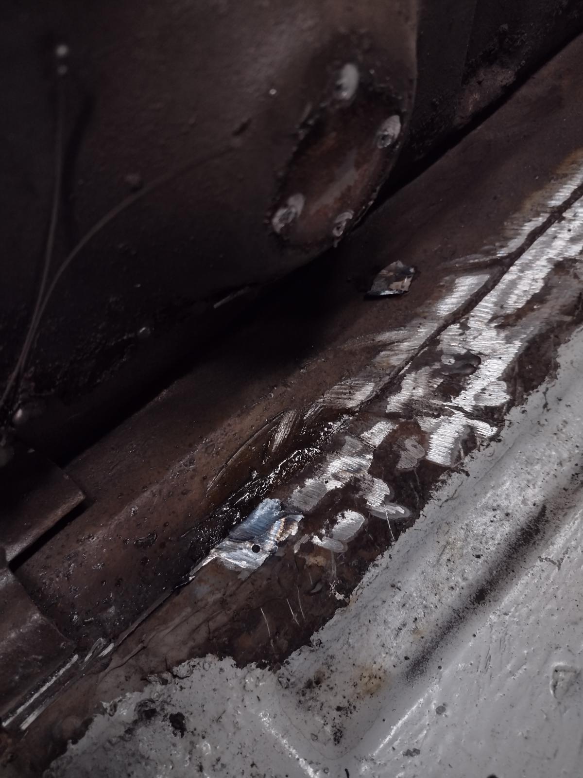

And the floor "repair" was not butt welded, which showed when I cut here the remain of the firewall and water came through capillarity even if the car did not see any water/rain since end of july (IMG:style_emoticons/default/unsure.gif)
(IMG:http://www.914world.com/bbs2/uploads_offsite/www.thesamba.com-24690-1637154777.10.jpg)
So more work on this area..
