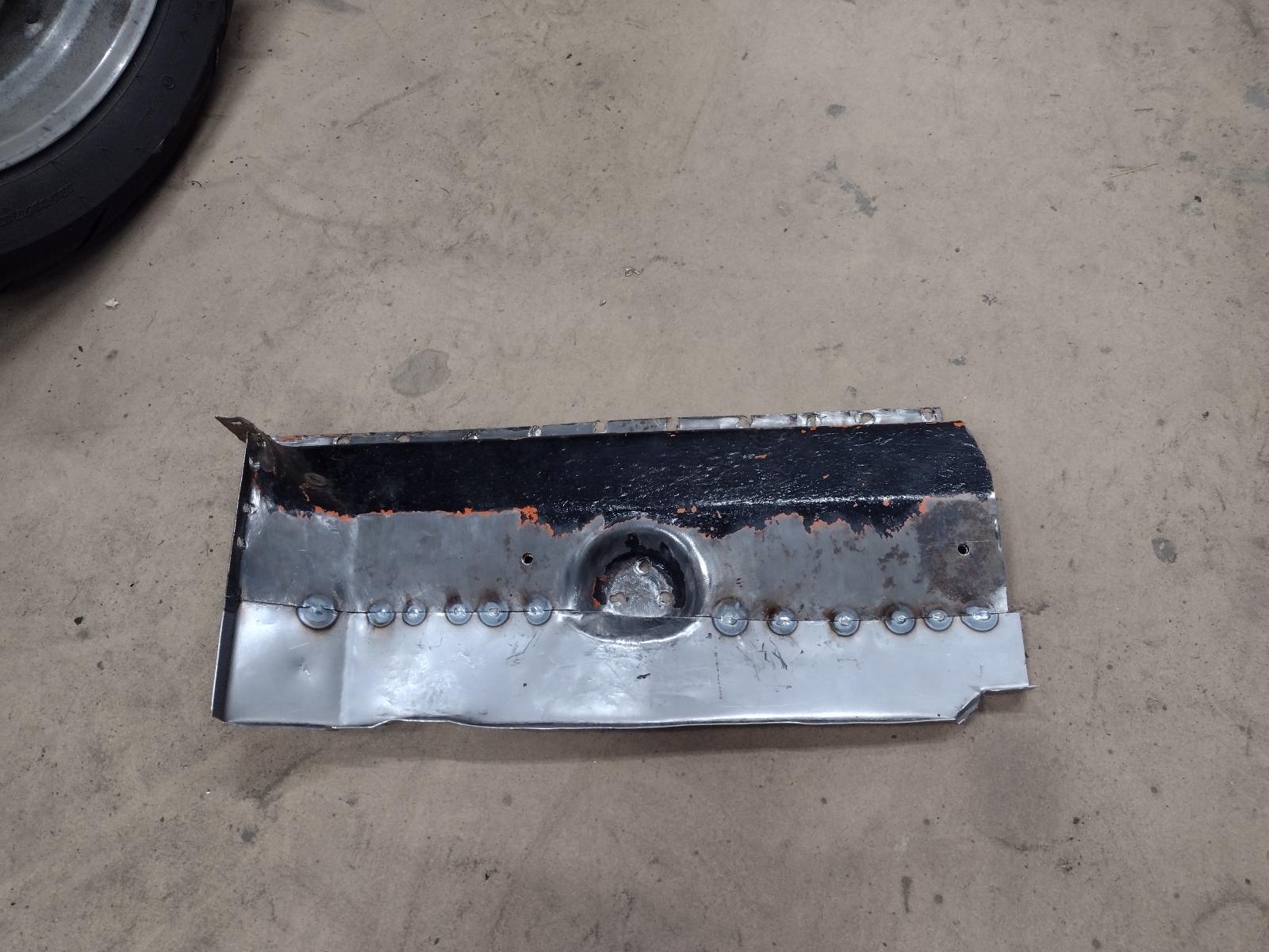

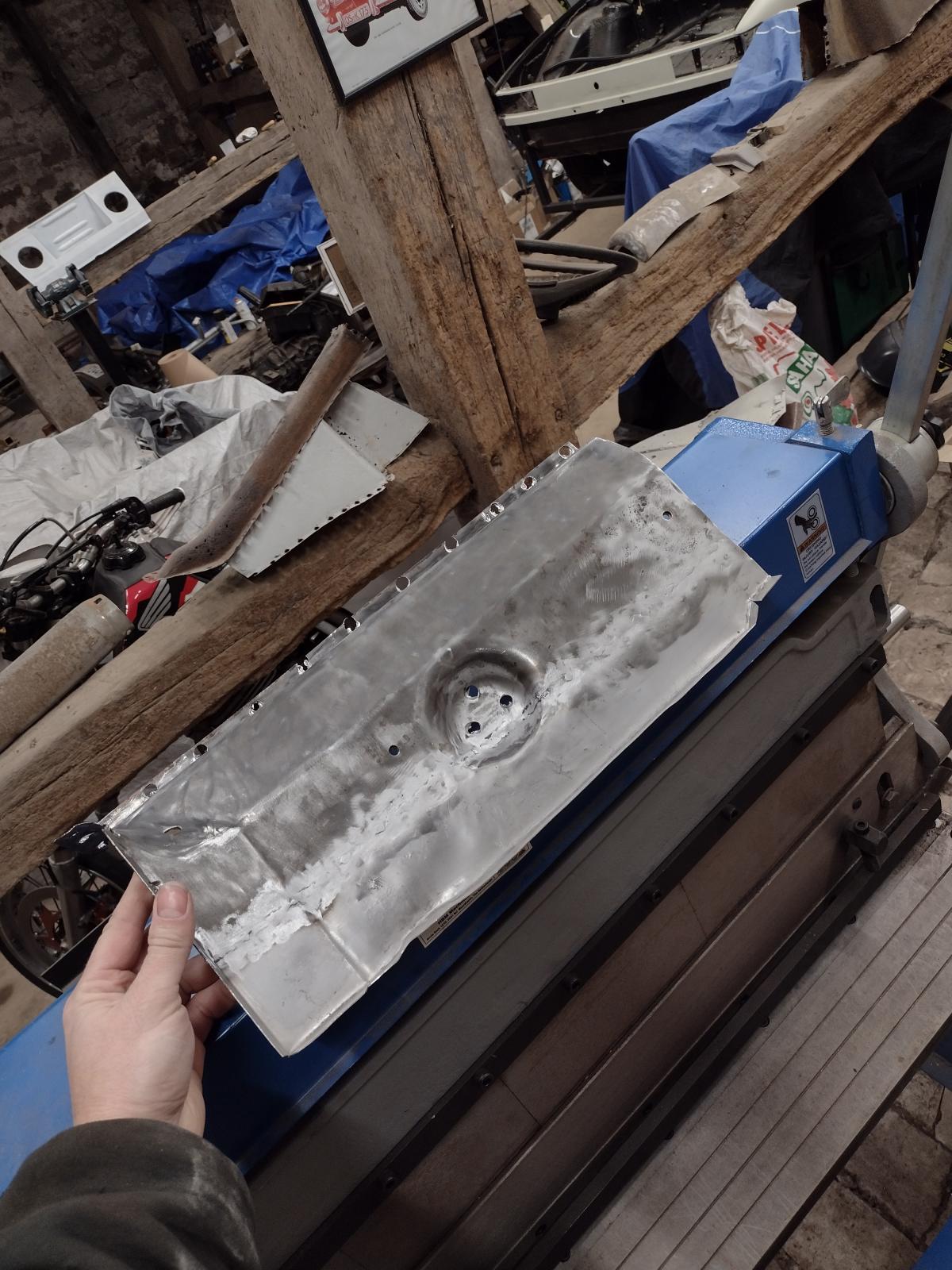

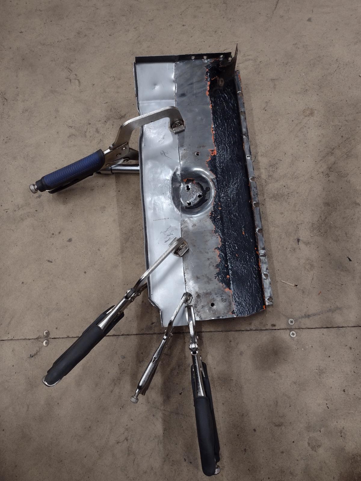

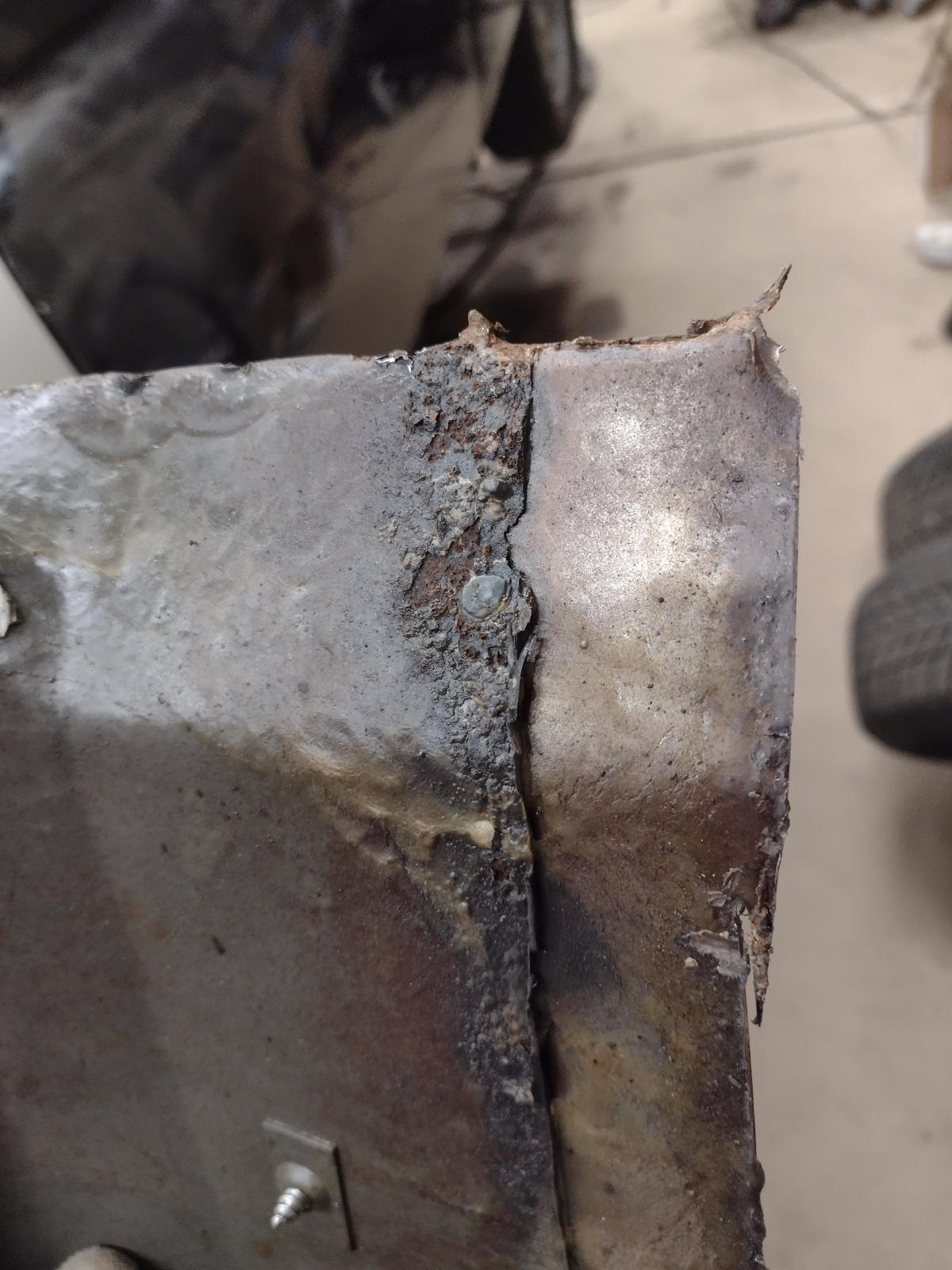

So, as I said, before going further, I repaired properly the firewall part I did cut.
It had a "repair" with metal over rust... (IMG:style_emoticons/default/headbang.gif)
(IMG:http://www.914world.com/bbs2/uploads_offsite/www.thesamba.com-24690-1637313486.1.jpg)
(IMG:http://www.914world.com/bbs2/uploads_offsite/www.thesamba.com-24690-1637313487.2.jpg)

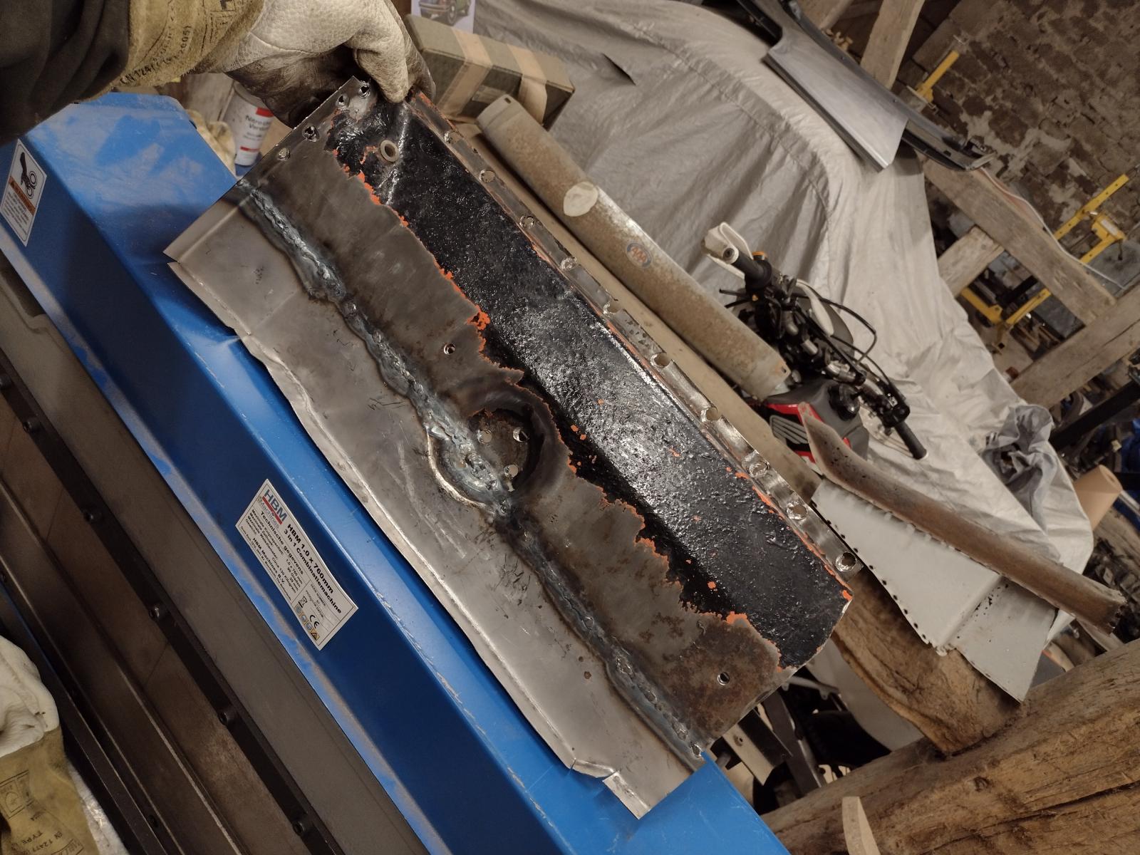

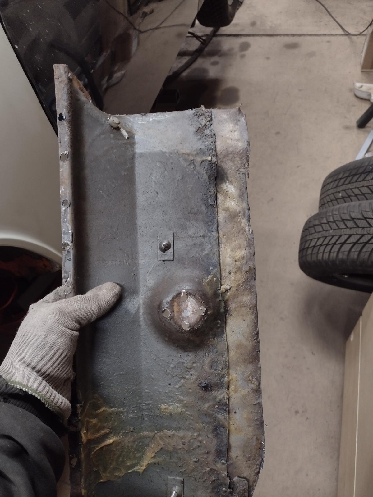

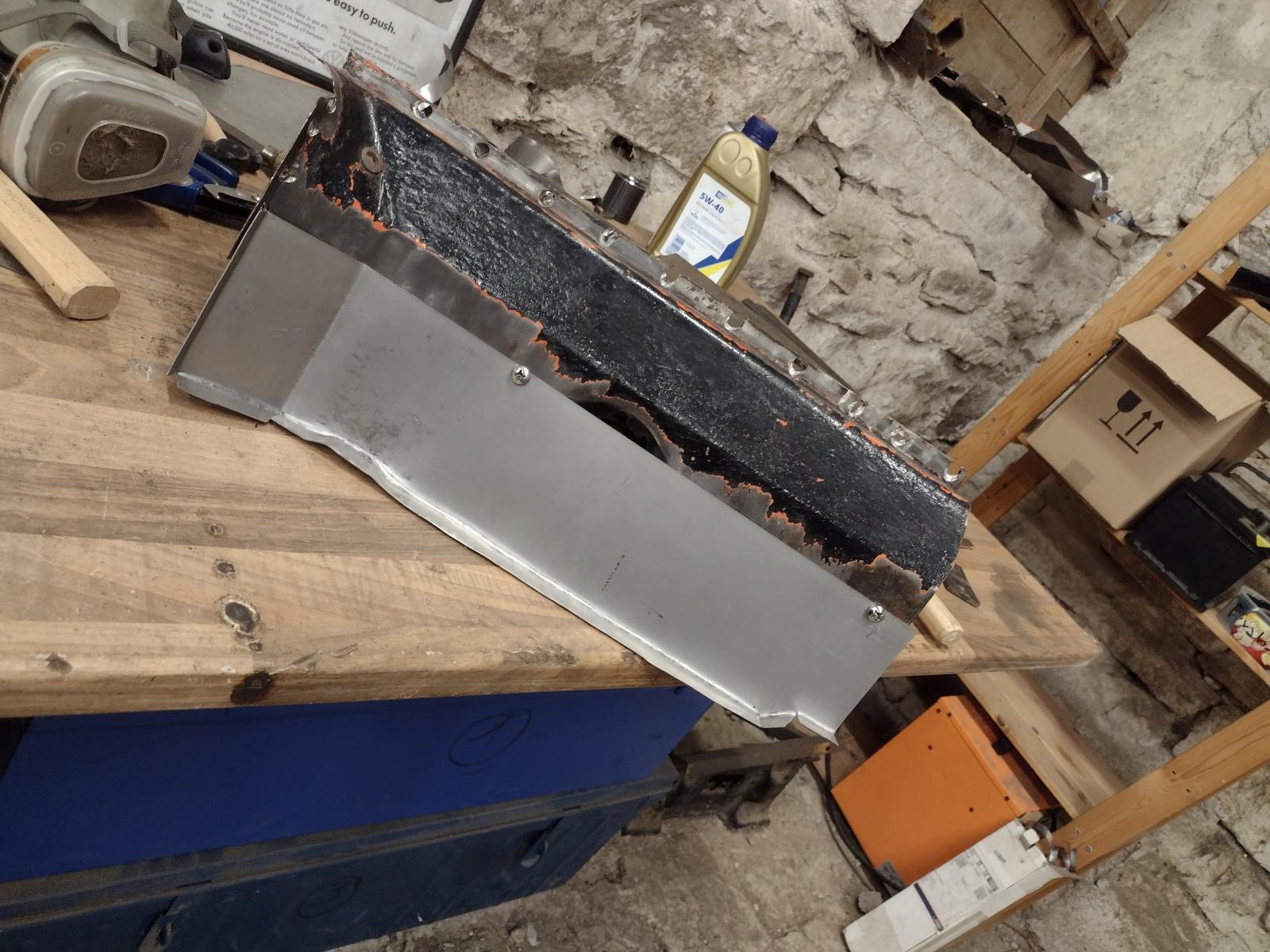

So I made a patch :
(IMG:http://www.914world.com/bbs2/uploads_offsite/www.thesamba.com-24690-1637313488.3.jpg)
(IMG:http://www.914world.com/bbs2/uploads_offsite/www.thesamba.com-24690-1637313488.4.jpg)

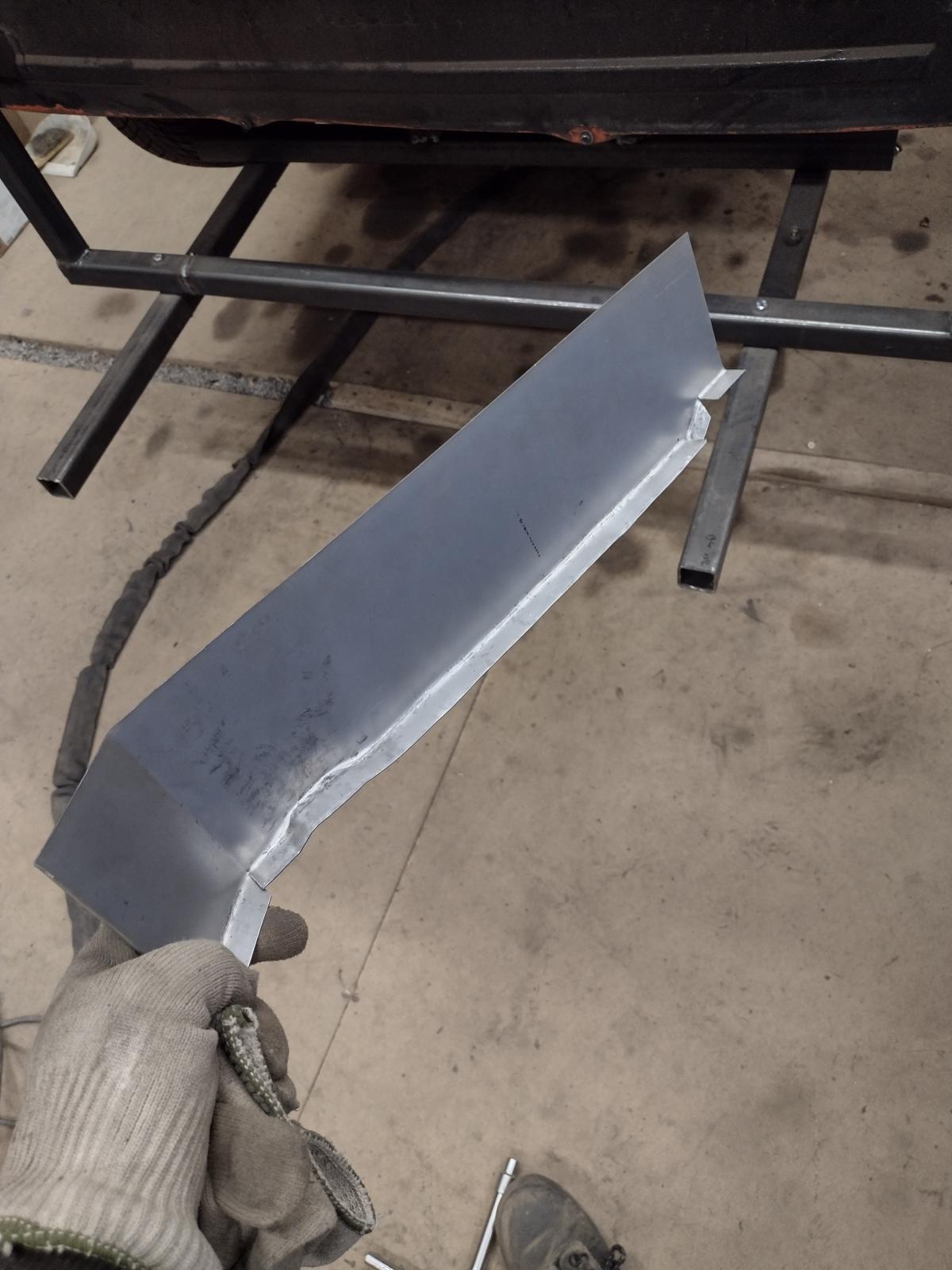

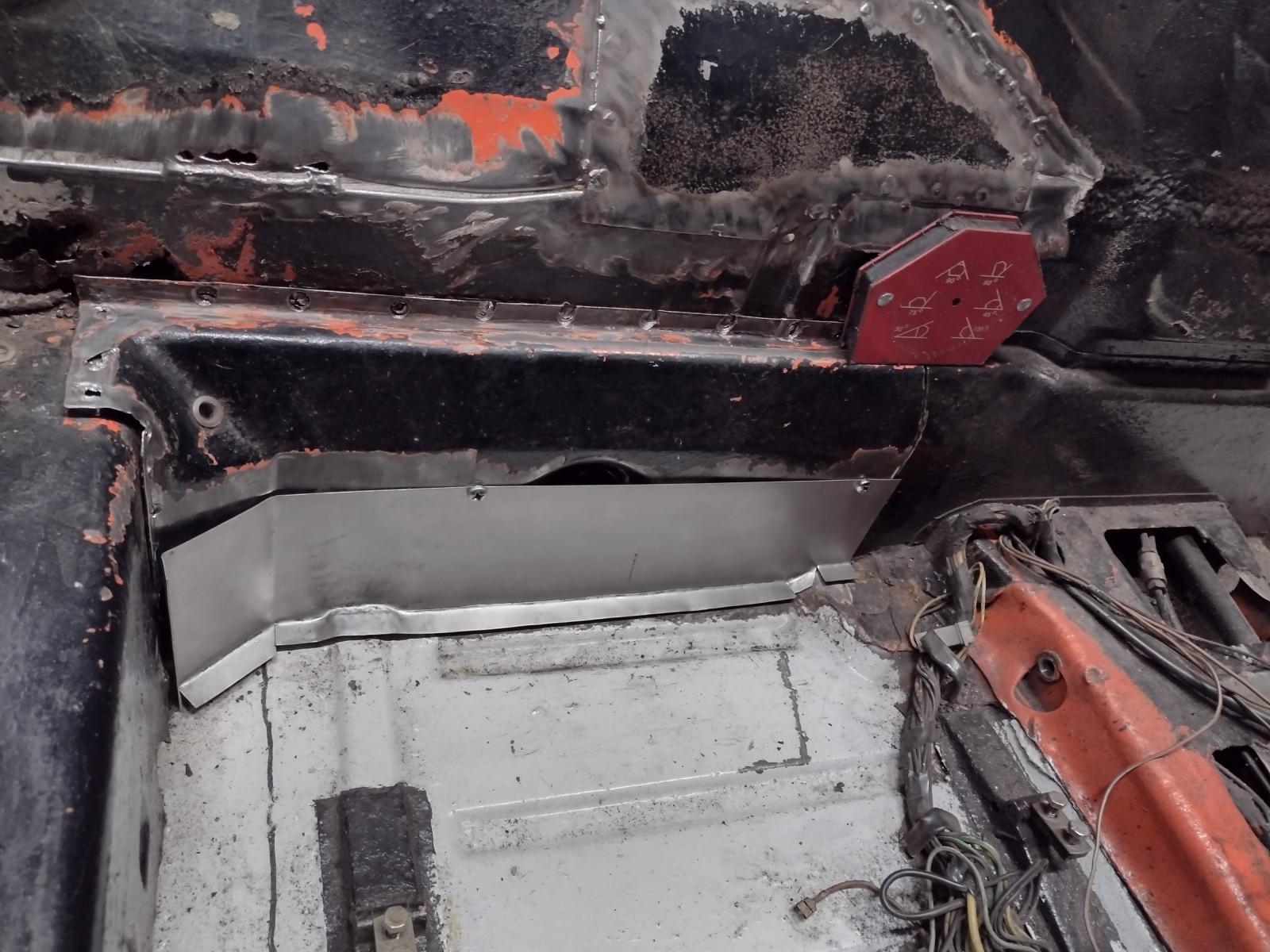

And adjusting:
(IMG:http://www.914world.com/bbs2/uploads_offsite/www.thesamba.com-24690-1637313489.5.jpg)
(IMG:http://www.914world.com/bbs2/uploads_offsite/www.thesamba.com-24690-1637313489.6.jpg)

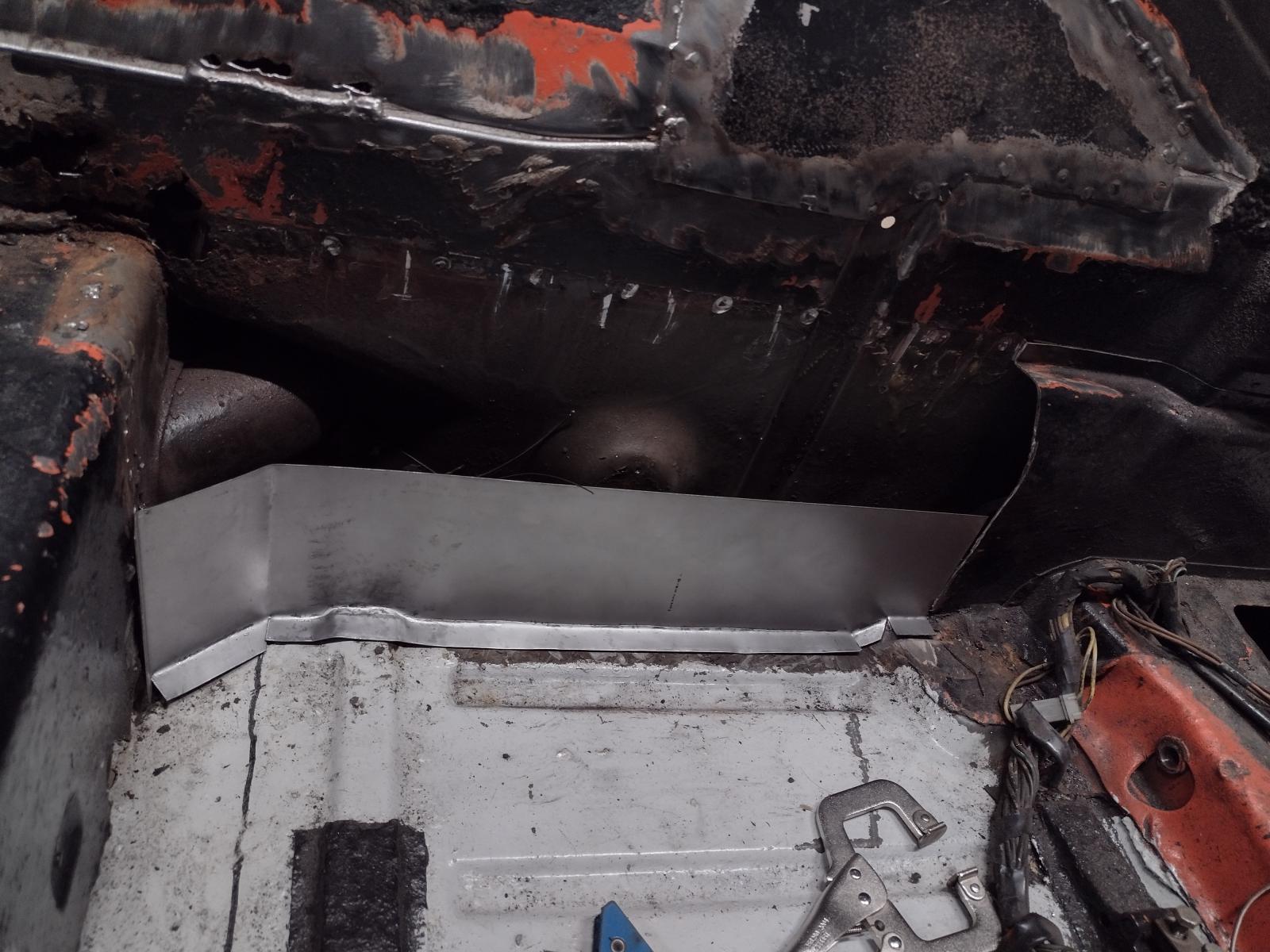

Ready to weld:
(IMG:http://www.914world.com/bbs2/uploads_offsite/www.thesamba.com-24690-1637313489.7.jpg)

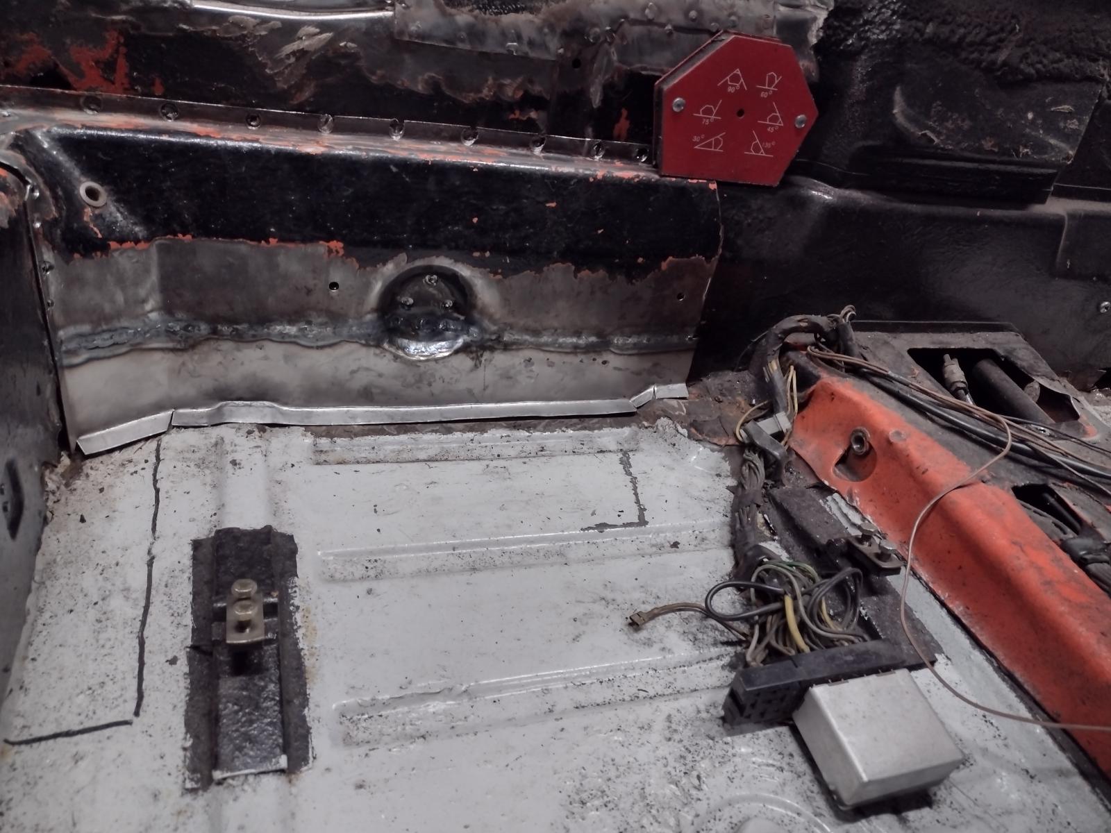

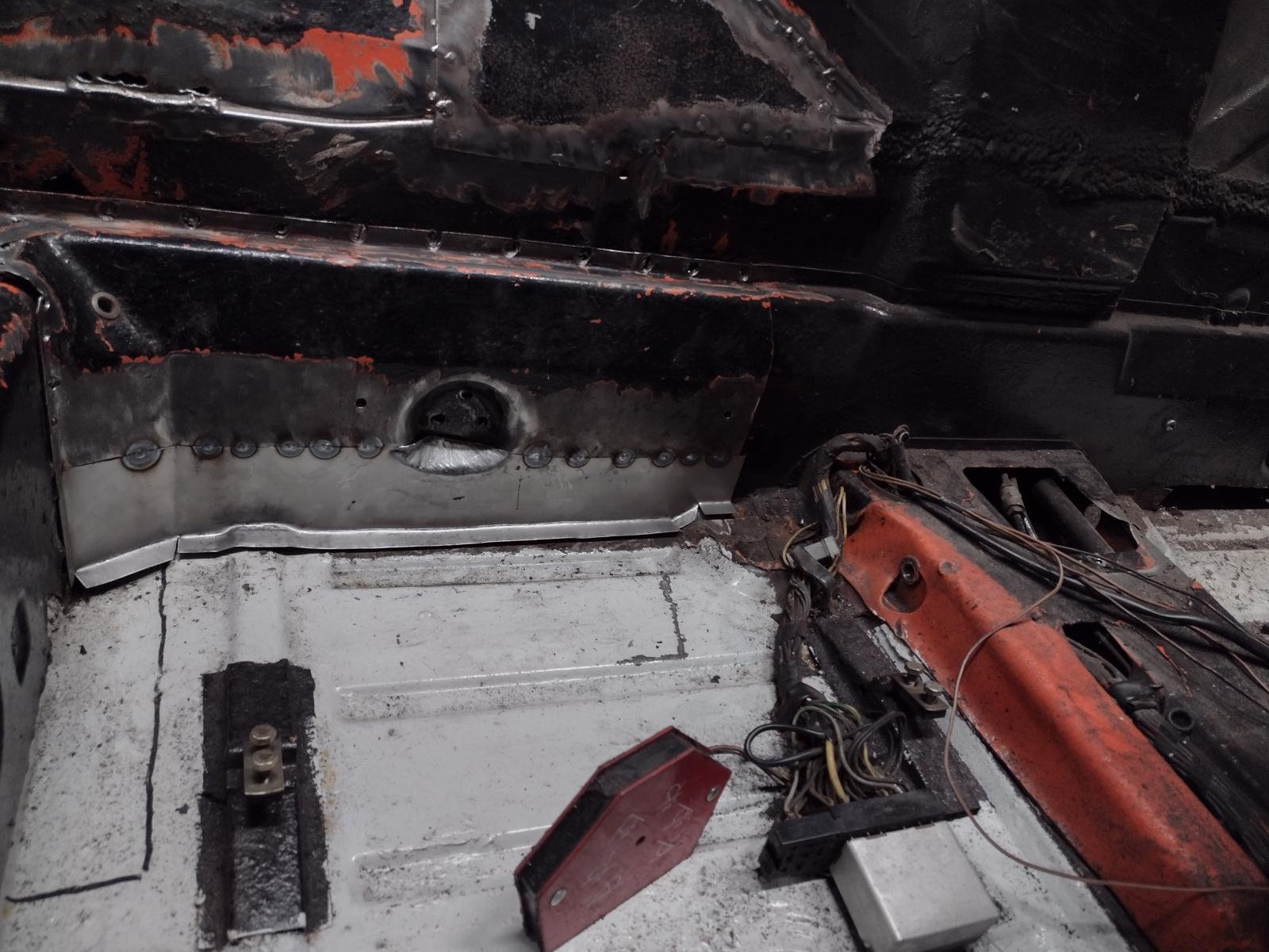

Tack welded and check:
(IMG:http://www.914world.com/bbs2/uploads_offsite/www.thesamba.com-24690-1637313490.8.jpg)
(IMG:http://www.914world.com/bbs2/uploads_offsite/www.thesamba.com-24690-1637313490.9.jpg)
Welded and check:
(IMG:http://www.914world.com/bbs2/uploads_offsite/www.thesamba.com-24690-1637313491.10.jpg)
(IMG:http://www.914world.com/bbs2/uploads_offsite/www.thesamba.com-24690-1637313491.11.jpg)
