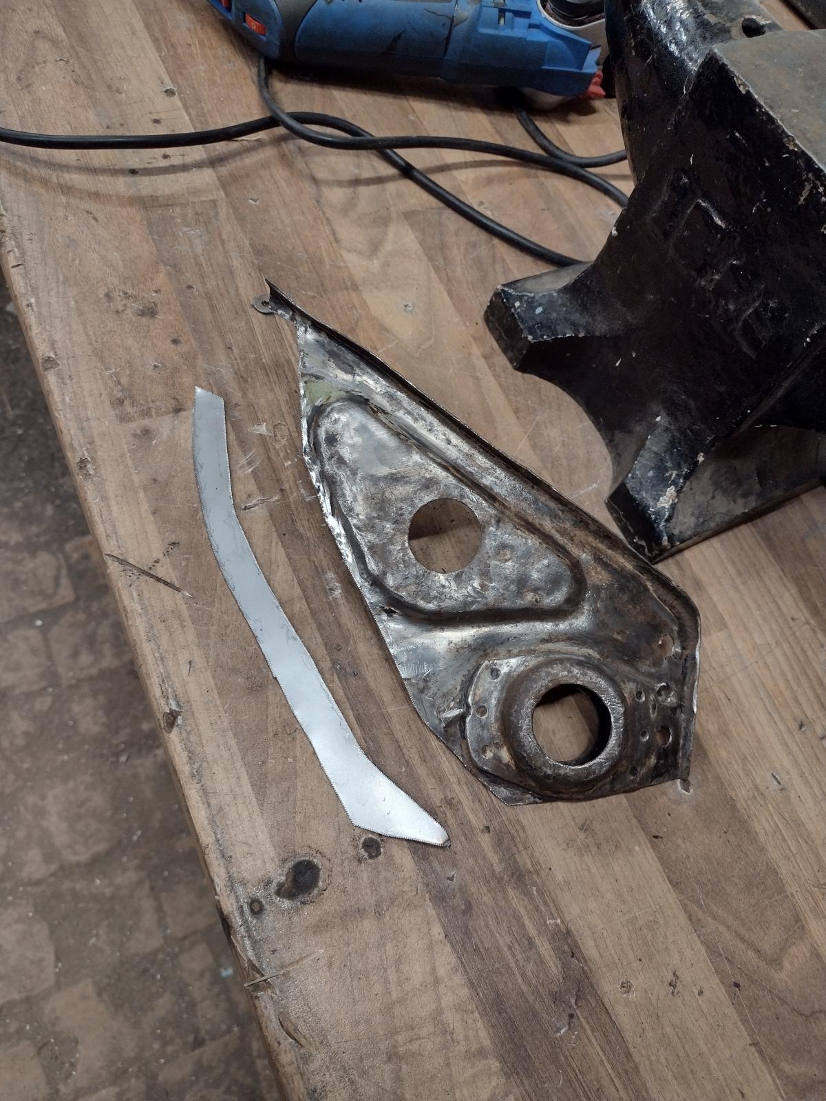

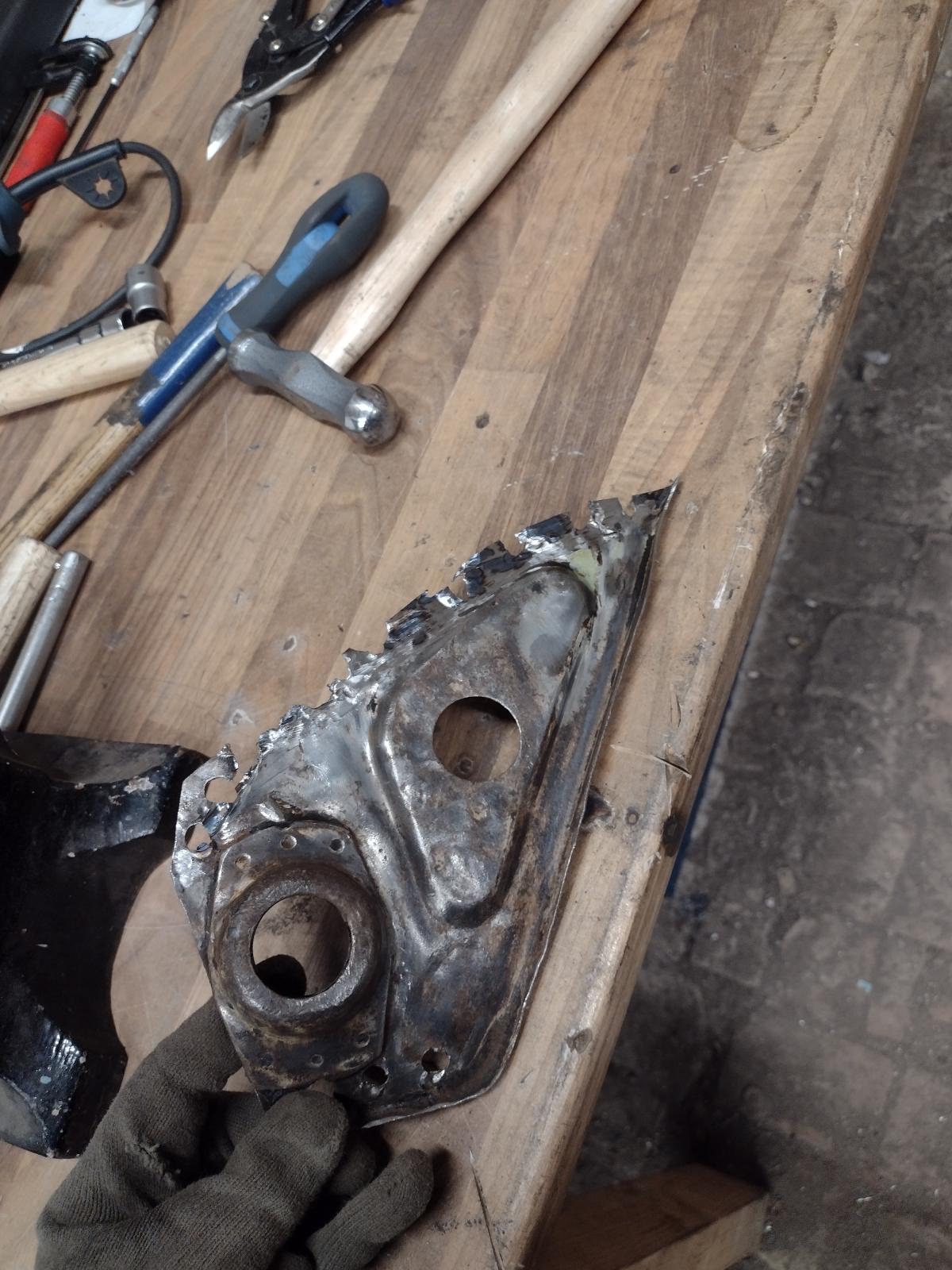

So, next update ! I removed the triangle at the back of the floor and it was damaged/poorly welded but still not really rusted so I decided to save it.
Before:
(IMG:http://www.914world.com/bbs2/uploads_offsite/www.thesamba.com-24690-1637918436.1.jpg)
During:
(IMG:http://www.914world.com/bbs2/uploads_offsite/www.thesamba.com-24690-1637918437.2.jpg)
After welding and beadblasting:
(IMG:http://www.914world.com/bbs2/uploads_offsite/www.thesamba.com-24690-1637918437.3.jpg)

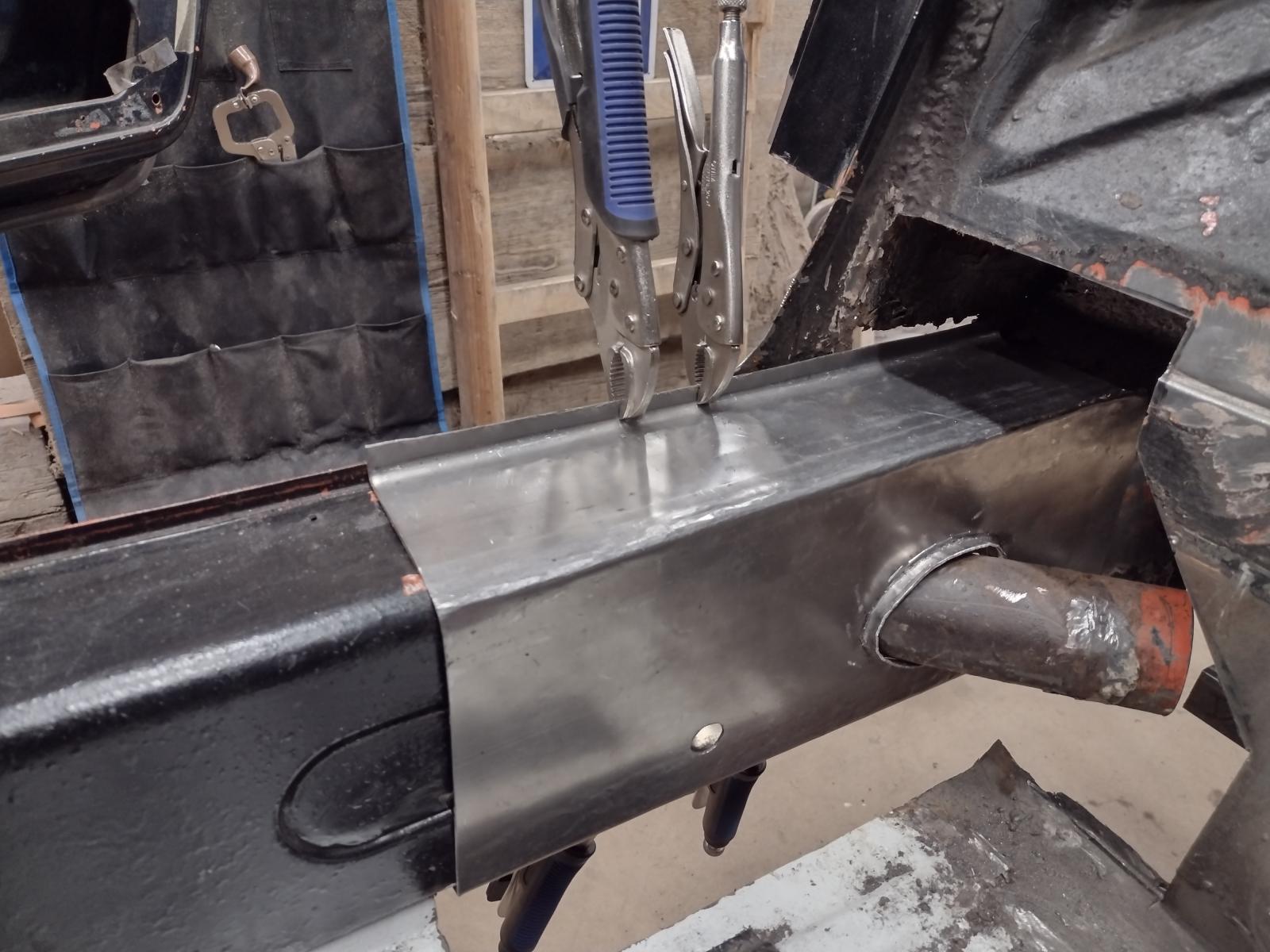

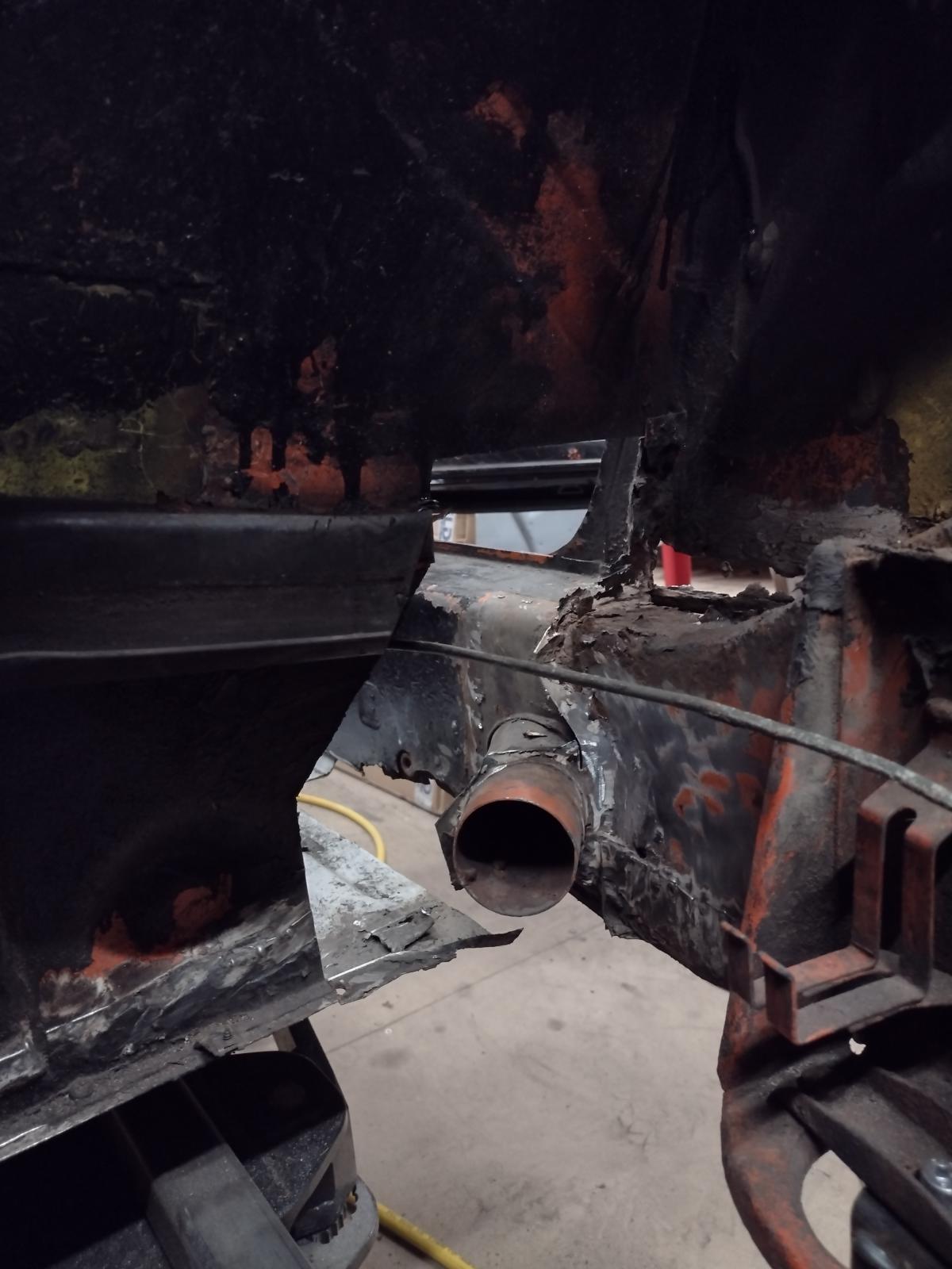

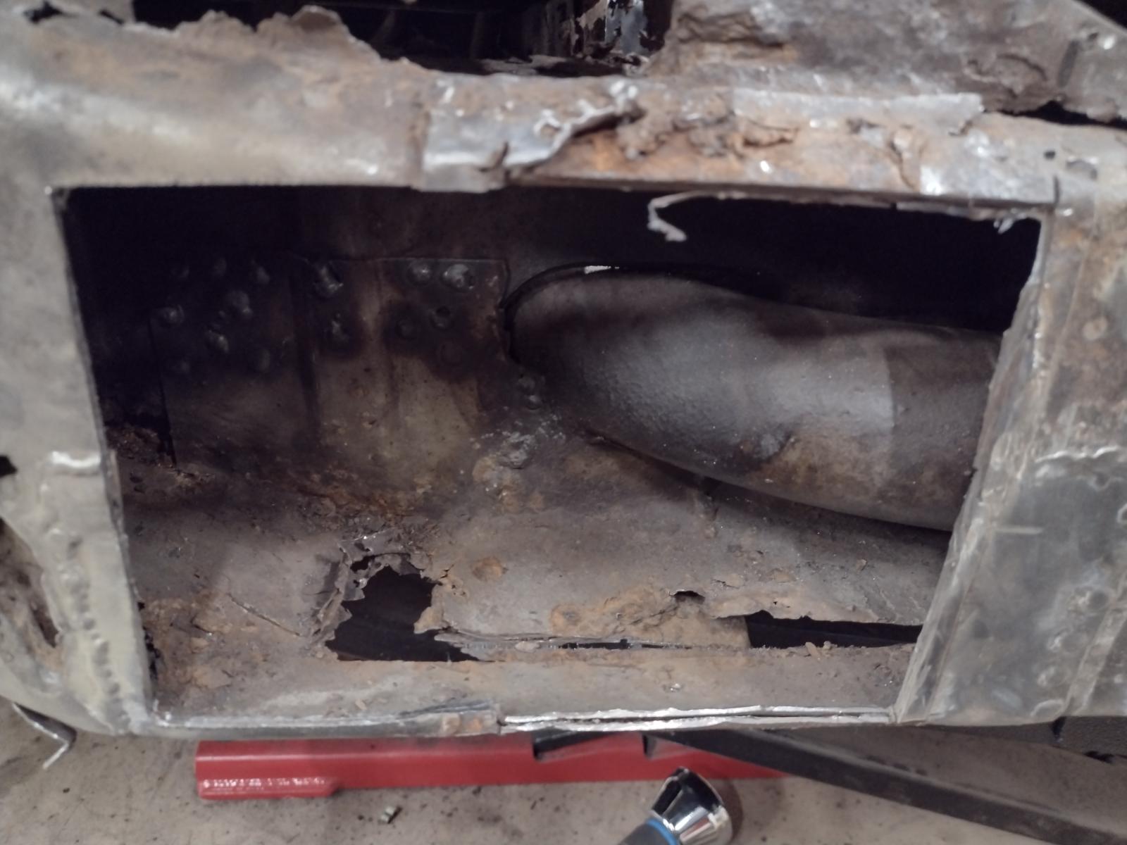

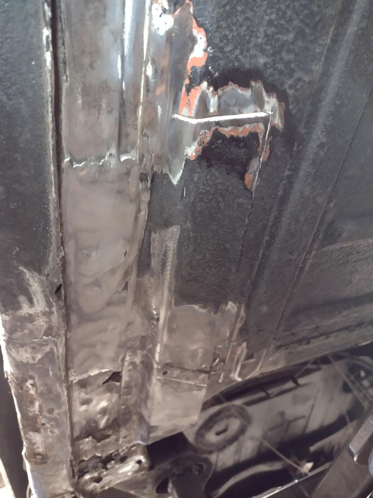

Then it was time to make some space to work on the long. Rust damages were there:
(IMG:http://www.914world.com/bbs2/uploads_offsite/www.thesamba.com-24690-1637918438.4.jpg)

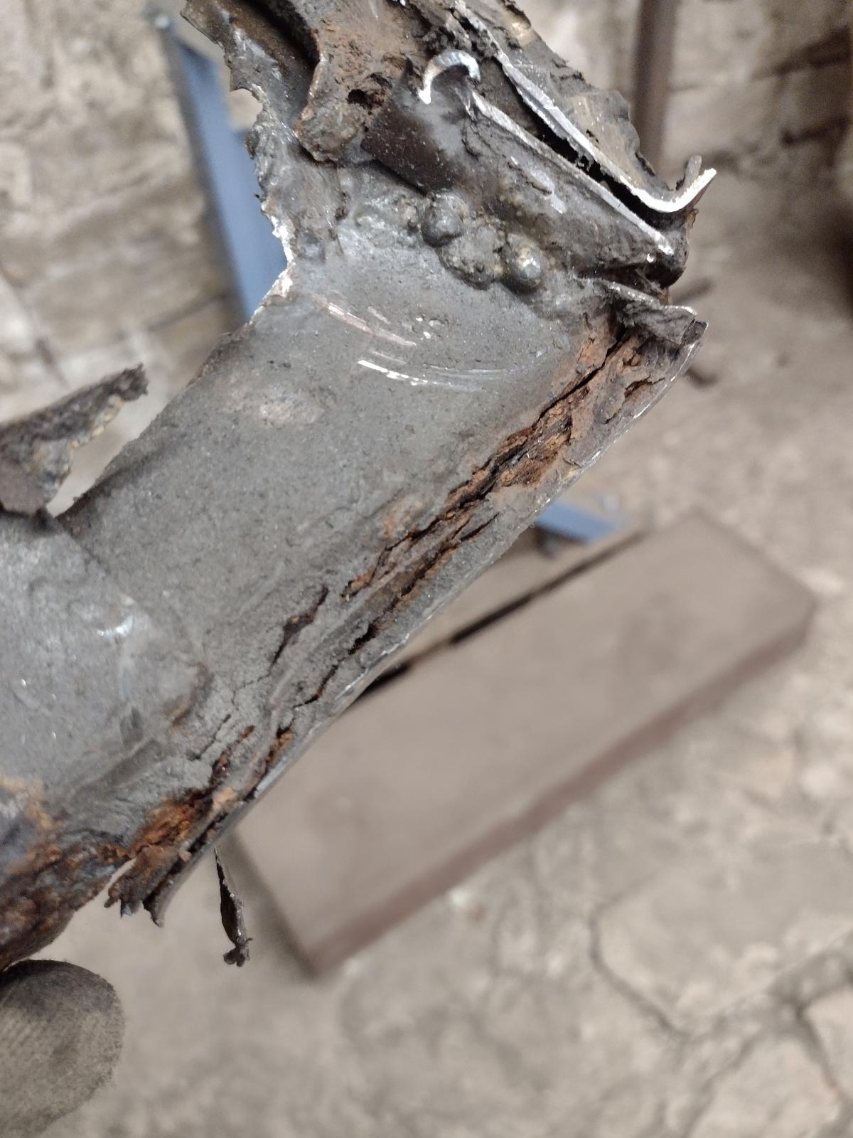

And when removing you see the old "repair" with metal over rust:
(IMG:http://www.914world.com/bbs2/uploads_offsite/www.thesamba.com-24690-1637918438.5.jpg)
(IMG:http://www.914world.com/bbs2/uploads_offsite/www.thesamba.com-24690-1637918438.6.jpg)
(IMG:http://www.914world.com/bbs2/uploads_offsite/www.thesamba.com-24690-1637918439.7.jpg)
So let's make some space:
(IMG:http://www.914world.com/bbs2/uploads_offsite/www.thesamba.com-24690-1637918440.8.jpg)

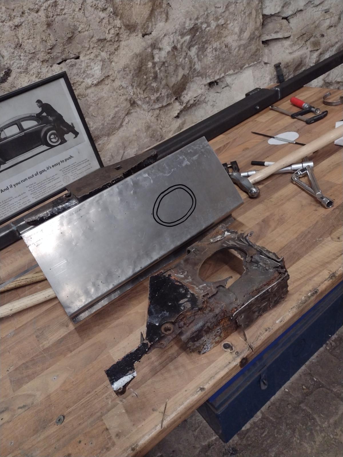

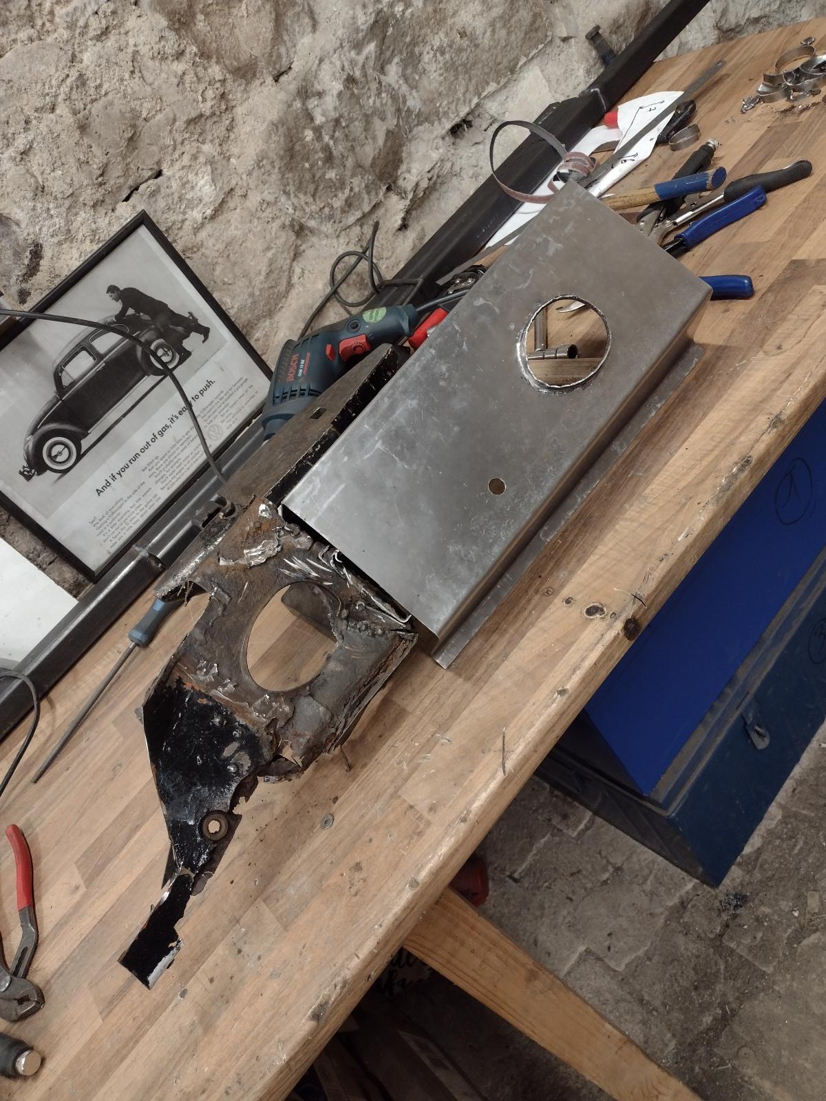

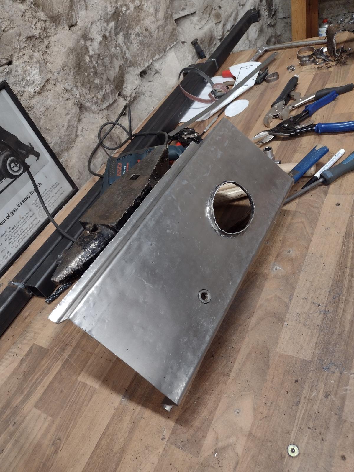

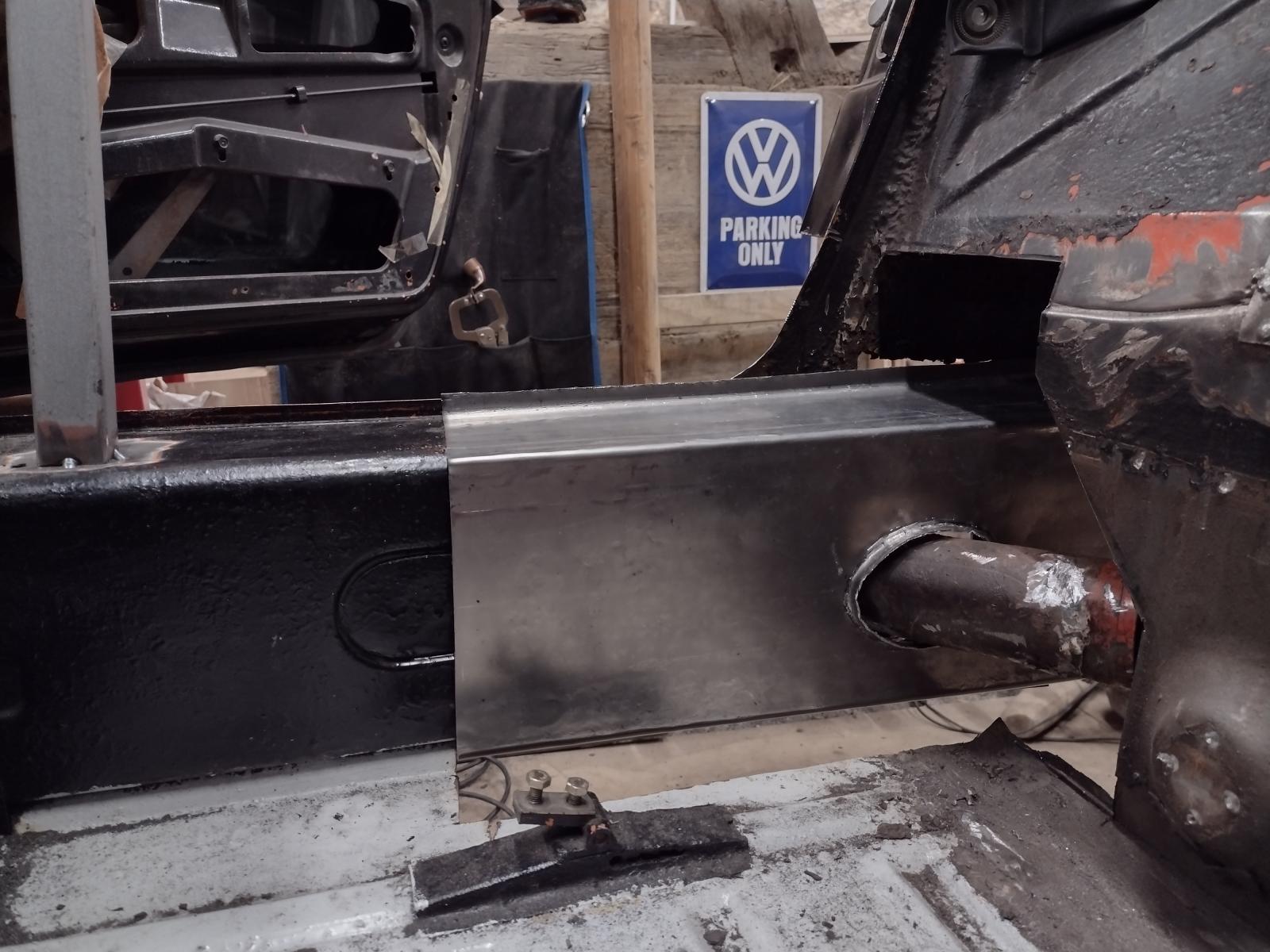

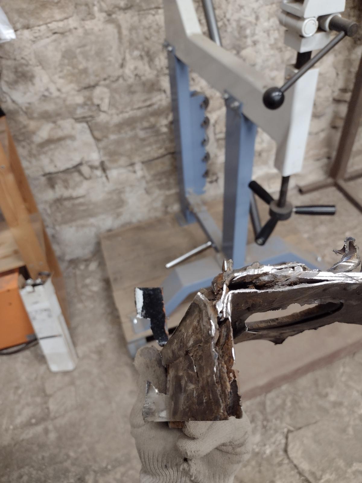

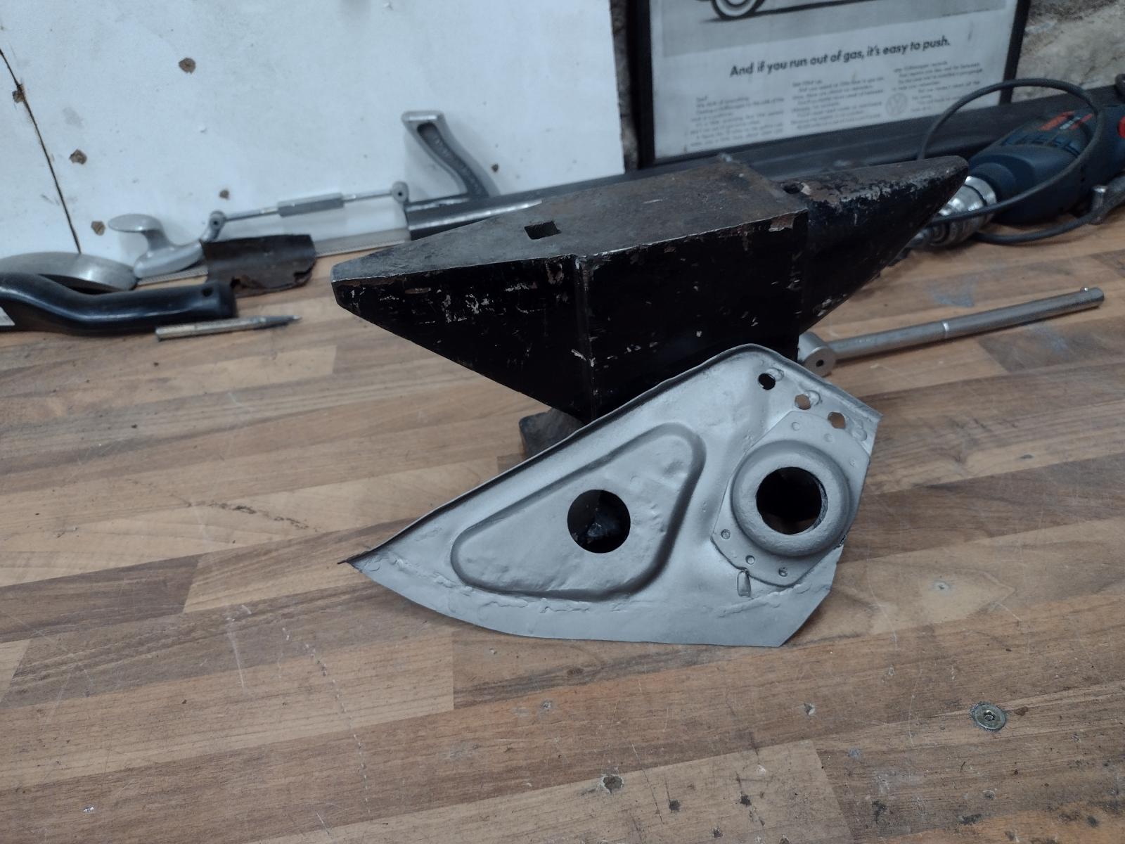

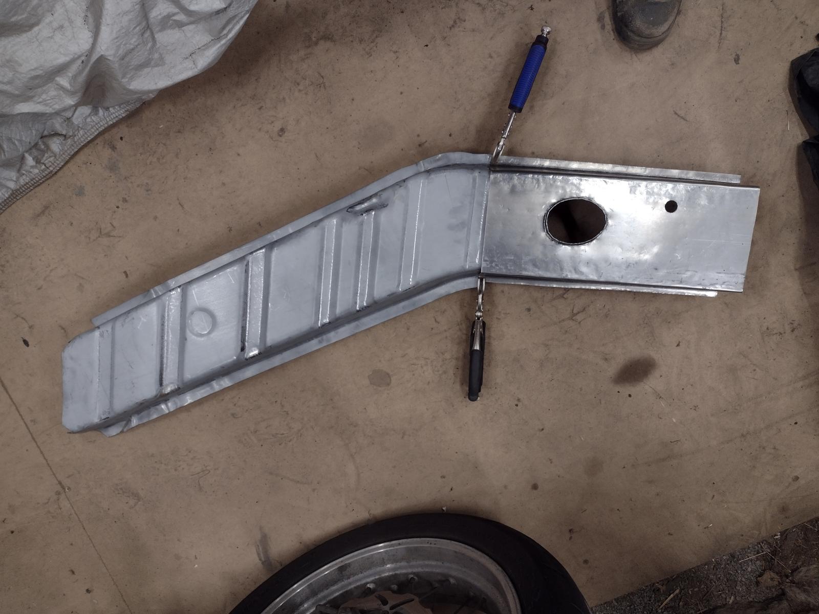

And start to make the repair pieces:
(IMG:http://www.914world.com/bbs2/uploads_offsite/www.thesamba.com-24690-1637918442.9.jpg)
(IMG:http://www.914world.com/bbs2/uploads_offsite/www.thesamba.com-24690-1637918442.10.jpg)
(IMG:http://www.914world.com/bbs2/uploads_offsite/www.thesamba.com-24690-1637918443.11.jpg)

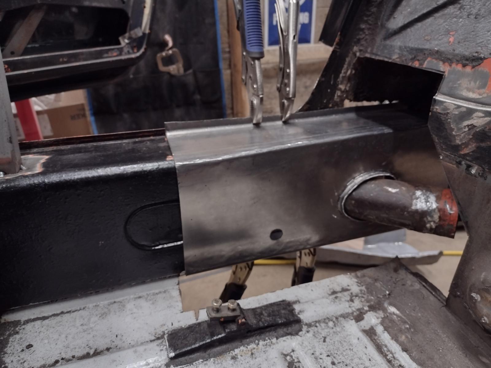

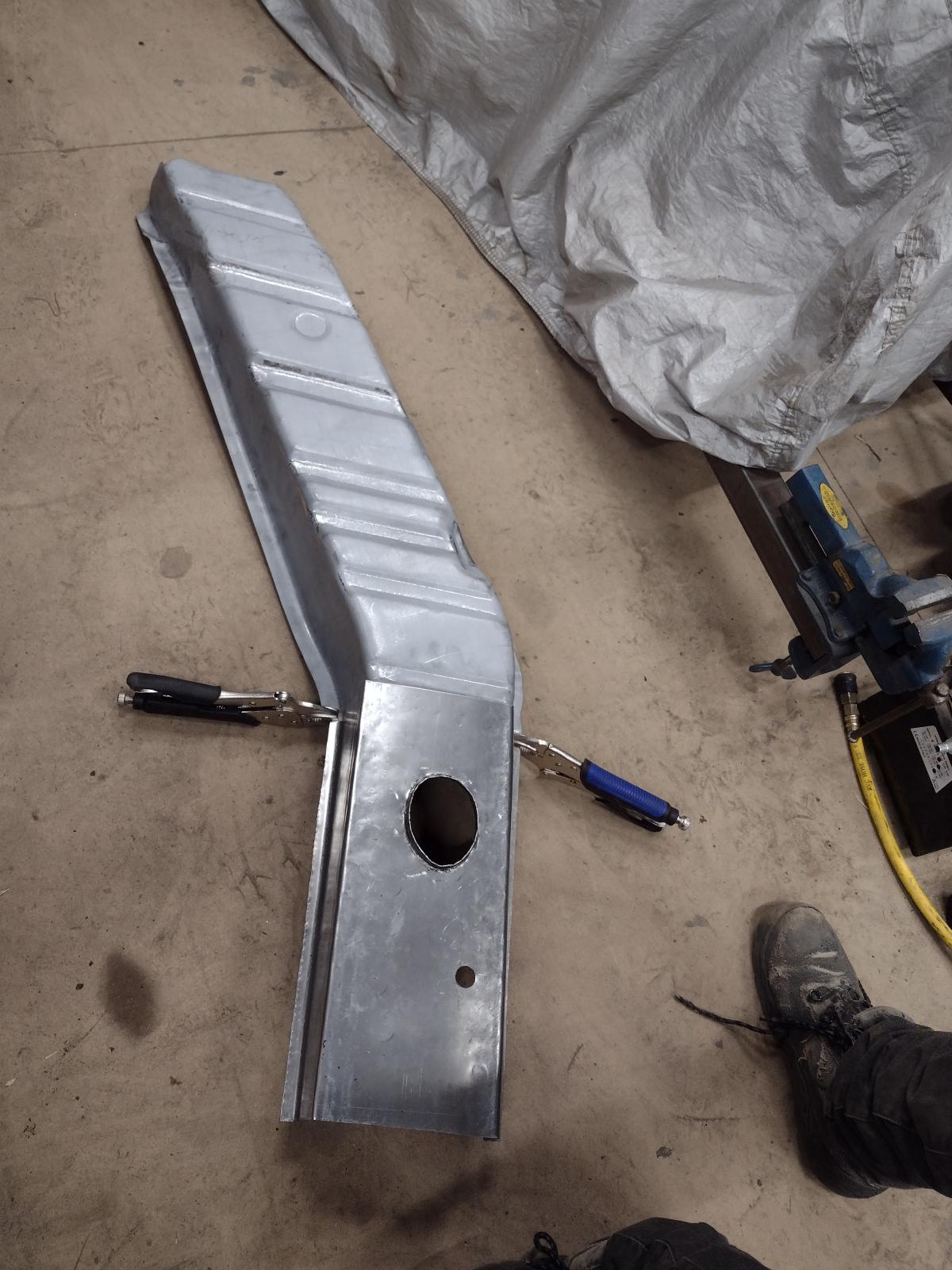

Test checking in position :
(IMG:http://www.914world.com/bbs2/uploads_offsite/www.thesamba.com-24690-1637918443.12.jpg)
(IMG:http://www.914world.com/bbs2/uploads_offsite/www.thesamba.com-24690-1637918444.13.jpg)
(IMG:http://www.914world.com/bbs2/uploads_offsite/www.thesamba.com-24690-1637918444.14.jpg)

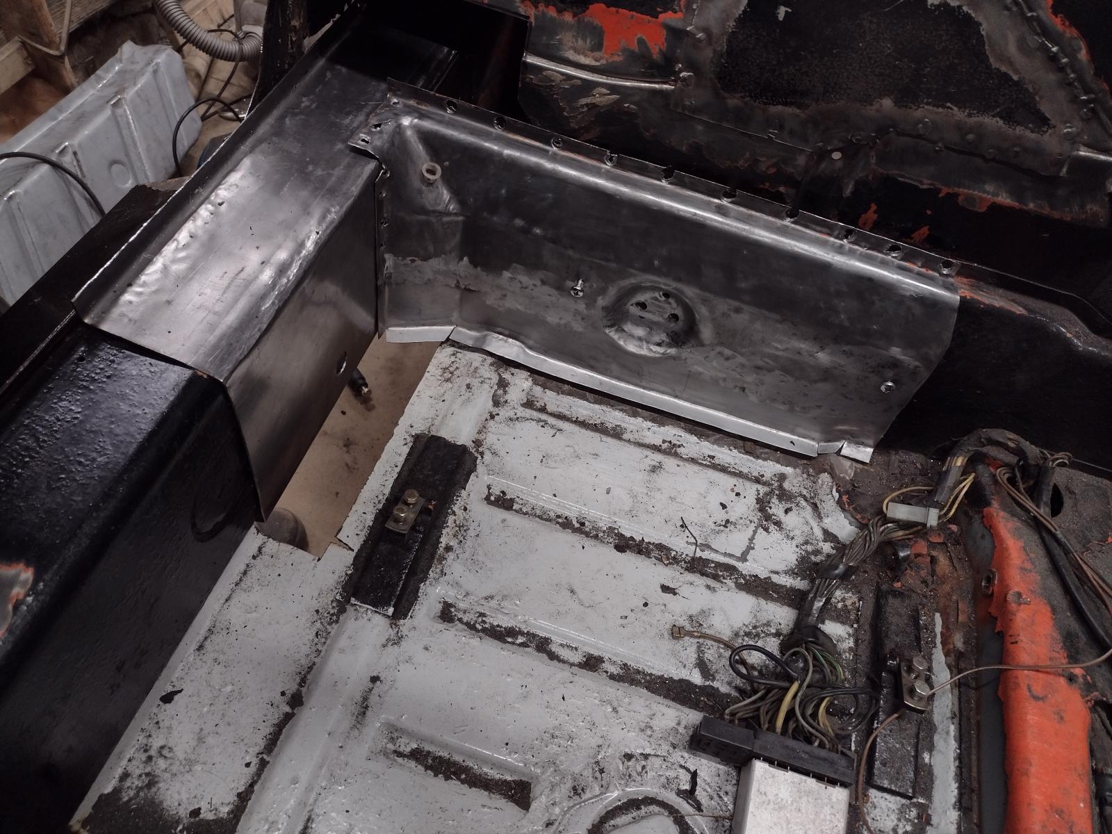

And soon all of this will be welded together:
(IMG:http://www.914world.com/bbs2/uploads_offsite/www.thesamba.com-24690-1637918445.15.jpg)
(IMG:http://www.914world.com/bbs2/uploads_offsite/www.thesamba.com-24690-1637918445.16.jpg)
(IMG:http://www.914world.com/bbs2/uploads_offsite/www.thesamba.com-24690-1637918445.17.jpg)
Stay tuned, I planned some solid hours on it next week !
